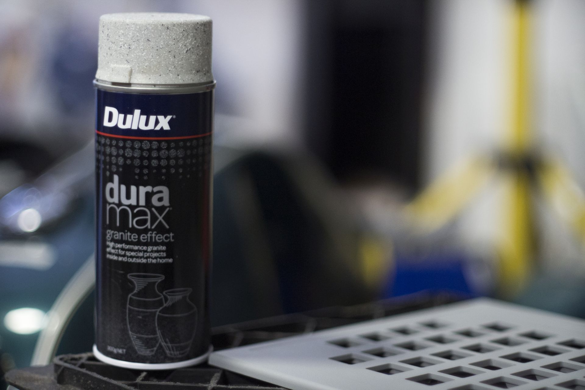

I think you should make it granite.
mmcdowell
17 Nov 2017, 16:06
I kinda like the granite idea! Sacrilege?
