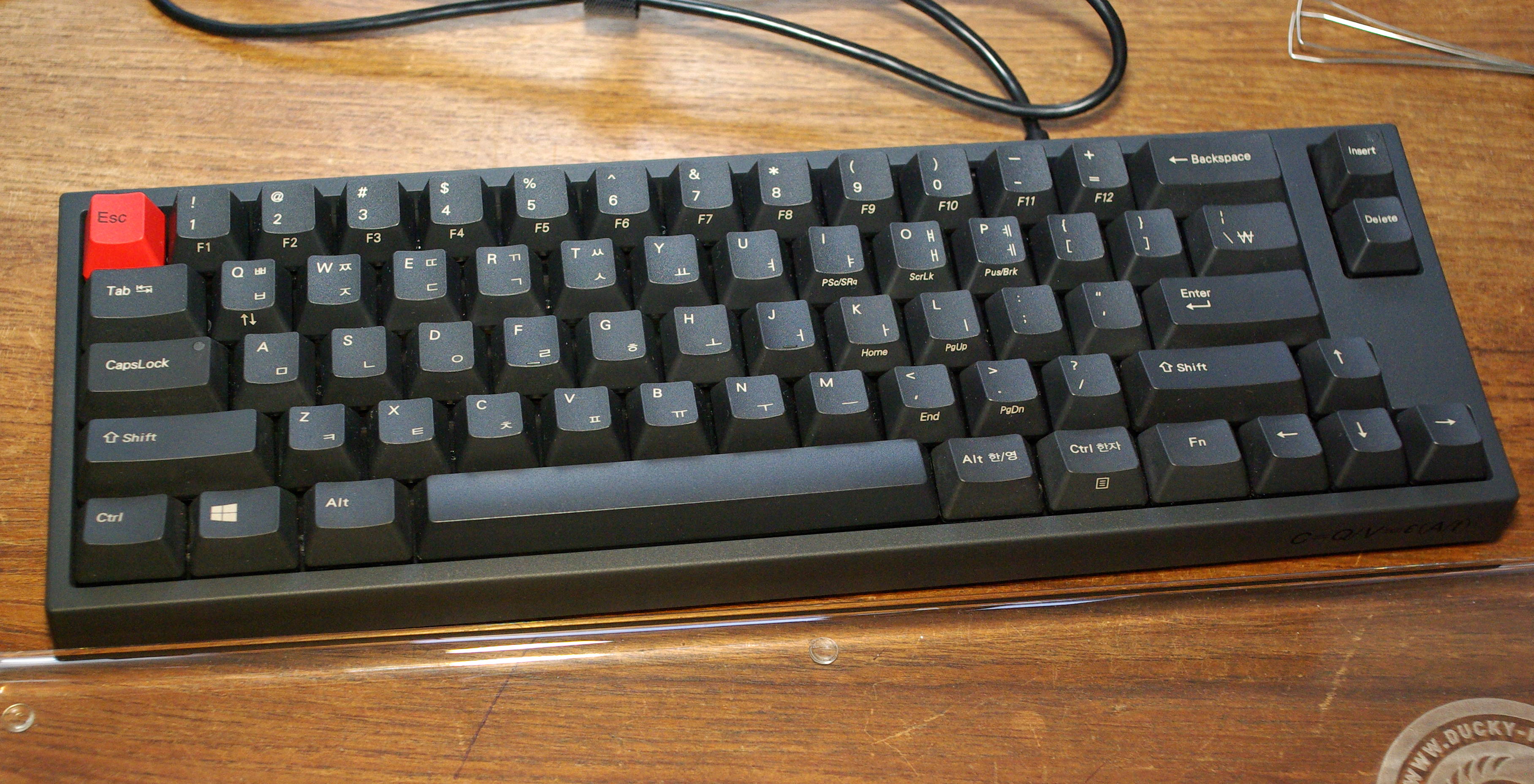

As per the title... I have a leopold FC660C and I would like to get a L-shape mini-USB->mini-USB(or even micro) so I can connect it to my devices in L-way, instead of straight, while also relieving a bit the strain of the continuous plug/unplug on the port which is directly solded into the PCB and prone to wear/failure. If I have the L connector I will be wearing the adaptor instead of the port itself.
But so far I ordered 2 different L-shape adapters and both were too short for the Leopold (which has the port quite recesed in the case). If somebody has one that is working fine with the Leopold, could you please share brand/model or link where I could buy it?

I haven't seen one adapter that fit.
Only L shape cable can fit, so you might as well get one of those and maybe not unplug it as much if you're concerned about wear.

Actually, I managed with a bit of cunning and a cutter! :)
First I took this one, because it is made of relatively soft plastic:
https://www.amazon.co.uk/gp/product/B01 ... ge_o01_s01
Then with a cutter I eliminated about half mm or so, cutting the plastic right to the edge of the connector. It is a perfect fit. There is still the tiniest space left as light still pass between the edge of connector and the case when plugged to the very end.
Now the problem was that most USB mini connectors have a bit of bulge on the head that would be a problem with the connector so close to the case, so I had to get a cable I could take the bulge away with the cutter, so it had to be of soft plastic. I used this one and worked great:
https://www.amazon.co.uk/gp/product/B00 ... ge_o02_s00
Hope that works for you all too. Cheers
