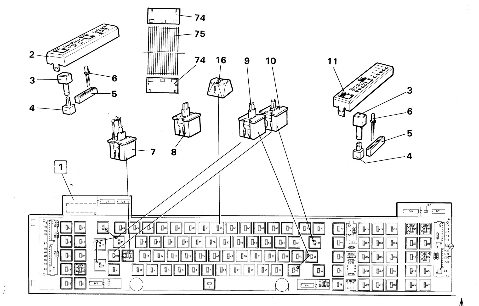

Strange keyswitch you have on your german speaking machine, never seen on a Facit typewriter, they always used this one photos-videos-f64/facit-8111-2-typewrit ... ml#p395390
Perhaps did they change for a cheaper model at the end of the production? What is the serie number of your machine?
This is more than an typewriter and an calculator, this is a invoicing machine, the right part makes all the calculations needed and stores the results in memory. There are 61 free memories called Constant (00 to 60), 61 to 84 have a pre-defined use: the date, invoice number, the column to print this number, how many lines to print, how to calculate % en which rounding ... The typewriter part has alson text memories under each letter (acces with PHRA+letter) as the 8111 of Haata.
The key I is for working with the invoice section
The key K is for the Constants (memories and program from 00 to 84)
The key T seem to be for an automatic printing of a bank transfer if attached under the invoice: filling of name, address, bank account, amount to pay ...
:idea: The attached PDF could help you to customize the keyboard
Facit Keyboard 6480.pdf
Keyboard Facit 6480
(241.53 KiB) Downloaded 1290 times

Production date February 1984, really strange, the service manual including the spare parts was printed in May 1983 and lists SKFF keys. I worked for Facit till early 1986 and have never seen the SKCC on typewriters, wel on their calculators.
SKFF are really good quality keyswitches, even not used for 15 years they're working fine and if one seems to give more than one contact, depress them a few times and it will work again, it was presented in training course as a self cleaning contact.

Sorry if it's unclear, I apologize for my bad English.
No, all the switch parts are not listed, just the own Facit parts number for the whole switch and a few words for the description, there is no make or model.
The PDF was only for the electronic parts and their position on the PCB, the mechanic parts are on another page, see the PDF with this post.
SKFF is the right model it's confirmed by Chyros, see the video on this post photos-videos-f64/facit-8111-2-typewriter-t12424.html , starting at 1'30".
Facit Keyboard 6480 mechanic parts.pdf
(326.51 KiB) Downloaded 1364 times
28 Dec 2017, 23:58
No, I mean, we don't know that they are called "SKFF series". We have very little official Alps documentation. "SKFF" was derived from a model number on a Canon typewriter keyboard, and I wasn't entirely clear on whether it should be "SKFF" or "SKFB", but the former seemed rather more likely. (Normally model codes have an extraneous "F", but this seemed not to.)
