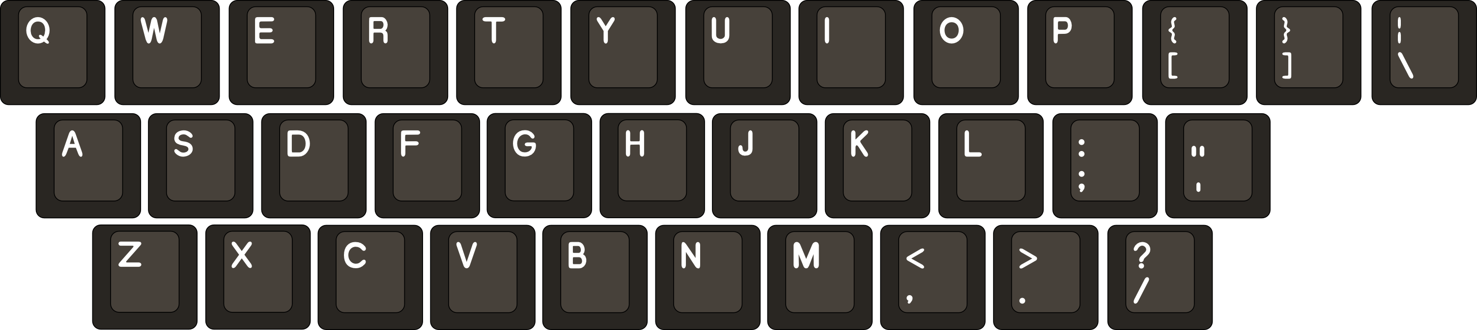

Over at GH we've been working recreating the Dolch PAC 6* set of keys and recreating the original vintage Cherry legends (which will be available for any future group buy)
Any input on the accuracy of the legends is appreciated.
dolch legends.png (128.03 KiB) Viewed 3301 times

Are you going to order a full set with costum legends? Won't that be expensive as hell?

They look good. definitely not azerty but good enough ;-).
You already have a true set ?

I still haven't been able to find a Dolch PAC 6* but I haven't give up yet.

the font in what you have shown some of the letters are too skinny. look at keys like the W and B. They are wider in the original cherry font.
except your Z, it is too wide, haha.
it looks really close though.
