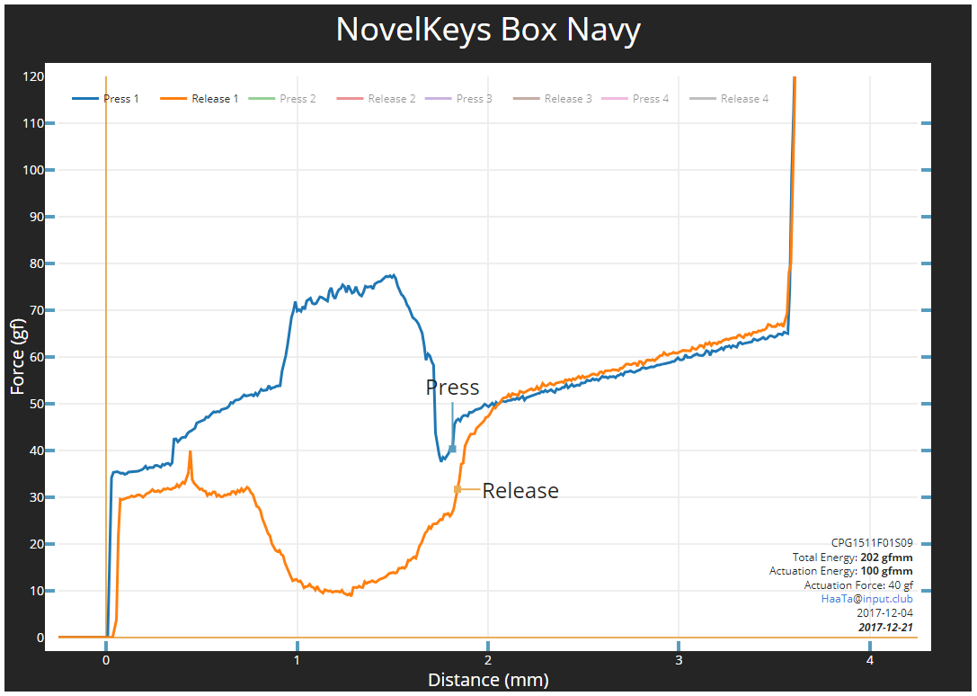

Reasonably smooth, punch through the table downstroke feel, huge force drop on the upstroke. I like them, but they're not for everyone. Regardless, the sound is awesome.

Can you do a nickel test? I can't find force curves on these anywhere.

Here's Haata's measurement.

Thank you! I was looking under Kaihua, didn't see Novelkeys there. So that's kind of what I was expecting from a quoted 60g activation I saw. But then I saw somewhere else talking about 95g weight, which seemed insane.
That looks right up my alley, so I'll try to get these when they come into stock.

Hmm... The plot thickens. That graph has been superceded by a very different one at the end of December. The new one shows a peak force of 80g just before the break.
https://plot.ly/~haata/415

Techno Trousers wrote: Hmm... The plot thickens. That graph has been superceded by a very different one at the end of December. The new one shows a peak force of 80g just before the break.
I posted the old graph -- the new one is more accurate. My fingers back that peak force up. Thankfully it isn't all that bad after using an M at the office for a while.
If you're looking for a more balanced switch, I recommend Kaihua Box Heavy Pale Blue. It doesn't have the same aggressive click of the Box Navys, nor the ridiculous tactility, but it definitely is better than other modern clicky options that I'm aware of.

Yep. But they feel more refined overall due to the reduced upstroke tactility. Peek at Haata's graph of them vs. Box Whites and you'll see what I mean.
Techno Trousers
100,000,000 actuations
17 Jan 2018, 00:10
Yeah, the initial hump to get the bar started over the stem bump looks smoother for sure. I'll give the box pale blues a shot. Thanks for all the advice!
