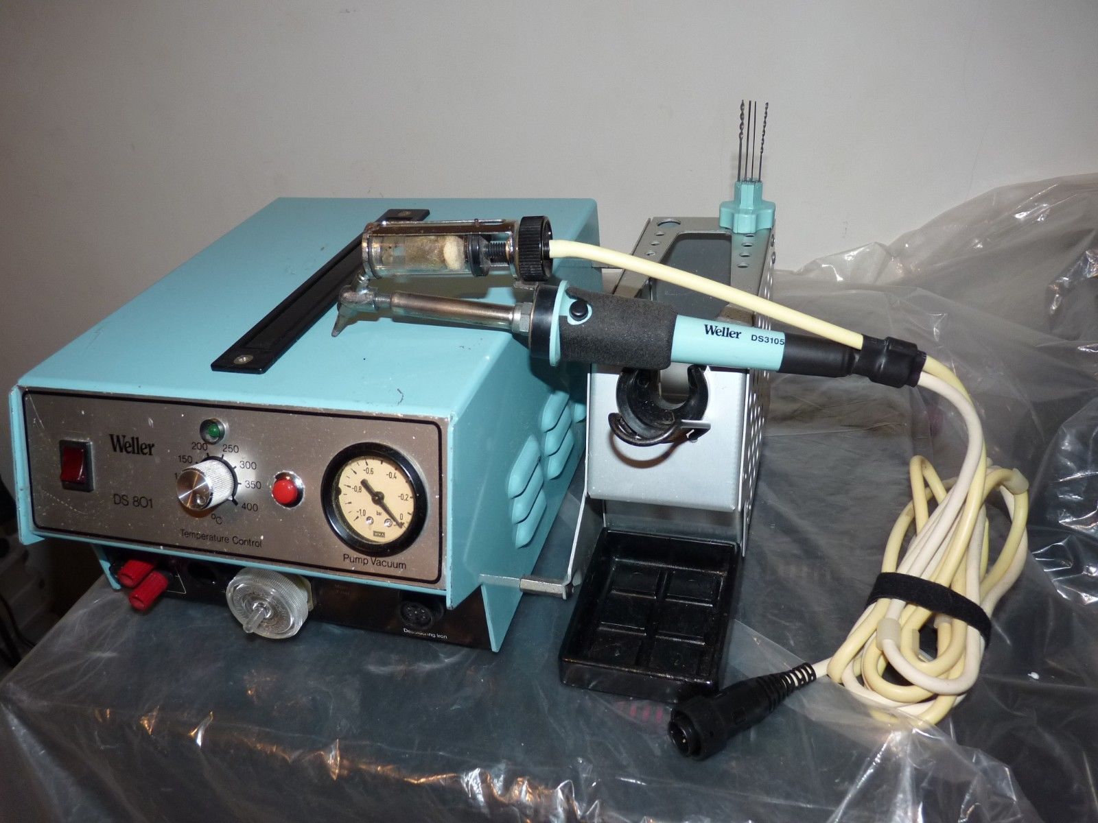

Thats not a de-soldering tool
I got this bad boy on ebay
THIS is a de-soldering tool :)
Bent pins is a massive issue with alps its bloody anoying, why!!! WHY!!! there is no need for it.

LOL! I had that (similar) Weller, till it was stolen from me. I still have the "manual" version, turkey baster style, but very similar iron head. It is horrible. I'd rather wick the entire board, than use that manual Weller.
My AOYUE station does quite nice for about 10% of the price, plus it is multi-function; iron and hot air as well. I've used it for about three years now with 0 problems (now it will burn to the ground). However, this is a build thread, not a tool thread.
