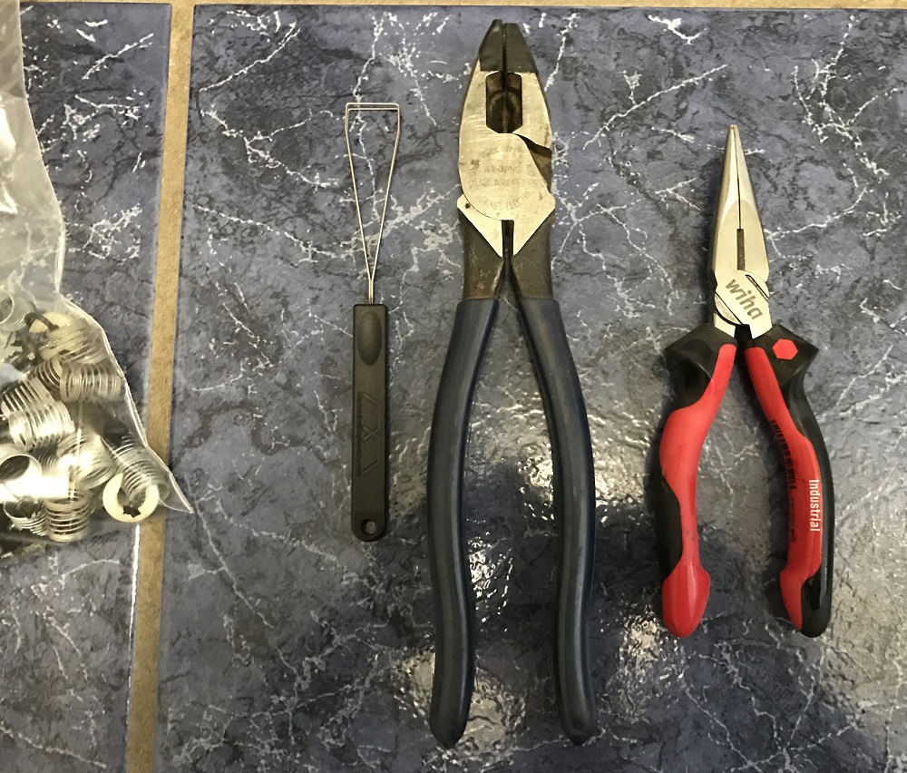

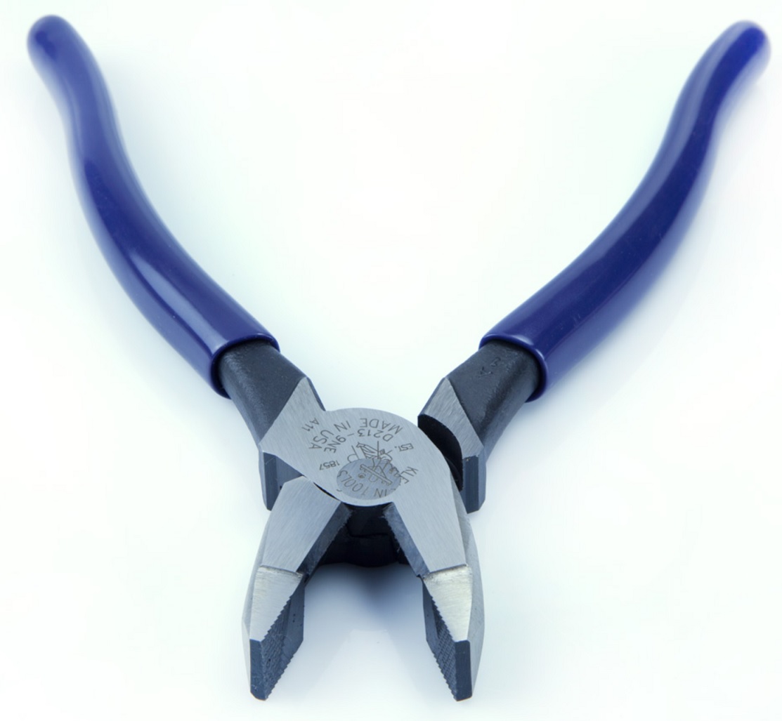

04 Apr 2018, 03:23
I use just a single pair of pliers, but not just any pliers. My first attempt I used some smaller pliers, those hardly worked and would scratch up the stems. After a few stems I located the largest pair of pliers I could find, my 9'' Klein linesman pliers. The large pliers worked great as the large jaws provided the greatest purchase on the stems. I wrap a little electrical tape on the jaws and they still have plenty of grip to pull the stems like butter, without scratching them. When pulling the stems I use my feet to stand on the edges of the metal plate to get the best leverage. I have done a few now using this method with great results.

codemonkeymike
04 Apr 2018, 14:33
Thanks for all the hints guys, I used JP!'s method and worked quite easy. Found a pair of 9inch pliers in my toolbox and they worked just fine. They are actually the exact ones in that photo you posted
