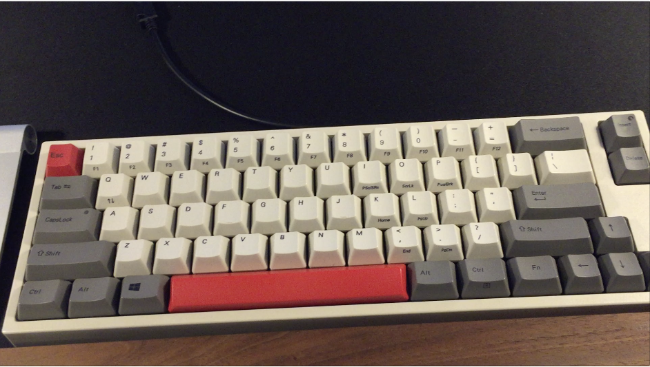

Hi guys,
After experiencing this problem for a fourth time i decided to ask for help as i can't figure out the reason for it happening.
The board is re lubed it with a mixture of SuperLube oil; partnumber 51004 and SuperLube grease partnumber 21030. Checked if the Hypersphere rings were ok and everything seems ok. But after a while this happens so i already swapped the cmd key (windows) dome with an other one.. and it keeps returning. the letter i is also misbehaving.
The lube and oil where recomended to me by Hypersphere and it seems ok for the most part.
But i did notice that i dries up after a few weeks that's strange..
So i will be buying sum "Tribosys" lube from meykeyboard.eu
Not cheap at €12,50 for 5ml plus shipping..
if anyone can tell me what's going on here with my topre board i would appreciate it..
next time i'l try to film opening up the board. for now here is the youtube link.
https://youtu.be/2v9Bd83spCY
my FC660C

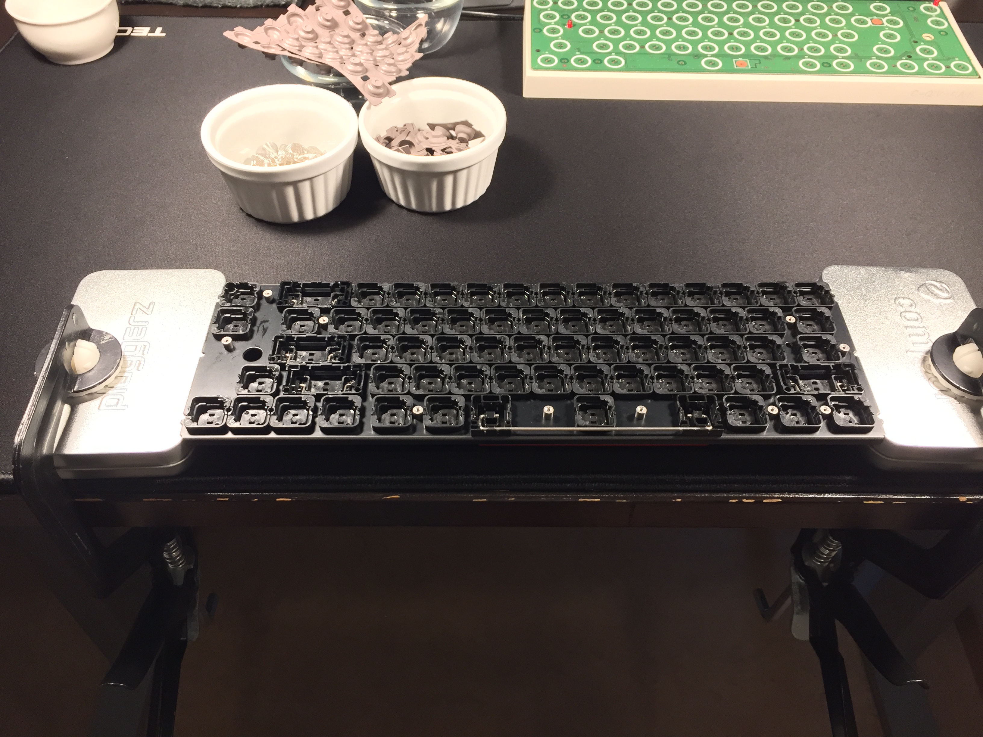

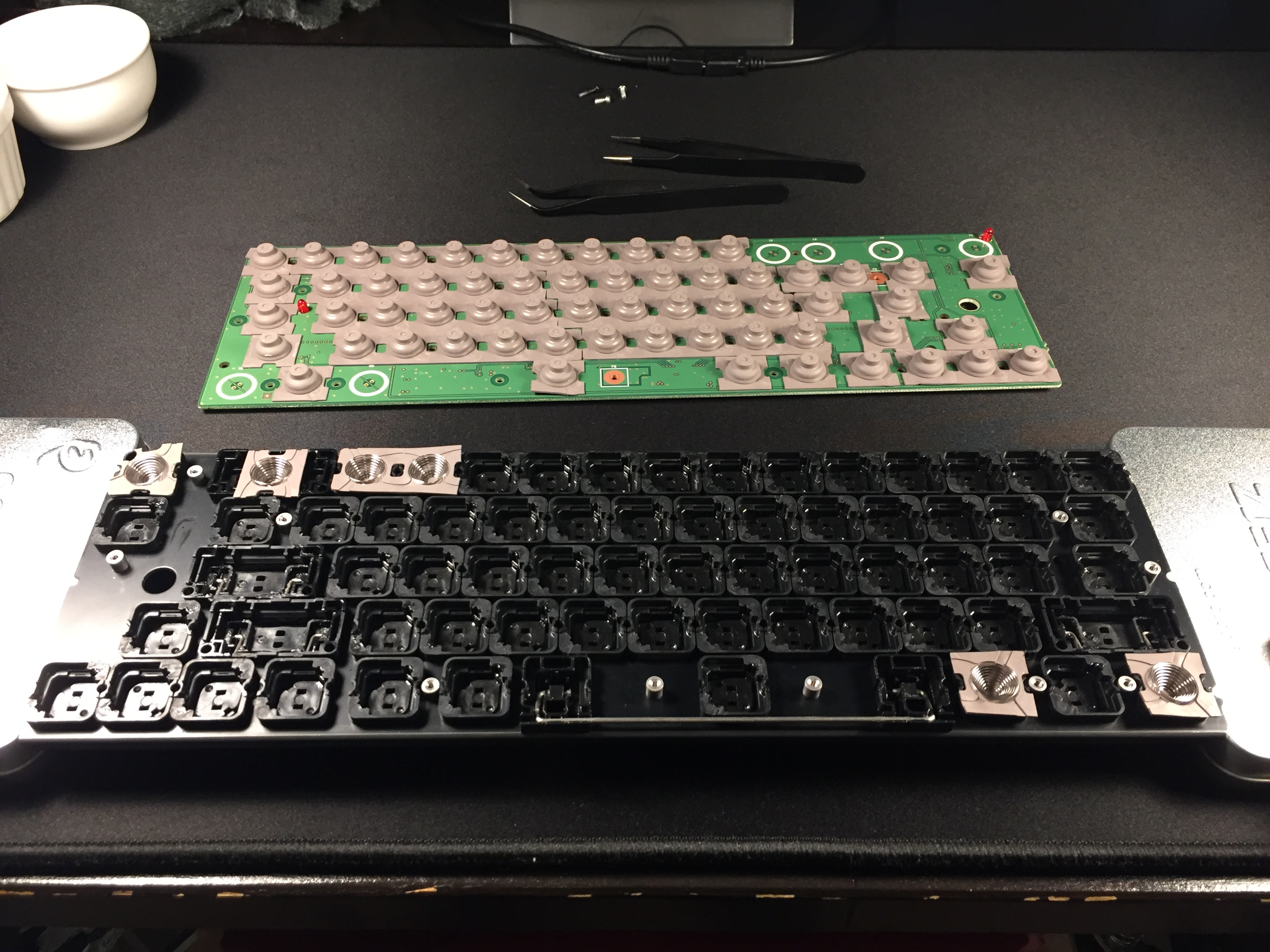

So i just finished opening my FC660C two times...pffff
the window key (normally alt key, swapped them) is now ok.. the letter i was 7th key from the right was a big sheet so nothing i could there without having to remove the entire sheet. :o
so i touched the sides of the dome hoping that would help..
one strange thing i did notice , when i place the board with domes back on the sliders being as careful as i can be.. the screw hole's don't align 100% so i end up moving my board when it's laying flat on the sliders that could be the reason why i'm experiencing problems.
Don't know how to avoid that..
i have a standing desk so i raise the desk up while i put the domes back on top making sure everything is aligned..
Strange..
Secure between two tins...
secure between two tins
Putting back a couple domes that are loose incl the misbehaving window key..
dome placement
dome placement

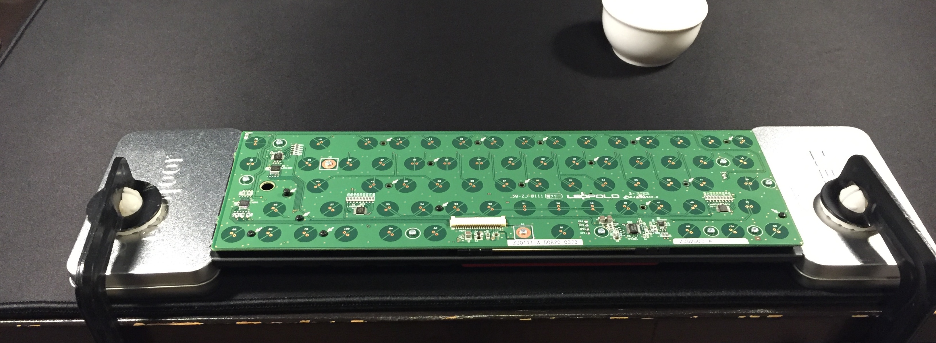

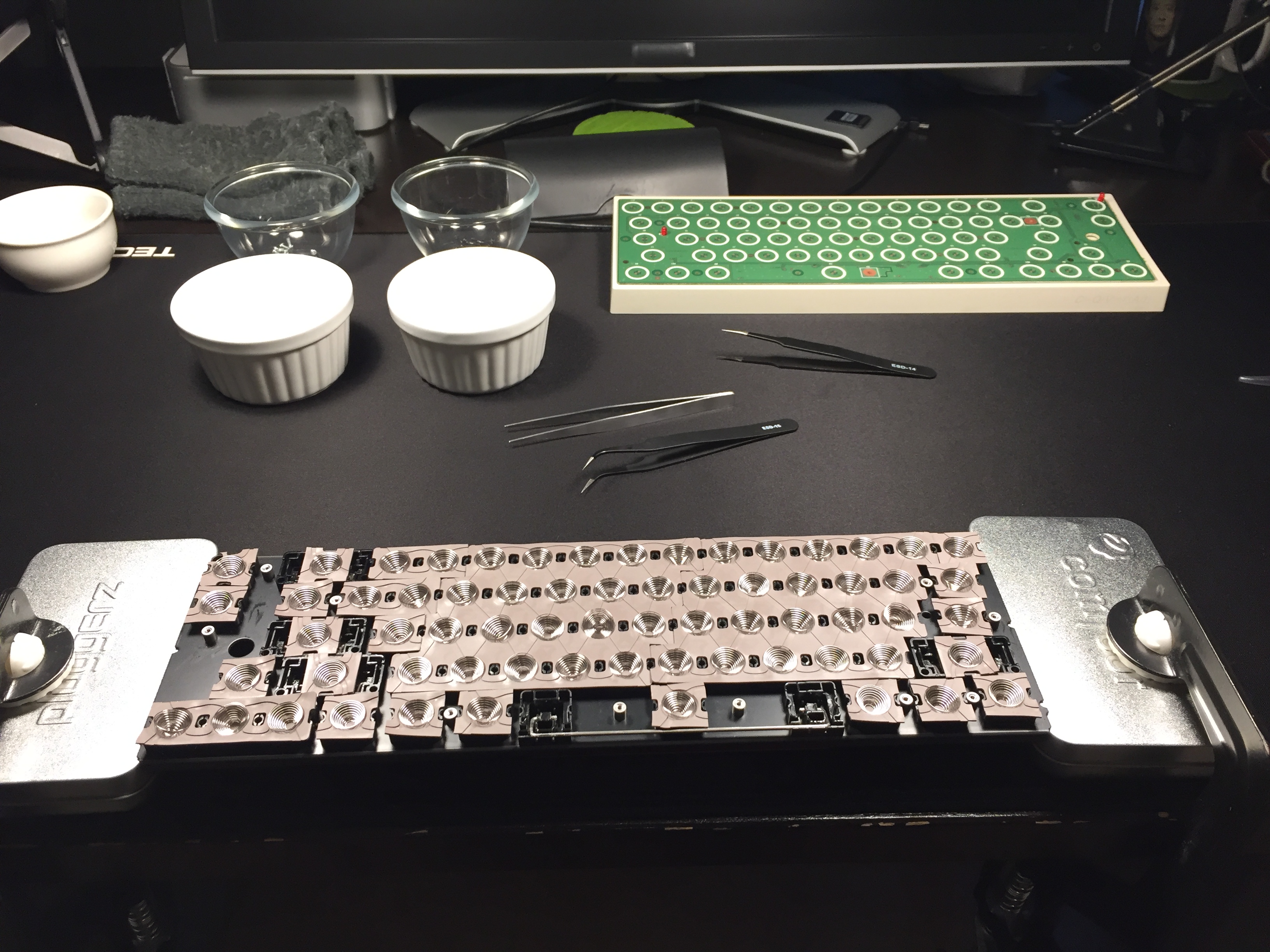

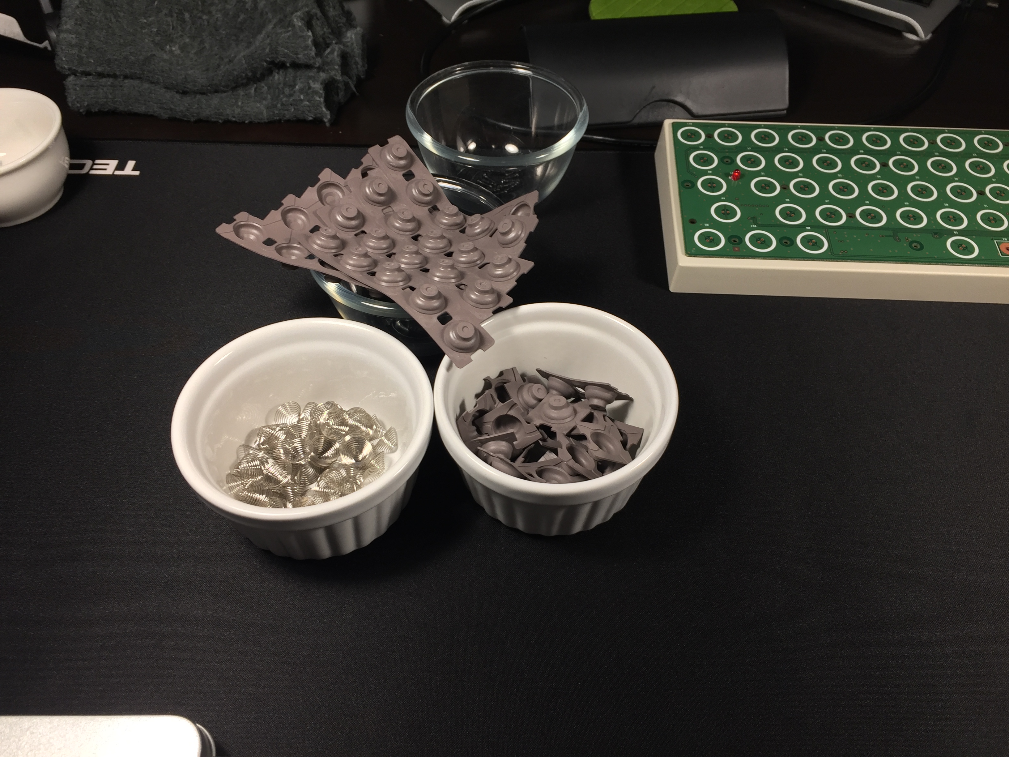

The Topre nightmare continues i spend a good part of the day trying to fix my Topre keyboard without any luck..
Since the letter N and I started to misbehave , aka not feeling right and making strange noises i decided to pull the sheet from the board :shock:
I then preceded to carefully place the two large sheets and the smaller individual domes back making sure everything lines up correctly..Placed all the springs back...and started to screw in the silver screws and a couple of the black ones and i decided to test i there where any problems?? :|
Well there was don't recall which key but one sounded absolutely awful i could even hear the spring..
So i reopened everything the only problem i could detect was that the two domes looked like thy didn't fit 100% no matter what i did they seem to be larger an overlapping at the top.. where both sheets meet..just the top..
Also every time i place the pcb back the screw holes don't align perfectly and then i need to lift the pcb up so it aligns perfectly ..that could be contributing to the problem...
The same thing happened the first couple of times when practically all domes where still glued to the pcb..
So final result.. i GAVE UP !!! i placed the domes back.. left the springs in a cup screwed all the damn screws back so i wouldn't loose them put my hasu controller in a ESD save bag and the board back in its box..
