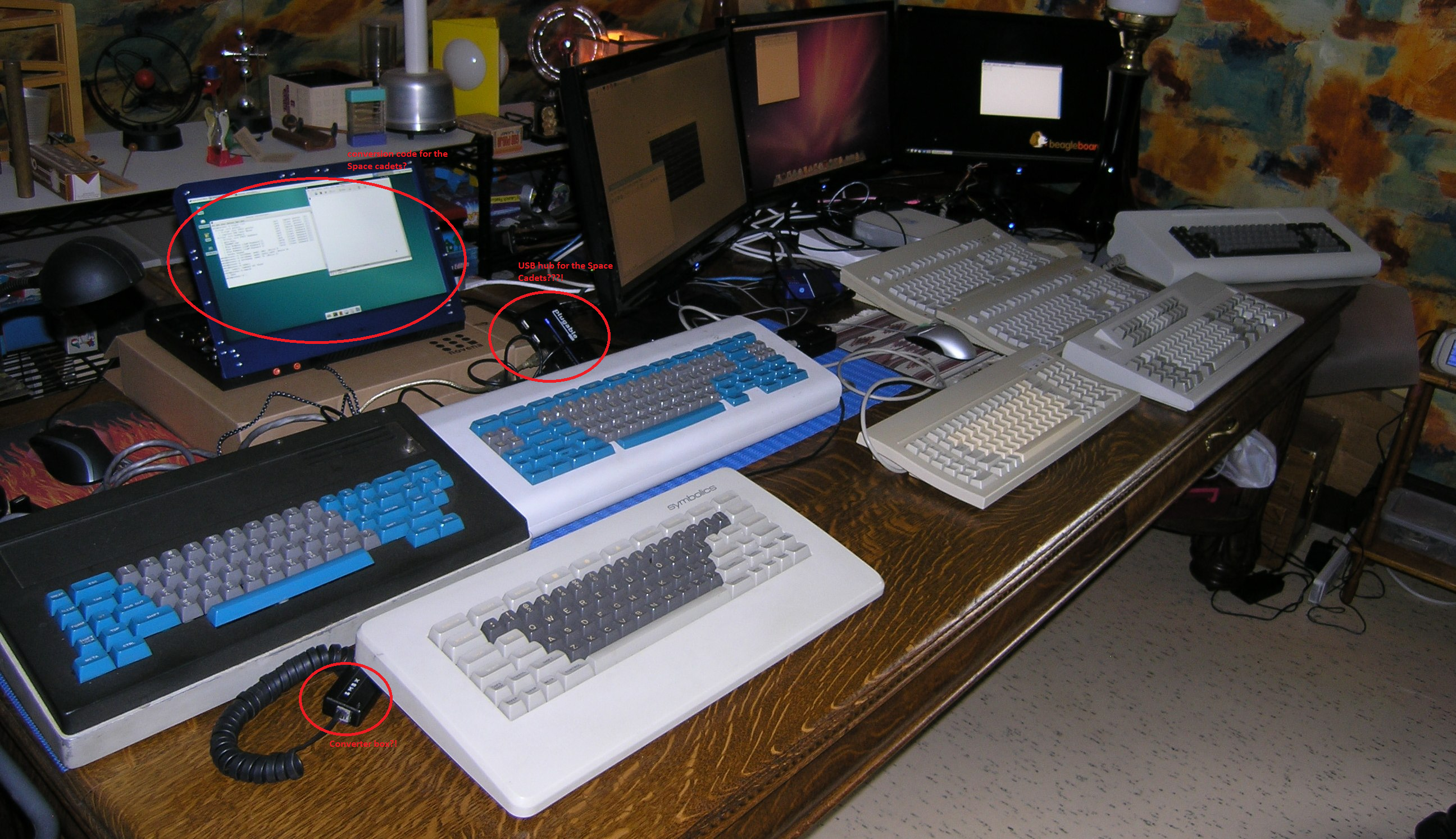

Space Cadet and friends, oh why be so expensive :(
photos-f62/80s-keyboard-party-t10963.html
