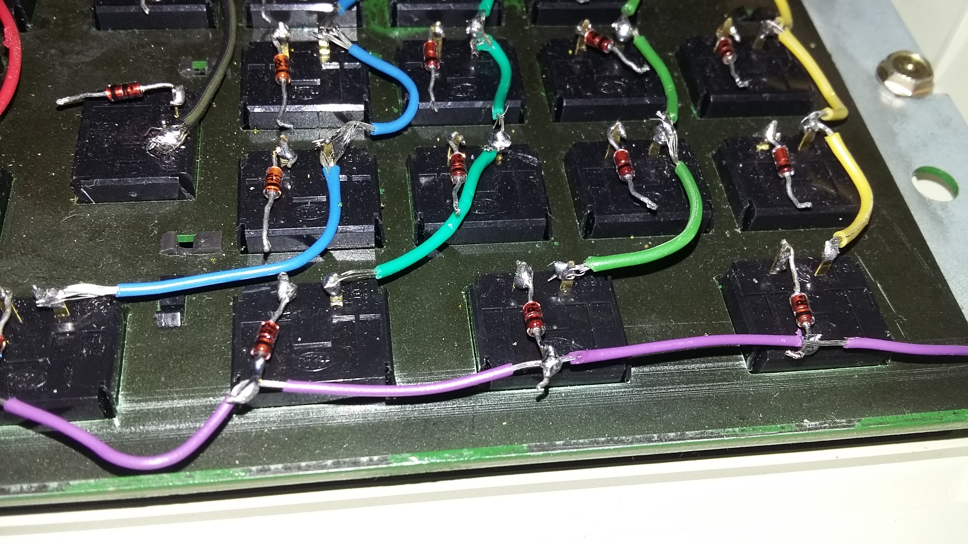

Hello guys! A few months ago, I started working on this handwiring project on my Zenith ZKB 7. I followed both Matt3o's and some geekhack guy's tutorial, though, and now I'm completely stuck and I'm very guilty that I haven't finished it. I had to desolder the resistors from the keyboard because I couldn't afford new diodes, but both tutorials use brand new ones that were soldered together! But yes, I'm stuck.
I also haven't been able to figure out which matrix to solder to which pin on the Teensy++. It's like that every tutorial just glances over that part, or I'm a dumbass (latter probably). EDIT: It doesn't actually matter, you just need to decide what each line does in software ;)
So if anyone has experience with this stuff, could you help me out, please?
Where I'm at so far.
14 Jul 2018, 14:34
Your diodes are pointing upwards - wires should go vertically and diodes should go horizontally. Use jumper wires to wire from the end of a diode to the next one.
green-squid
14 Jul 2018, 15:50
scottc wrote: Your diodes are pointing upwards - wires should go vertically and diodes should go horizontally. Use jumper wires to wire from the end of a diode to the next one.
Like this?????? :?
zrrion
15 Jul 2018, 10:07
That looks good, yeah!

Barrelling into a pretty sizeable soldering job without a clear understanding of the detailed objective? I salute your misguided enthusiasm! Been there and done that sometimes myself.
Zrrion is right, I think. The key is to do what Matteo did. Be consistent. Point those diodes the same way (get comfortable with cathodes and anodes) and be sure each switch gets one, in a parallel hookup to the wired matrix. Serial diodes = NOPE.

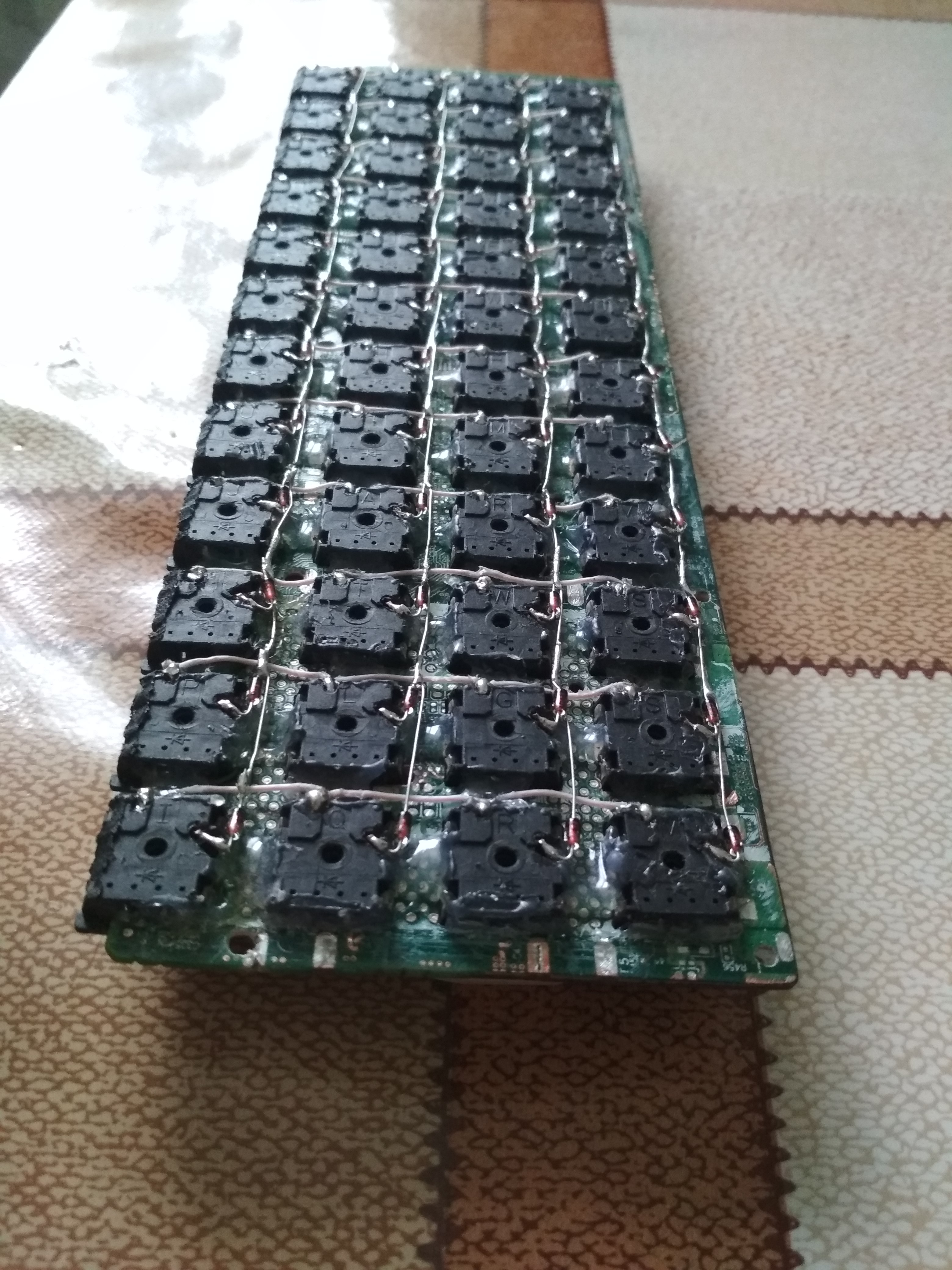

While I was handwiring - I was inspired by this 2 posts:
http://blog.roastpotatoes.co/guide/2015 ... -a-planck/
workshop-f7/brownfox-step-by-step-t6050.html
Main points that I have remembered - pins orientation goes up, diodes orientation goes down from the left pin, diodes are rows, right pins are columns.

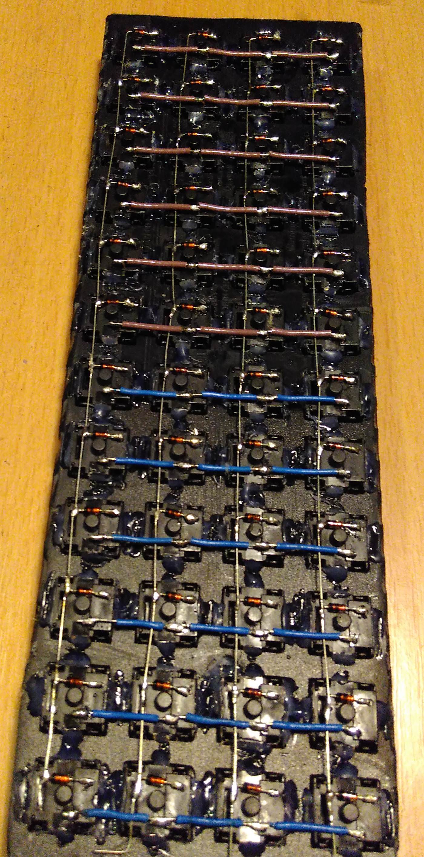

Here are results of my first and second attempts of handwiring:
Yes, second one is about "how to make low profile with standard MX", and I haven't implemented "main points that I have remembered" here ;)
Both attempts are successful and keyboards are fully functional, only thing is that I dismembered first one coze I wasn't in need of 2 planks :)

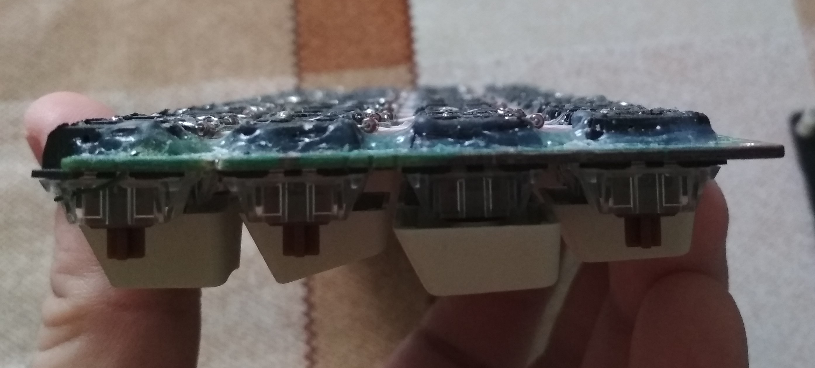

16 Jul 2018, 12:58
Nice job on the low profile. Looks ugly from below, but when you see it from the side all becomes clear! What case did you put it in?

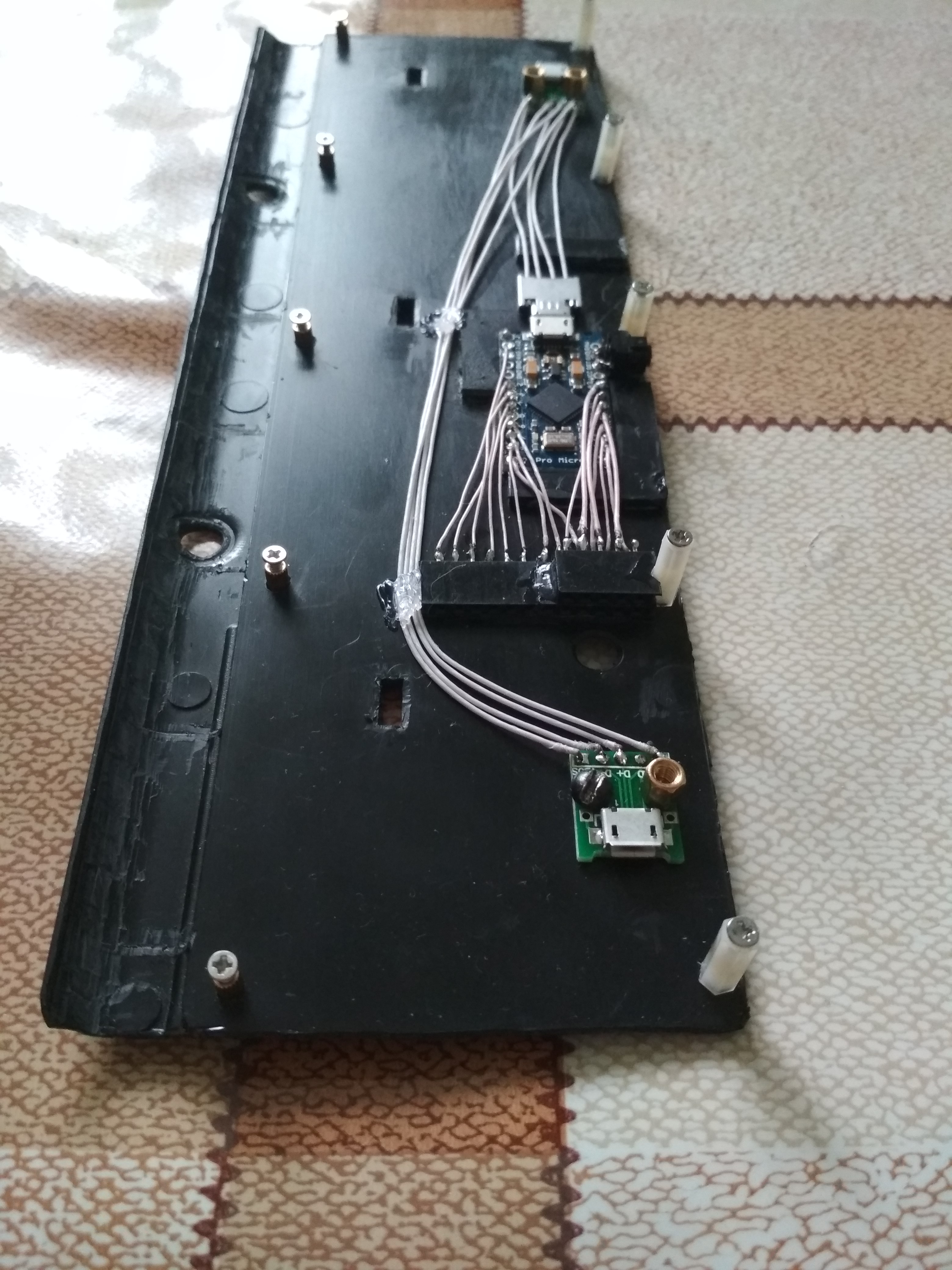

16 Jul 2018, 13:16
Muirium wrote: Nice job on the low profile. Looks ugly from below, but when you see it from the side all becomes clear! What case did you put it in?
It doesn't have any case, bottom plate is just rectangular piece of bottom housing of some cheap plastic keyboard.
Just used standoffs to hold it together.
Standoffs are of different height to have inclination and to have room for controller and USB extenders.
Upper part is connected to the controller with 2 lines of pins.
And 2 USB extenders exist for case when one will be accidently ripped off :)

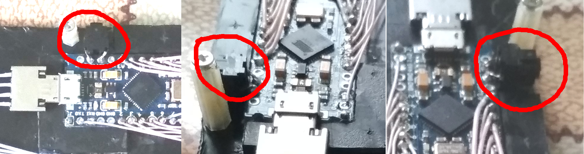

Almost forgot, it's hard to see on previous photos, but there is a reset button too.
I took it from some veeery old ball mouse and soldered right into GND and RST pins on controller board.
