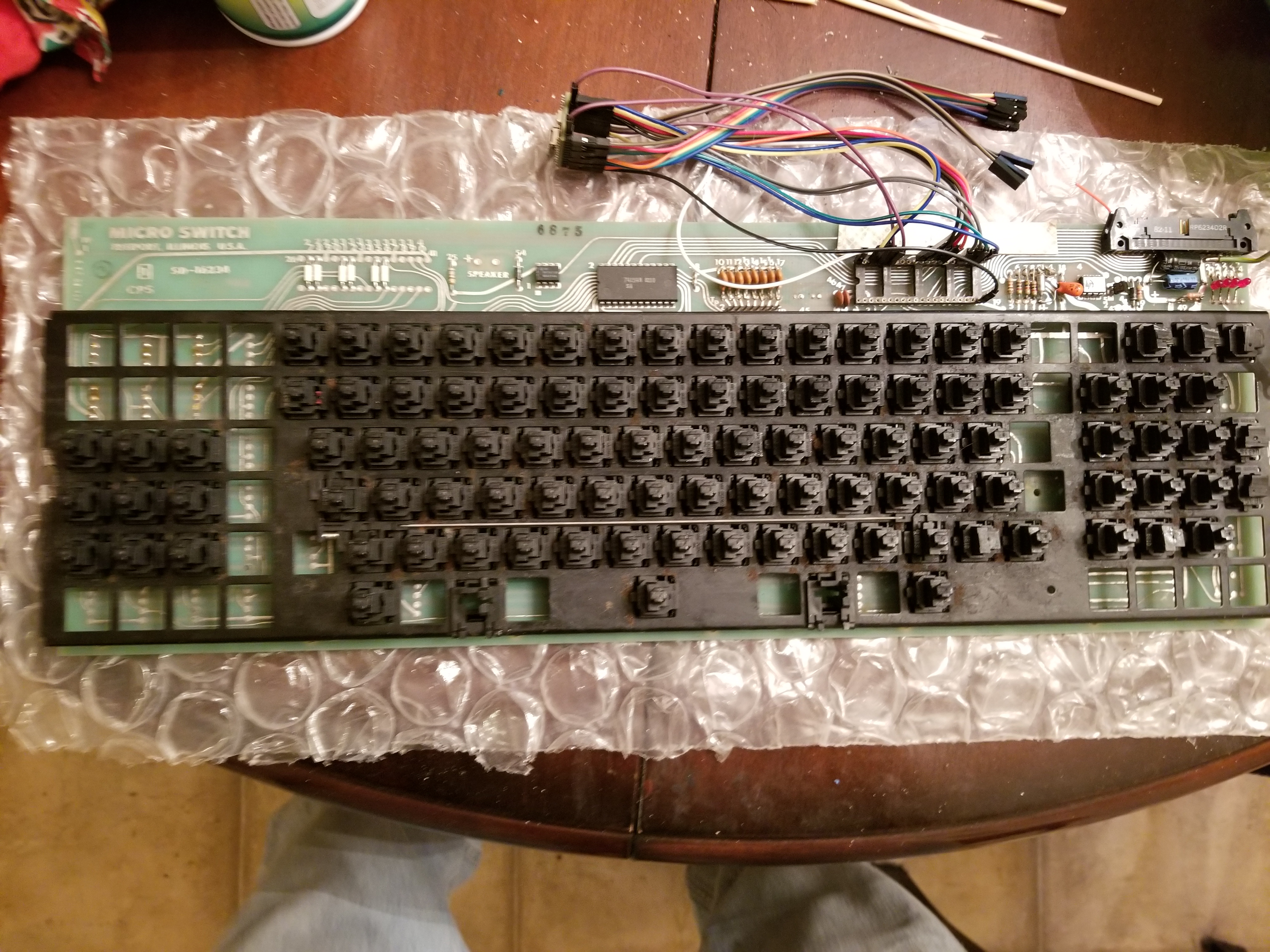

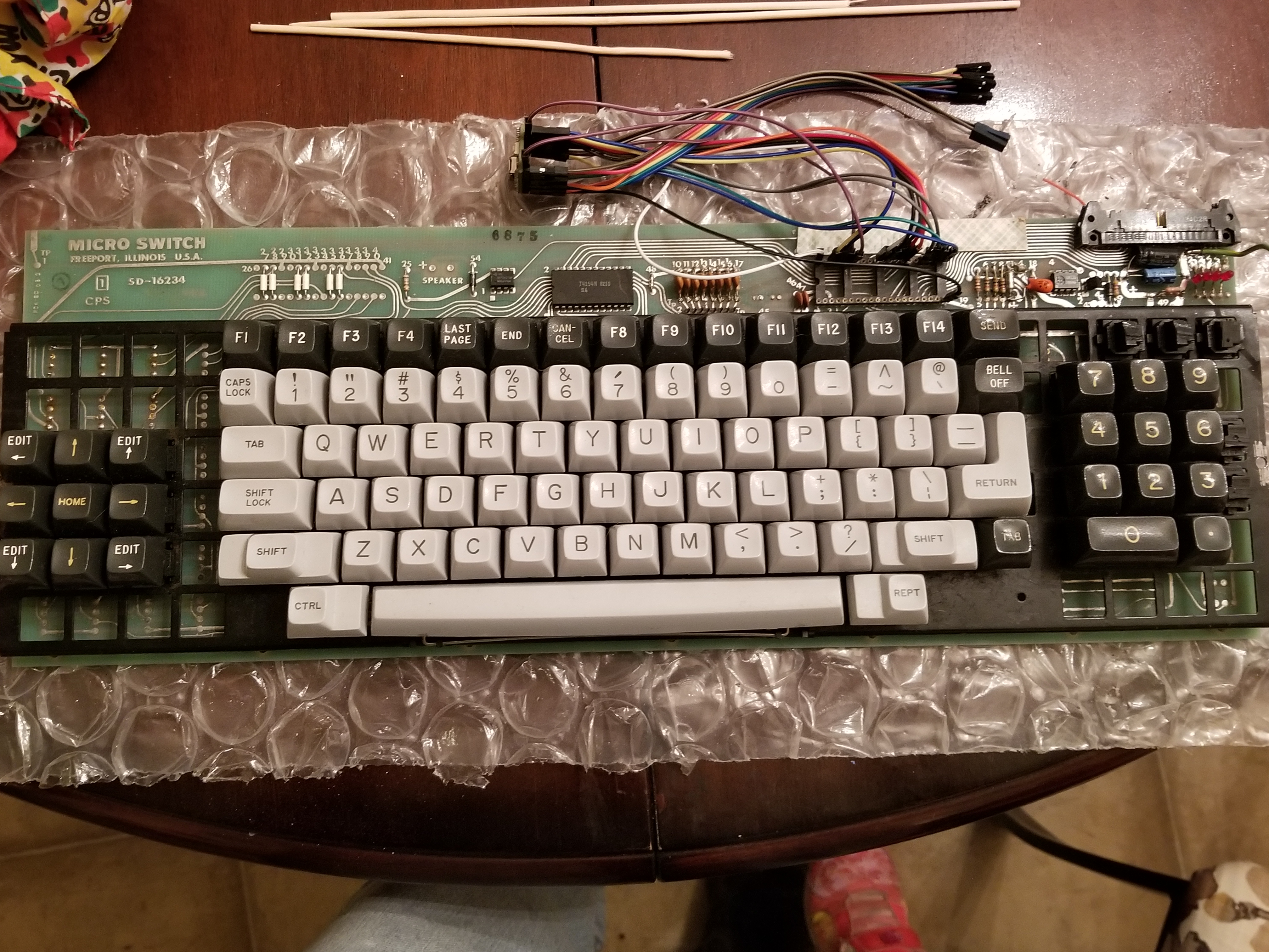

When I opened the box this is what I saw,
When I depressed a plunger it slipped down with all its promised smoothness, this is the closest you can get to touching an angel I remember thinking. The deep clunk of the switch bottoming out was satisfying (something I always do on linear switches). I can honestly say it was one of the few times that I felt that the hype was justified.
This is what she looks like naked, I love the modular mounting system that would allow for awesome customization as far as I can tell there is no reason why you couldn't turn this into a Space Cadet type. I would just need to get more switches and have a keycap set made or just accept having a motley assortment of keys.
After carefully going over the board, I began to write down the part numbers for the different chips that had been placed on the upper edge of the PCB. A few of the chips didn't have anything to do with the actual operation of the keyboard, such as an optical driver for a light pen.
I used the datasheet of the TI 74154, which is a four to sixteen line demultiplexer to determine where the power and ground lines were, double checking myself against the big caps just below the original cable connector to be sure. I had soldered some female connectors onto a cell phone charger and I used this as my test power supply feeding the board with five volts dc.
I had already used the Multimeter's continuity tester and I really can't stress enough how much trouble and time it saved me. I think you can get away without having an O-scope but you can't get away without having a good Multimeter with a continuity tester(The louder the beep the better). Such a tester lets you with no power supplied to the board, place a probe tip on say a leg of an IC while placing the other on the connector pins to see how the connector is laid out.
Then using my Multimeter, I checked the eight test points that I had deduced were tied to one of the eight rows which I realized each corresponded to one pin on the cradle that had held an Intel 8748. I felt at this point I was making progress.
But my probes showed that there was zero volts on the test points with FIve volts supplied to the board. I checked various points on the board and found that they all had power. I asked my wife to press down keys so I could hold the probes steady on each of the test points in turn which I hoped would produce a voltage when depressed, still nothing.
Feeling defeated I went back to the SD Keyswitch document and found that someone had scribbled a diagram of a four pin hall effect, they had even labelled the pins correctly and I could clearly see that one of the pins was an input.
In a flash of insight I reached for a jumper and applied a voltage to one of the inputs on the de-multiplexor and once again probed the testpoints but was disappointed yet again.
So I rechecked the 74154's datasheet, combing through the short document. I laughed aloud when I realized my error. There were two enable pins on this chip, one had already been tied low but the other had a trace to a pin on the 8748. So running another jumper from it to ground, I tried again.

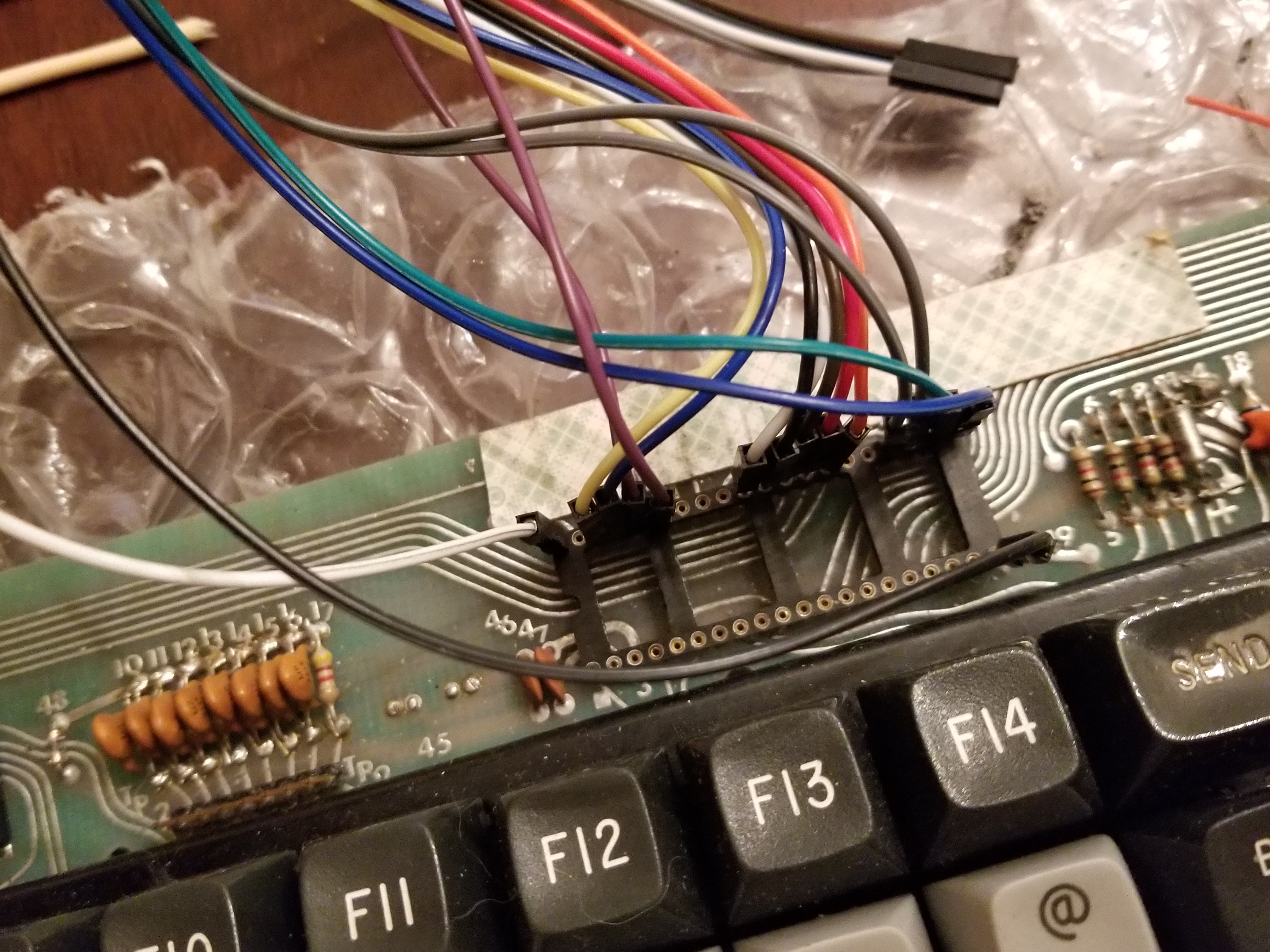

Powering up the board I used a jumper and applied a voltage to a single input on the 74154. My probe quickly found voltage on one of the rows and when I depressed a key the current disappeared. I released the switch and the current returned, if I were an athletic man I would have done a back-flip.

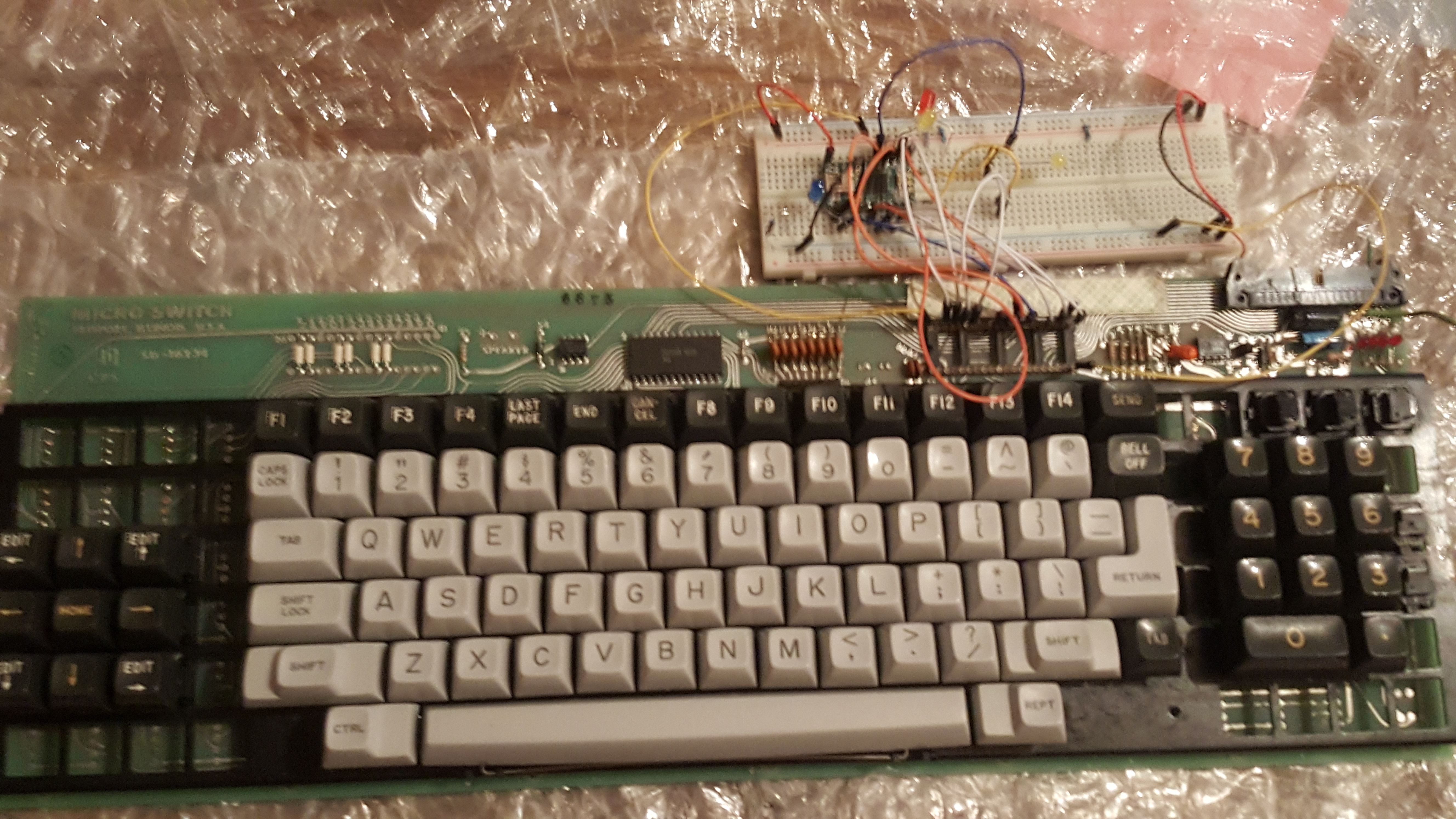

I hooked up everything with jumpers to my breadboard.
| 8748 pin | Teensy 2 pin | Signal |
| 20 | GND | GND |
| 40 | 5V | +5V |
| 27 | PB0 | Demux Strobe |
| 28-31 | PB4-7 | Demux Address|
| 21-24 | PD0-3 | Input |
| 35-38 | PD4-7 | Input |

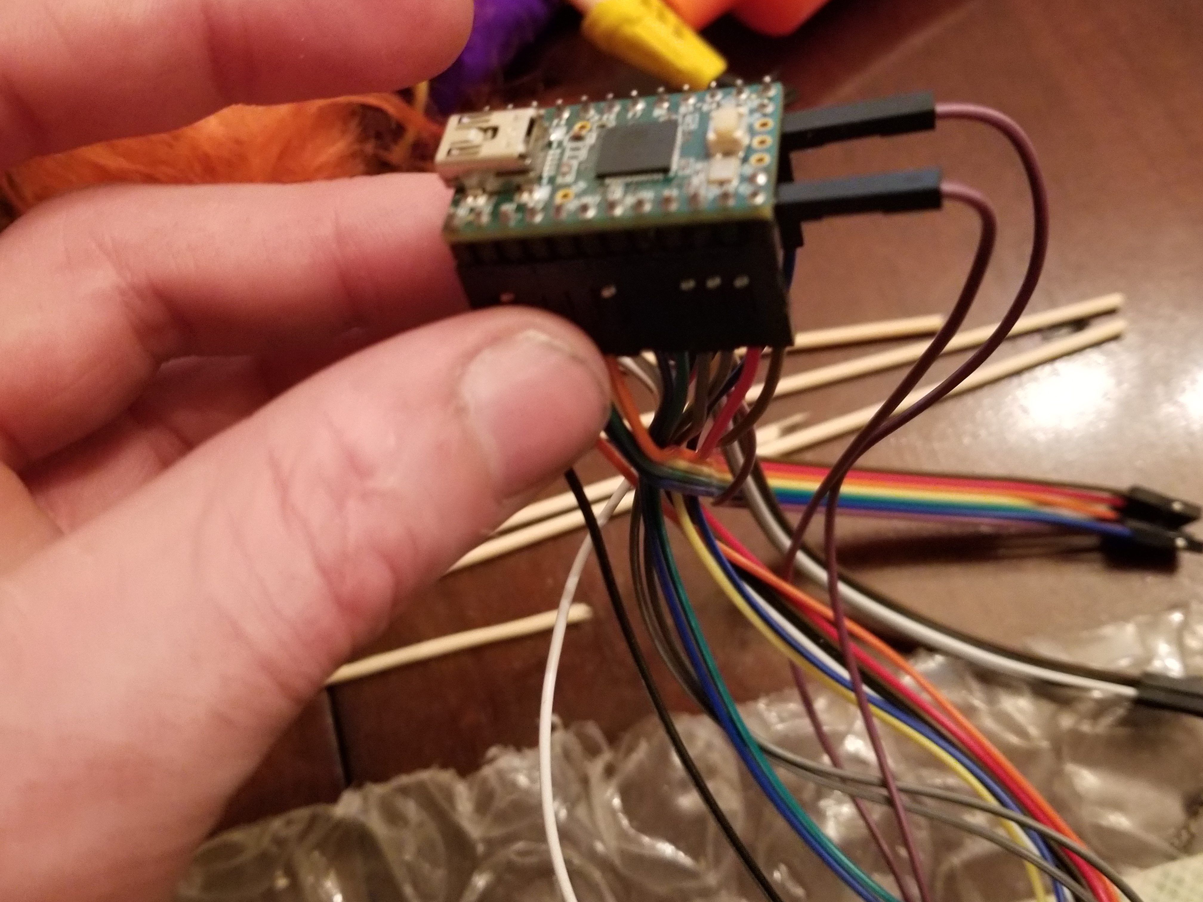

Once I had the driver up and running I began the laborious process of setting up my KeyMap.

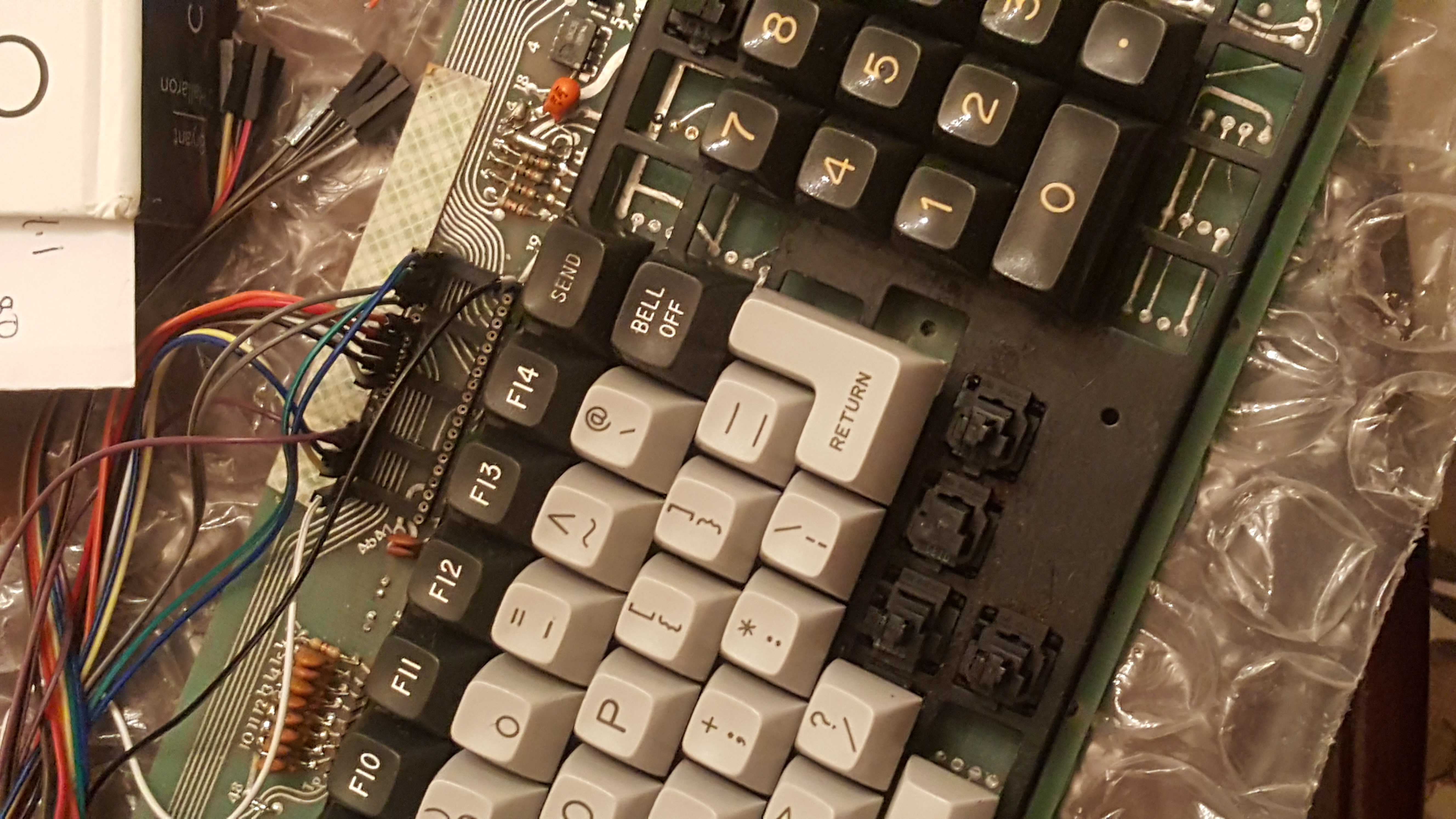

After finishing this up, I connected everything more permanently with male to female connectors. I hooked the female end to the header pins I had soldered on earlier. I then drove the male ends directly into the cradle that had already been attached to the board making sure everything was well connected. This finally brought us up to this point.
My teensy hooked into the old Micros cradle

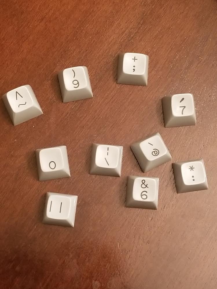

My main problem is that several keys on my board have unique shifts and I couldn't get the proper HID KeyCode for them.
This is something I've noticed on several MicroSwitch boards the open parenthesis is placed over the eight and the close parenthesis over the nine. There is no shift over the zero so this moves all the alpha-shifts one row over to the left.
There are in fact more than a few keys that are non standard and so you have to just assign them to something that's close or just use what that position would be on a standard board.
To me, this was unacceptable but after doing some digging I realized that there was just no easy way to make your own key shifts. There is a way, but I didn't think getting each person to patch their kernel was really going to be a popular solution.

You might be able to cheat with your non standard shift by making it a fn key where the layer has things moved around as necessary and has shift added to keys that need it to get capitals and whatnot.

My board is powered entirely by the USB. The space cadet was a three pin but I don't know if it has transistors on the rows. In the scanned mode you are only powering 3 or 4 switches at a time so you might not need any extra power source. I think Muirium has a board with 3 pin switches, we need to convert that board here is the link to the post
photos-f62/a-honeywell-who-dunnit-1983-t6296.html
And photo of that board

Awesome board, man I wish I had your collection you have some really awesome stuff. Yeah all the Micro boards that I have seen are almost all different, even as you were saying boards that are of the same type. All the diferent Silent TI configurations for example or the boards like the one that I have which seems to have been made or at least modified towards a specific purpose. Like my board has caps on the back between the VCC and the Ground on several rows. I assume this was to clean up the signal for some reason maybe because they were using the CRT light pen and it was attached directly to the boards PCB. Also my board has a place for a speaker but no speaker has ever been soldered on. I can definetly tell someone other than the factory has soldered on my board there are a few caps that they left really long legs on and stuck a piece of insulation on so they could reach between pins on the IC. That's one of the reasons I really love working on these old boards because in a way its like being a detective and you are reconstructing the mind of an engineer who designed something that is truly amazing.
I fixed caps lock and the locking shift works now, I updated the git so you might want to get the latest version so you can have a fully functional board at least, I'm still working on the non standard shifts and the somewhat automated keymap generator. Hopefully your keymap will be similar enough to mine and you might not need to do much to it.
This is how I figured out my keymap, I set all the places to be a character 'o' and then I changed the first ten to the first ten letters of the alphabet. Then I compiled the code an loaded it on the teensy. Then I would depress keys until I found an A or a B whatever and I would see which Index that was in the Array and change it to the proper Keycode. For example the A might have been an X I would then change the A to an X, after I found all the keys that I could I would recompile the code and double check myself. Then I could move on to the next ten changing them from O to A through J. I just repeated this process untill I was done, after I had they keys mapped out I went back and any letter 'o' that I had left I changed to a nokey which is mapped as a 0.

Just count how many possible spaces there are on the keyboard I used 128 which is just the rows and cols with keys. But I think the whole board has 6*24 or 144 possible key posistion. So just change the array size which is
  static const KeyInfo Keys[128] PROGMEM = {
Just change 128 to 144 or whatever size you need then update the array.
Have you tried out my hex? I'm excited to see how it does in the wild.

Hey, the kb works great with your hex! Keys read just fine, there's basically no lag, and I count 6KRO.
but I'm having some issues with the keymap. Basically F1-F4 send weird keycodes (aquakeytest says they are bios code 0x67 windows key 0x7f for F1 for example). "Last Page" sends F5, the next key "end" is escape, they key after that and F8 do nothing, and F9-12 work great. F13-14 send "weird" keycodes and "send" is letter O. Most of the alphas are fine except the key labeled [* :] which sends letter "H" Most of the tenkey is fine except 6 sends letter "Q"
I need to head out now, but I'll double check my wiring on the inputs. It's entirely possible I have a wire crossed somewhere. I didn't have a chance to double check my wiring before my girlfriend wants to go to the county fair.
LessthanZero
02 Sep 2018, 06:21
Awesome news awesome, I will check the source I can fix the function row I just used the standard f-alphs as placeholders while I was debuging and forgot to replace them. The switch which corresponds to 6 numpad is broken on my board so I never set it. I can update the hex in the morning I just need to find the duplicate 'Q' and 'H' then replace them with the proper keycode. Good deal, have fun at the fair.

LessthanZero
02 Sep 2018, 20:02
I've updated the source and HEX files fixing the keymap.

If I were you I would just pull the 8048 and tie in directly to its traces. I know the eeprom memory on the 8748 only has a lifespan of about 30 years so most of boards with this Micro on them are dead or slowly dying. Now it is possible to pull the Micro and reflash it with the proper binary which would give you I guess another 30 years or so before you needed to reprogram it once again. You can't program the 8748 in circuit though and I don't know about the 8048. So it could be possible that the code on the 8048 is corrupted in some way. Which is why I always pull the micro on my boards and tie directly into the pins, to me I'm removing a failure point and I can just read the columns and output HID directly without worrying about translating XT or some other protocol.

Slom wrote:
LessthanZero wrote: Keep up the good work! I will now (once again) try to understand that demux part of your writeup ... I'm a software guy after all and that is above my head for now ...
I took logic design at my university last semester so I can help here. But first a datasheet:
http://ee.hawaii.edu/~sasaki/EE260/Labs ... n74154.pdf
The most important thing is the function table: it takes a 4-bit input and decodes that to 16 outputs. So you can turn on one output at a time by the binary combination of the 4 inputs. Its super useful if you need to only power 1 column of a keyboard at a time, but only want to use 4 pins of your controller. Also note that G1 and G2 have a bar over them, this means "not". Either G1 or G2 will disable the multiplexer. This is very useful for timing and other things. It's also sometimes called a decoder since it decodes the 4-bit binary into a one-of-16 output. Please forgive me if you knew all this, I'm just excited because I learned it in class recently and it's already useful in the "real world".
These specific ones have a propagation delay of 36 ns (max), which shouldn't adversely affect operation, but too many of these devices, or situations where high-speed timing it can definitely make a difference.
I'm not a software guy (C++ is this semester) so I don't know where it applies that logic output to the pins, but the scan module is lines 392-430, 16 columns of r, and 8 rows for j. I really like how there are exactly 128 key positions out of 128 possible. Microswitch really stuffed this board to the gills.
Slom, I'm going to work through your silent 700 writeup. If I can figure out how to build your firmware into a hex I can test it out on the PCB I have. It'll be cool to have another working one.
LessthanZero wrote: Yes your code will work on all MicroSwitch keyboard Silent 700's. The board pin outs are identical.
Unfortunately this is only true of some of them. The early 1973 models have a different pinout completely. (i suspect they have card-edge connectors like other hall effect keyboards of their time) but I've never seen one to confirm. Of my three silent 700 boards, two of them are completely different. Even though the pinout power/ground is the same, the keymap is different between them. One is a 63SD17-2-A from 21'st week of 1979. the other is a 58SD17-2-B from 29'th week of 1979. The internals of these units were also completely different despite being made weeks apart. But this is not the silent 700 topic (unless we want it to be)
https://www.flickr.com/photos/dork_vade ... 7779985502
LessthanZero wrote: I was speaking of the keyboard that I converted, your TI code would not work on my board and the code I use wouldn't work on the TI. In order to change the driver to work on the TI I just need to change the scan module slightly, instead of using the four address lines of the demux I just strobe the enable lines directly.
I don't even need to change the loop I just need to change the array size from 16 to 8(really 7 because one line is always low) Im waiting on some more Teensy's to arrive so I can wire up the Silent 700 and test my source out on it before I post a second HEX compiled to work on the Silent 700 specifically. I'm planning on making a metal case for it as well something matte black probably.
awesome. Can you tell me what kind of silent700 kb you have? I have a box of teensys and a soldering iron ready to go. I even drilled a PCB on one so I can wire it up however I want.
LessthanZero wrote: Yeah the keymap is a bit of a mess but I just mapped the function row to the standard f1 through f12 so they would match up better with a modern OS. I am still working on the problem of the weird shifts and the fact that several of the keys have no corresponding key in the HID key table, some of the keymaps oddities come from this fact.
I wonder why the function row isn't working for me. I downloaded the latest hex (and c) but I am still getting the weird results above. I'll re-flash the teensy tomorrow after class just in case. I checked and I have the pins wired correctly on the teensy (if I didn't an entire row or column wouldn't work and my results are not related to the matrix I posted earlier)
LessthanZero wrote: If I were you I would just pull the 8048 and tie in directly to its traces. I know the eeprom memory on the 8748 only has a lifespan of about 30 years so most of boards with this Micro on them are dead or slowly dying. Now it is possible to pull the Micro and reflash it with the proper binary which would give you I guess another 30 years or so before you needed to reprogram it once again. You can't program the 8748 in circuit though and I don't know about the 8048. So it could be possible that the code on the 8048 is corrupted in some way. Which is why I always pull the micro on my boards and tie directly into the pins, to me I'm removing a failure point and I can just read the columns and output HID directly without worrying about translating XT or some other protocol.
This is just my opinion and if you could get the 8048 to work then you could just read bits right from the socket. If you did that someone would then need to write up a converter that could take whatever format the 8048 was spitting out and convert it into something that your computers HID could understand. It would be a microswitch version of the Soarer converter.
Yes I was primarily interested in seeing what was going on with the kb protocol. Is this using a known protocol or something odd? It has no input so it's internally clocked for sure. I'm planning to pull the crystal and test it out of circuit, but the 8048 could be dead. It's socketed so no big deal. I can pull this and quickly install my teensy in it's place. I've just got flying leads for now, but I'm going to solder it to a dip socket so I can easily swap it between boards.
LessthanZero wrote: I think I could write something like that fairly easily but figuring out the protocol would be the hard part. I guess I would need an O-scope and probably a logic analyzer to backwards engineer the protocol but that is something I've never done before. Of course since you know the computers that these boards went in, we could probably get some Documentation that would at least give an explanantion of how it worked.
I have scope and Logic analyzer and could provide you the protocol if I can figure it out. It's really just an academic exercise at this point, but I found it interesting nonetheless. Maybe we can make it easier for someone else who has one of these boards.
LessthanZero wrote: I would say that pulling the 8048 would be the easiest option to get those boards up and running through USB. The pinout is a little different but I would just take the 8 inputs on the 8048(the rows) and tie that to PD0-PD7. Then you can take four lines from PB4-7 and tie them to to the four address lines of the demux, then you just need to tie PB0 to one of the enable lines on the 74154. The 74154 has two enable lines though and they both need to be low(pretty sure its low I'm not looking at it right now though) for the output to be valid. On my board they had tied one of the pins low and connected the other to the 8148. I suppose though that they could tie the other enable to a clock signal if they were planning on using an external clock. Just let me know and I will help you in any way that I can. I can let you use my debug version that gives you hex code for the key position that you pressed and when a key was hit and released which might be helpful when you are making the Tex's keymap since its so different from mine.
I've been wrestling with this SPI library and trying to implement a calculator on a teensy. I'm eager to start on the Silent 700 I've already gave it a deep cleaning and started to draw up some schematics. Kicad is another progam that I really need to master but I'm sure you know how it is, so much to do, so little time.
I'll put the TI code up as soon as I can test it. Should be this weekend. Let me know how it goes.

dorkvader wrote: Slom, I'm going to work through your silent 700 writeup. If I can figure out how to build your firmware into a hex I can test it out on the PCB I have. It'll be cool to have another working one.
Please do. If all else fails I can provide the hex, but I would prefer that you try to compile it yourself. That way I would know if something is missing in my writeup. Also write down the pinouts, please :)
Do you have a picture of the third board as well?
I was not implying that it would work unmodified. But the scan logic should work the same. The key map might have to be modified. I put the matrix position of pressed keys on the serial out, that should help setting up the matrix. I also have a compile time switch to disable key presses, that will also help setting up the matrix.
We can continue the TI silent discussion in my thread if needed.
