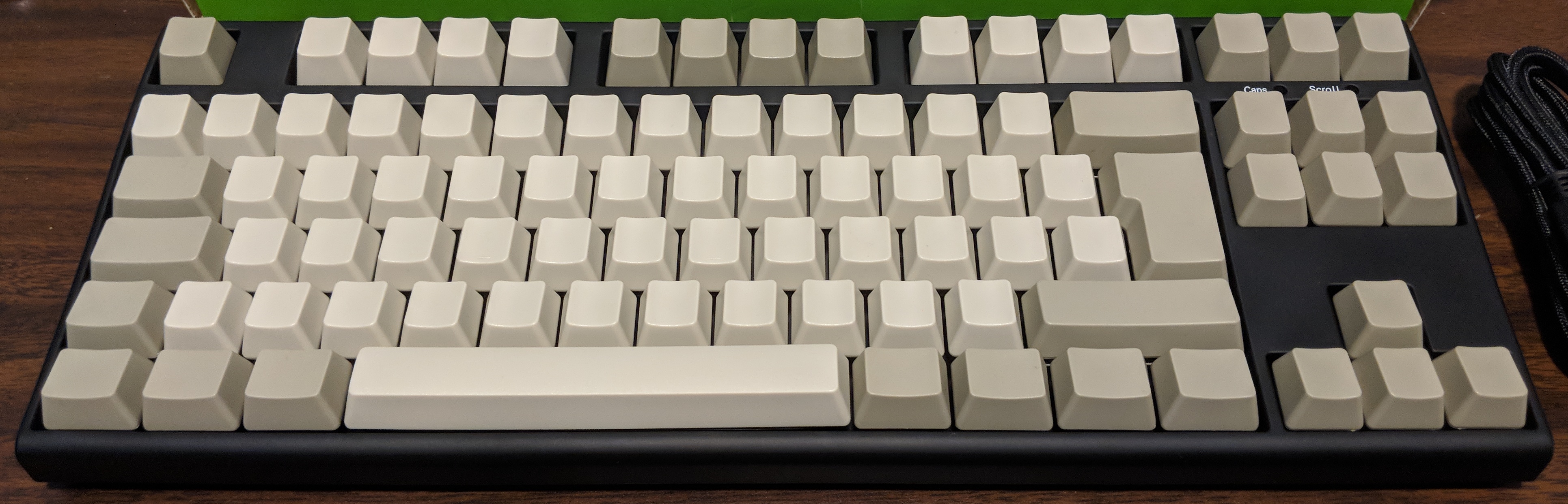

Keyboard with original keycaps
2018-08-31 21.34.56.jpg (1.2 MiB) Viewed 3656 times

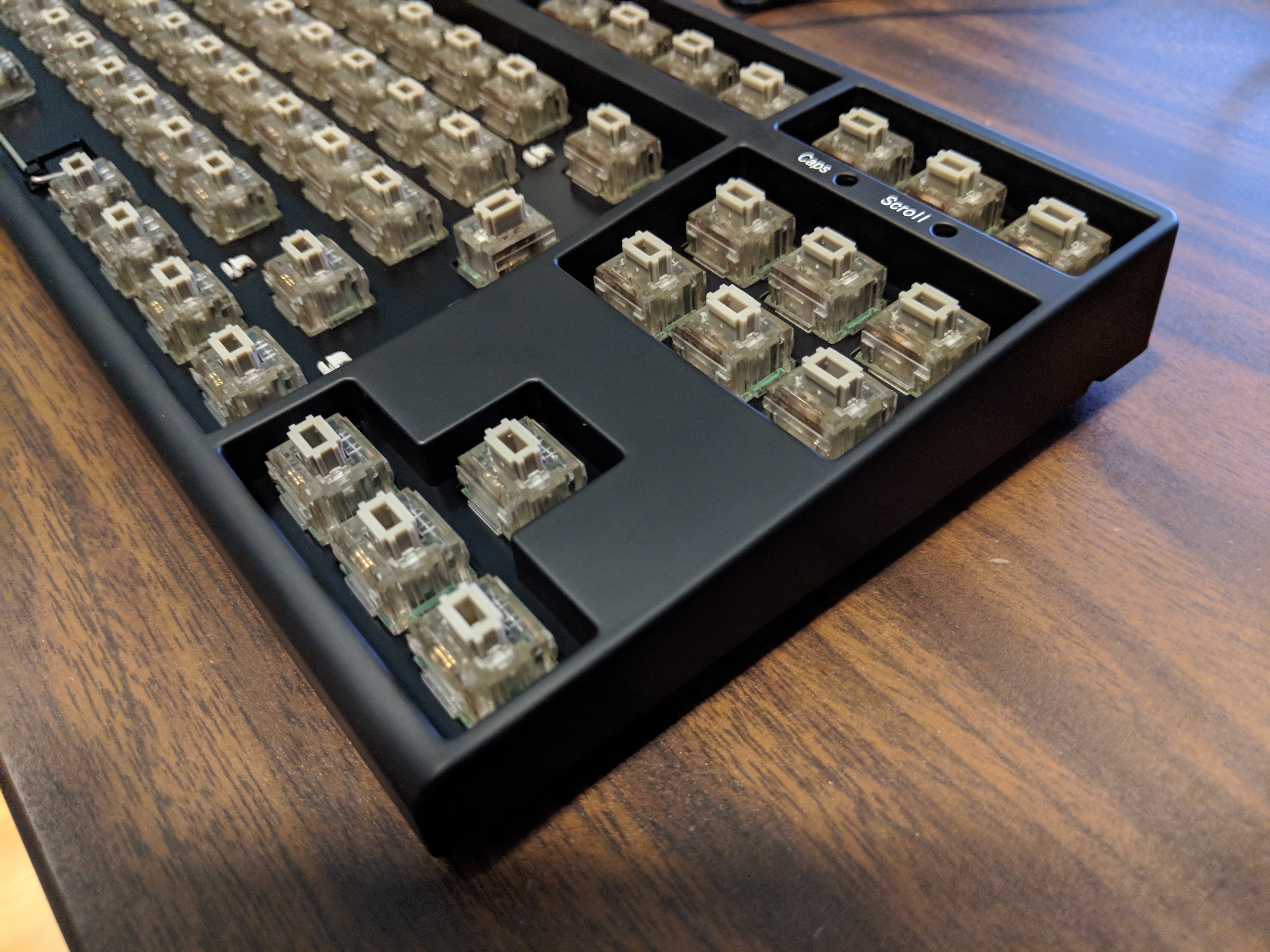

Ahem... those aren't MX, it's not a backlit model, keycaps haven't been lasered.

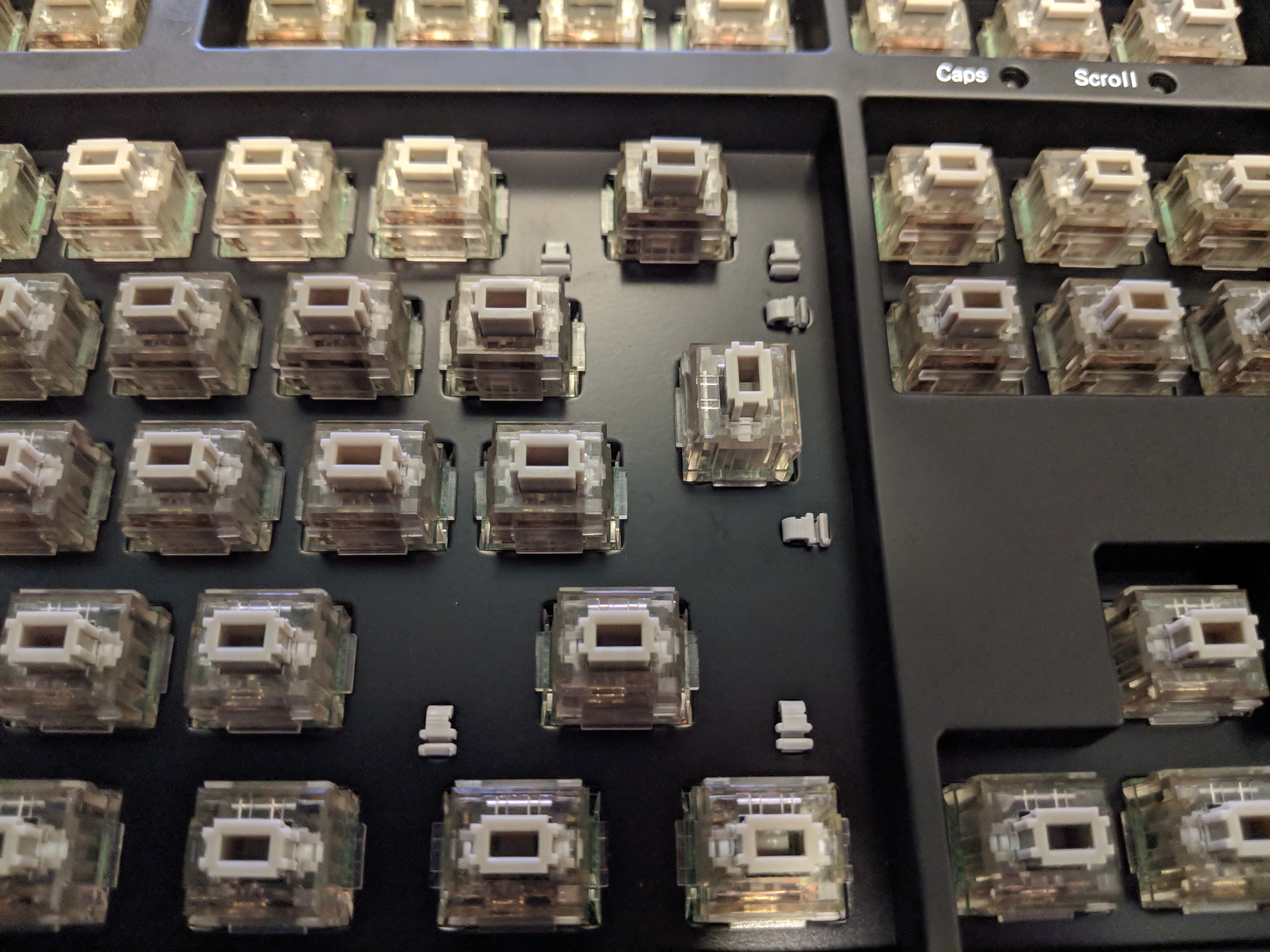

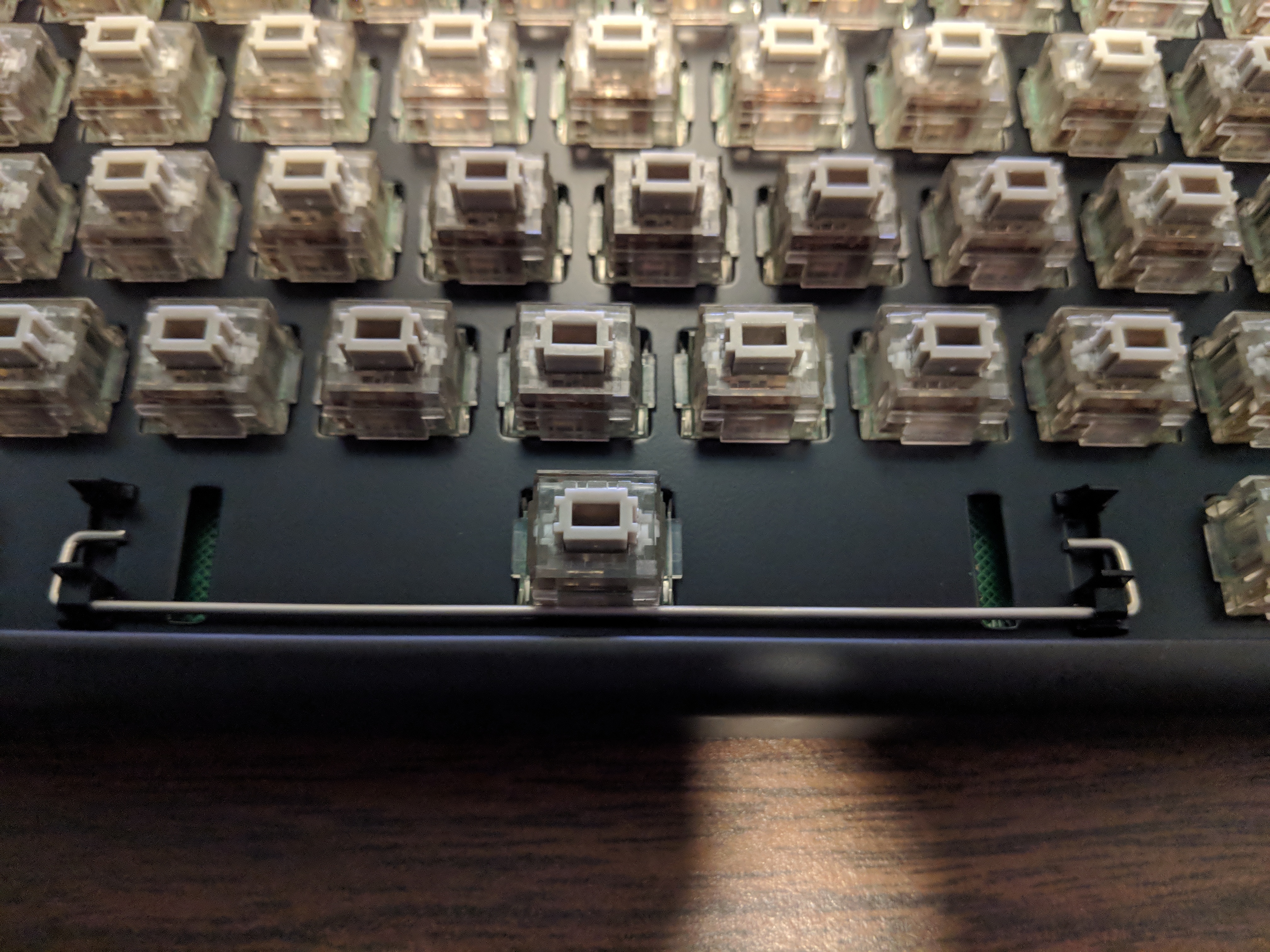

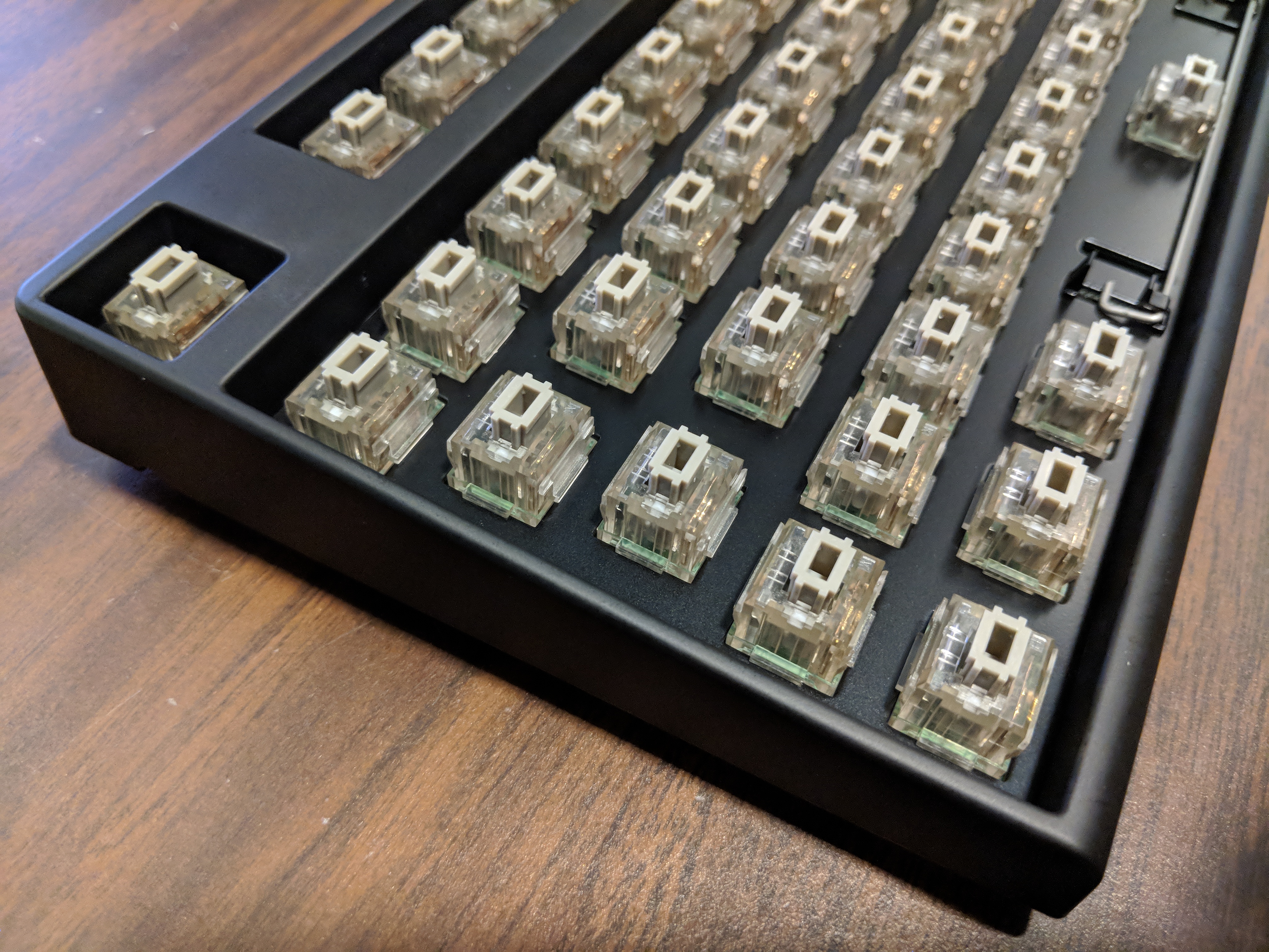

Stabilizers rattled too much to my liking, fixed with the application of a suitable lubricant.

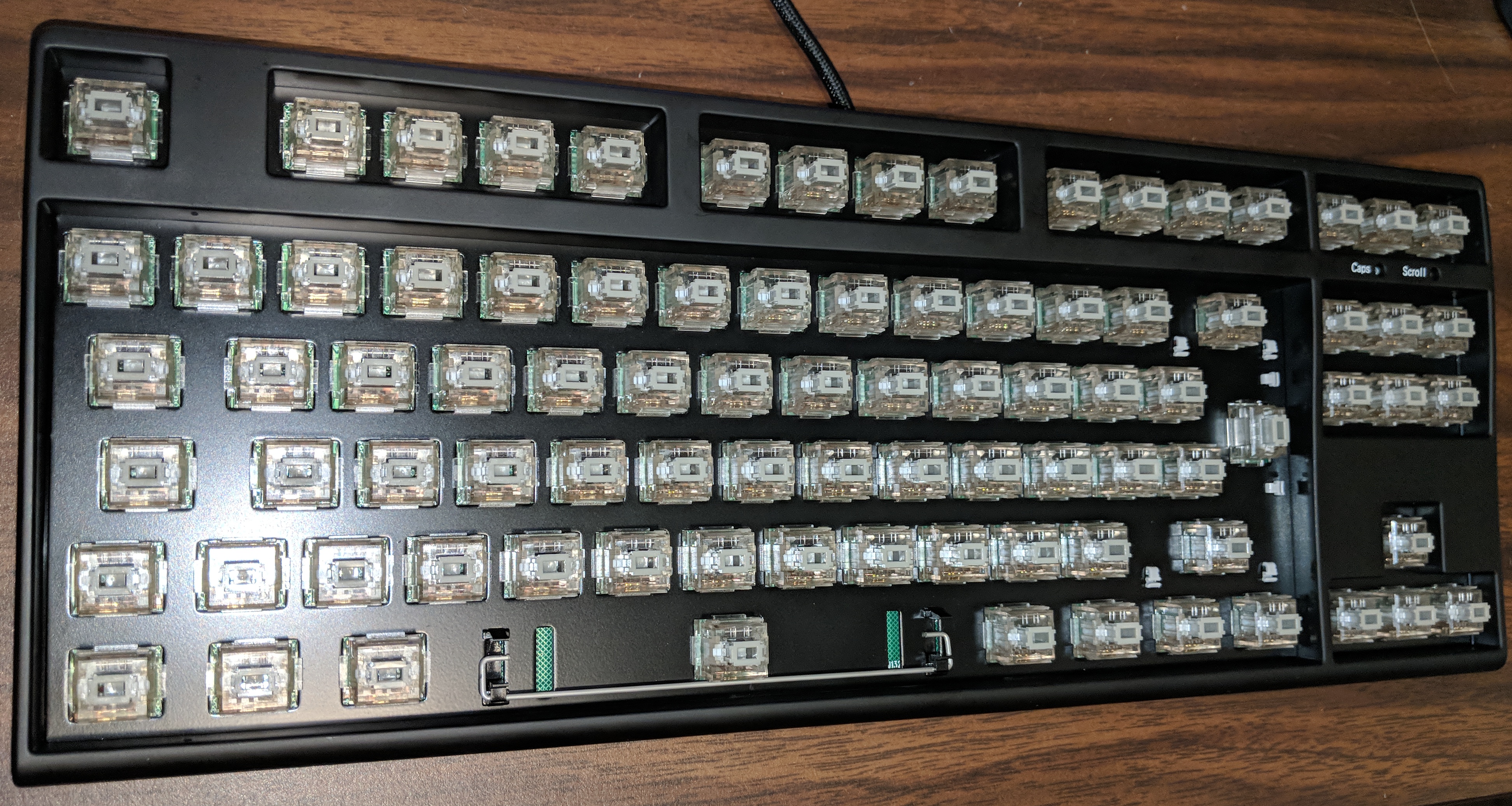

No keycaps
No keycaps
2018-08-31 23.17.40.jpg (2.41 MiB) Viewed 3655 times

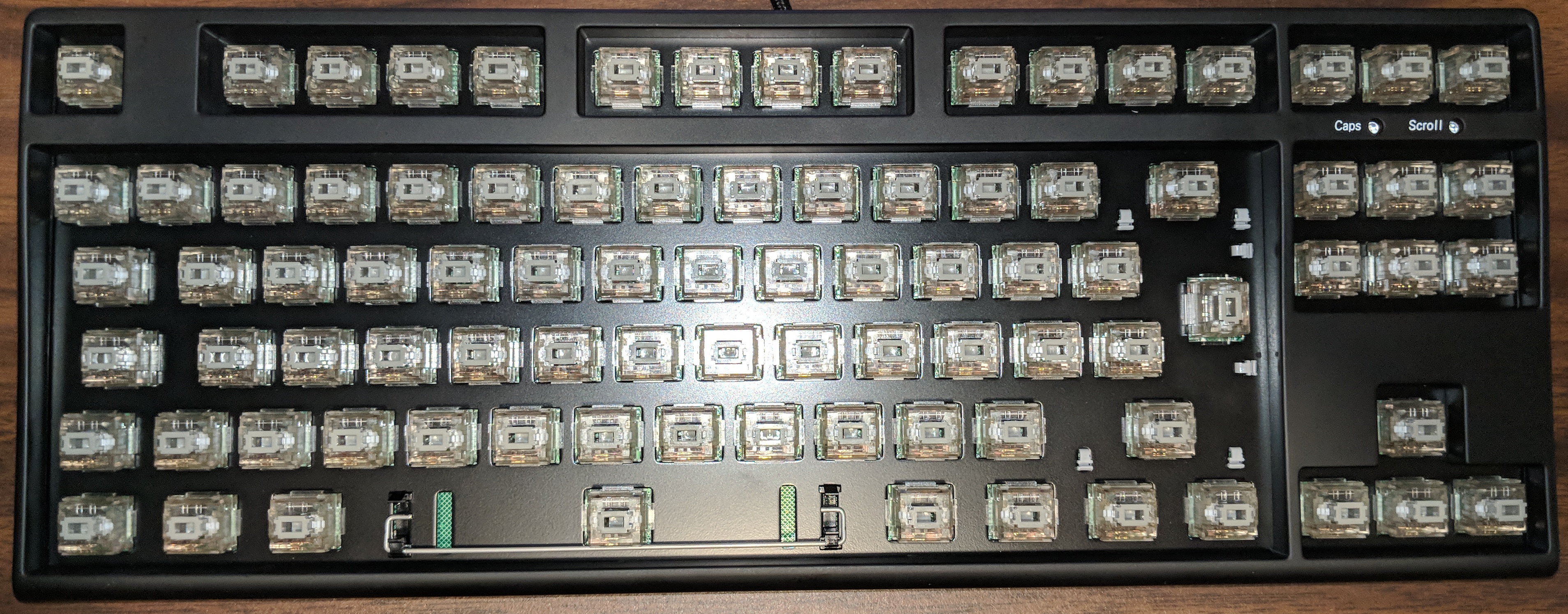

Spacebar uses Cherry-mount Costar stabilisers, the rest are Alps style. The plate has provisions to support another style of spacebar with the two other stabilizer mounting holes.
No keycaps - angled shot
2018-08-31 23.18.06.jpg (3.14 MiB) Viewed 3655 times
No keycaps - Left side
2018-08-31 23.18.17.jpg (3.85 MiB) Viewed 3655 times
No keycaps - Right side
2018-08-31 23.18.34.jpg (3.47 MiB) Viewed 3655 times
Stabilizers closeup
Stabilizers closeup
2018-08-31 23.18.53.jpg (3.85 MiB) Viewed 3655 times
Spacebar stabilizer closeup
2018-08-31 23.19.00.jpg (3.51 MiB) Viewed 3655 times

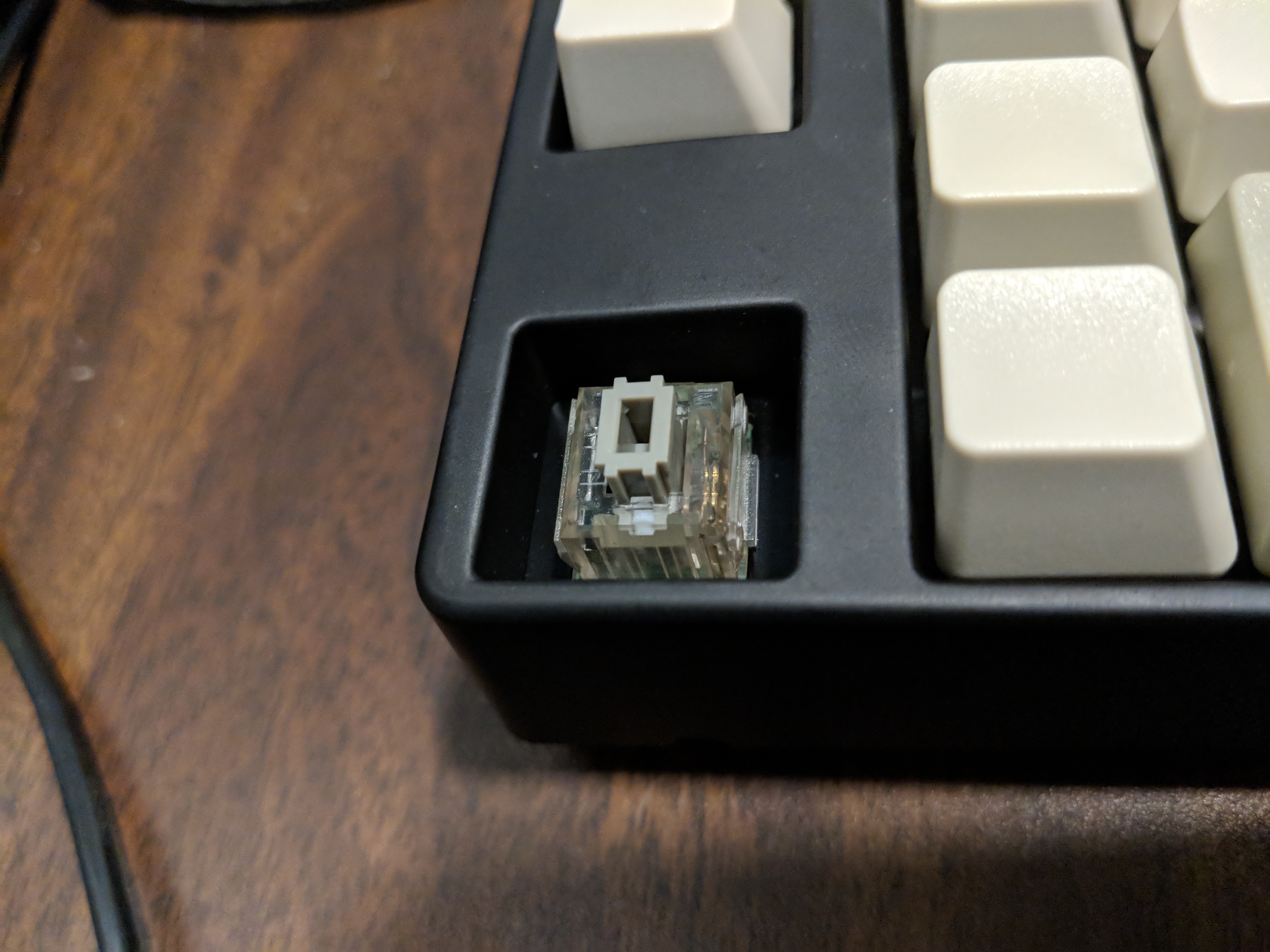

The switch for the D key squeaked slightly for some reason... Didn't notice while testing before swapping the caps (the original ones held on tightly) so I might be at fault here. In any case, that gave me reason to open it and make sure everything was seated properly, problem fixed after reassembly.

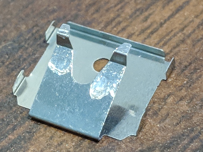

Factory-lubed tactile leaf
2018-09-01 00.02.52.jpg (166 KiB) Viewed 3655 times
Turns out that the tactile leaves are factory lubed, interesting.

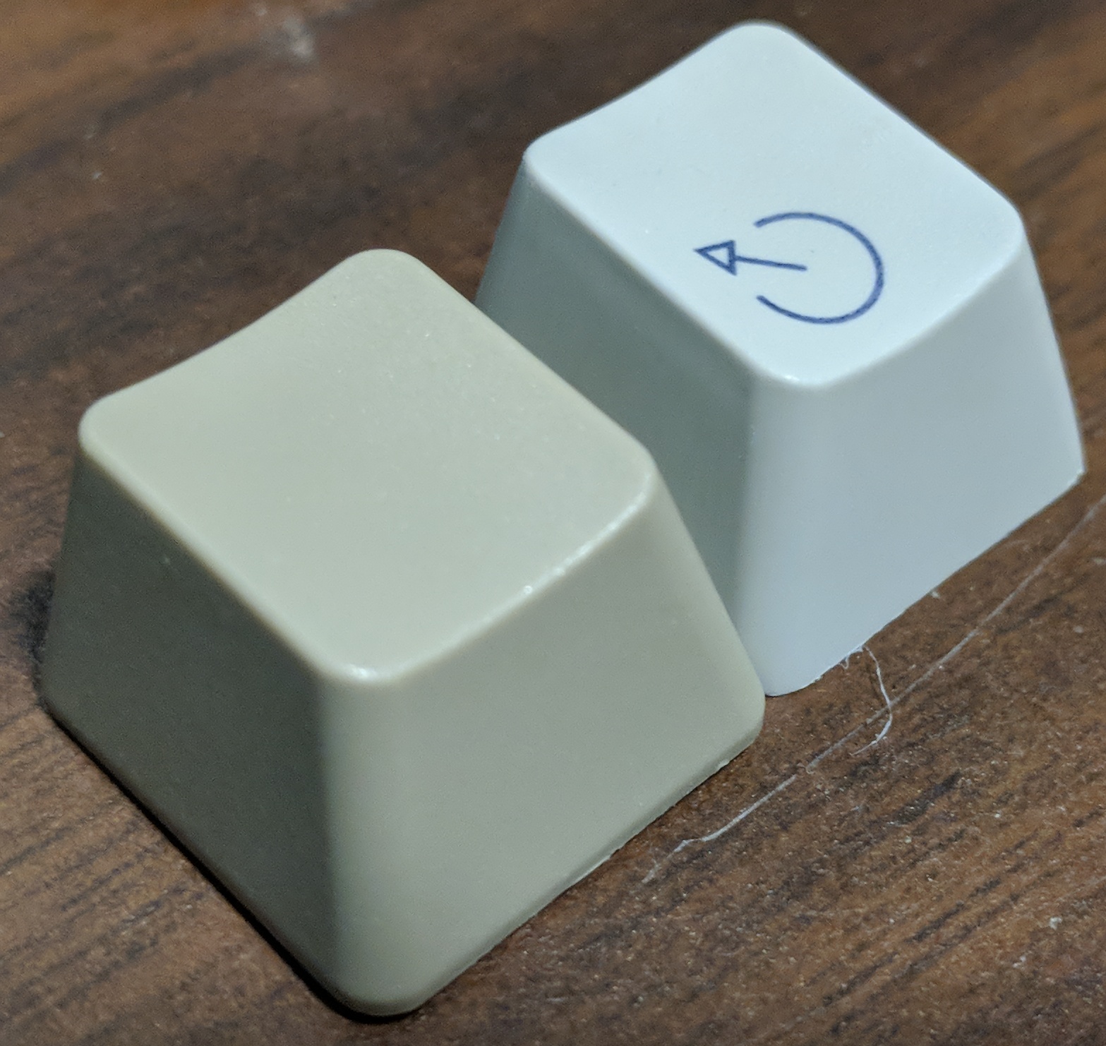

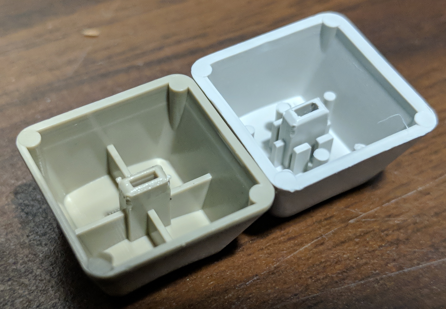

I bought a pair of rubber dome AppleDesign boards as donors for their PBT caps a few weeks ago:
Keycap comparison - Angled shot
2018-08-31 21.49.06.jpg (598.7 KiB) Viewed 3655 times

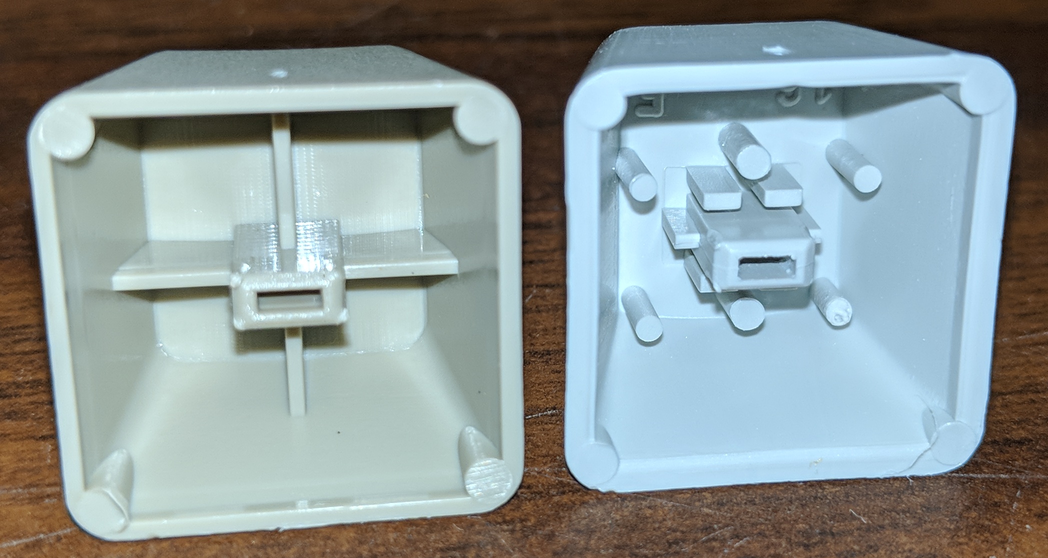

Keycap comparison - Underside 1
2018-08-31 21.49.48.jpg (658.43 KiB) Viewed 3655 times
Keycap comparison - Underside 2
2018-08-31 21.50.03.jpg (586.66 KiB) Viewed 3655 times
In my opinion, the thicker caps make the switches sound better.

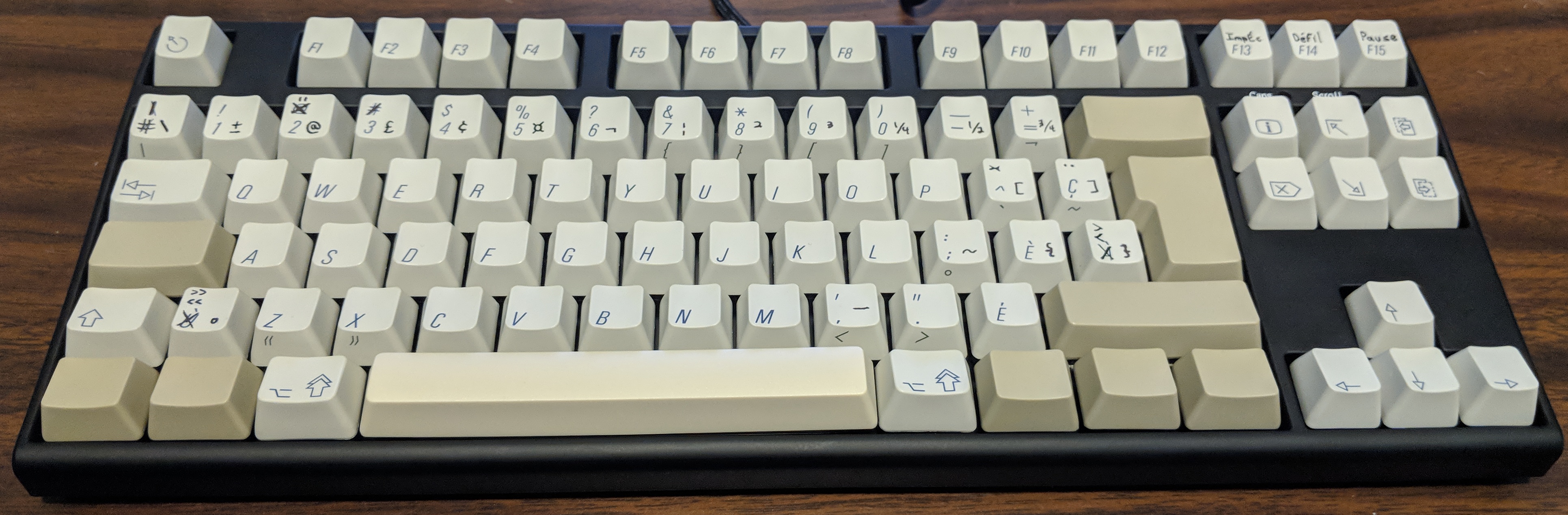

Long story short, I'm not aware of *any* Alps sets in my usual layout so I had to improvise a bit:
With adjustments for layout
2018-09-01 00.15.02.jpg (1.3 MiB) Viewed 3655 times
