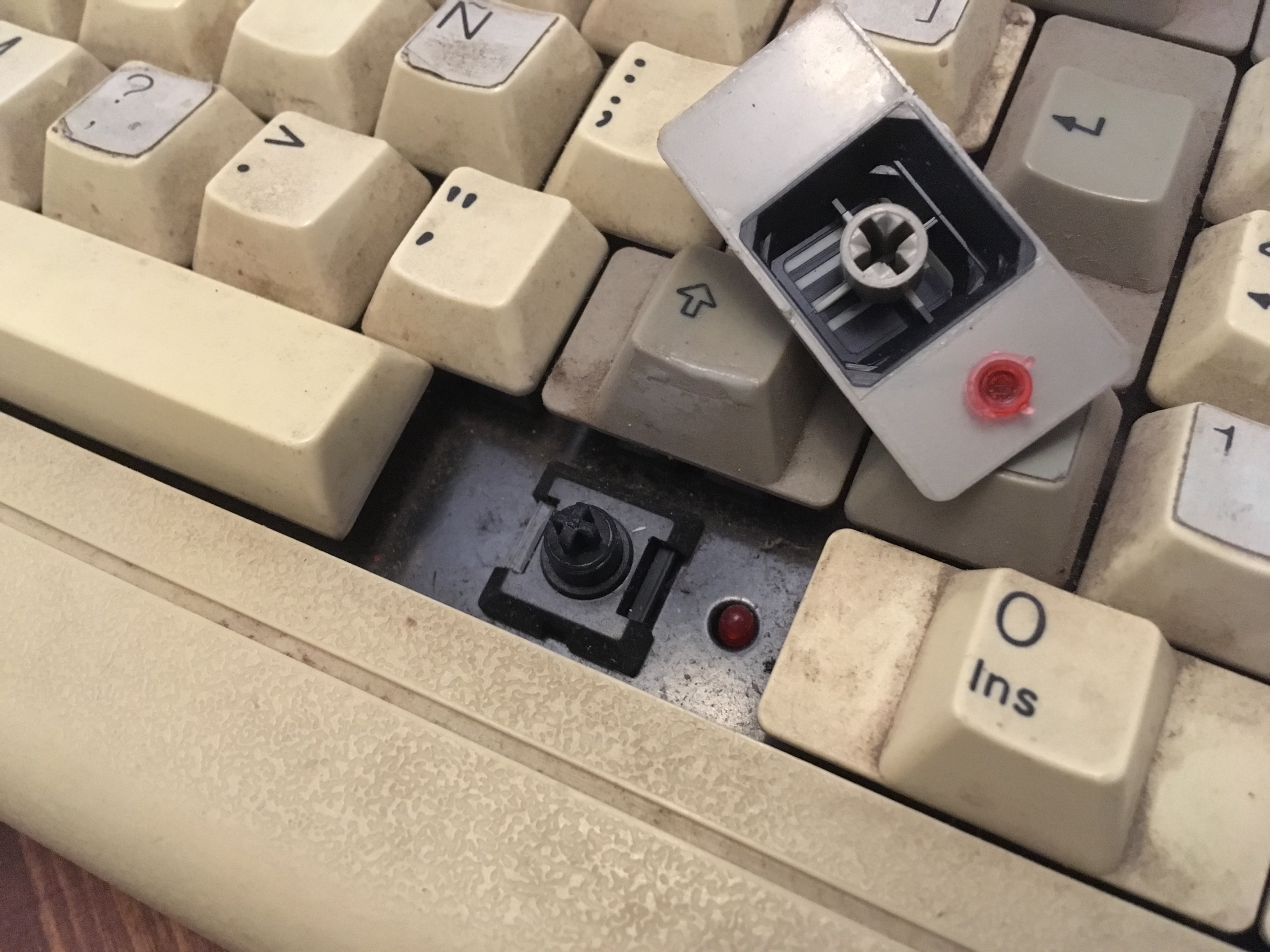

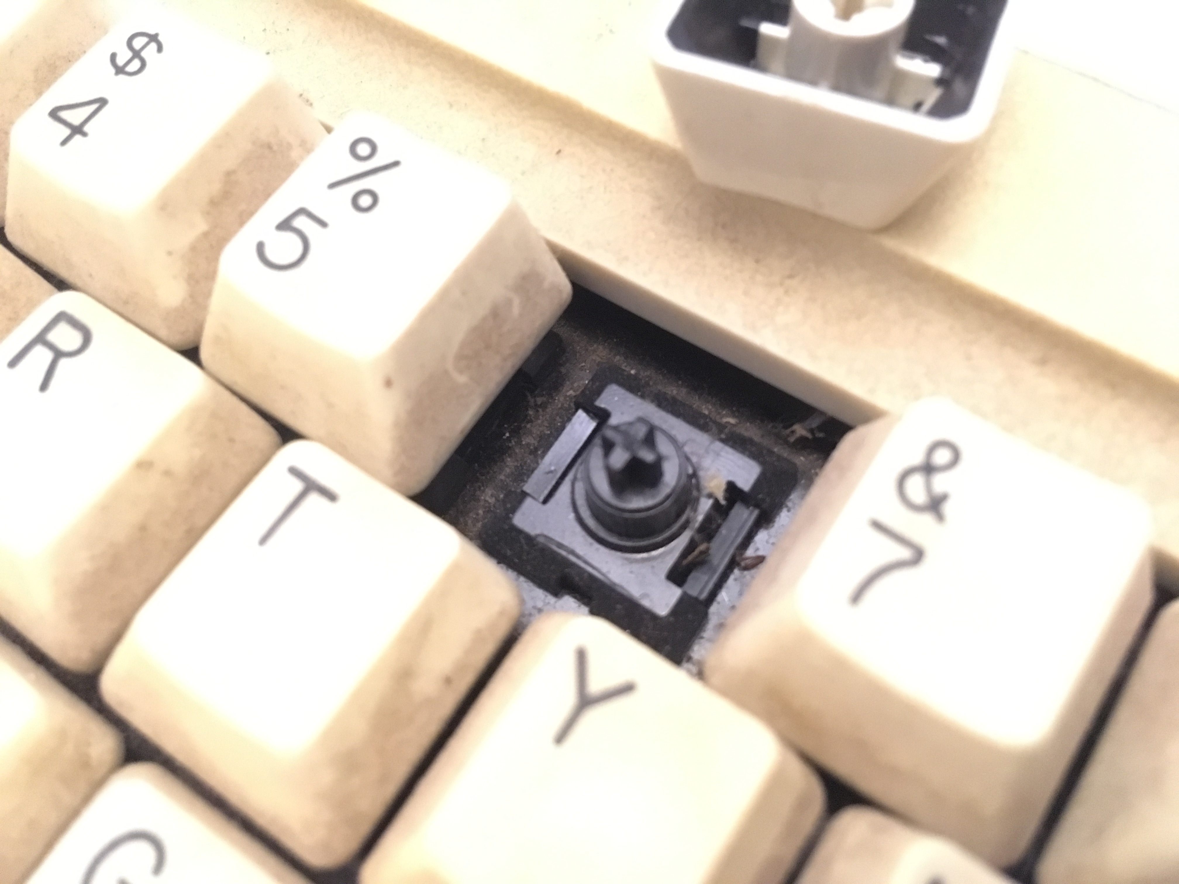

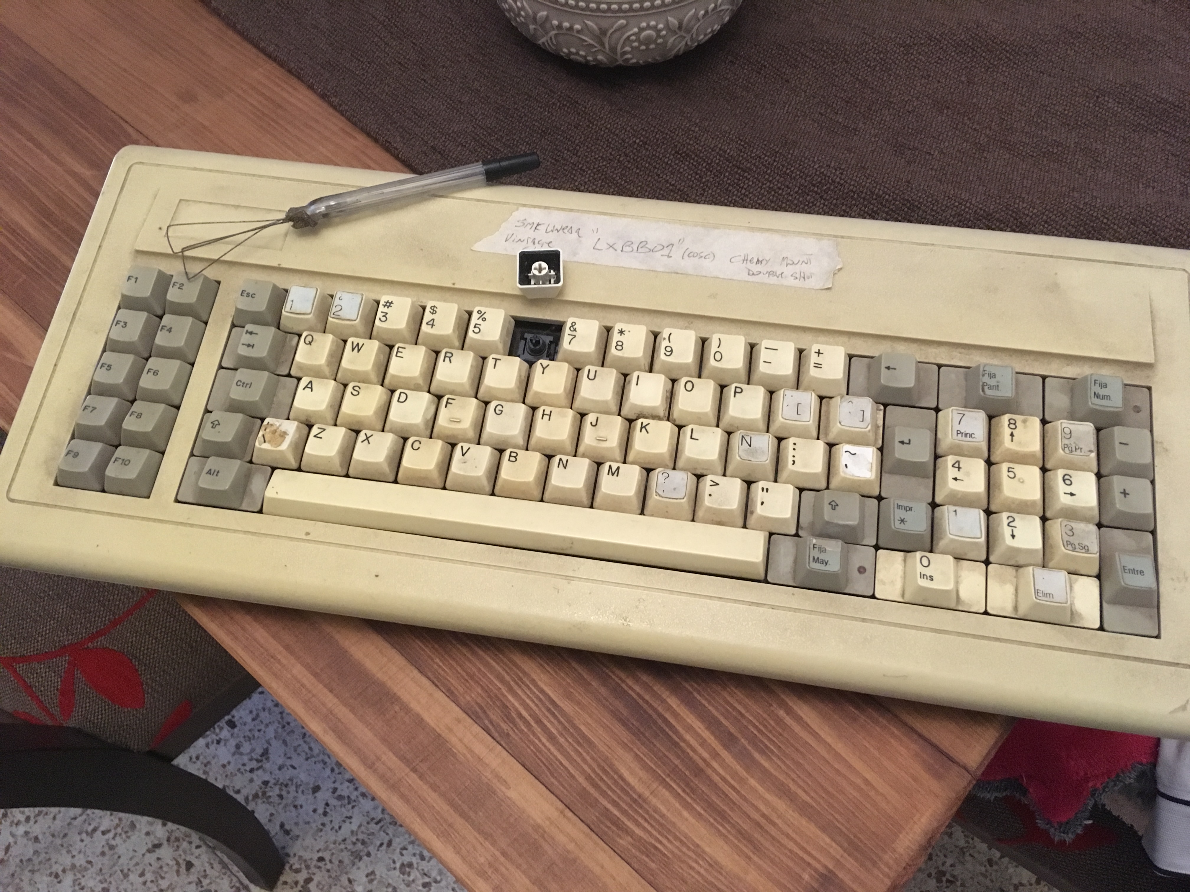

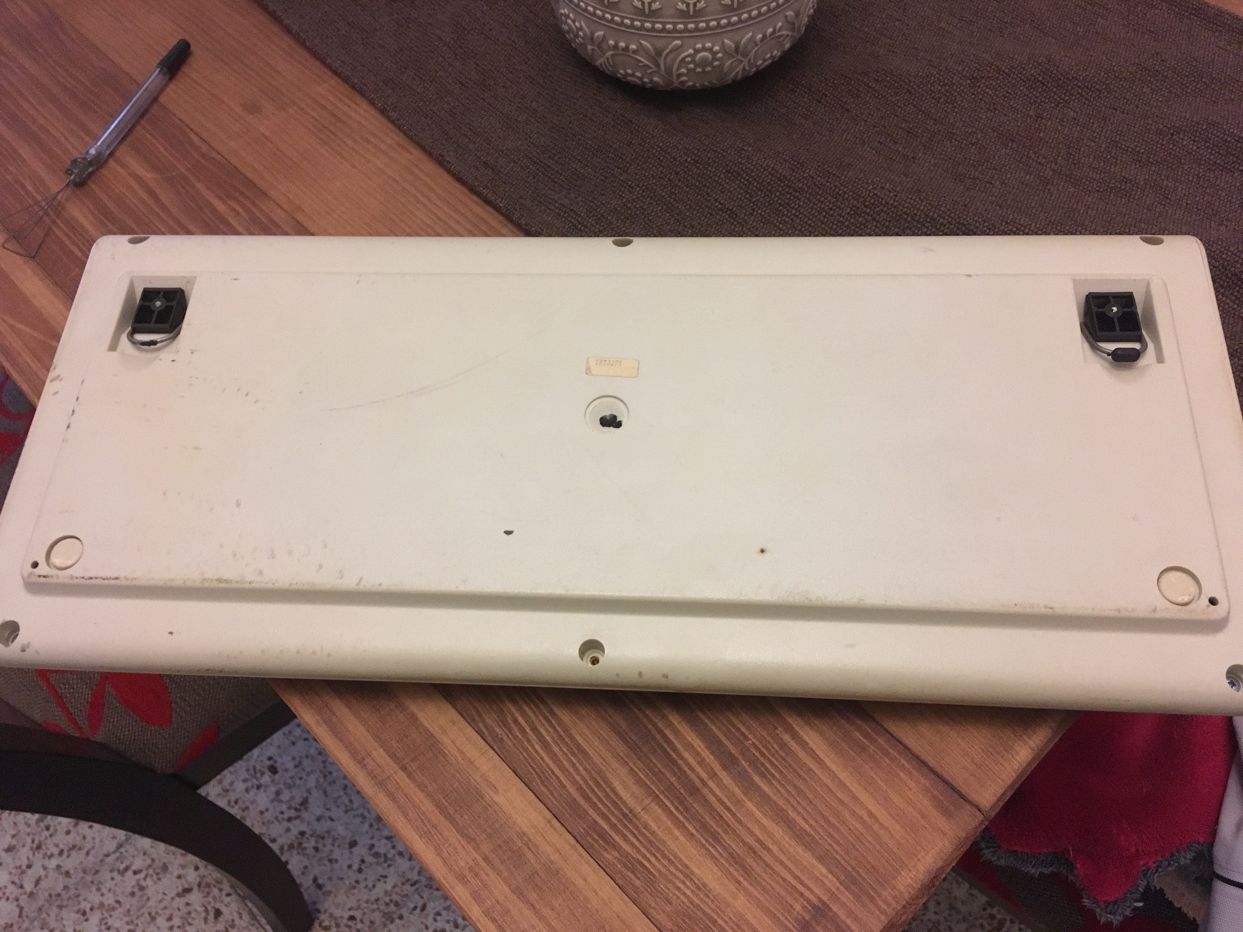

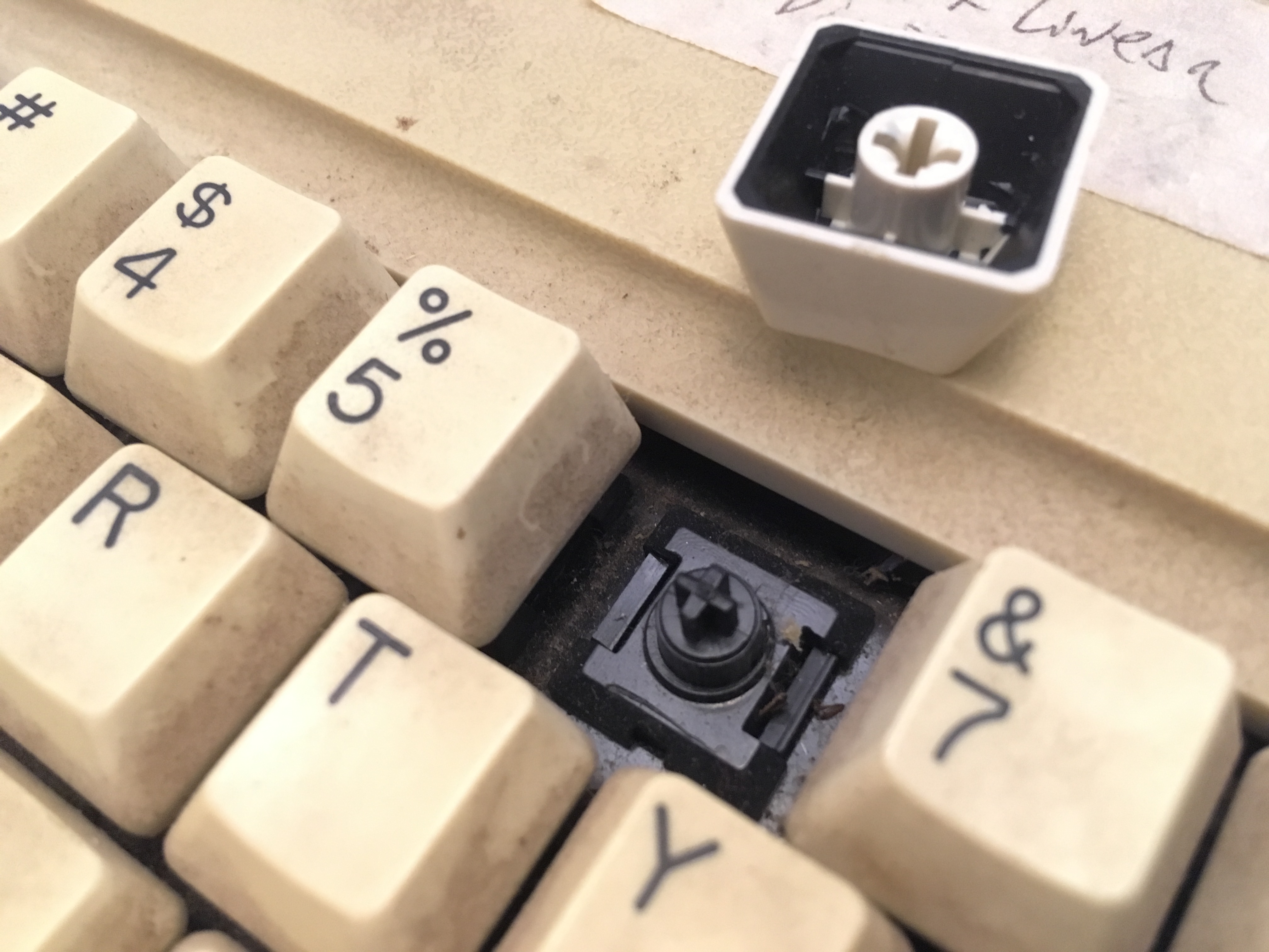

spongebob1981
19 Sep 2018, 15:27
And here it is. Dirty AF, sorry, I found it that way and haven't got to restore it yet.
Foto 18-9-18 18 12 07.jpg (2.19 MiB) Viewed 6678 times
Foto 18-9-18 18 14 12.jpg (1.67 MiB) Viewed 6678 times
Foto 18-9-18 18 13 03.jpg (1.06 MiB) Viewed 6678 times
Foto 18-9-18 18 12 44.jpg (1.34 MiB) Viewed 6678 times
Foto 18-9-18 18 15 18.jpg (1.98 MiB) Viewed 6678 times
Cable was cut before I got it. Switches are SMK clones AFAIK, linear, a tad scratchy, and quite pingy. Space bar works well, it's the only stabilized key.
It used to be on a government facility, thus the neglect and the stickers over the keys (much easier than to remember what does each one :lol:
