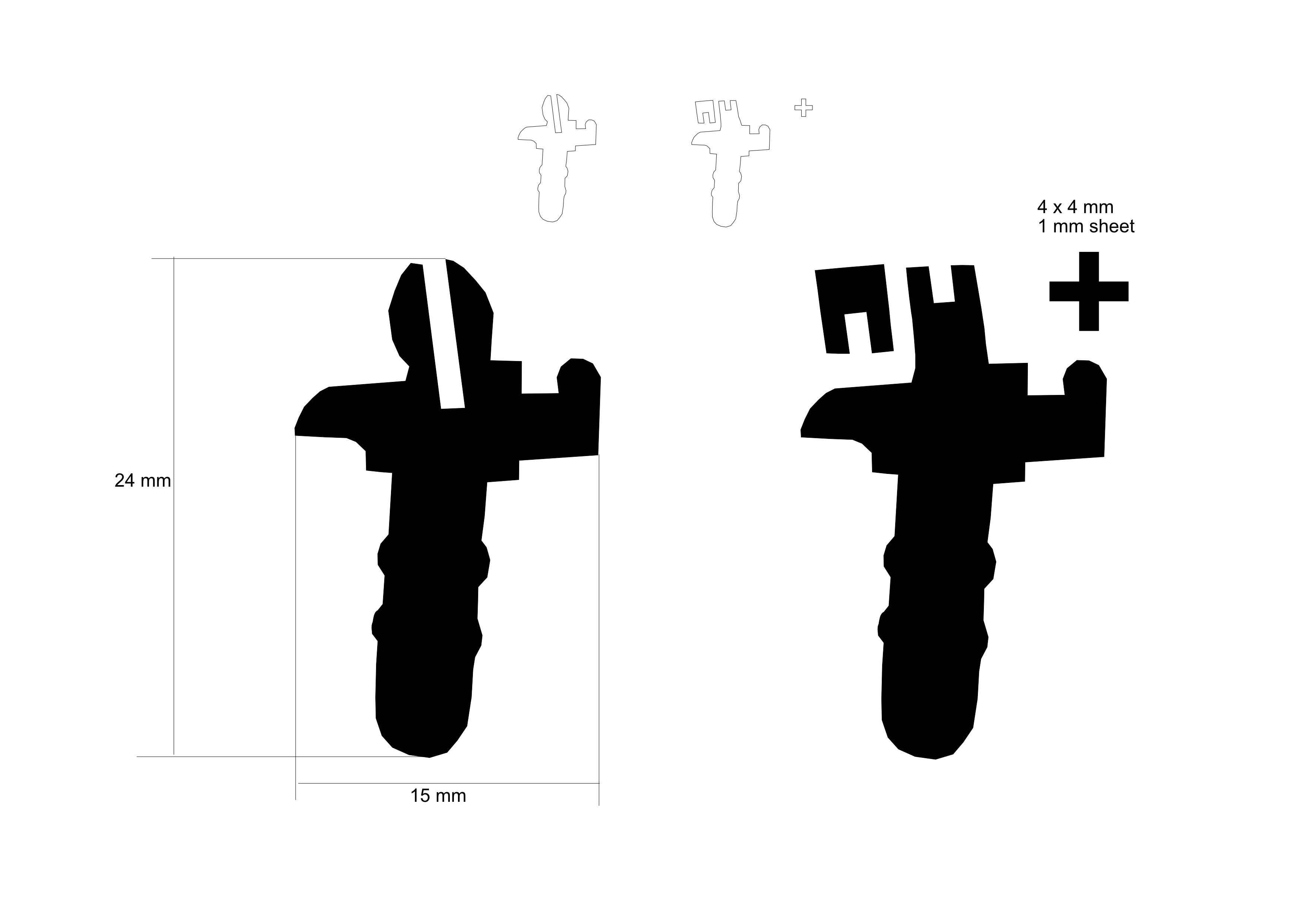

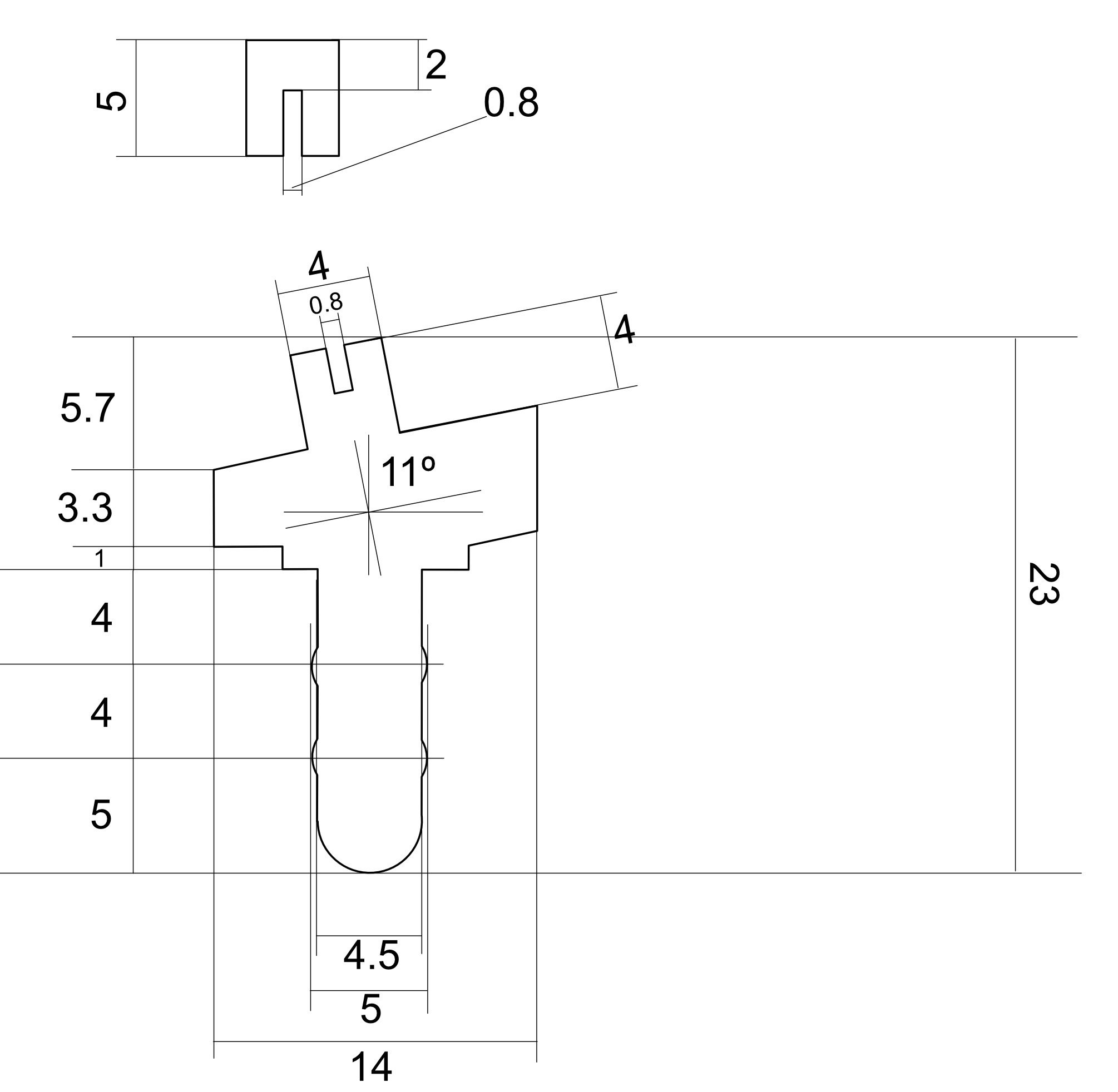

Below is the drawing for the cutout. I am planning to let them laser-cut accordingly. I don't have the full costs for the stems, yet, but they will be around US$ 200 for 100 stems, which are MX mount compatible. Before I continue to work on these, I wanted to hear from the community, if this has been already tried and hear opinions.
Metal Stem.jpg (173.24 KiB) Viewed 15459 times

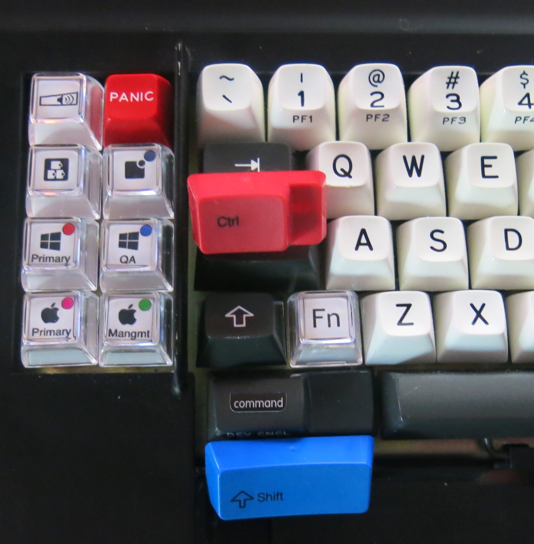

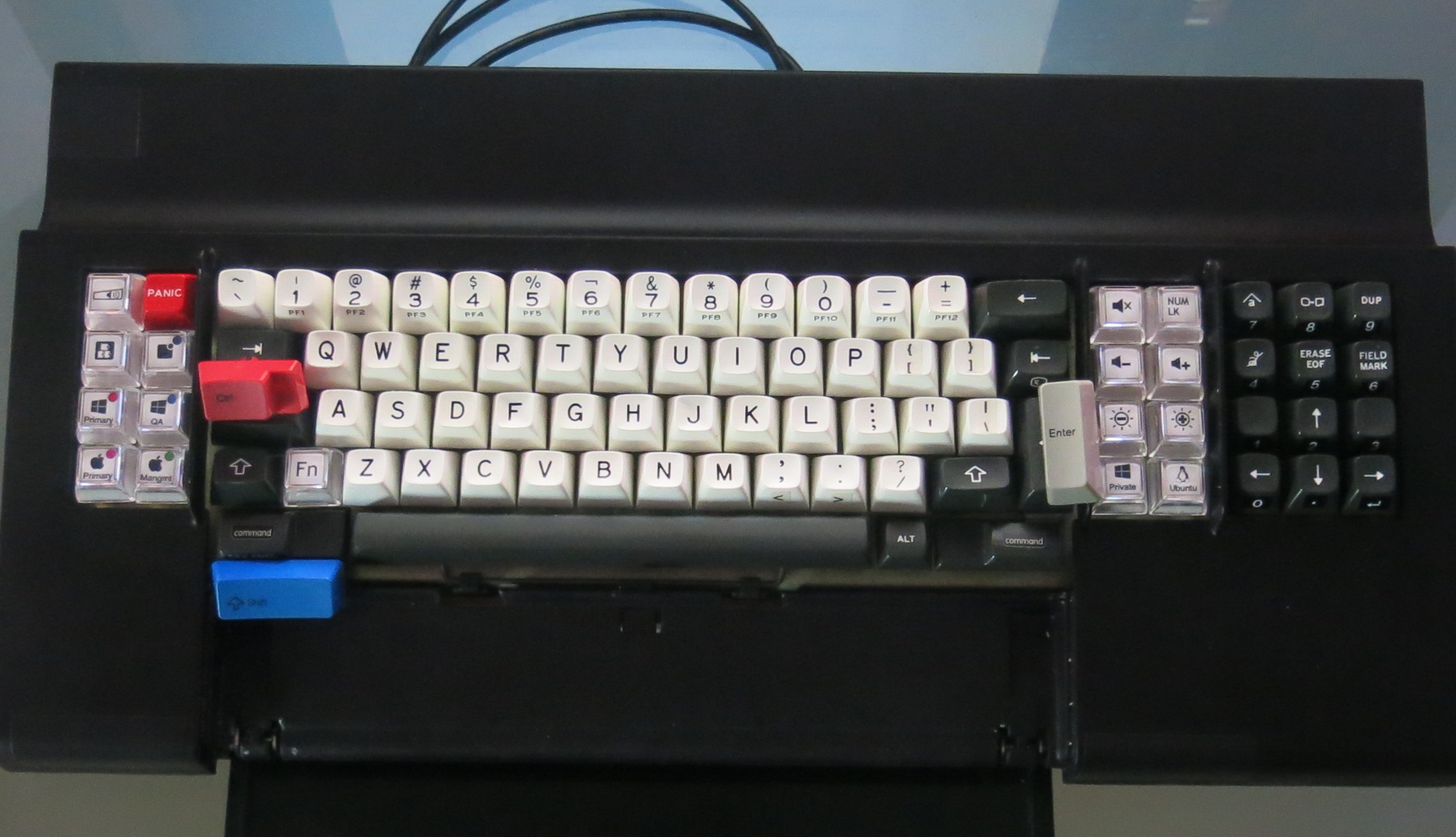

The layout of the keys / the key sizes are actually standard size, even they don't look like it.
Below are a few keys from the later IBM Model M (Ctrl in red is a 1.75U / the lower Shift key in blue is a 2.25U / the grey Enter is the same as a Keypad Enter). The keyboard has some MX keys: clear keycaps and Panic key, which work great.
Close-up with the Fn-key being also a MX mount key:
My plan was not to exchange every single key on the normal alpha plane, but more to make some keys more modern. Also, it would be possible for some companies to create dye-sub keys with proper labeling.

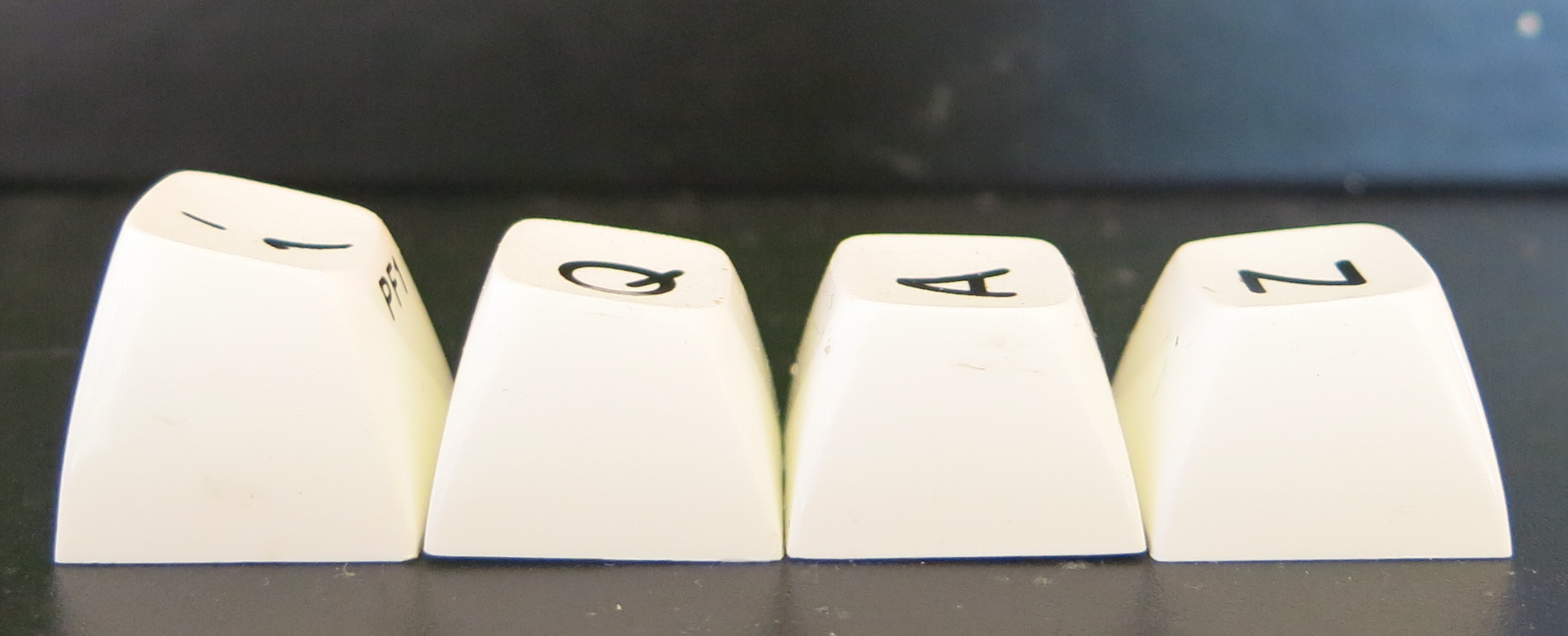

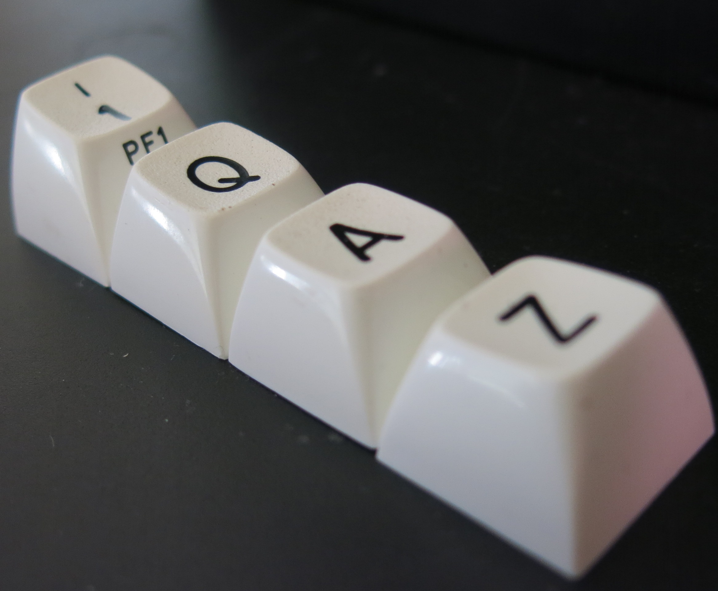

The best possible match is the High Profile, Spherical Top, Sculptured (or SA). Rows match according my tests according this pattern:
Alphanumeric Cluster:
Original Row 1 (Numbers) - SA Family Row 1 (-13 deg)
Original Row 2 (QWERTY) - SA Family Row 2 (-7 deg)
Original Row 3 (ASDFGH) - SA Family Row 3 (0 deg)
Original Row 4 (ZXCVBN) - SA Family Row 4 (7 deg)
Original Row 5 (Space) - no direct match, but SA Row 3 works
PF-Cluster & Nav-CLuster:
All Rows the same - SA Family Row 1 (-13 deg)
The original keycaps are PBT doubleshots with a 1.5 mm thick plastic in a formula that isn't produced anymore.

Would you be so kind to give us the blueprints or the document with all the measurements? I know a 3101 who screams for some custom keycaps.
darkcruix
01 Oct 2018, 09:57
Find attached the test version of the simplified MX mount for laser cutting. This drawing hasn't been tested in any way, yet. I am still waiting for it to be cut.
The version here is a simplified version that likely gets changed after initial testing:

I started to speak to a few companies and they asked me to make some changes after measuring the original stem and a keycap with MX mount. Find attached what I have so far:
Stem - simple - d11.svg.zip
(3.46 KiB) Downloaded 315 times
Screen Shot 2018-10-01 at 17.52.34.jpg (164.93 KiB) Viewed 15077 times

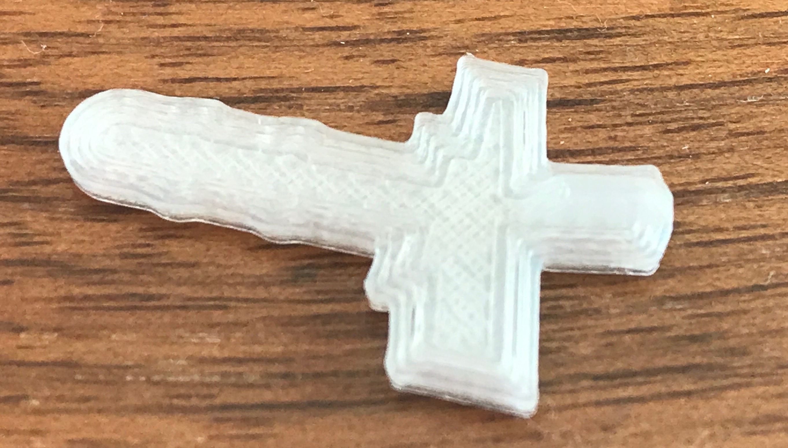

I'm a bit late to the party but I took that svg and turned it into an stl for you if you have a 3d printer. Only thing of note would be that it only has 3 of the four MX crosses so you can print it flat for extra strength.
[The extension stl has been deactivated and can no longer be displayed.]
darkcruix
06 Oct 2018, 11:50
Thanks for creating the file. The printout looks beautiful. I hope, I can test it over the weekend and give some feedback.

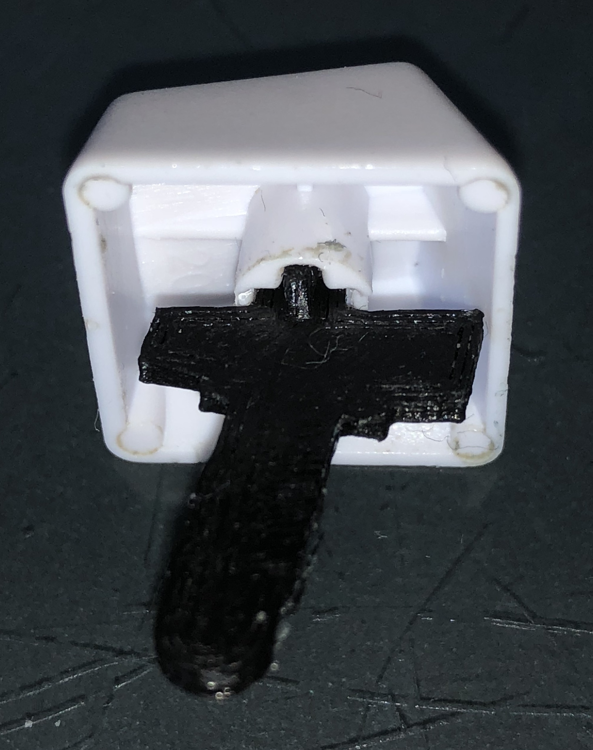

The company I was approaching to do the laser-cutting came back to me that they can't take the request on, due to "problems associated with production".

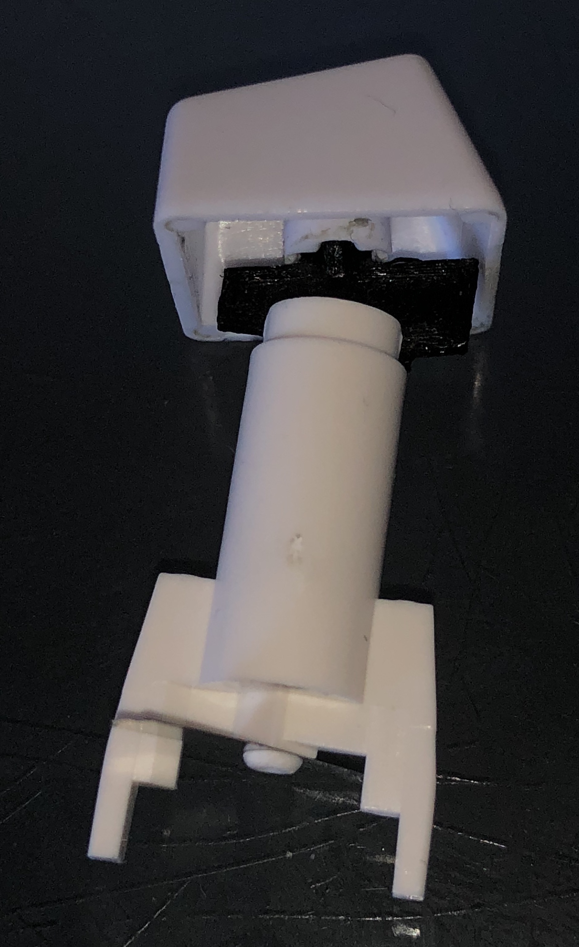

Meanwhile, I have tested the PLA plastic printout. It fits perfectly in the slider and MX keycaps also look great. Downside is the durability of the 3D-print I had.
Here is the new printout in PETG (sorry for the dirty MX cap and uncleaned printout - couldn't wait to test). I will print 16 of them this weekend and build them into a 3278 which I will use for a while, to see how they perform:

sealclubber wrote: Oh man this is exciting :D Just ordered one of those beamspring keychains from orihalcon's ebay so I should be able to do some tests and tweaks if needed once it gets here.
You may want to reduce the size of the "cross" by 0.2mm - 0.4mm. On PETG I had to cut it a bit to fit properly. You may want to share a new file when done (I am a total n00b in 3D work :) ).

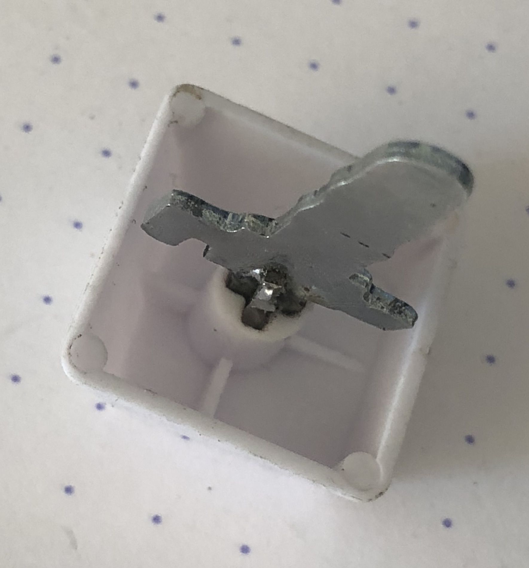

I wanted to share a quick video of the usage of the new stem. It is only showing it in an external switch, but I plan to replace 4 columns in the Beam Spring to get a feeling of the change and durability tests.
darkcruix
15 Oct 2018, 17:20
First test results I wanted to share:
- There is a difference in key feel (the plastic ones do not feel as crisp)
- The plastic stems are more (wobbling), but you won't recognize it during normal typing.
This would lead me to the first result, that those stems need to be built from steel to give you the same typing feel. I will try a few more things like an additional piece that sits on the slider.

Gotcha. Depending on the width of the nozzle it can expand a bit and I forgot to account for that. Assuming you use a nozzle diameter of .4mm, the XY delta between exact measurements and actual results can differ by about 75-ish% of the nozzle width. This new file has the crosses at a width of 1.27mm which should account for this discrepancy.
EDIT: Just saw your new post with your test results. Wondering if maybe the wobbly bits are due to the lack of that fourth cross, because the thing is made out of plastic, or because of the extra height. Could be all three. Uploading the revised model anyway. In other news, it seems like my beamspring keychain was shipped out this morning, so I should be able to get some good tests in when that arrives.

It is getting better an better. I guess I have a further idea to improve the typing feel - currently the "wobbliness" is acceptable and the sound is on par with steel. I used PLA now with 100% infill.
To get this to the next level, I had an idea. Can we make the 90º mount longer, so it reaches down to the slider and builds another stabilizing feature? Additionally, I believe, if we reduce the height of the stem a little (see svg), the keys will be in the exact position compared to Beam Spring keys.
EXCITING - it works so well already. I have 18 keys replaced and they feel great.
