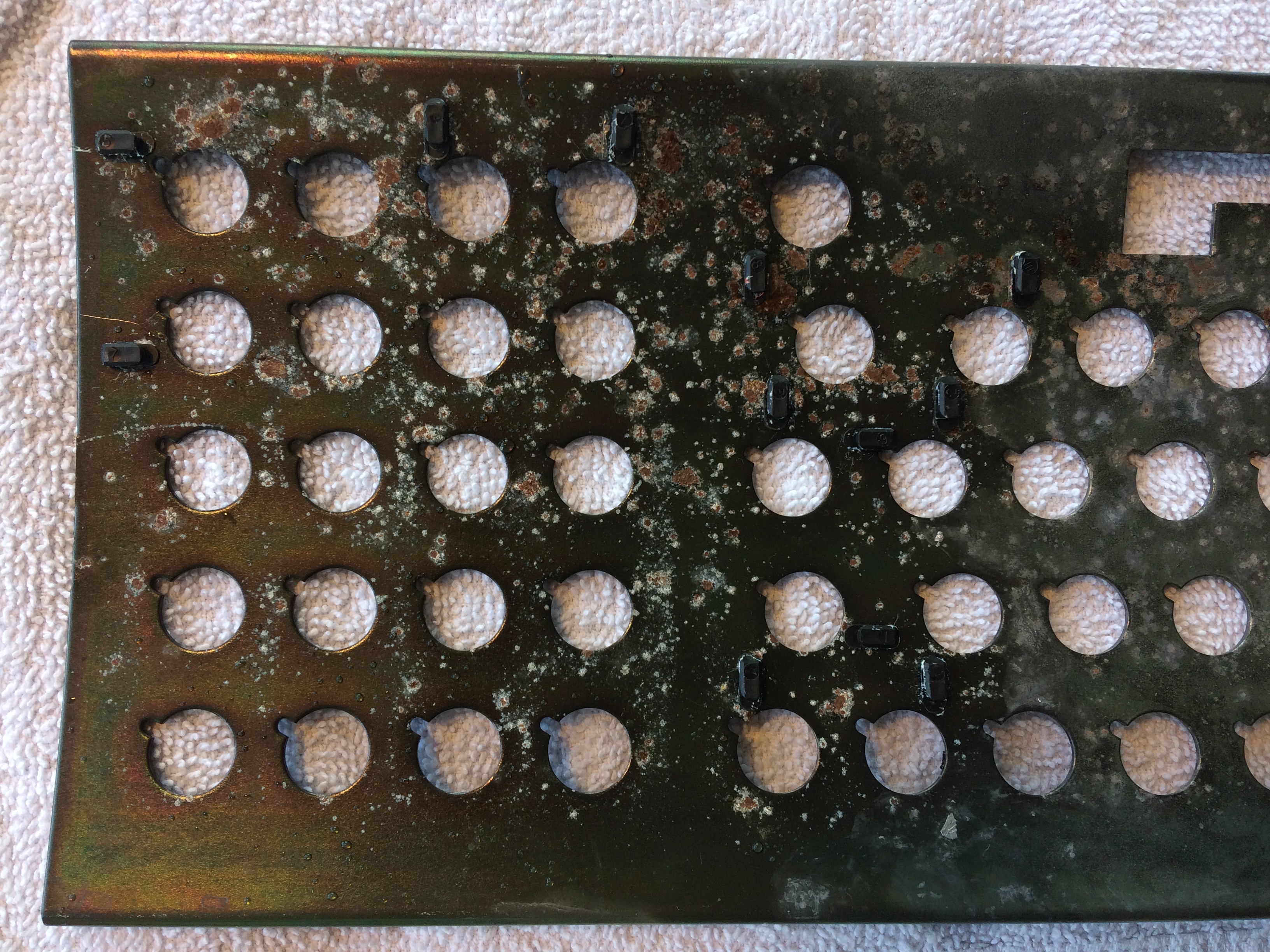

Before
IBM AT Model F – Corroded barrel plate (focus on stabilizer clips)

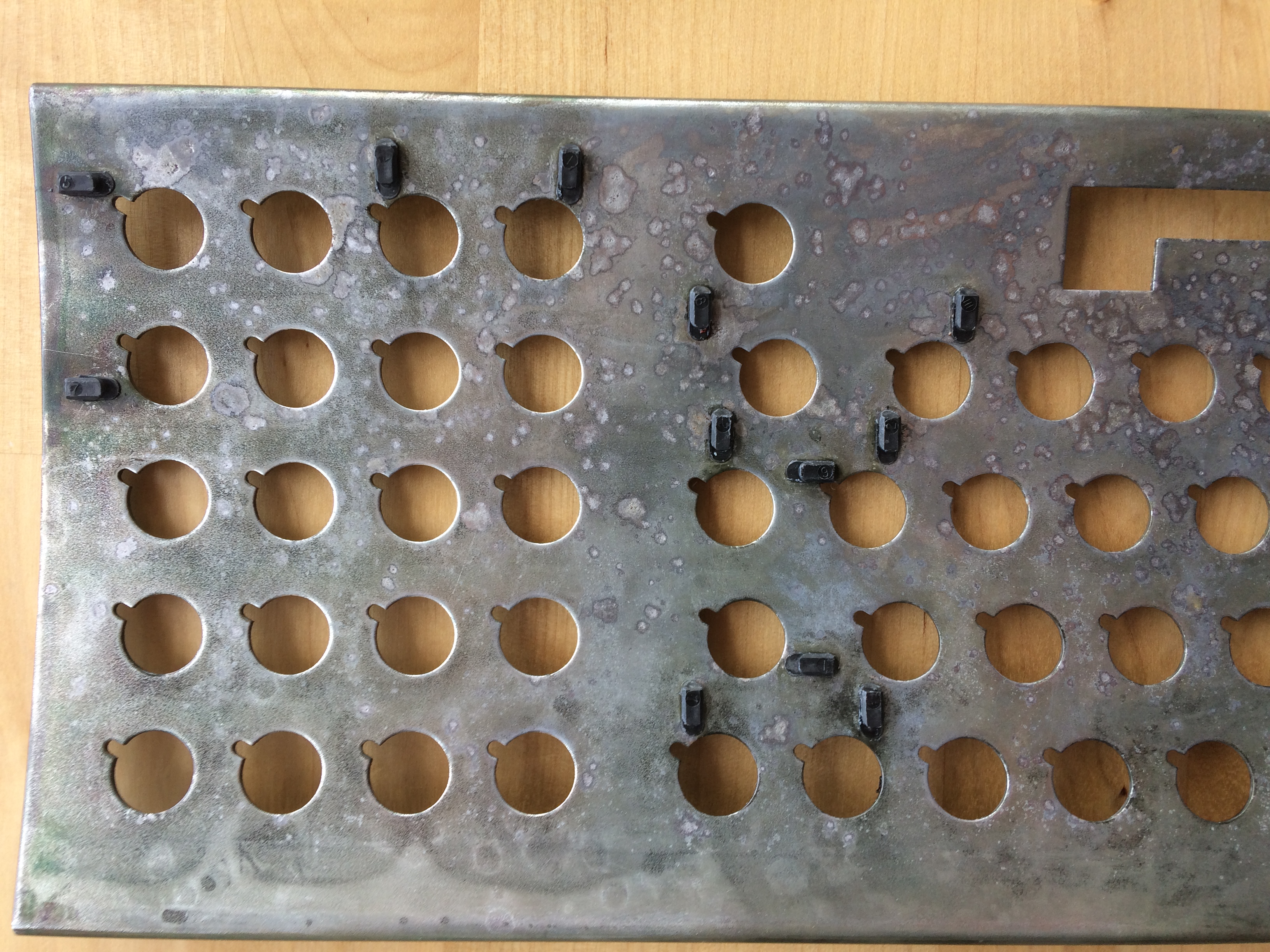

After
IBM AT Model F – Cleaned barrel plate (focus on stabilizer clips)

  9. Once your aluminum tool passes over the surface of the barrel plate without any resistance, you have probably removed all corrosion and some or all of the existing lacquer.
  10. In a few places and especially around the stabilizer clips, corrosion might have penetrated beneath the surface of the barrel plate. In these places I used a small flathead screwdriver to break up the rust, added copious amounts of vinegar, let it soak, and started cleaning with the aluminum tool.
  11. Once you have removed all corrosion, wash, rinse, and dry the barrel plate. You can now prepare the barrel plate for painting. The smooth surface makes it very easy to give it a light sanding.

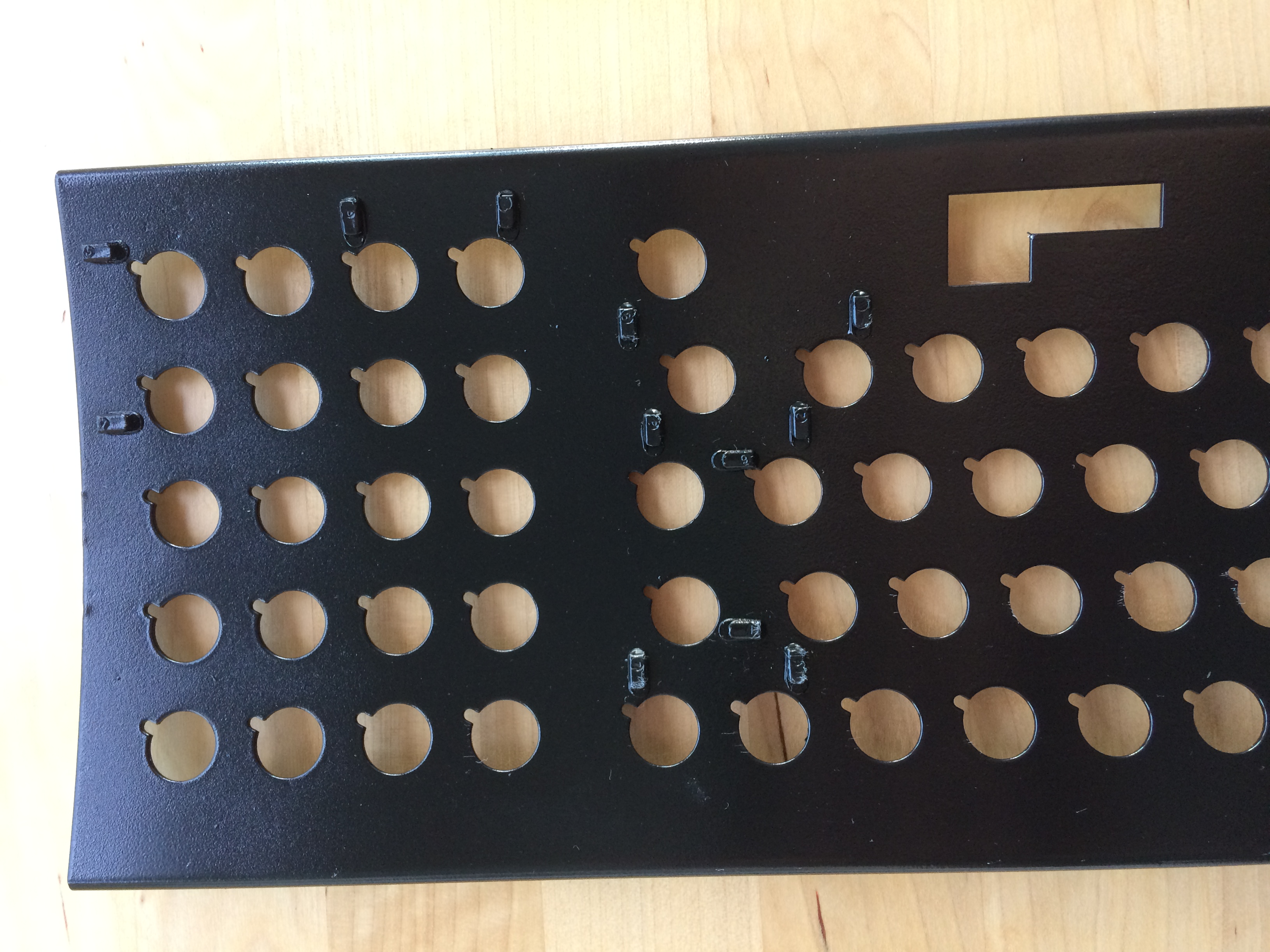

IBM AT Model F – painted barrel plate (focus on stabilizer clips)

I used Hammerite direct to rust metal paint. This is NOT the best choice. It didn't bond well in all places and I didn't wait long enough for it to dry properly. Because I used the thick replacement foam from Ellipse, many clamps were needed to join the two plates and they ended up damaging the paint job despite all the precautions. Regular interior metal paint probably works much better.
