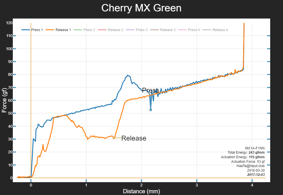

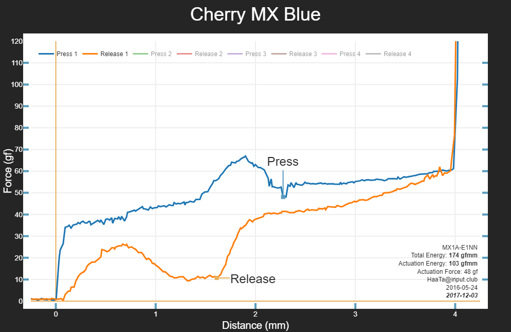

As you might know, HaaTa has made some excellent force-displacement measurements and published the curves.
Here are his plots for mx blue and green:
Cherry mx Blue
Cherry mx Green
As you can see, the slope of the green curve after the tactile and actuation events is steeper than that of the blue curve. This is similar to what is seen with Cherry mx Brown vs mx Clear.
