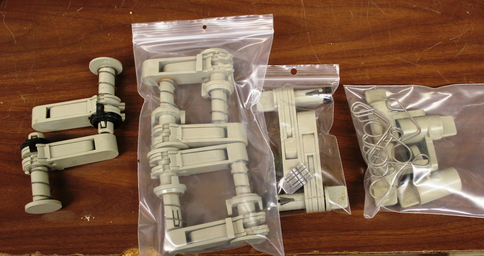

elecplus
02 Nov 2018, 17:35
Feet come in many varieties! I know it is not either of the 2 left ones, because XT feet have "ears". Can people please identify which boards these came from?
All help appreciated!
02 Nov 2018, 17:42
The bag on the right are for the XT.
elecplus
02 Nov 2018, 17:45
I have been told, from right to left, AT/XT, bigfoot, and the 2 left ones are for F122 and some old M122.
elecplus
02 Nov 2018, 18:21
