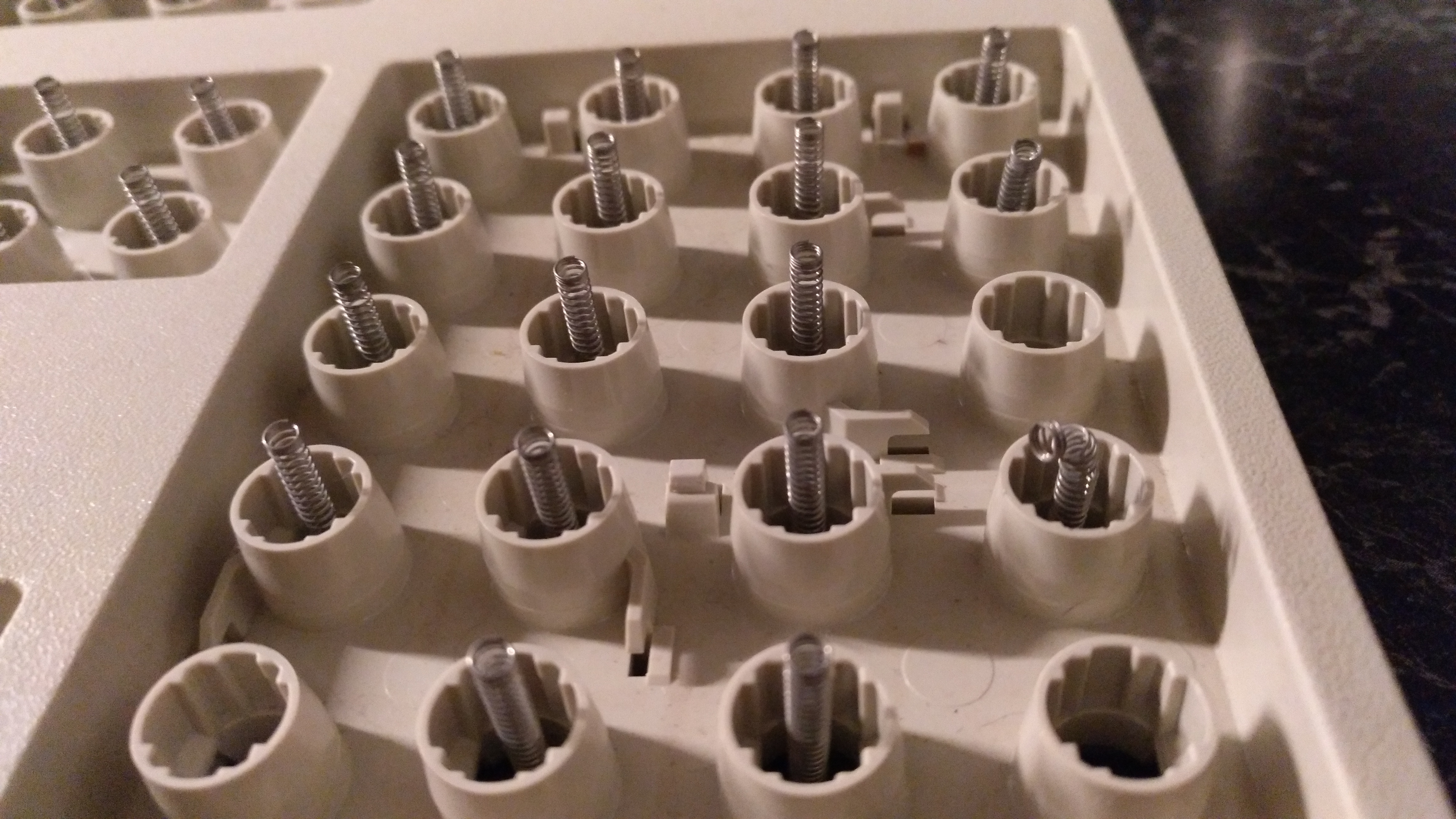

Hello there,

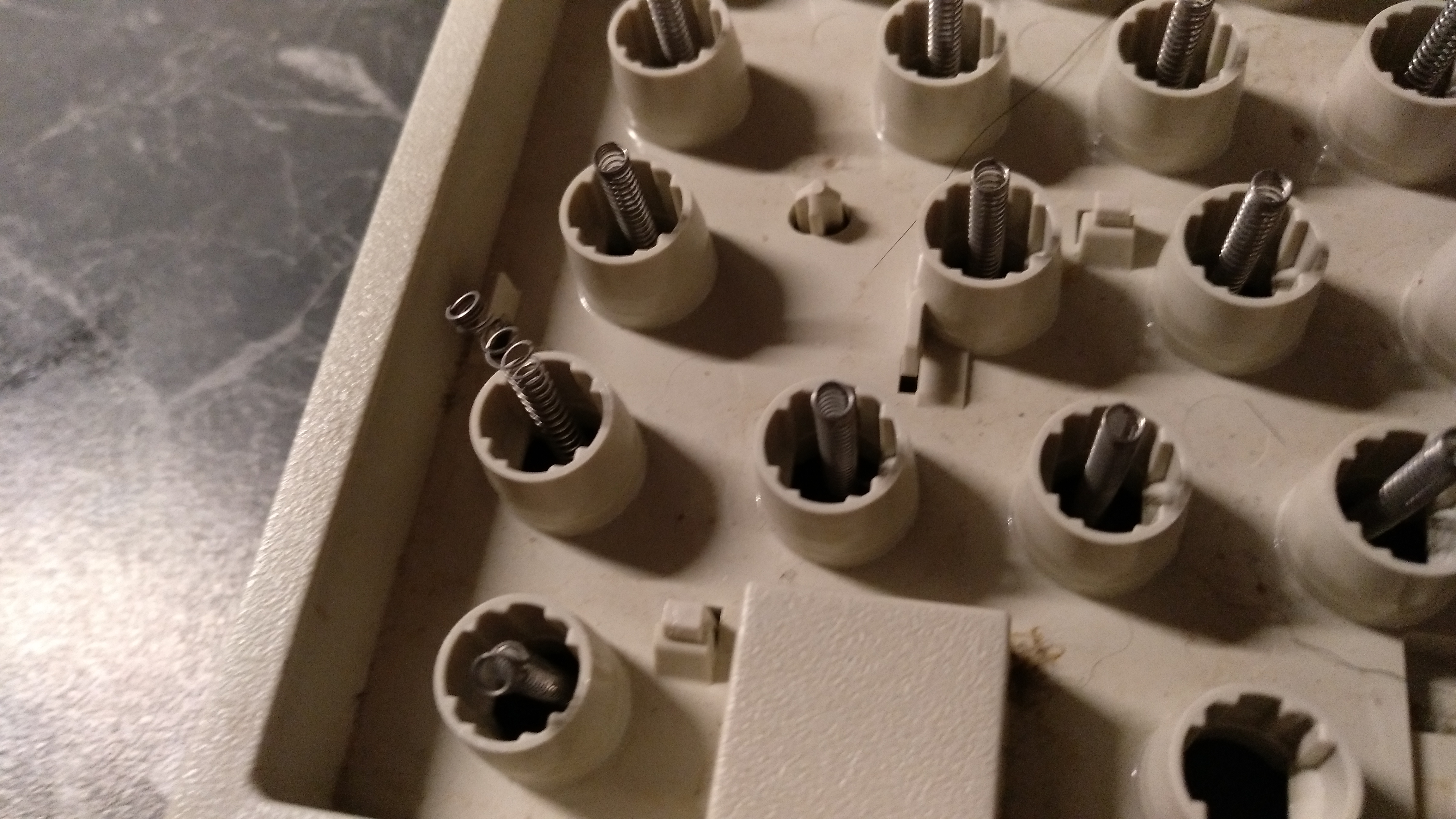

with a little bit of luck and a spelling error I was able to aquire an IBM Model M2 for an reasonable price. The seller described it as working with one ore two stuck keys. Upon receiving it I checked it (removed keycaps using a wire key puller) and unfortunately I discovered some serious bent spings. Some springs were stretched and the spring and hammer for the left ALT key is missing at all. So I came to the conclusion that someone tried repairing it and failed. :evil:
The keyboard also suffers from dried capacitors, but this should not be a problem replacing it.
I know and own Model Ms for decades and know how to remove keycaps without damaging the springs.
Before I go any further in disassembling the M2 I'd like to ask if the springs and hammers are compatible with those from a regular Model M. I have some new Unicomp-made ones in my spares box and it would be cool if I could use those springs to repair the M2.

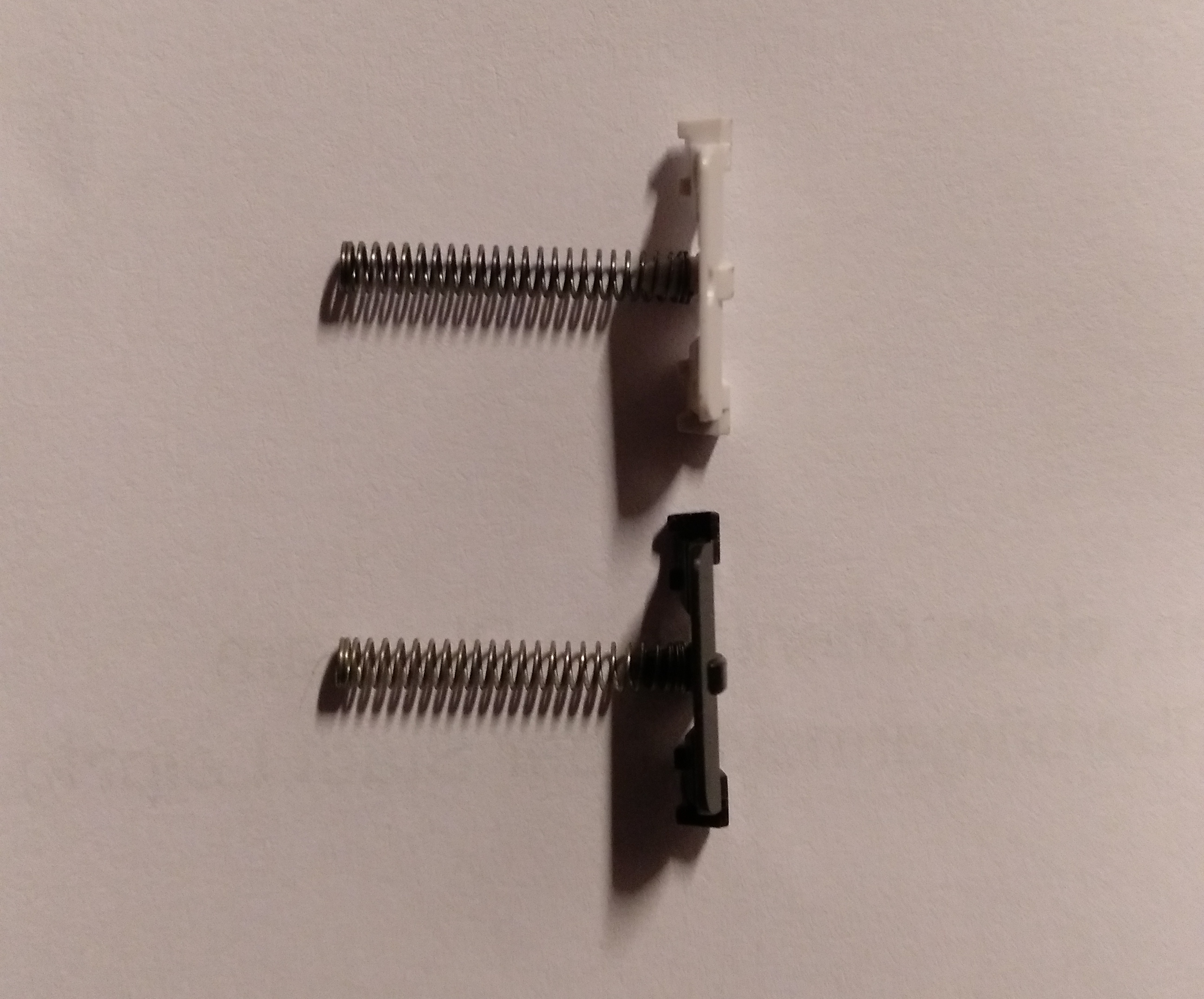

I think they’re different. What with M2’s lower profile caps, and so shorter buckling spring housings. Could be worth an experiment, though. But M2s are a bugger to open up and put back together, as I remember.
digital_matthew
08 Nov 2018, 18:09
I've used Model M springs in M2s with no problems. I haven't tried replacing the hammers, but I think they are interchangeable. Muirium's right, they are a pain to open and close. Be prepared to break a few of the plastic teeth in the process; that's just part of the fun.

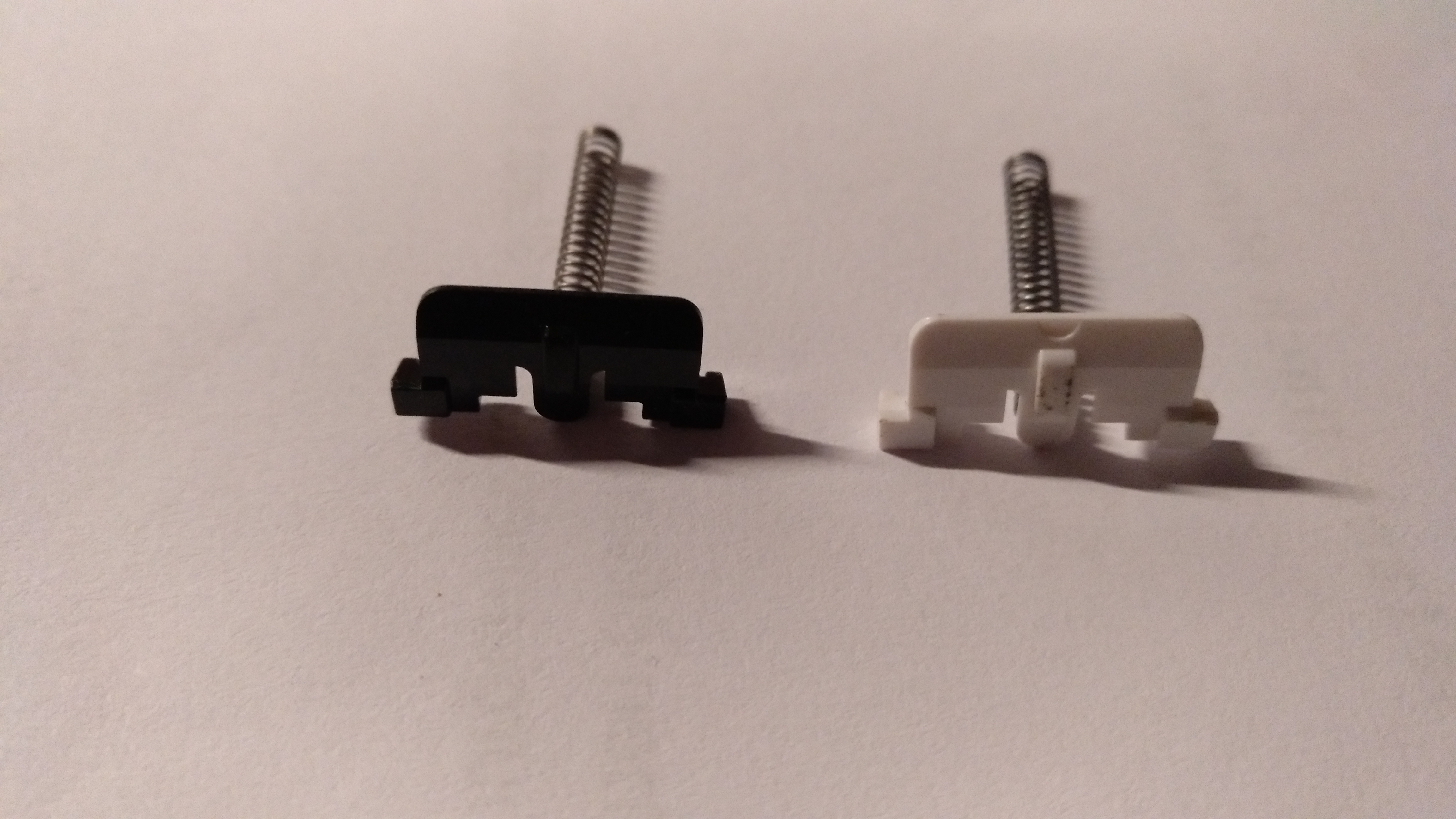

The buckling-spring and hammer assemblies in the Model M and the Model M2 are the same and they are interchangeable.

Thankyou. After close inspection I counted 10 bent or streched springs and one missing. :roll: Nice summary (not). Tomorrow I'll source some replacement capacitors and hopefully the M2 is in working order really soon.

I got it apart without breaking any clips. Indeed the springs and hammers are the same. The black one is from the M2, the white one I bought from Unicomp as a Model M replacement part.
