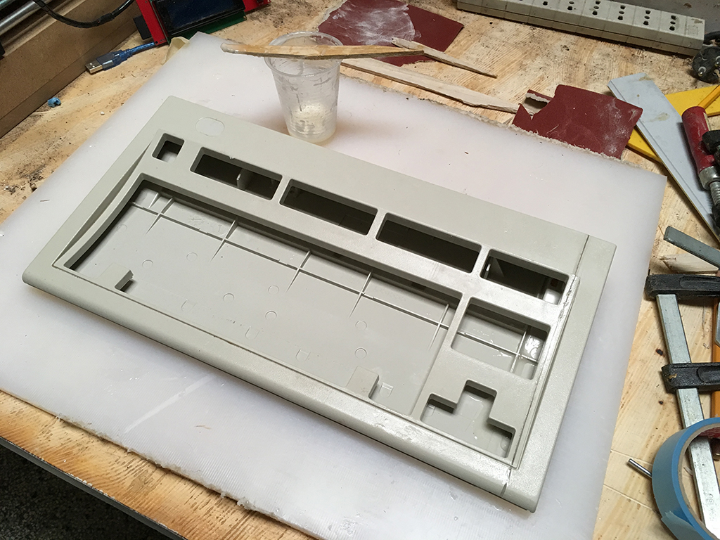

Just finished the epoxy job on my Model M, success!
Photo 26-11-2018, 12 59 51.jpg (597.13 KiB) Viewed 6294 times
It's a bit bigger than a standard SSK, definitely cheaper, and a lot could be done chopping more here and there, but I'm not going to venture past this first chop job.
Still a lot to be done, took some guts to start, but the worst part is over, hopefully.

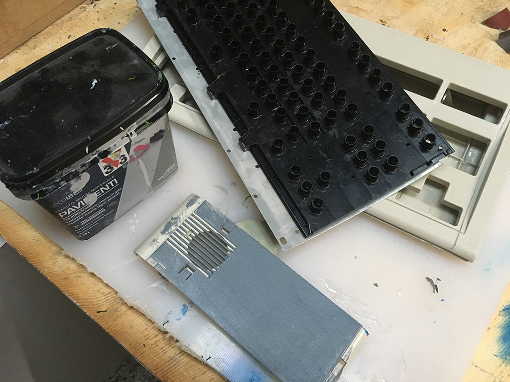

andrea-i
06 Dec 2018, 09:37
All chops done, seams sanded flush, screw mod done, all is ready for the paint job!
Photo 06-12-2018, 09 19 41.jpg (606.38 KiB) Viewed 6062 times
I did an experiment with a water-based resin for floors.
I just used it on my bathroom, might sound funny and a bit inconsiderate, but the stuff is top notch!
It's made to be resistant, thin, perfect coverage of color on any underlying color...and as it turns out, works great on plastic too.
I've pigmented it with some resin colors I had, but I'm not happy with that color yet.
I won't try and match industrial gray, but I want this to be more green-ish.
I can still see a lot of sanding scratches, I'm hoping a lighter sand beforehand and another light sand before second coat will make everything smooth and hopefully still keep some texture.

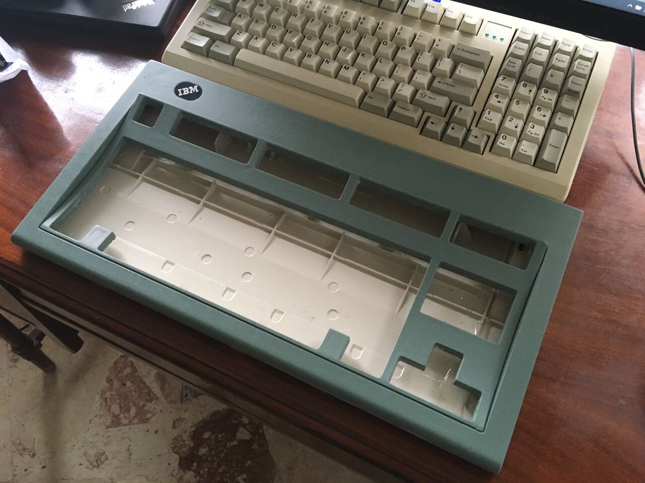

andrea-i
06 Dec 2018, 20:28
Freshly bathroom-resin-coated : D
(read previous post for an explanation)
The texture comes from applying the resin by gently pushing the tip of the brush against the surface at a 90 degree angle, rather than brush-stroking.
This is just the first coat and the finish is pretty good already, tomorrow I'll finish the whole thing, it dries pretty fast and than needs to properly set for a few more days.

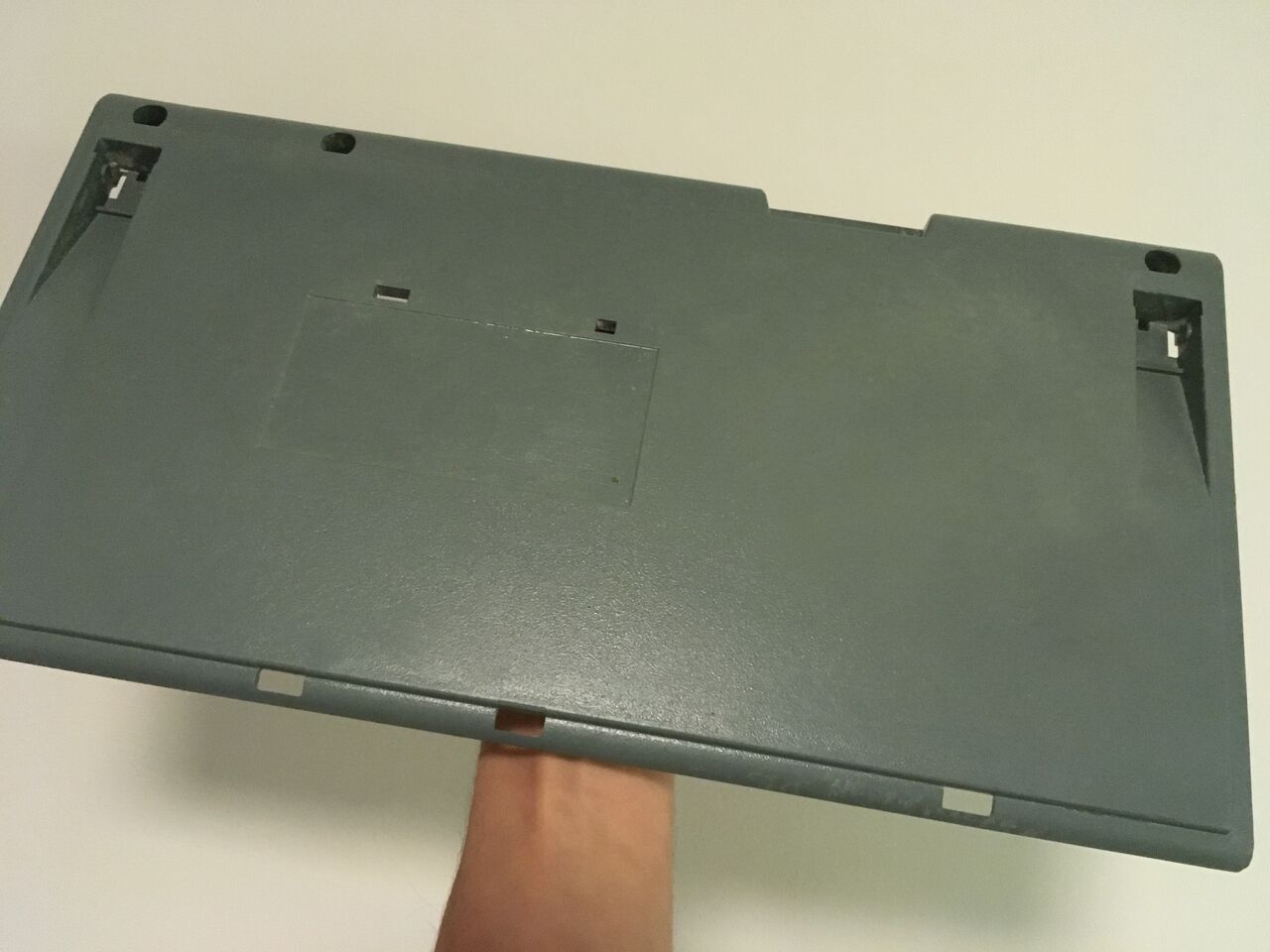

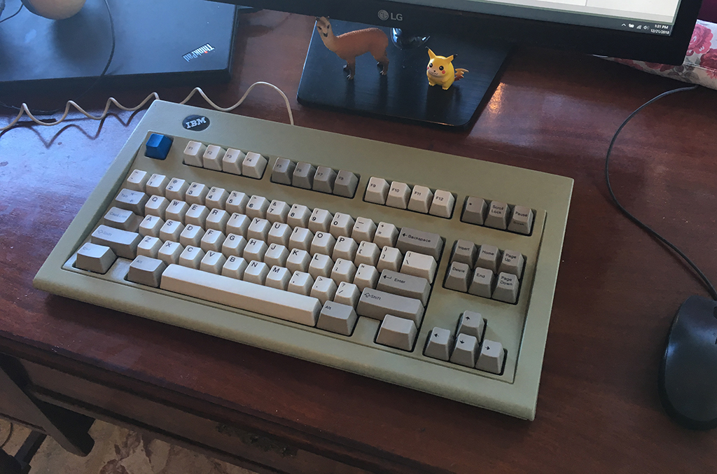

andrea-i
08 Dec 2018, 09:08
Not even close to being perfect, but I'm so impatient to put this on my desk that I will just take it for a spin as it is now : D

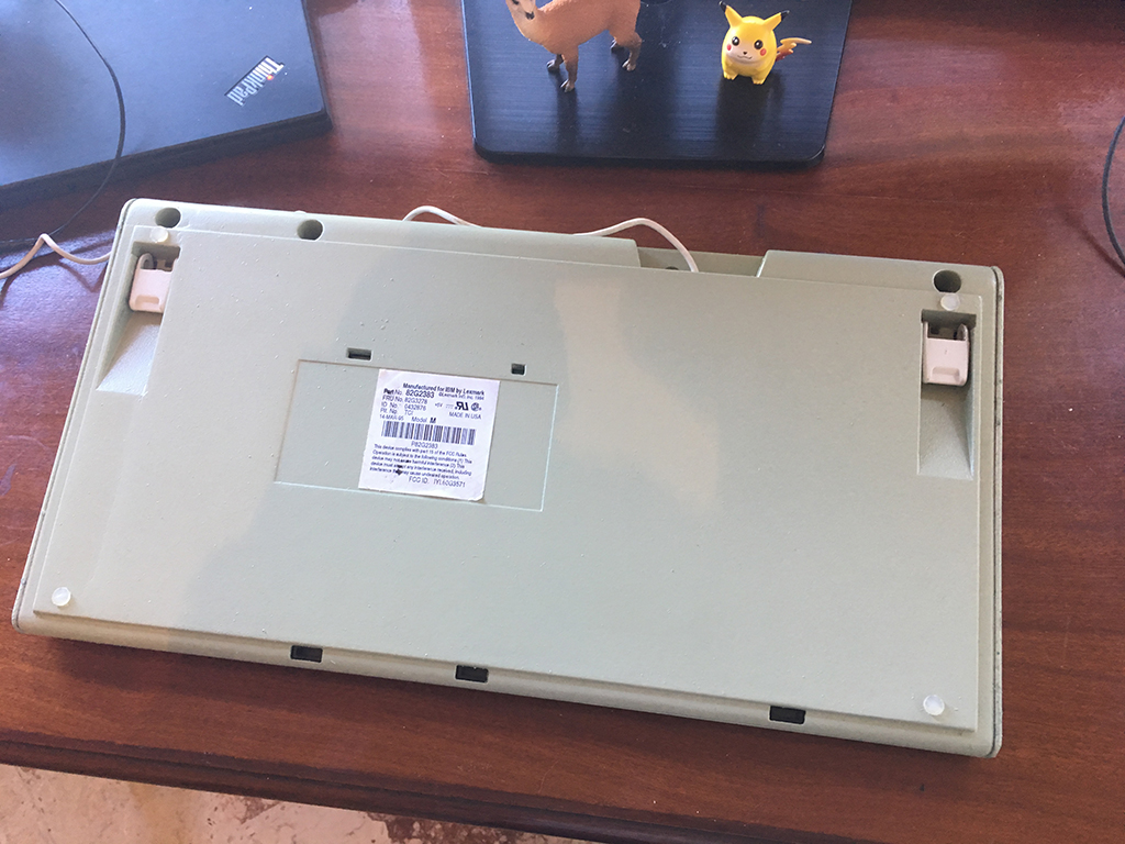

andrea-i
21 Dec 2018, 14:04
After some serious wrestling to perform the screw mod, a total recolor of the case because the whole resin pot did dry on me before the last touches.
After a few broken traces on the membranes, probably due to me fiddling during the screw mod.
So, after a *lot* of screw ups, it's finally done.
Funny thing is, while my M was unusable, I switched to a replacement cherry 1800 with vintage cherry blacks I had but never really used before. And now, I'm so used to those delicate vintage blacks and the awesome 1800 compact layout that I don't feel like switching back my "new" NotSoSpaceSaver!
Oh life is strange : )
I leave you with the photos:
Photo 21-12-2018, 13 31 46.jpg (515.71 KiB) Viewed 5838 times
Photo 21-12-2018, 13 32 43.jpg (535.52 KiB) Viewed 5838 times
Photo 21-12-2018, 13 31 27.jpg (580.25 KiB) Viewed 5838 times

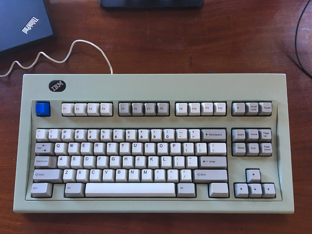

digital_matthew
21 Dec 2018, 18:31
Inspiring and beautiful. I'd like to tackle this myself one day, especially when Ellipse releases his MOPAR keys.
hansichen
21 Dec 2018, 18:44
Nice "mint" colourway, works well with the black badge. I really like these well executed mods, IBM cases are perfect for it due to its design.
OldIsNew
22 Dec 2018, 00:19
Wow nice! Great job for sure! BTW if you don't feel like using it because you like your replacement cherry 1800 with vintage cherry blacks is better, you can send it to me and I'll take it off your hands for free!
22 Dec 2018, 01:38
Wow, excellent work! That looks so clean, I love it.
andrea-i
22 Dec 2018, 11:58
eheh thanks for the advice on how to get rid of it, OldIsNew : D
To be honest guys, it's absolutely not as clean as it looks from the photos, it is still a garage job and once you have it in your hands you can tell.
Thing is, if one is to do such jobs for oneself, then it's totally worth it, the end result is something that ends up being very personal, this is my M and it's unique now : )
I think in order to make it "perfect", one would have to butcher at least a couple of those to get skilled enough with the screw or bolt mod and membrane mods.
