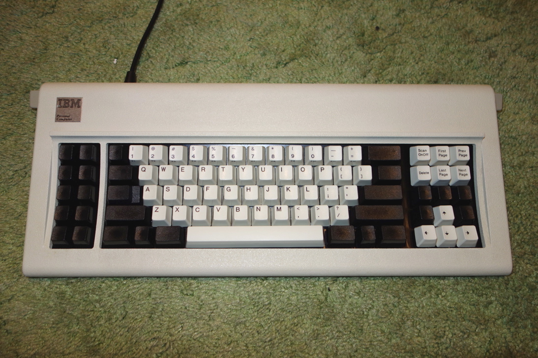

I know there's the XTant and I don' particularly like that solution, this is more what I have in mind:
While we all drool over the new kishies, and have a laugh at some fake sales, I wonder: isn't the original XT just FANTASTIC in terms of ergonomics and form factor?
No idea how much pcb+metal+foam would cost, I guess not that much for the PCBs, with the added cost of machining the metal barrel-holder and laser cutting the mat, it could probably be around the 100ish bucks with enough partecipants?
Would there be any interest? I can offer my service for the plate/mat cad files, unfortunately I suck at PCBing, maybe someone wants to help?

Seems the pic comes from Orihalcon with a f107 board cut and mod, but its still a good idea.
I think there must be someone who could finish the PCB design if even the 3277 pcb has been completed. Xwhatsit could still take over the controller job also, but can't think of how to get the appropriate curved metal plate over the foam, even with the CAD file. Maybe need a machine tool to do the part, or use plastic plate for some substitution?

Yes, that picture is from a geekhack thread on fitting an F122 chopped pcb in an XT case.
To make this into a guilt-free mod kit, we'd reuse the original bottom metal plate of the XT and just work on a new custom PCB + top barrel holder plate + mat.
I now see what you meant about the curved plate, yes that needs addressing, annoying : (

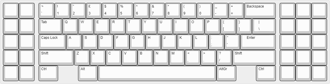

Pardon my ignorance :roll: , but here I'm seeing 83 keys, considering we might need stabiliser barrels for at least backspace, enter and 2 shifts, that adds another 4 barrels, even if we add another two win keys (yack!), isn't the XT layout made of 104 keys?
raw json:
[{a:7},"","",{x:0.25,a:4},"¬\n`","!\n1","\"\n2","£\n3","$\n4","%\n5","^\n6","&\n7","*\n8","(\n9",")\n0","_\n-","+\n=",{w:2},"Backspace",{x:0.25,a:7},"","",""],
["","",{x:0.25,a:4,w:1.5},"Tab","Q","W","E","R","T","Y","U","I","O","P","{\n[","}\n]",{x:0.25,w:1.25,x2:-0.25},"|\n\\",{x:0.25,a:7},"","",""],
["","",{x:0.25,a:4,w:1.75},"Caps Lock","A","S","D","F","G","H","J","K","L",":\n;","\"\n'",{x:0.25,w:2,x2:-0.25},"Enter",{x:0.25,a:7},"","",""],
["","",{x:0.25,a:4,w:2.25},"Shift","Z","X","C","V","B","N","M","<\n,",">\n.","?\n/",{w:2.75},"Shift",{x:0.25,a:7},"","",""],
["","",{x:0.25,a:4,w:1.25},"Ctrl",{x:1.25,w:1.25},"Alt",{a:7,w:7.5},"",{a:4,w:1.25},"AltGr",{x:1.25,w:1.25},"Ctrl",{x:0.25,a:7},"","",""]

An XT has 83 keys, 83 barrels, and 83 flippers. The barrel under the space bar is different though, so should be replaced. You are correct that extra barrels are needed for Backspace, Enter, shifts, and Win keys.

ok thanks, I was too lazy to count and the internet is not always giving you the best answers : D
So, if we take out 5 barrels from the right cluster and make it into a standard tkl layout without winkeys, we should be good.
