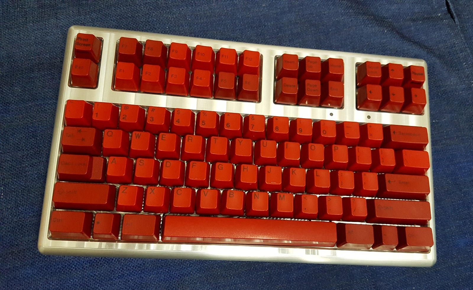

Just over a week ago I received a package and in that package was wcass' unique Model F compact SSK. I've been using it as my daily-driver for about a week now. I've now gotten enough information to give a good, solid review and consent to tear it down and comment on its construction.
Geek Out time :evilgeek:
First things first - this one:
Keyboard Layout / Feel / Sound
It feels glorious. In theory the keys should be slightly stretched on the y-axis but if they are it isn't perceptible at all. Those of us who own multiple versions of the Model F can attest to the different models feel and sound different. This keyboard has the key 'snap' and 'feel' of the XT and the 4704 more than the more 'loosey-goosy-hippie' F-122.

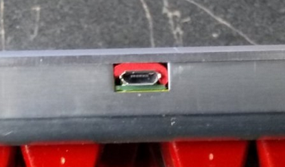

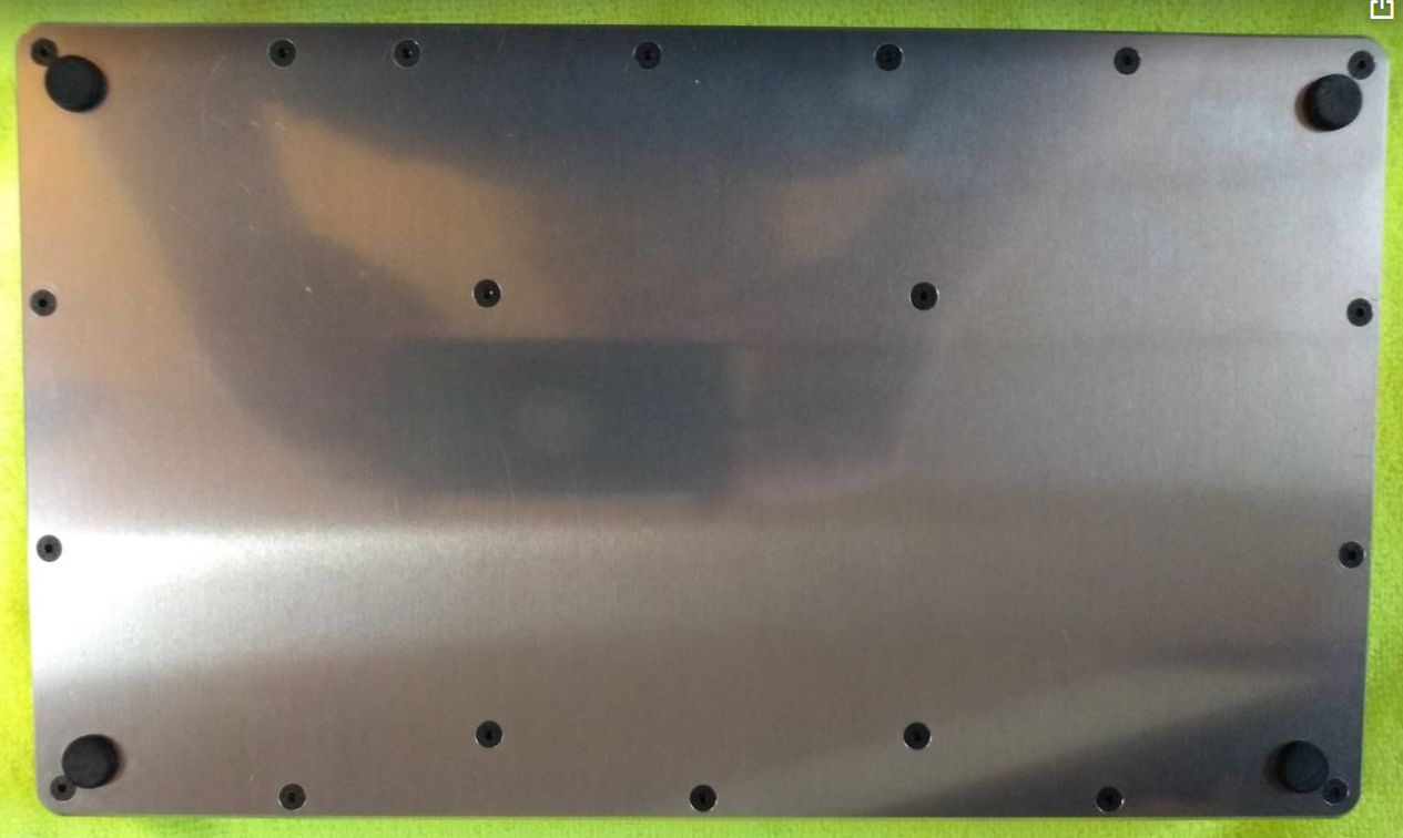

USB micro connection on the top face as you might expect...

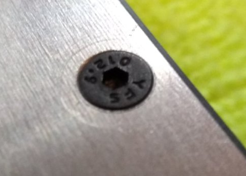

... and HOLY JYR&^F - how many fasteners? :lol:
... needless to say, the back isn't going anywhere. The second thing I noticed was that each of the fastners released with a 'snap' which tells me that wcass either owns a tension driver or is just obsessive with attention to detail.

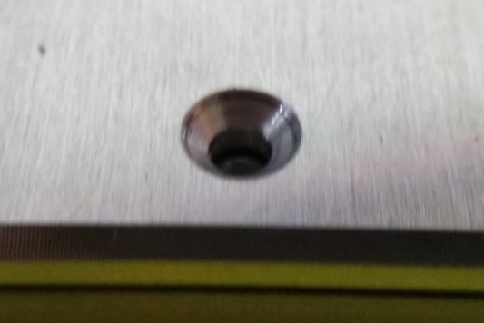

About 15 snaps in, I noticed something else which I always have forgotten to do:
The fasteners have been perfectly countersunk. When they're in they're completely flush - not perceptibly above or below the metal case.

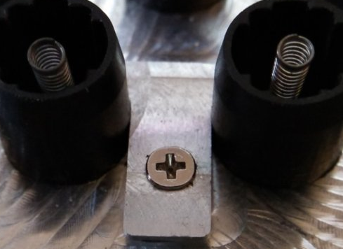

Oh Hello - let's take a closer look at that spacebar retainer...
Yes, even that was countersunk(!).

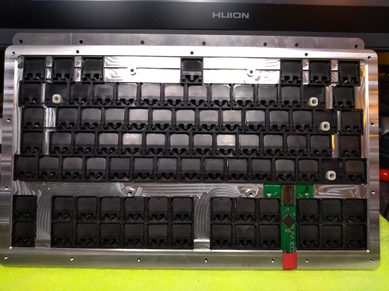

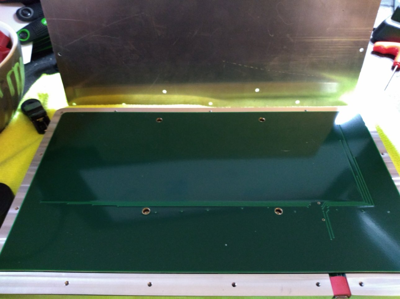

... Let's look at the back!
Nice - it's subtle and hard to see here but the two screenholes you see in the PCB are ground and plated which means that they're making electrical contact with the case itself. You can also see that the USB socket is on a daughter-board which is nice - means one can modify either or both at will with a minimum of fuss.

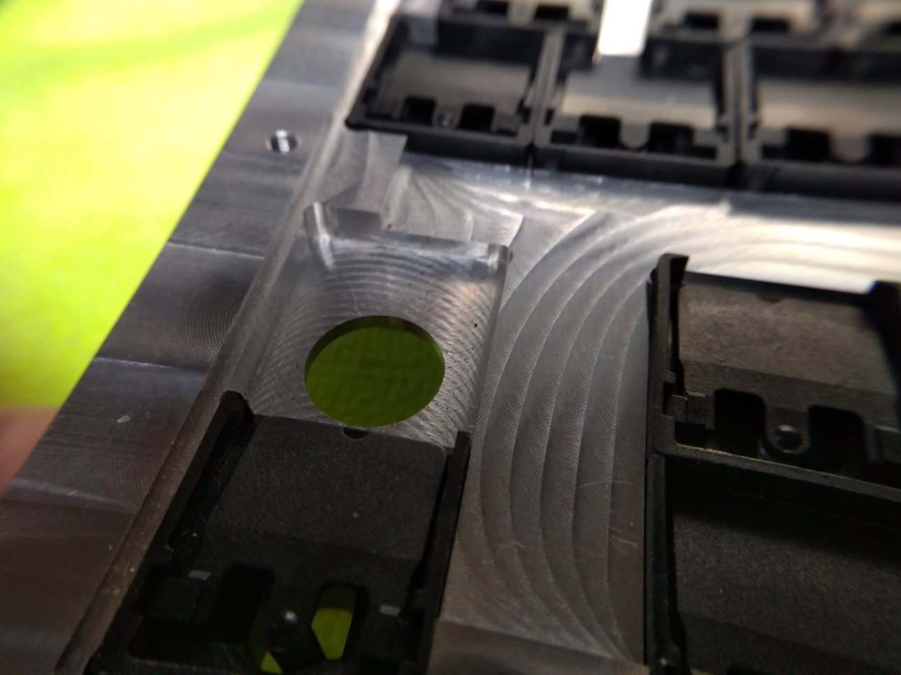

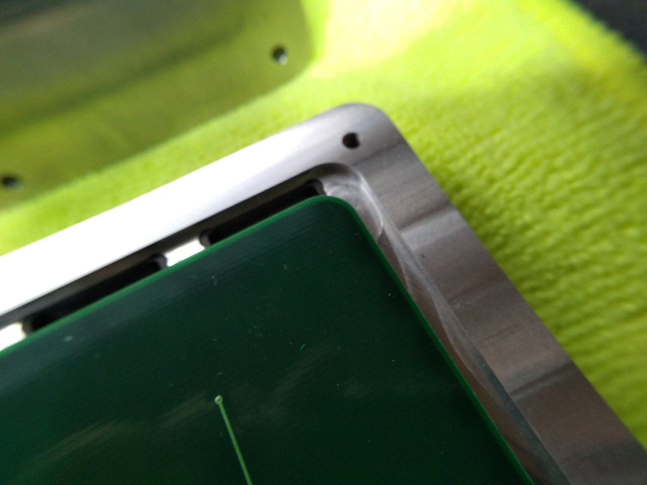

The base of the barrels and the PCB are countersunk into the case. This results in the PCB resting on top of the barrels with no pushing and shoving required. Speaking of pushing and shoving, what about that daughter-board?

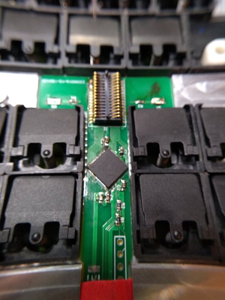

The daughterboard is also countersunk to the depth required such that it makes direct physical contact with the PCB when the PCB is put on top. The daughter-board can move a little when the main PCB isn't there but the posts on the interfacing component alight directly with holes in the main PCB which index the connector perfectly.

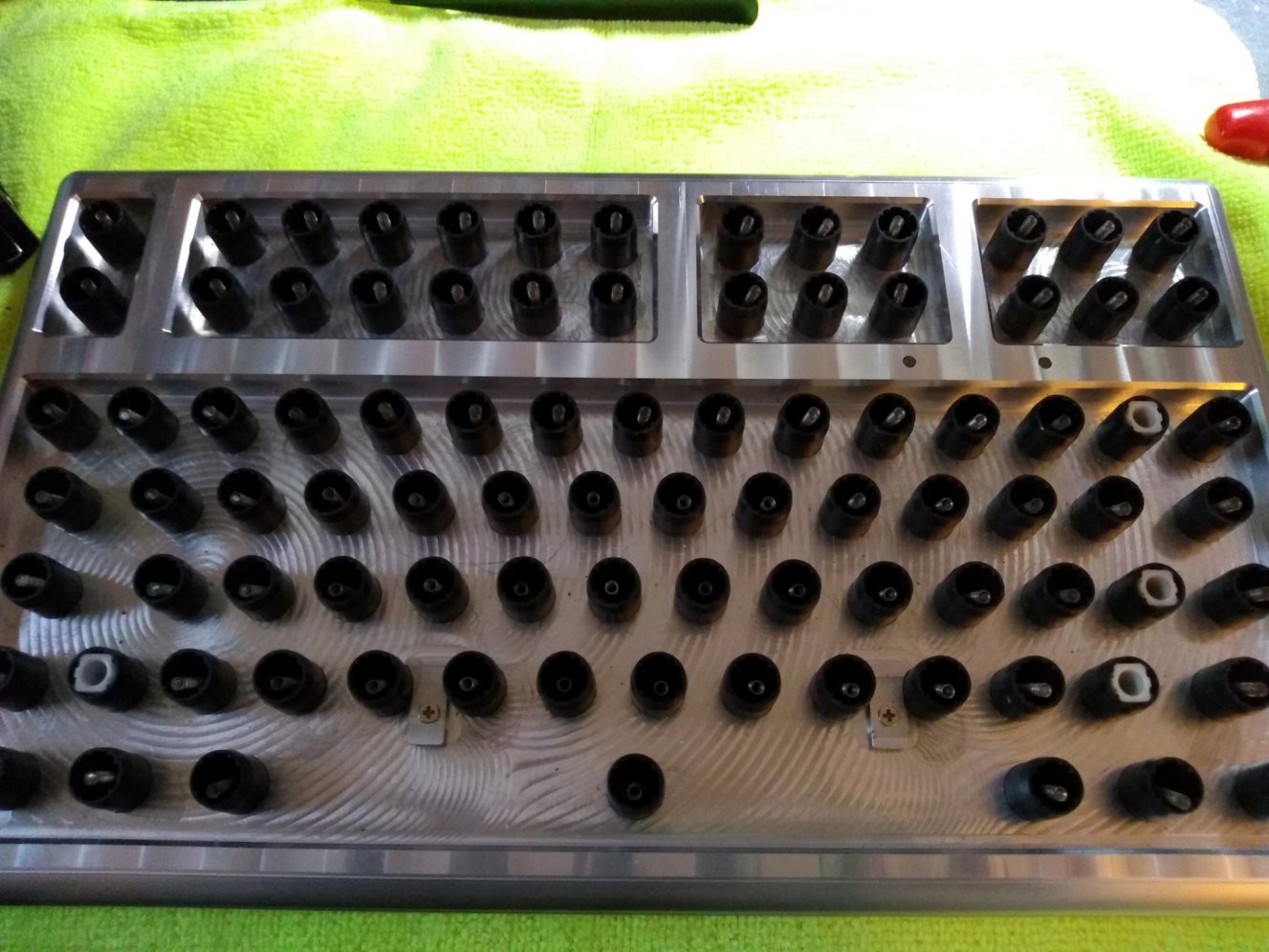

Did I mention earlier that there was no foam and no index pins in the barrels? Then how do they keep aligned so we don't have the barrels rotating? If you hadn't guessed already:
The barrels themselves are also countersunk.
Final View
The final photo which I think says it all for anyone that has ever struggled to re-assemble a Model F. See all those barrels in place? See all those feet in perfect alignment? To re-assemble I just dropped the PCB in. The PCB fell into the cutout that is perfectly sized for it with no fighting or tension or anything. Just add the fasteners and done.

Another way that this design differs from your typical Model F designs is that the PCB is four layer and the controller is directly connected (as opposed to via wires etc from a cypress devkit).
The signal to noise ratio for this board and this design is significantly better than even my original IBM produced beamspring PCB. That's food for thought right there.
