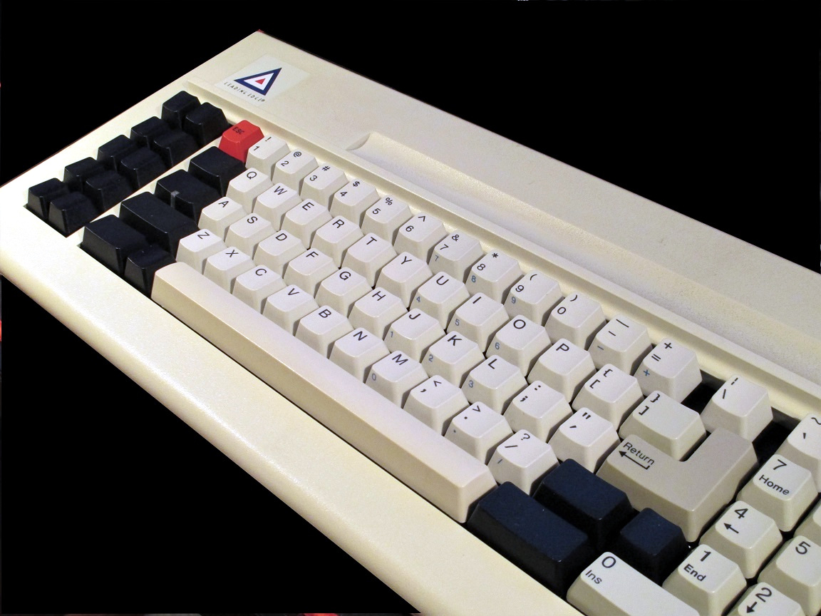

Here is my latest keyboard project, a Leading Edge DC-2014 with SKCM blue Alps switches.
MODIFICATIONS:
Spacebar switch: Replaced slider, spring, and click leaf with corresponding parts from a Matias Quiet switch.
Lube: Super Lube 21010 synthetic grease on all stabilizers and on flip-out feet hinges. Super Lube 51010 synthetic oil on Spacebar and Return stabilizer posts.
Spacebar and Return shock absorbers: Thin strips of polyurethane foam applied to plate under the stabilizer inserts.
Case: The stock case amplified the sound of the switches more than I would like and imparted a wooden timbre. To modulate these effects, I packed the case with strips of terricloth and padded shelf liner.
USB converter: Internal Orihalcon/Soarer ATmega32U4 on a Pro Micro board.
Remapping: HHKB-esque
Panel mount USB connector: Mini-USB.
Keycaps:
Alphanumerics (except Rbracket): IBM 5140 dye-sublimated PBT
Numpad, Rbracket, Return, and Spacebar: Stock doubleshot ABS
Modifiers: Matias blank black ABS
Esc: SP doubleshot ABS
Leading Edge DC-2014 Keyboard

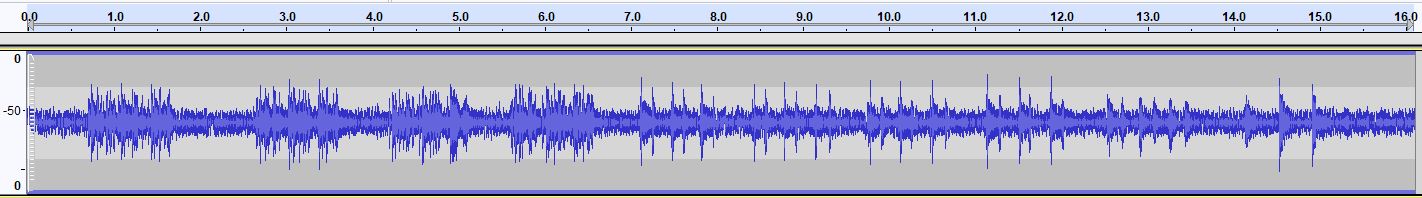

Amplitude (db) vs. time (sec)
Typing sequence, 3 times each of the following:
098 poi lkj .,m Rbracket (remapped as Backspace) Return Rshift CapsLock (remapped as Rgui) Spacebar Thump on case
Video with typing sounds
