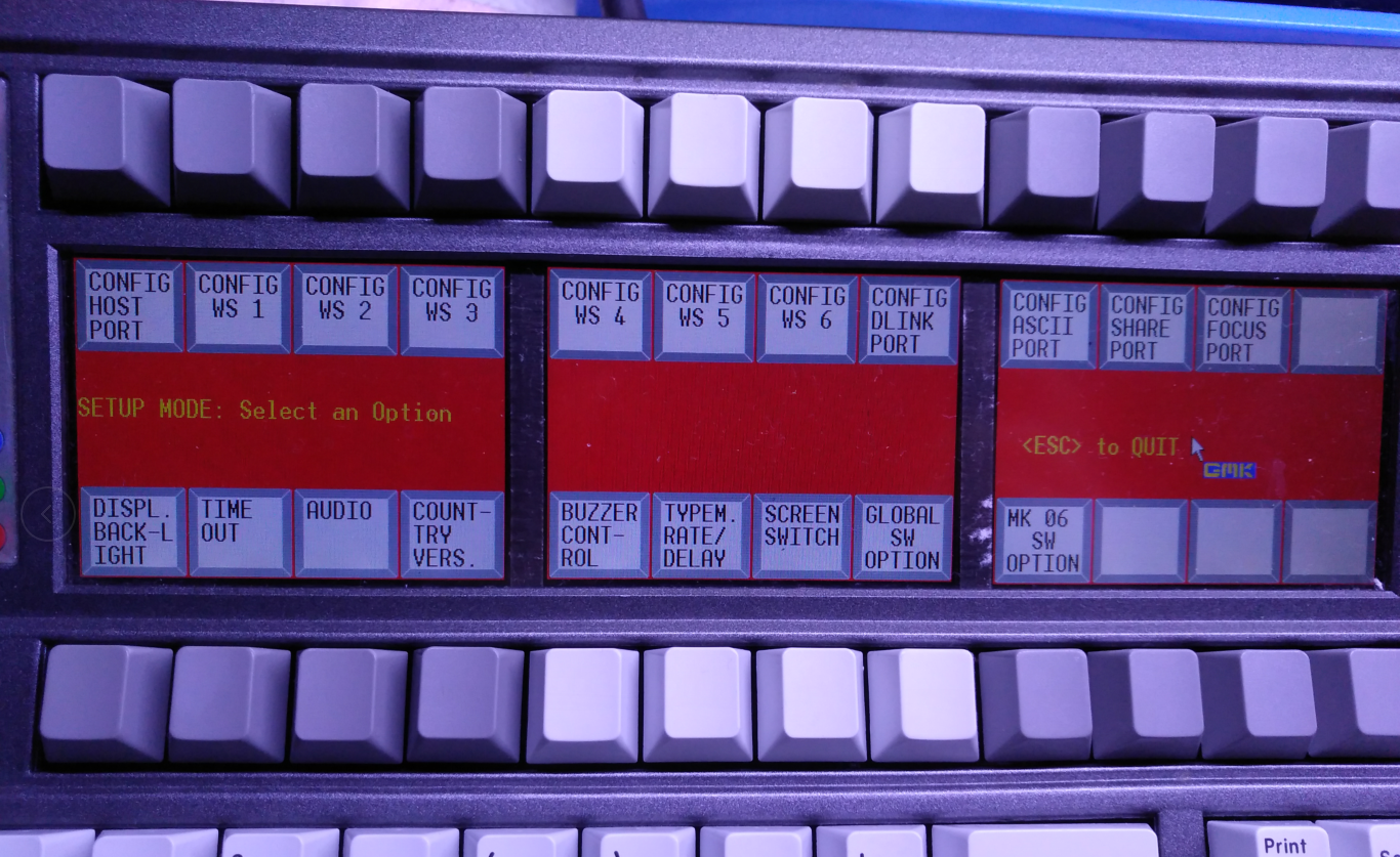

  4. Arrived at the splash screen, press the CTRL + ALT + Logoff/System buttons simultaneously. You should land on red configuration screen.
  5. Navigating the configuration screen is done using the buttons above and below the screen, along with ESC/RETURN to return and save options. Enter CONFIG WS 1.
  6. Toggle WIN NT EMU and enter VIA DLINK EXTERN.
  7. Press CLEAR ALL ADDR, press USB1 30 (if the option is yellow, press ENTER) and then press EXIT WITH SAVE.
  8. Press ENTER and then ESC until the keyboard reboots.
  9. Arrived at the splash screen, press the WS1 button next to ESC.
  10. Ta-da! Your keyboard should be functional and usable with a modern computer!

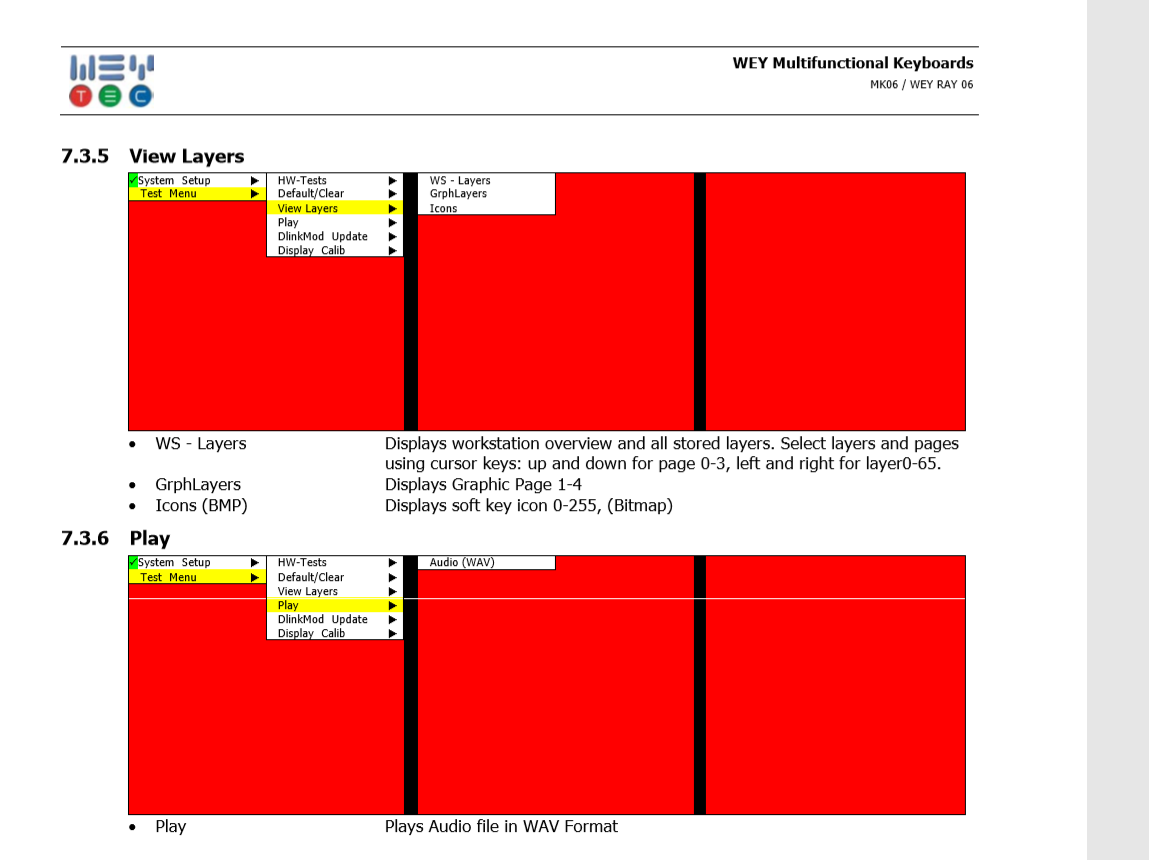

Purchased Converter Box va from Germany, connected to the keyboard, can work initially. So I want to find more features, maybe the parameter settings are messed up, and now I can't connect to the PC. The RESET button on the back of the keyboard does not depend on resetting the keyboard parameters. I want to reset the parameters completely. My firmware V1.17 doesn't seem too different from yours. In addition, I downloaded the manual on the Internet and did not find the [TEST MENU] option on the keyboard. My email address: sunxkui@yeah.net

You'd need a flash drive formatted fat32, with 2 folders on it: MK_WR06\Download . Once inserted into the back of the keyboard it will give you the option to upload or download. You want upload in this case. The entire file structure should only be a few megs. The process is detailed on page 44 of the manual here:
