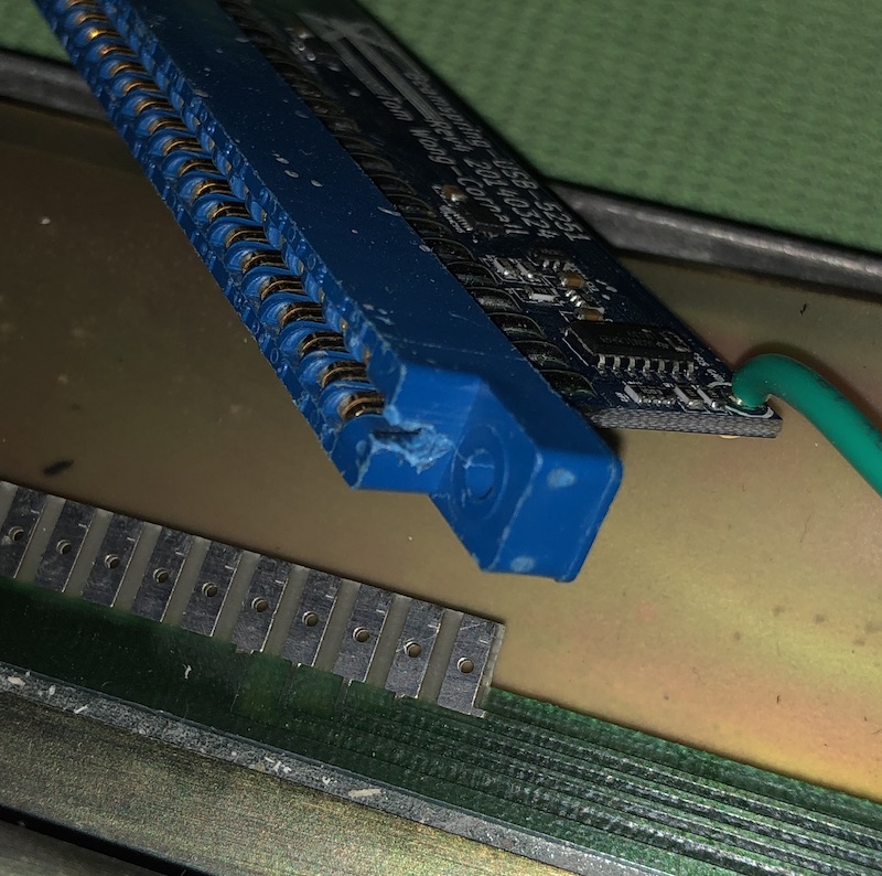

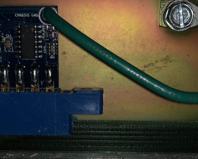

With my keyboard it was actually quite hard to get the controller to fit and I had symptoms like this. Does your connector have the one side filed down? the pcb is not straight across and one side needs a notch to be flush with the connector.

SneakyRobb wrote: 28 Feb 2019, 19:28 With my keyboard it was actually quite hard to get the controller to fit and I had symptoms like this. Does your connector have the one side filed down? the pcb is not straight across and one side needs a notch to be flush with the connector.
I have made a cut myself in the connector as shown here:
Here's a view on how it is connected to the PCB itself:
