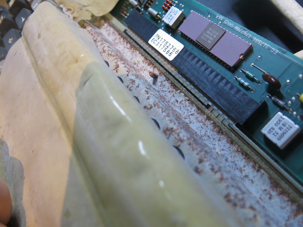

My IBM 5251 in the original unrestored state was way more rusted than the previous boards I had in my hands. I have seen worse ones on photos, but not in person. Nevertheless, I had a lot of fun in doing the restoration:
I feared the worst before opening the Metal Assembly Board. Not knowing what was ahead of me, I had no doubt that I have to do a proper job in de-rusting.

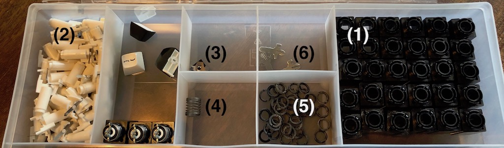

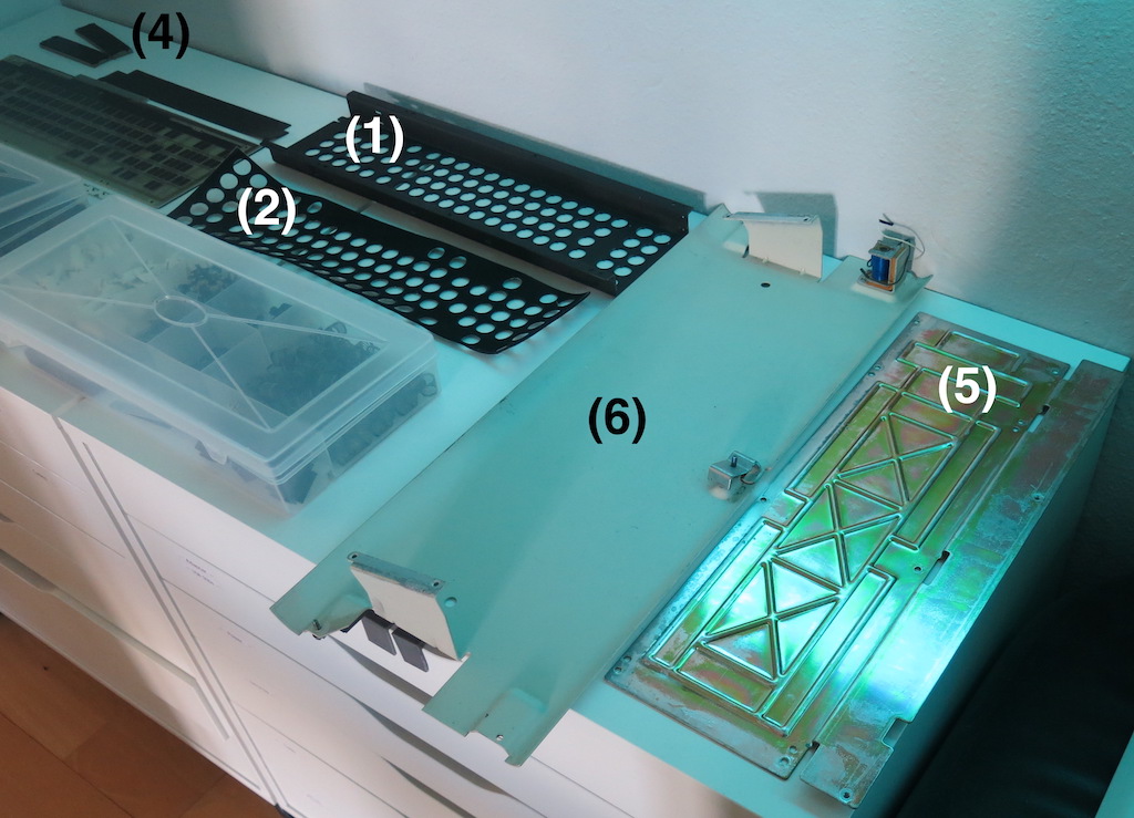

In my last post, I forgot to explain the different bits and pieces of a complete Beamspring keyboard, hence I’ll do this now:
  • Key or Switch Module
    • (1) Switch Housing
    • (2) Slider with riveted beam spring
    • (3) Fly plate
    • (4) Return Coil
    • (5) Rubber Damper or Washer
    • (6) Plunger or Metal Stem

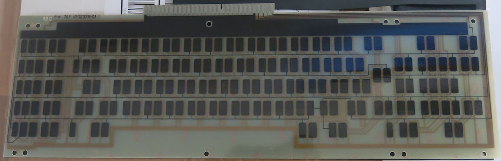

  • Pad Card (Two-layer PCB covered in insulating substrate)
  • Metal Assembly Board
    • (1) Metal Switch Housing
    • (2) Foam
    • (3) Gaskets (shown on the second picture)
    • (4) Dust Cover to left and right
    • (5) Bottom Switch Plate (that holds everything together)
    • (6) Bottom Case

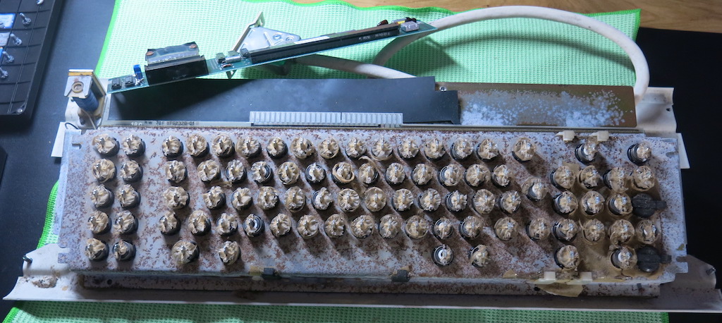

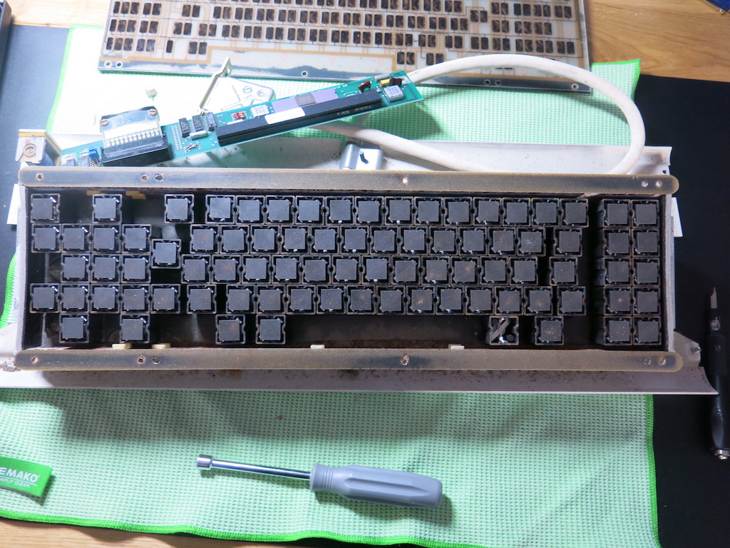

Unscrew the switch housing from the bottom case, turn it around, so the top side of the switches look away from you, like shown below:
You now can unscrew the Bottom Switch Plate, which now looks towards you. It contains eight screws in total. Once done, lift it off. You should be able to remove three pieces now, the Bottom Switch Plate, the Pad Card (PCB) and the insulating rubber mat. Put them aside – you should be able to see the switches now:

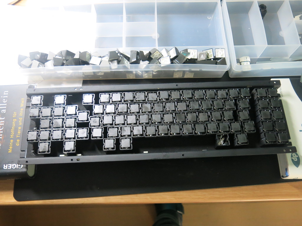

Remove all individual key switches by carefully wiggling them out. They should get out fairly easy. Place the switches on a cardboard or in a box (not a big thing if they fall apart, we will dis-assemble them anyway later on).

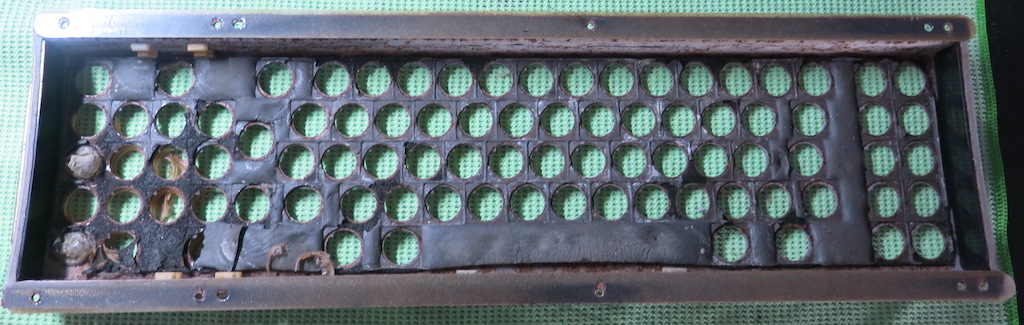

Most likely you will have a disintegrated foam in front of you after the switches are removed and you will look at something like in the picture below:

Step 3: Clean the switch plate (get rid of the foam or what is left over)
Originally, the foam was on top of an adhesive plastic strip. There are two ways to remove the foam and strip. Either way, get gloves on first (believe me).
Either you use a heat gun and remove the plastic strip together with the rest of the foam (which would be the preferred method) or you do it like I had to do it (the foam was too much dissolved already).
I first removed the foam using a small palette-knife. After I removed the black foam, I went with a heat gun. With the same palette-knife, I could remove most parts of the plastic strip underneath. Even when I was finished, the switch-plate was still full of goo and rust. This combination is hard to come by. I used a brush to get most of it off.

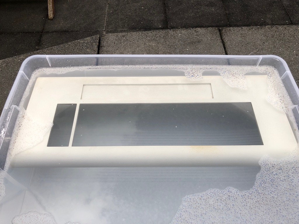

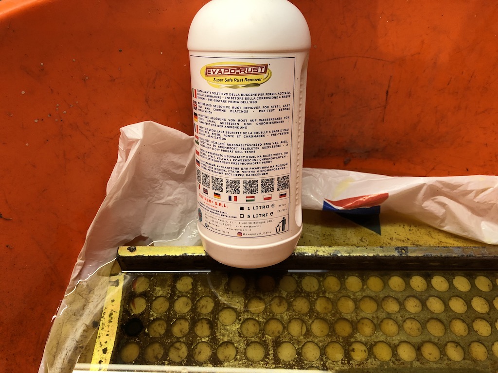

As rust was the dominant thing left, I took a tub, placed the Switch Plate in it and emptied two bottles of Evapo-Rust on top of it. To cover the full switch plate, I also added another two liters of water (this will increase the time required to de-rust and I had to leave it in the solution for 7 full days).

Get at least six large enough boxes ready for the parts of the switches. As described already in the beginning, there are 6 primary parts and I showed also a picture of them earlier.
Step 1: Taking the Switches apart:
There are multiple ways described on how to take the switches apart. For me, the easiest method was a plastic box which could be split apart. I drilled a hole into one end that had the diameter of 10mm. This box is only to get a better grip and limit the possibility of damaging the switch (yes, again, they are expensive and rare).
Now, place the switch in the one half of the box, so that the metal stem and O-Ring are on the outside and the rest of the switch on the inside. Then take pliers, grab the metal stem and pull on it (sometimes as hard as you can). The stem will slide out and the whole switch can be disassembled. As I had to do this about 90 times, I spent half a night on this task and had sore muscles in arm and shoulder the next day.

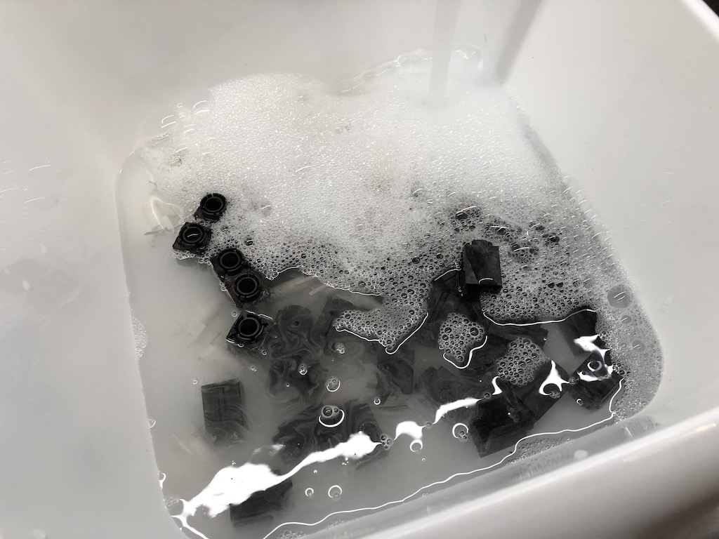

Step 2: Cleaning the Switches:
Plastic Switch Housing:

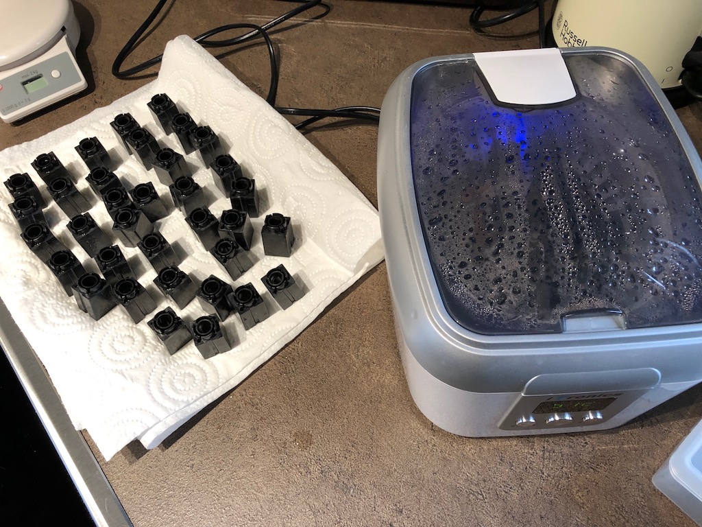

I put the Switch Housing, Slider, Return Coil, Rubber Damper and Plunger (but not the Fly Plate!) into a bath with mild soap for a day. After that, I cleaned them with a tooth-brush and clear water. At the end, I put them in an Ultrasonic cleaning bath and finally rinsed them in de-mineralized water.
Dry them by placing them on a towel for 24 hours.
Step 2: Coil and Plunger de-rusting and cleaning
Some of the coils have not only been dirty, they also have accumulated rust. Even, if you don’t see rust on your coils at first sight, the de-rusting is super important. The stems on this 5251 have accumulated a lot of rust and needed treatment as well.
Put about 25mm or 1 inch of Evapo-Rust fluid in a plastic box. Add the Coils, Plunger and Space bar and other Stabilizer Wires to the bath and leave them in there for at least 1 day. I left them in for 2 days due to the condition.
After the evapo-rust procedure, I cleaned them with de-mineralized water and let them dry in the sun.

The O-rings have been dirty as well, I cleaned them with Soap-water and put them into the Ultrasonic Bath. Finally they also got a little Ballistol to bring back the shine.

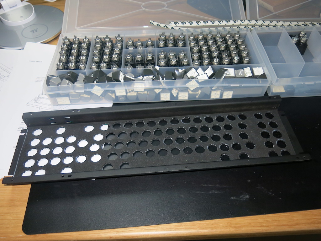

Step 1: Replacing the foam
Replacing the foam is one of the most important tasks that you need to do. Especially, if the keys are wobbling around. I also found out that the sound is very much dependent on a proper fitting of the switches.
First of all, you need a foam that is cut to a size of 435mm by 100mm (2mm thickness). In my case this was simple, as I already had a 100mm wide band that I only had to cut at 435mm. I used a Guillotine cutter for this to get a very straight cut.
Next, I placed the foam underneath the switch plate so that the side of the foam was looking towards me. You need to align the foam perfectly at this point and I used glue strips to hold it in place.
Next, I turned the switch plate around and started to mark every hole with a white marker on the foam.
Once every hole is marked, the switch plate (template) can be put away and we can concentrate on the foam.
Use the 15mm Steel Hole Punch, place it on top of each marked circle and punch out the hole. In my case, I only had to put some slight pressure on it and wiggle it a bit to punch the holes into the foam
Once all holes are punched, I put the foam away, as the Switch Plate wasn’t ready, yet.
Step 2: Finishing the de-rusted Switch Plate and Spray Painting of it
The Switch Plate was de-rusted in my case, but the bare metal was facing towards me. I took sanding paper (400 grid) and sanded down all little spots of rust that I could still see. Finally, I gave the whole plate some more sanding.
In a last step I used de-mineralized water to clean it completely and gave it a final inspection.
I put the switch plate on hooks and gave it a nice spray coating using a black paint that is helping to keep rust away. I let it dry for 24 hours.

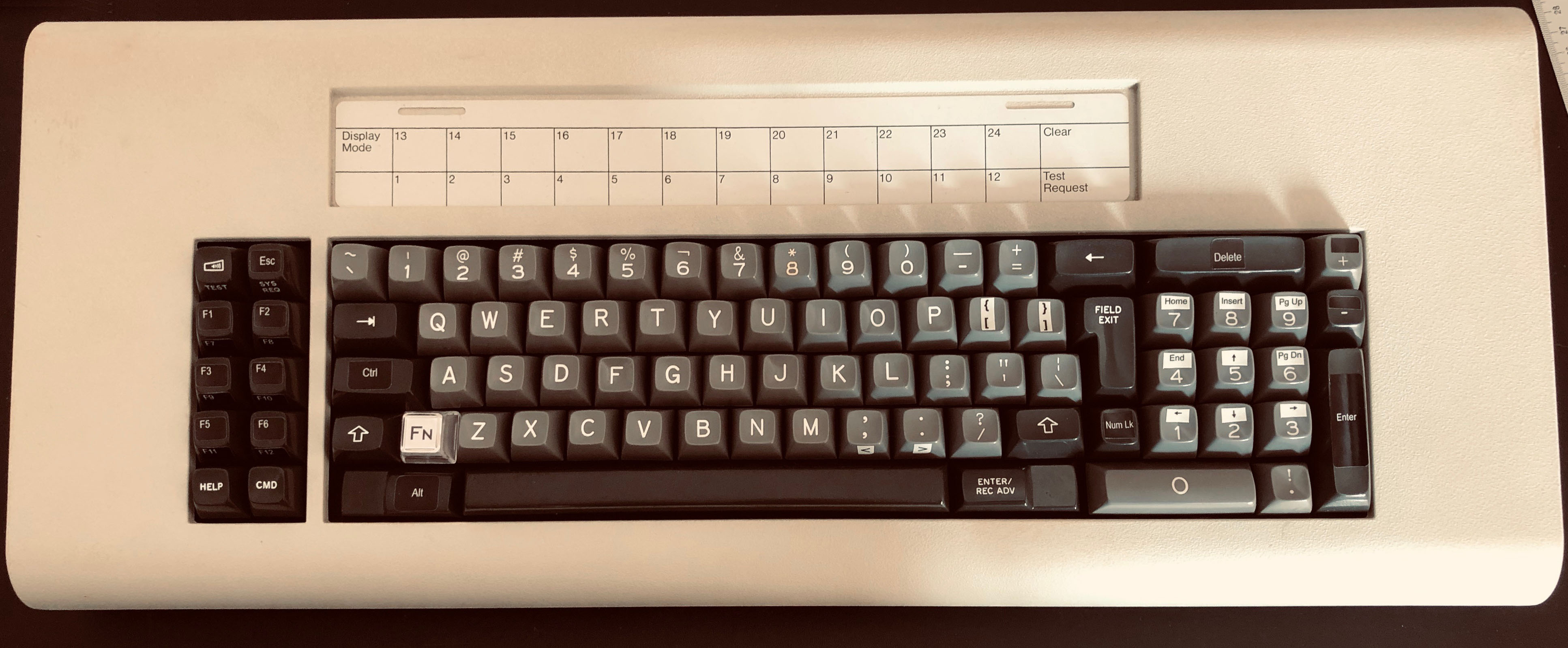

Before screwing everything back together, I also cleaned the top case for a full day in cleaning agent and rinsed it afterwards in clean water.
I also added an xwhatsit controller and made some modifications to the keycaps. I don’t want to get into details during this restoration guide, but the final outcome looks like this:

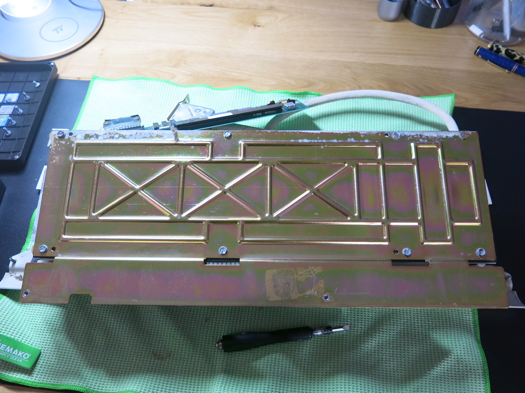

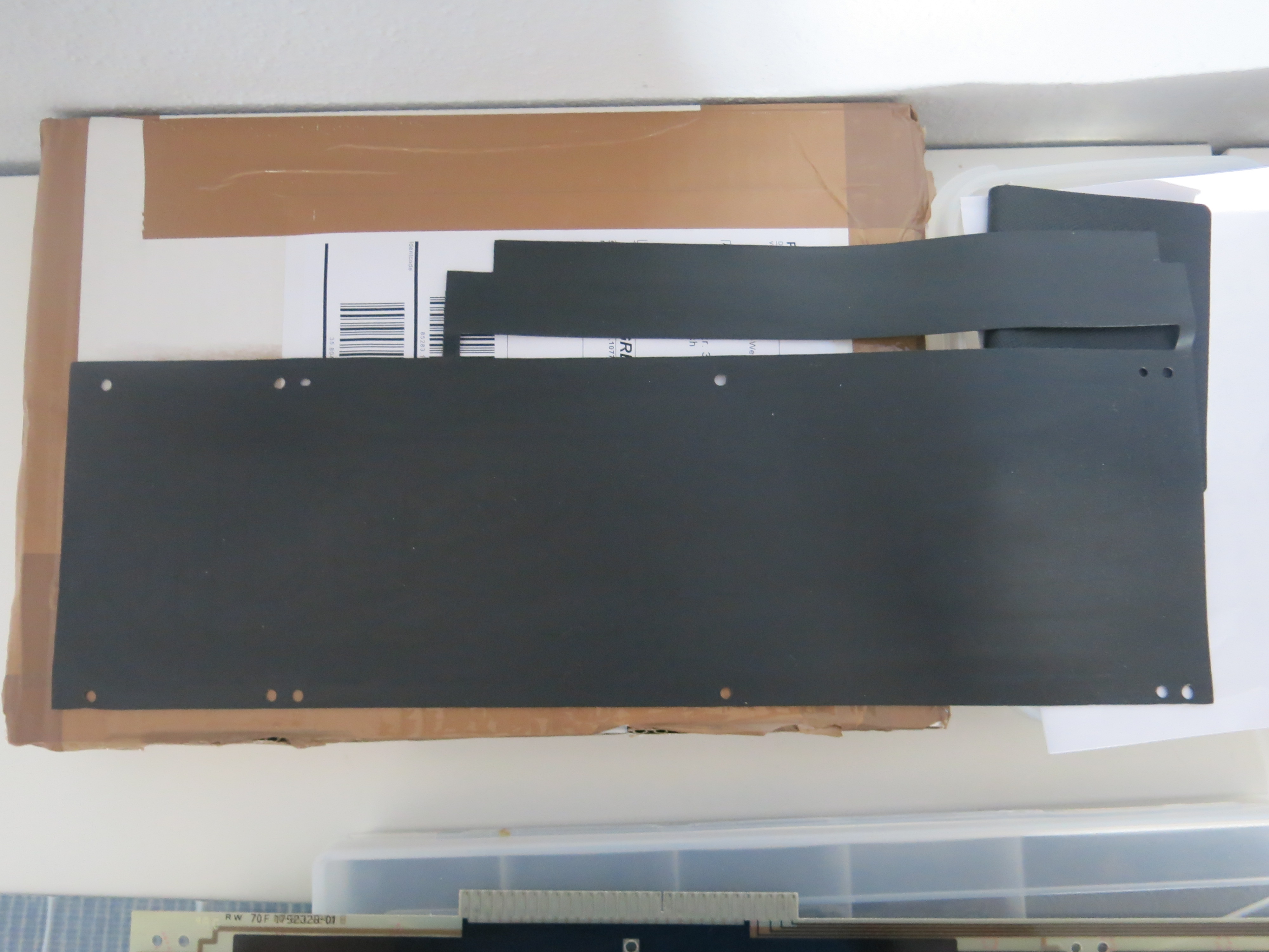

Do anyone know if the crossed grooves in the lower metal plate have any use?
I always ask myself why did IBM bother to make that grooves...
Are they functional to the PCB , capacitance or whatever?
Luca
darkcruix
18 Apr 2019, 18:31
They are just for higher stability - the stuff is built like a tank ;)
inmbolmie
19 Apr 2019, 19:21
lucar wrote: 18 Apr 2019, 17:25 Hi! Great work! And lucky owner !!
Luca
There is a plastic sheet between the plate and PCB with the same groove pattern so that it fits the plate perfectly, that sheet is there for insulation, protection and to press the PCB uniformly against the switches. I suppose the groove pattern is there for better fitting of that plastic sheet.
Can be seen in this post, step 7
viewtopic.php?t=19574
darkcruix
19 Apr 2019, 20:29
Hi,
great info. My insulation mat did look completely different (as did the PCB):
lucar
26 Apr 2019, 00:18
inmbolmie wrote: 19 Apr 2019, 19:21
Luca
Thanks all for the info !!
Luca
lucar
26 Apr 2019, 00:27
darkcruix wrote: 19 Apr 2019, 20:29 Hi,
Is that mat a new one or just the one that came with your beamspring?
darkcruix
26 Apr 2019, 01:28
It came with it and looked like it was in there from the beginning (had a ton of rust on it before cleaning).
AJM
26 Apr 2019, 12:43
inmbolmie wrote: 19 Apr 2019, 19:21 There is a plastic sheet between the plate and PCB with the same groove pattern so that it fits the plate perfectly, that sheet is there for insulation, protection and to press the PCB uniformly against the switches. I suppose the groove pattern is there for better fitting of that plastic sheet.
In my 5251 the plastic/rubber sheet looked exactly as in this picture.
But that sheet is completely flat. The pattern was only transferred by oxidation (or something like that) from the plate to the rubber sheet.
