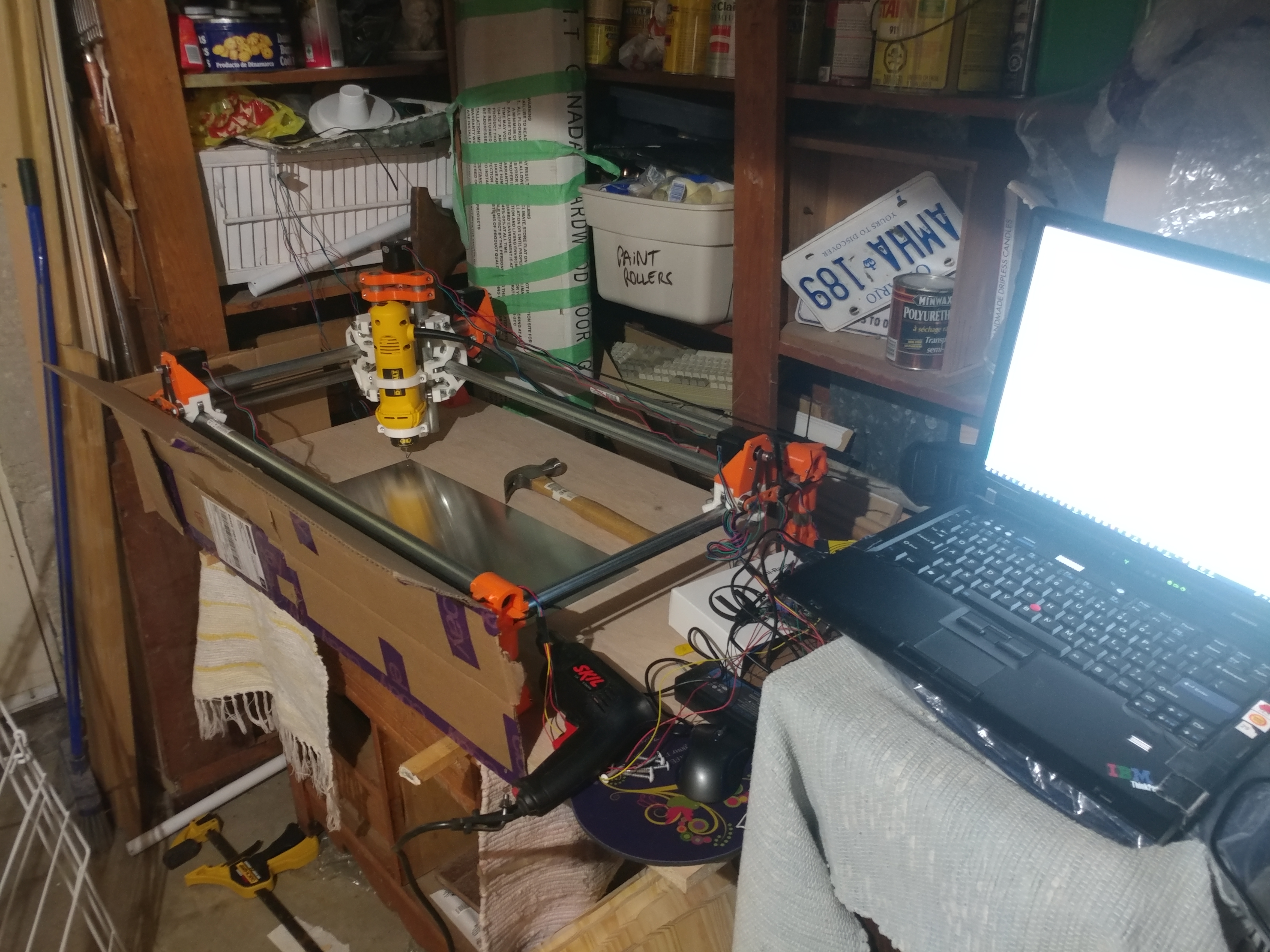

Hi, thanks and sure.
It is the Mostly Printed CNC and while very DIY tier, and it works great for what it is.

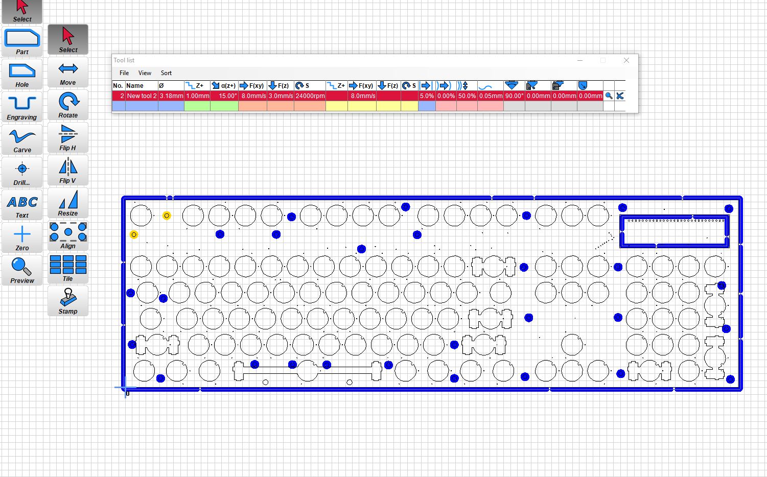

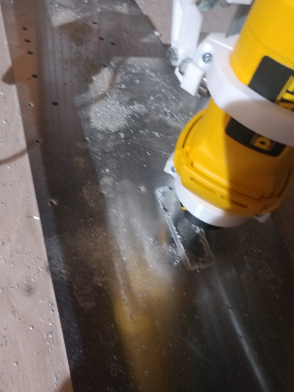

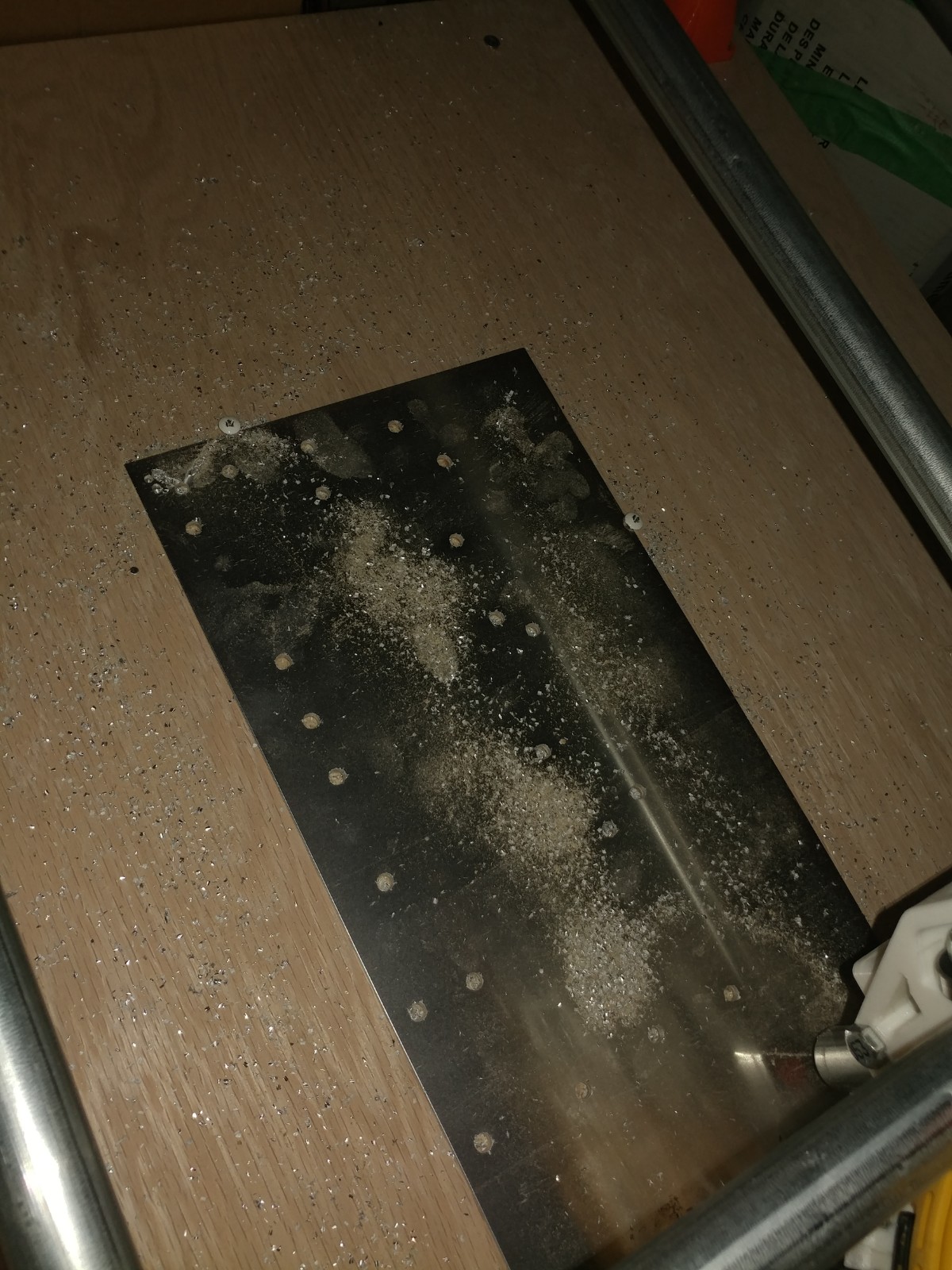

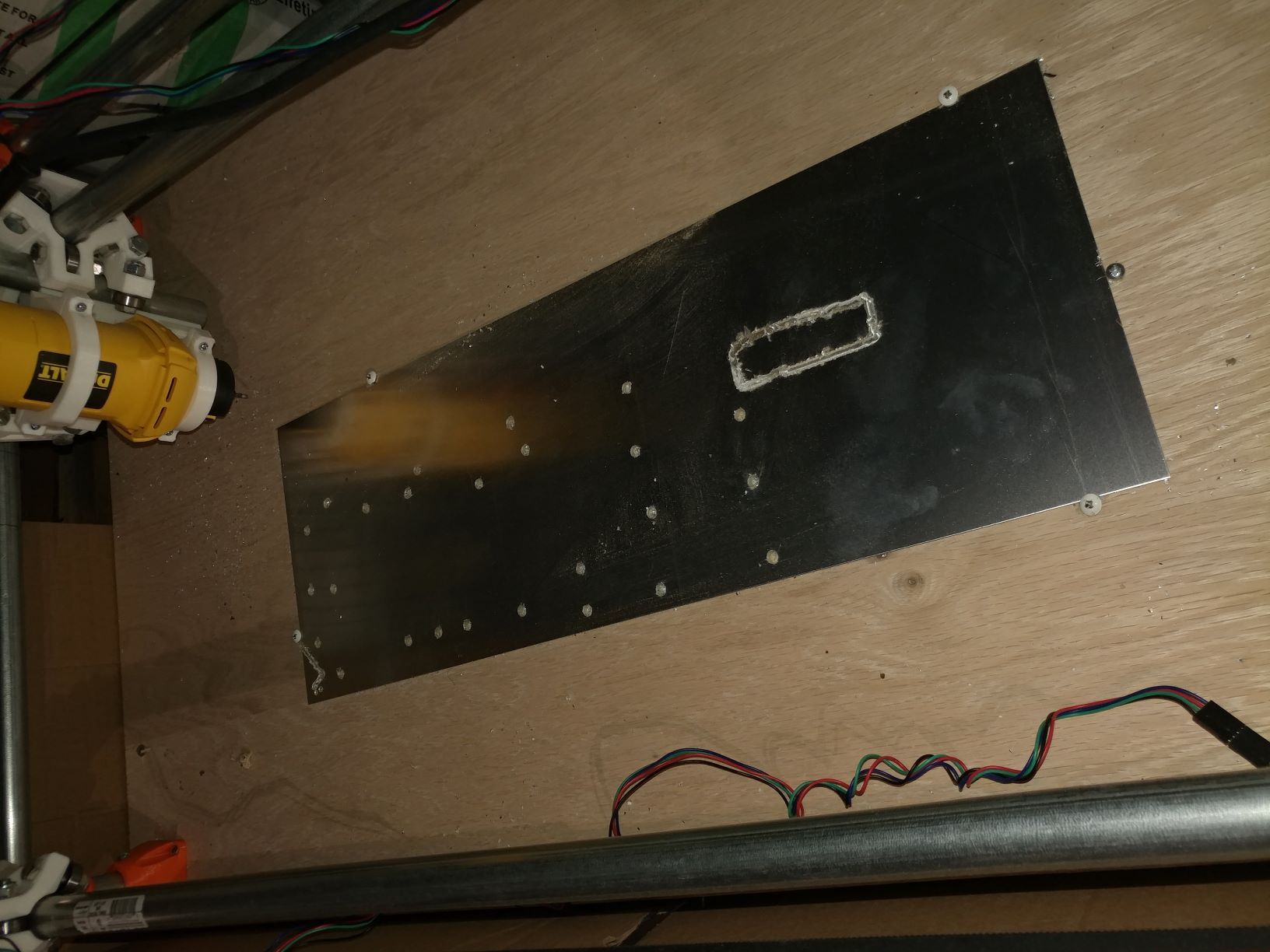

It has been somewhat intimidating and I am honestly quite new to it, but I was able to get some space in my parents house for it so why not. Below is the bottom plate that I tried to mill yesterday. It is for the beamspring model M style layout. It was not successful but attempts were made!
My settings need to be adjusted quite a bit. It was going okay with the holes until the window... Then I discovered the feed speed was too great. I am learning at this point. The screw holes are quite big.
I am debating if I want to make a sandwhich case for it maybe of plastic.
When it got to the "window" it started sort of skipping and crashing, obviously the rectangle is not square. I probably should had tried foam first but I like to jump in.
I am using ESTLCAM to make the gcode and then repetier to run it.
The metal plates are about $4.50 CAD each. I wanted to make the metal plate of brass and wanted to use the less expensive aluminium first.
