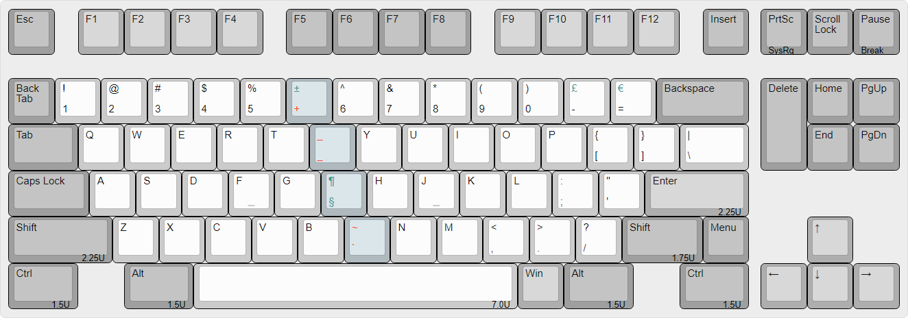

Let's fire up KLE, load a TKL form factor (there won't be any differences on the alpha block for full-size and larger) with the US English national layout and tinker a bit.
TKL ANSI with extra column (US English national layout).
In this first approximation, we can see that this TKL looks like a... TKL.
  • The four light grayish blue keys in the middle of the alpha block are new.
  • The top left key in the alphablock is now a Back Tab key.
  • LSHIFT is untouched.
  • The function row now has plenty of space, enough to add a new 1U key there (since it definitely can't be F13, for the obvious reasons, we'll leave that for later). Note that it's now symmetric.
  • The US English layout remains essentially the same, with the only changes (marked in red) being that the BACKQUOTE key (containing ` and ~ ) has been moved to R4 in the middle column, and that I chose to move the plus and minus signs to the base layer, right between the numbers, because why not?
  • Green squares signify newly available positions on both the base and the Shift layers (the AltGr layer remains unused, obviously).
  • Tsangan-style bottom row, because we're civilized people here. The space bar would have been 8U, so I chose to split it into two 4U keys for now (more on this later on). Note that the bottom row is fully symmetric, and while the space bars aren't symmetric to the alphas themselves, they're both positioned with the same offset with respect to the homing keys on each side (F and J).

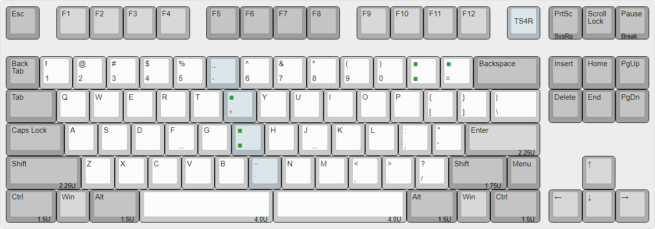

It's rather dashing so far! So let's see how this goes if we go with a smaller form factor. First, a 75%:
75% ANSI with extra column (US English national layout).
ANSI style again, alphas untouched. In the bottom row, the space bars have been shrunk to 3U, to accomodate the Fn key and the leftshifting of the RALT and RCTRL keys. The one thing I don't like of this layout is that the correspondence between the numbers and the F keys is lost after F5.
That said, some people have taken to use 0.25U separators in the F row of normal 75% keyboards... and in this wider form factor, this can be pulled off with little pain.

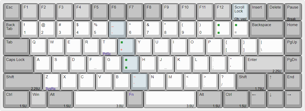

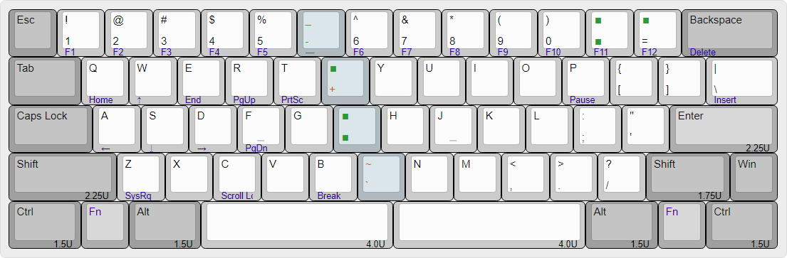

What about a 60%?
60% ANSI with extra column (US English national layout).
Whisk off the Win key to a side, put Fn keys where they belong, and it looks pretty usable! The only issue here is, again, the loss of contiguity between F5 and F6 (and it would probably be wise to ensure that that Fn-key assignment in between stays unused).
It's quite tempting to move the \ and the | characters to the middle column, make the 1.5U key an HHKB-style backspace, split the 2U Backspace key and put Insert and Delete there... but that should wait until a revised US English national layout is actually produced.

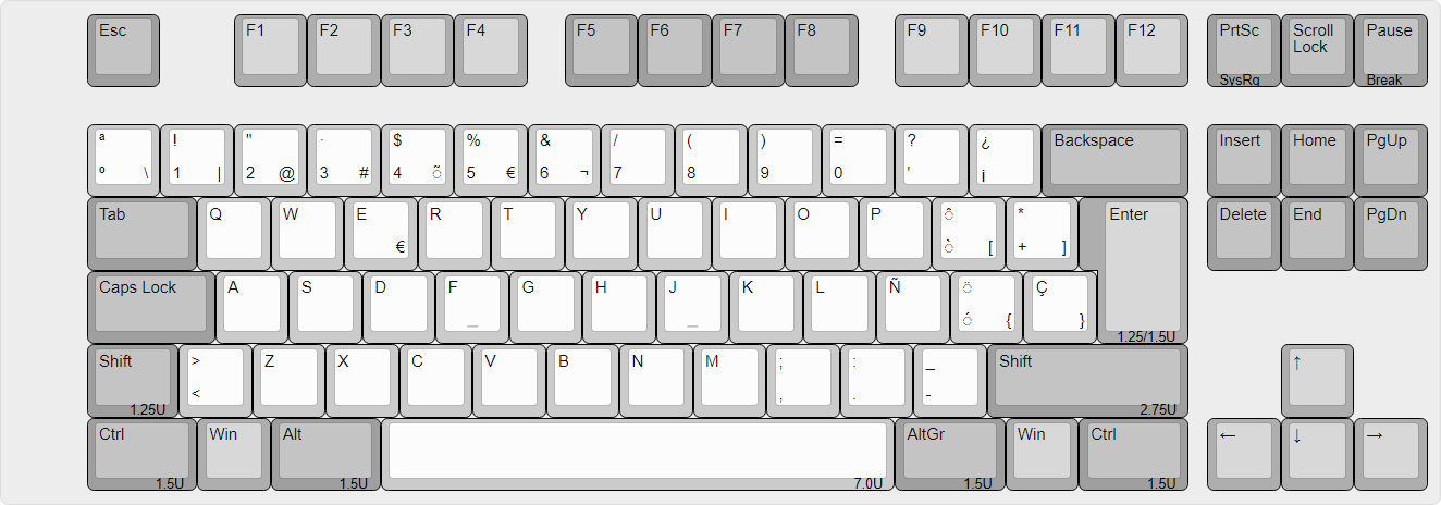

So I keep talking about form factors while using only the US English national layout (the ANSIest of them all), but what about ISO-based European layouts? Let's choose one, like, totally at random and stuff:
Regular TKL ISO (Spanish (Spain) layout).
The BACKQUOTE key has three symbols: º ª and \ ; the NON-US BACKSLASH key has two more: < and >. The five of them need to be moved because the former key is becoming a mod and the latter is disappearing. ALSO, I'm going to move the Ç letter, because the place it was assigned to back in the day is so piss-poor you can't actually write "URINE" with it.

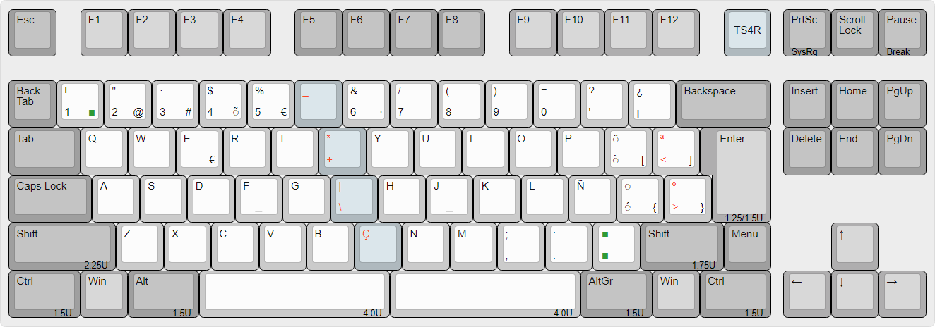

TKL ISO with extra column (Spanish (Spain) layout).
Note how I repeated the moving of the minus sign and underscore characters (this time from its position at R4 instead of R1) and placed the plus sign and the asterisk immediately below. Only three green squares remain, instead of five (but do remember that the AltGr layer can be put to further good use).
The location of the Ç will surely be a matter of controversy for decades, but at least it's now among the letters, as it should be (don't get me started on the location of the interpunct, though).

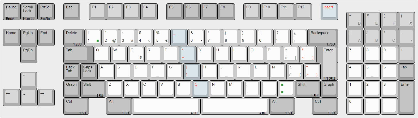

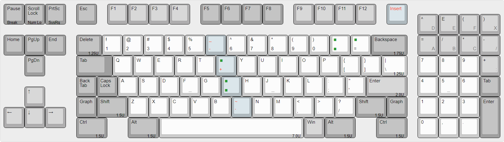

As I kept testing this on different form factors, I came on to my own left-Enhanced layout. It's surprising, but not too surprising, how well it fits the idea of adding an extra column of alphas:
ISO Left-enhanced with extra column (Spanish (Spain) layout).
That unused key on the top right? Perfect place for Insert. Back Tab can't be on the top left, so it goes to R3, to Insert's former place to the left of Caps Lock. Note the modernized numpad.

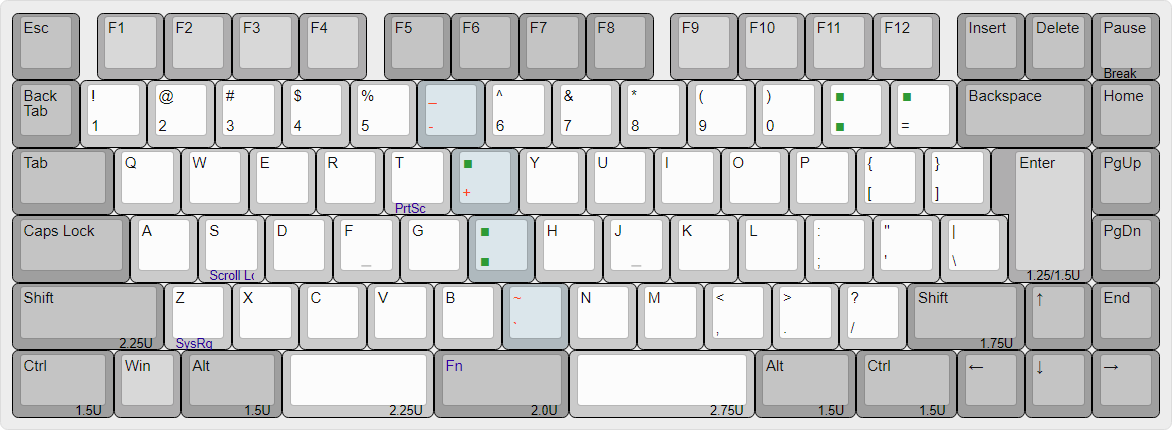

This left-enhanced keyboard is still WKL and proud of it... but some people actually need the Win key, and some people don't really like split space bars, so let's see an alternative:
ANSI Left-enhanced with extra column (US English layout).
This ANSI version of the left-enhanced keyboard sports an unsplit 7U space bar, symmetrical to the homing keys; between it and RALT, there's a single 1U Win key — in a place that will be both easily accessible and not a nuisance. So, Winkey-sporting WKL tsangan-like bottom row (and no Menu key whatsoever)? Ain't this great?

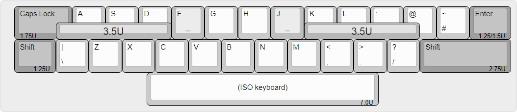

So, regarding the "balance" thing...
I had to make a few images to ensure we'd be talking about the same thing.
On an ISO keyboard, the distance from the homing key to the outward Shift key is the same — 3.5U:
Distance from homing to Shift keys (ISO keyboards).

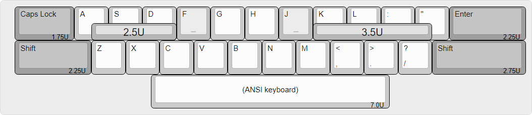

While on an ANSI keyboard, the distance on the left side is smaller — 2.5U:
Distance from homing to Shift keys (ANSI keyboards).

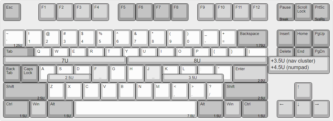

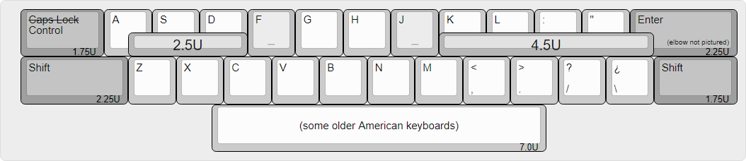

Now, even though both Shift keys ought to be used more or less evenly, it's well-known that ANSI users tend to use the left Shift much more than the right Shift, to the point that in some of the poorer-thought-out ultra compact layouts, the right Shift is usually displaced or mutilated (or even overloaded with an alpha... like, EEEEWWWW!). Historically, this was even worse for the users of some keyboards that had one more key between /? and RSHIFT (a feature that survives in JIS keyboards, BTW):
Distance from homing to Shift keys (some older keyboards).
In the light of this, it becomes obvious why ANSI users would recoil at the suggestion that the "good and proper" distance between LSHIFT and F should be "so much larger" than what they're used to... and on a "tiny" 1.25U key, to boot!

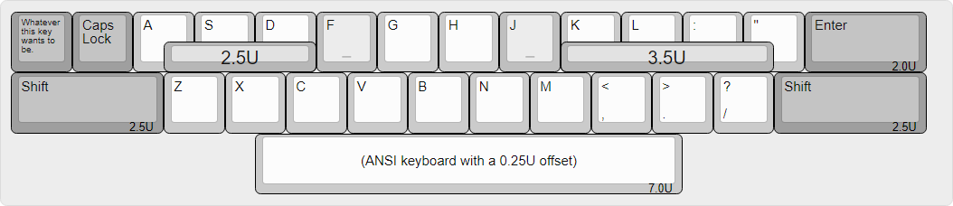

We could attend the latter issue, by doing the -0.25U offset that I proposed in the left-enhanced layout and using that to make the mod keys look balanced:
Distance from homing to Shift keys (left-enhanced (or ANSI with -0.25 offset) keyboards).
But the problem remains, and it's due to the simple fact that the right side of the alpha block (not to say the entire keyboard) is larger than the left side:
TKL (ANSI with -0.25 offset) keyboard, with length markers.
Note that the 7U and 8U distances are for the alpha block of an offset keyboard — on a normal keyboard, they are 6.75U and 8.25U (the latter of which grows to 9.25 in the 75% and 65% form factors).
It seems to me that while the imbalance between left side and right side of the alpha block remains, convincing ANSI users of the goodness of equidistance of the Shift keys is going to be difficult (but we can try).
