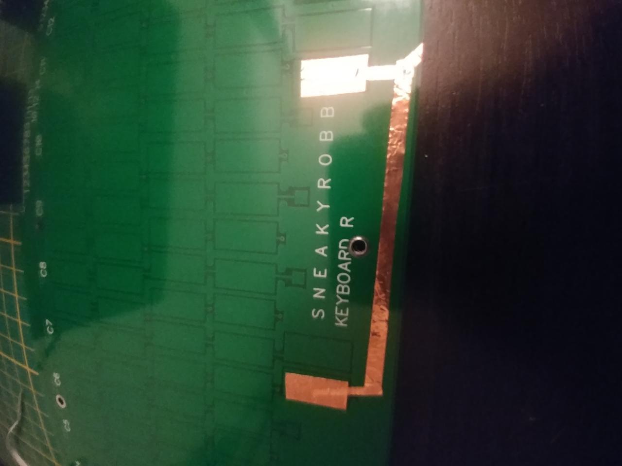

Reliability and durability?
Capacitive > Hall effect. Full stop.
They both have pcbs, but the capacitive pcb doesn't have any exposed circuitry under the keys unlike the hall effect which has at best a surface mount sensor soldered in place. You could in coat this with water proof resin though, but it is still more stuff that can break. More exposed circuitry.
You can dunk most of a capactive board in water and pull it out and it will work fine. The sensor pads are inside the soldermask so they can't get shorts between pins. Do this with a hall effect pcb and the sensors might be shorted if not sealed or if there even was sealant and it has peeled.
They both have controller chips at the top, but for a capacitive board these are the only chips. So less points of moisture failure.
In a capacitive keyboard the pads aren't exposed at all, they are just trace areas. The only real wear on the capacitive pcb is a light plastic capacitive element slightly slapping it. I'm not sure anyone has ever seen a capacitive pcb that has worn due to "slap damage."
This is no better and no worse than hall effect that must also move a magnet thing around. We seen a lot of clickly capacitive keyboards, but there is no reason you couldn't make a near linear one with almost no contact at all, or a topre style.
If the traces break in your hall effect pcb you can redo them, but if the sensor gets messed up you have to replace the sensor.
If the traces break in a capacitive pcb, you can go to any hardware store to... do some science to fix it.
Even then, topre capacitive boards just have a spring that moves around near the board so it isn't really slapping it anyway.
So if the sensor usually doesn't fail in a capacitive topre board, the thing that is going to fail would be the mechanism that moves around the capacitive element. Or the controller at the top.
But that is exactly how the hall effect keyboard would fail as well though. It would have failures in housings, springs, slider wear etc.
Its just that the hall effect keyboard has more individual physical sensors soldered in place which is just a bunch more points of failure.
