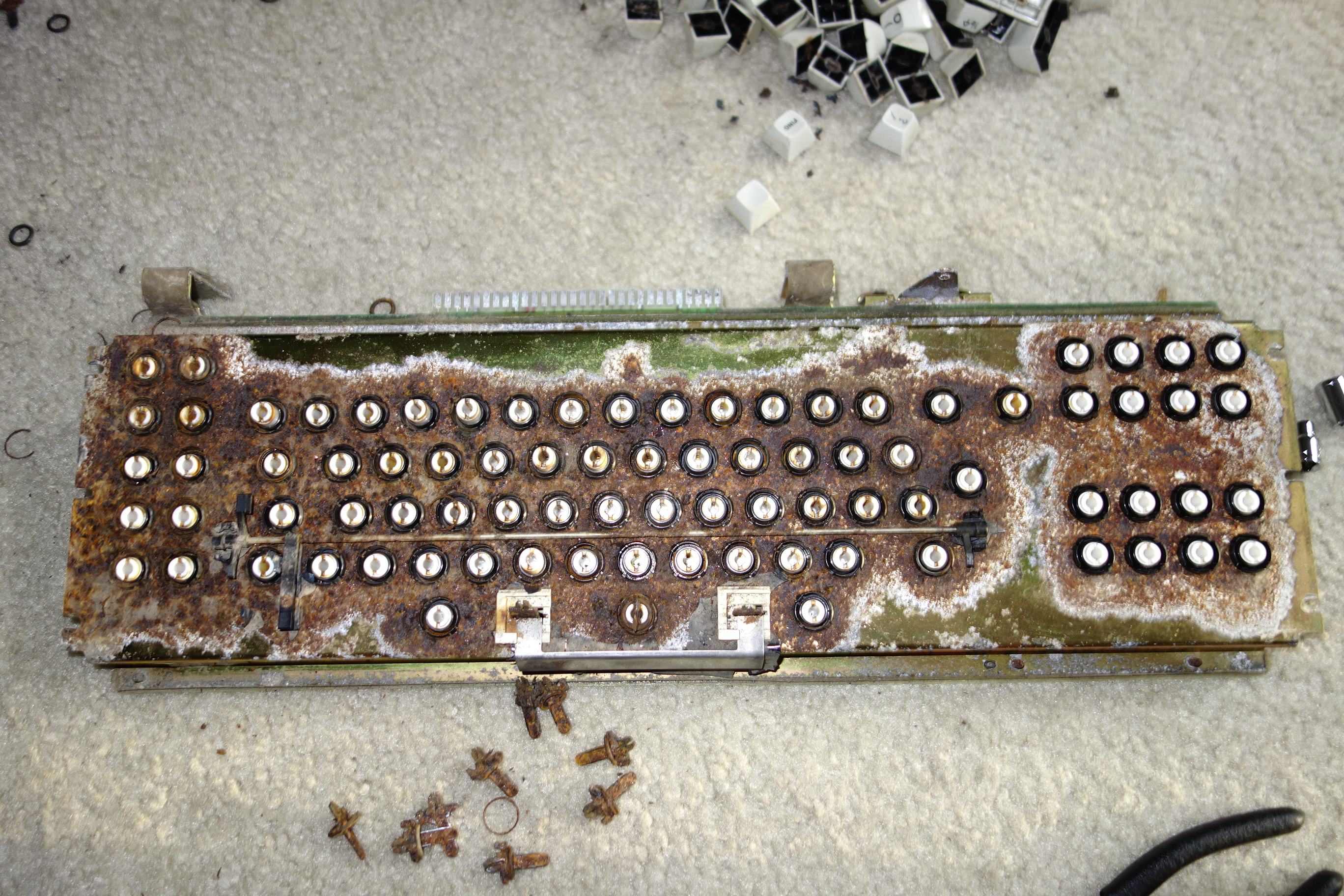

You got lucky! At least yours wasn't like this one I got a while back:
_DSC5719 copy.JPG (3.57 MiB) Viewed 7100 times
On yours, You could just put a light coat of rust preventing oil (like something lanolin based, though beware, your beamspring may then smell like a sheep) and wipe off the excess.

orihalcon wrote: 05 Aug 2019, 15:52 You got lucky! At least yours wasn't like this one I got a while back:
Yea, I have seen quite a few beamsprings that were much worse than mine. Do you know what conditions that one was stored in?
Mine was kept in an un-air conditioned house next to the beach in Florida, so considering that, I got pretty lucky.
