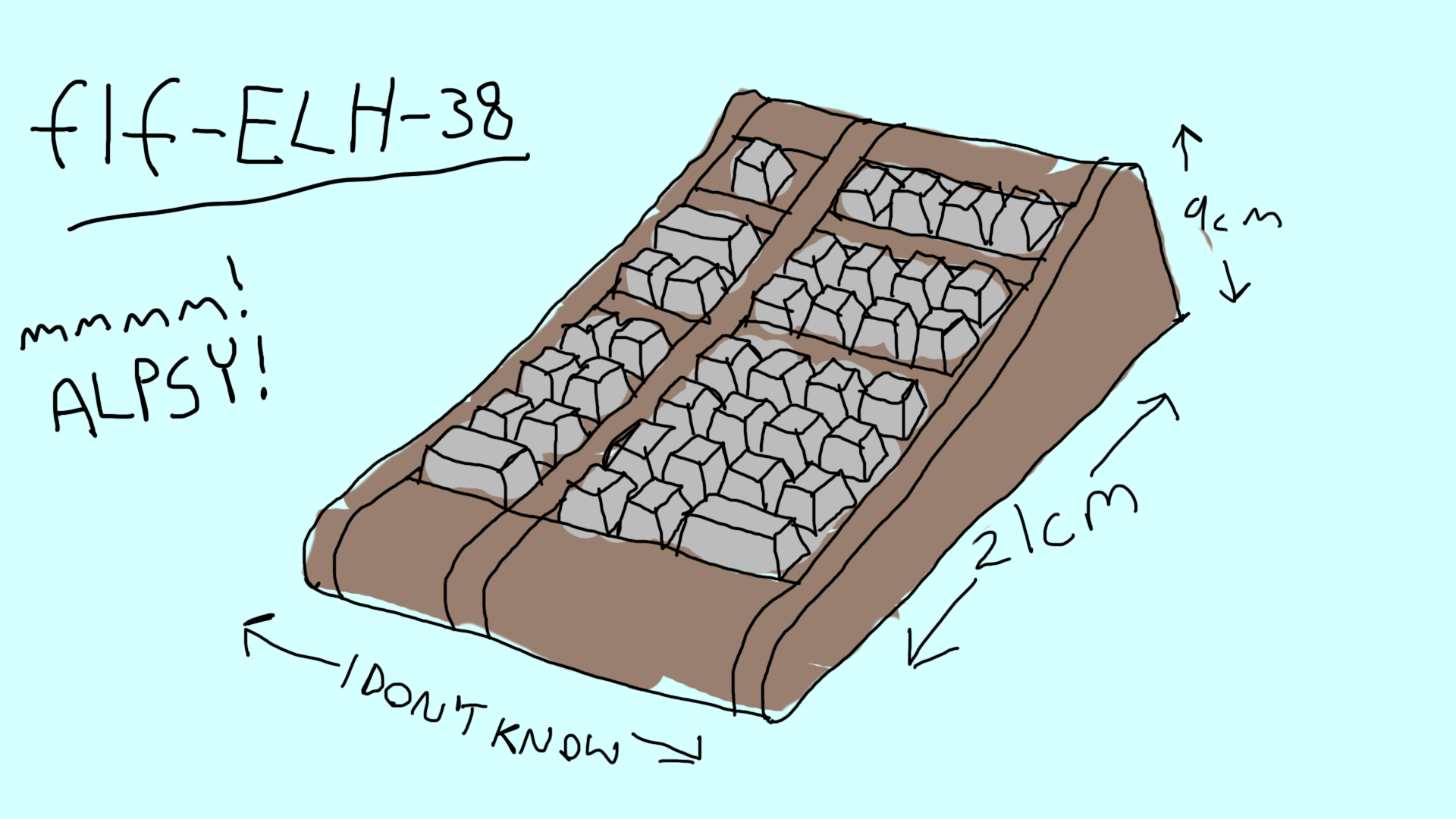

I need a board for my Maya hotkeys while 3D Modelling, so I've come up with this.
It will be a companion piece for my SGI AT-101, so I will be using its profile as a template.
It uses Yellow Alps and the case will be made of wood, here is the Quentin Blake bar napkin design.

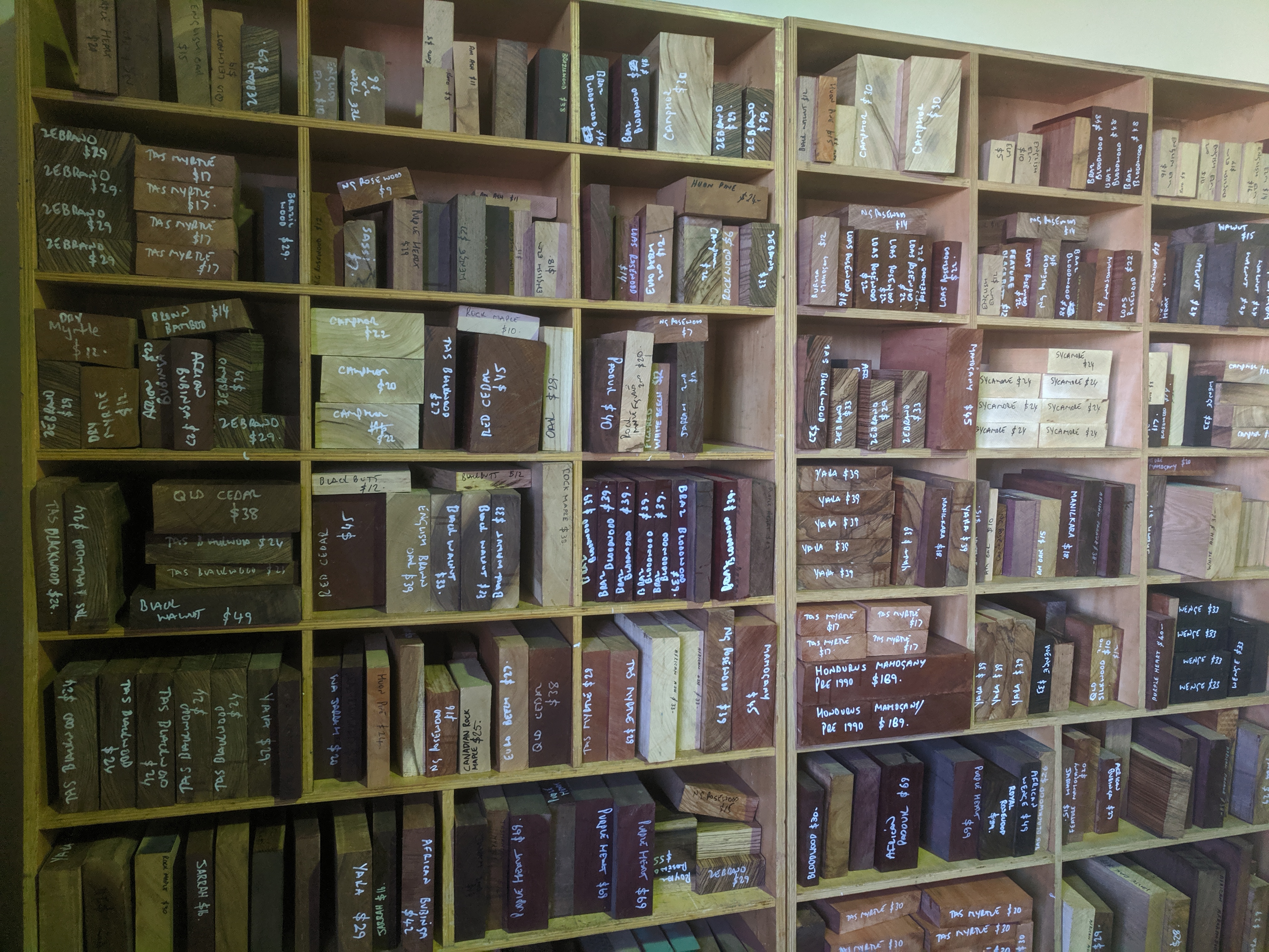

In the meantime, it's off to the exotic Wood store to choose a material.

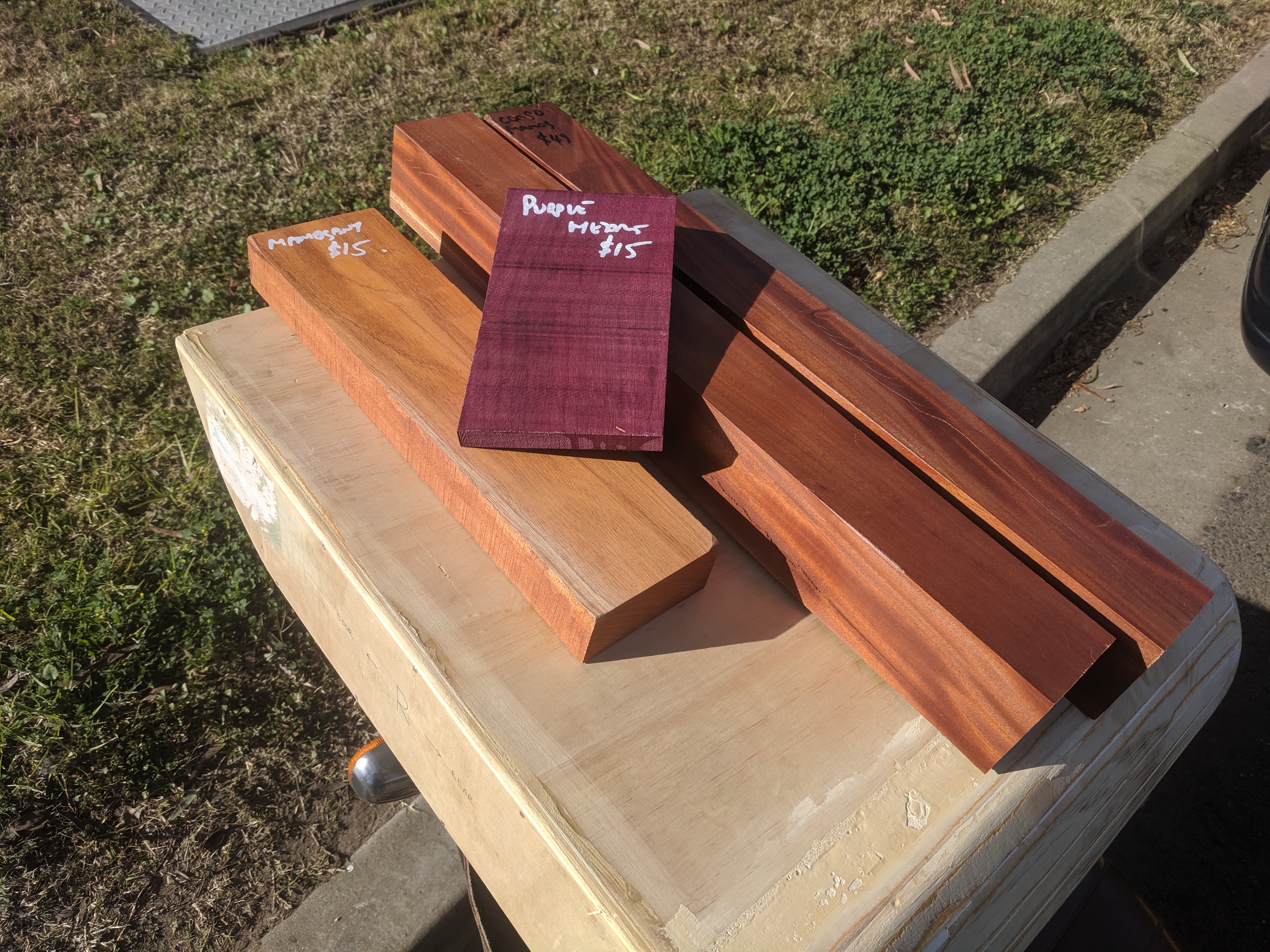

The two big pieces are Congolese Mahogany, this will be our build material.

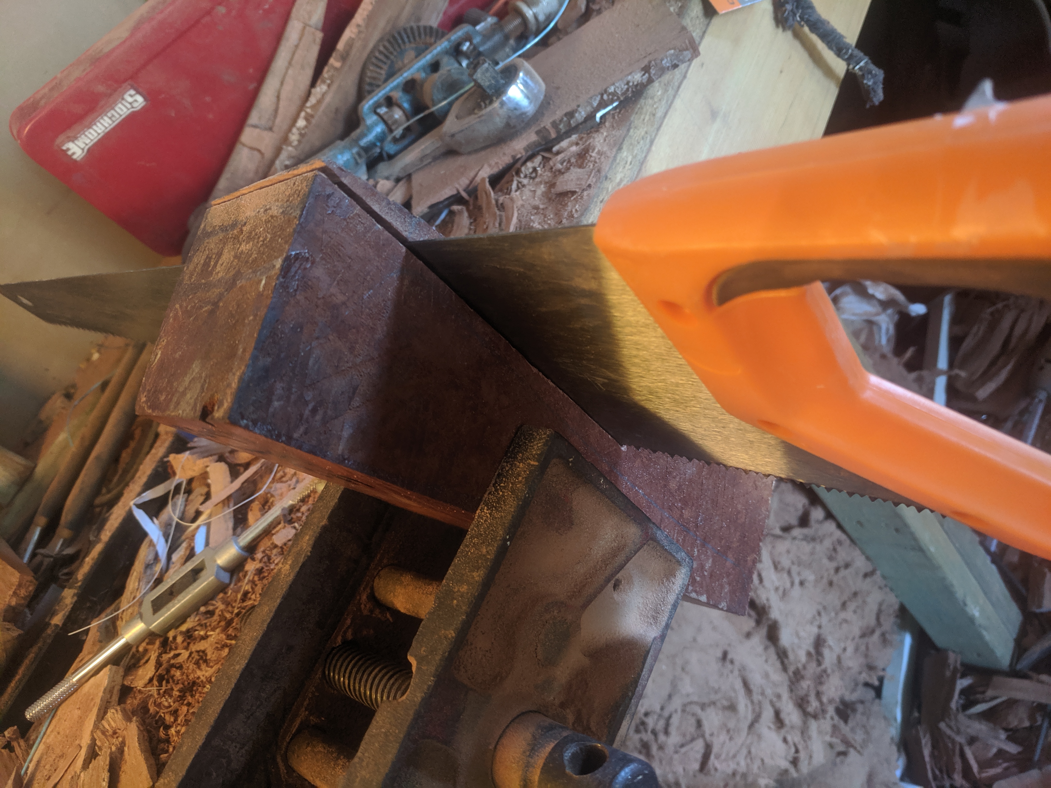

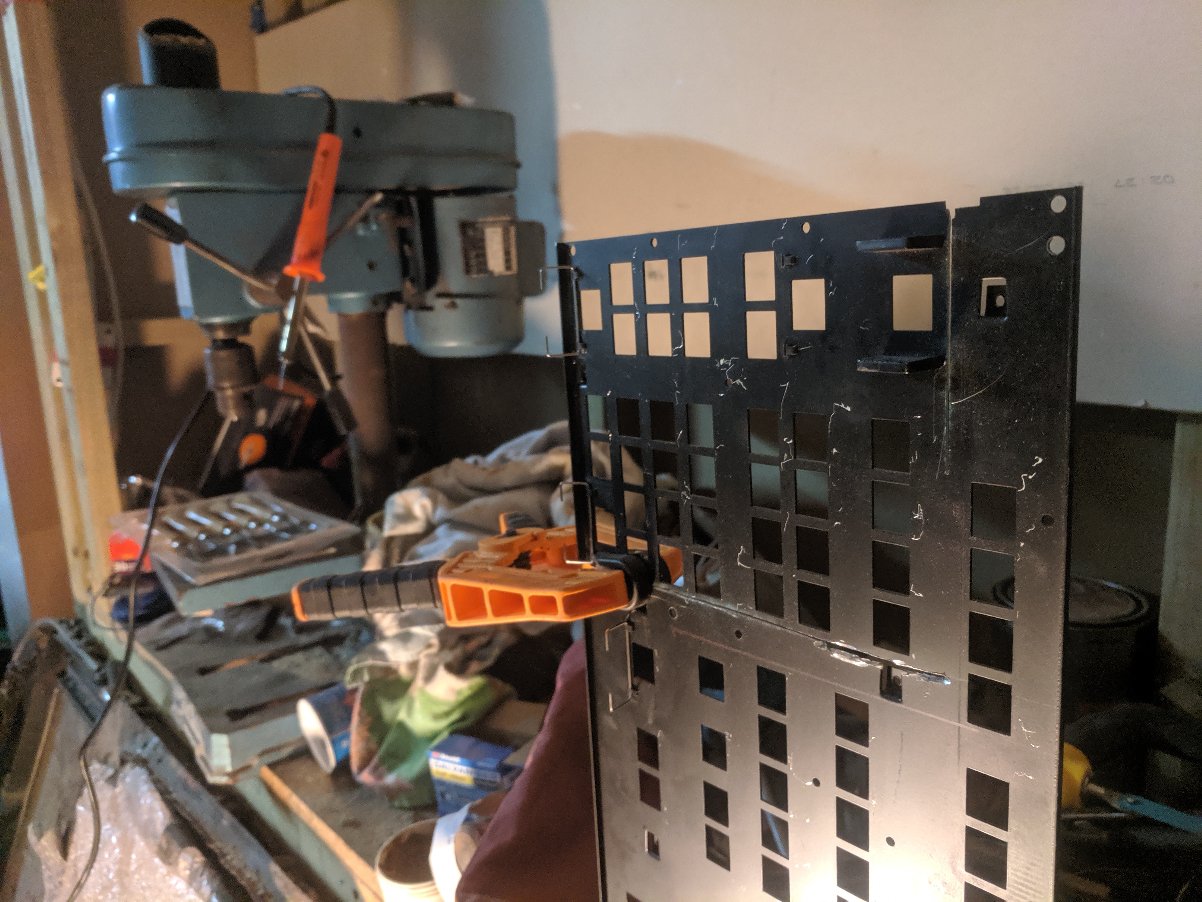

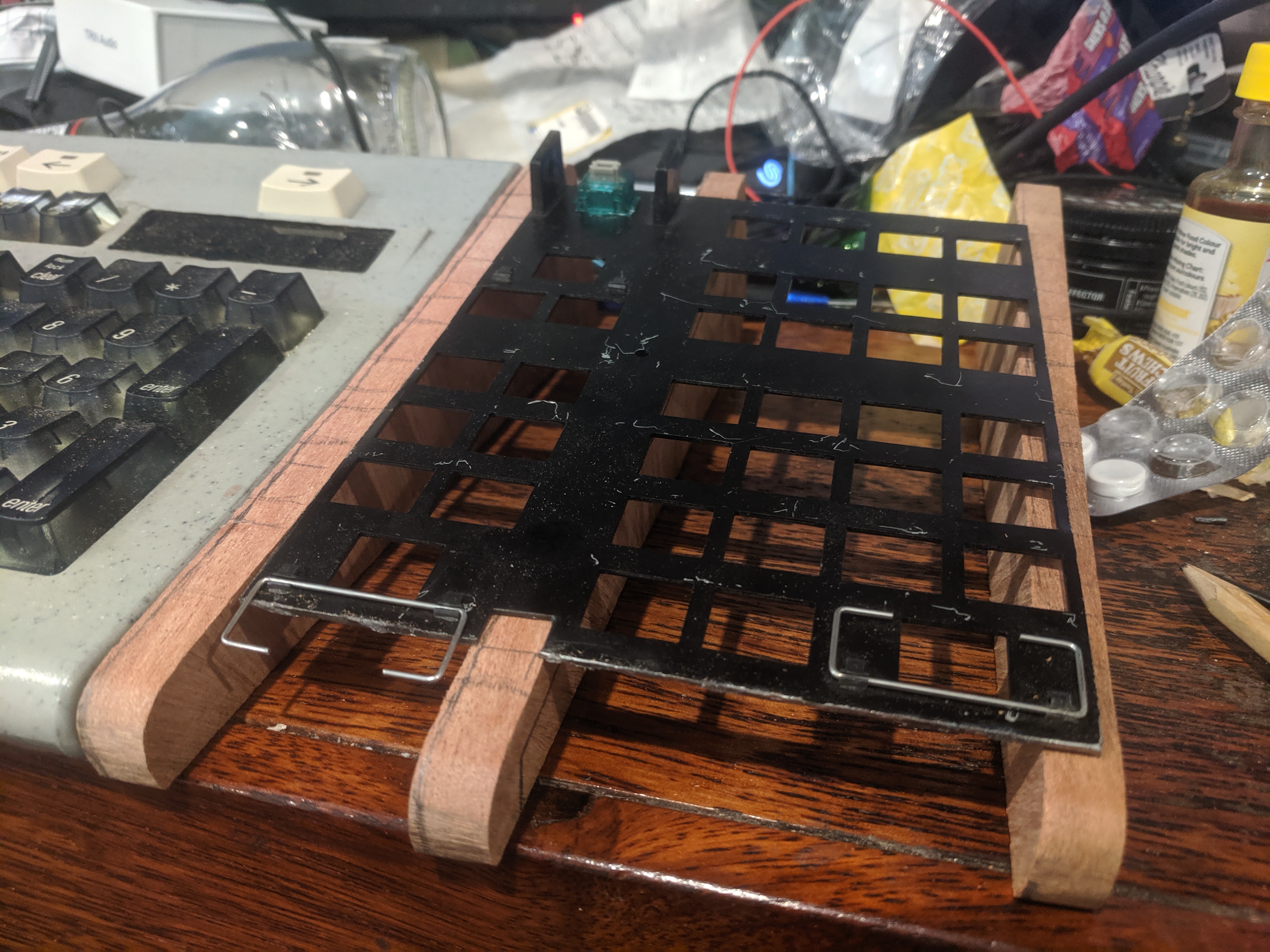

I'll be taking the steel plate from a dissected editing console. This corner chunk is all I need.
flowerlandfilms
09 Sep 2019, 18:52

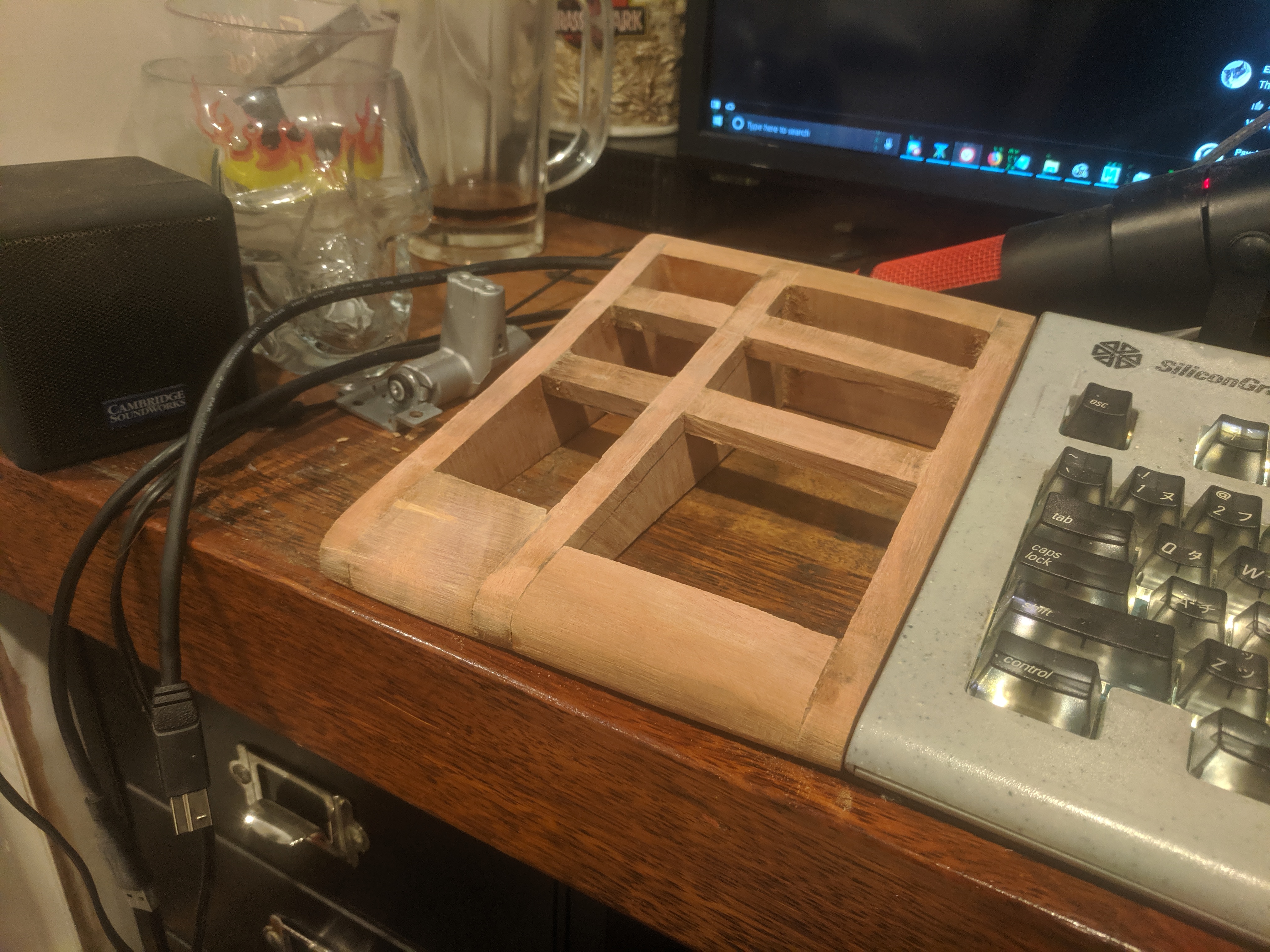

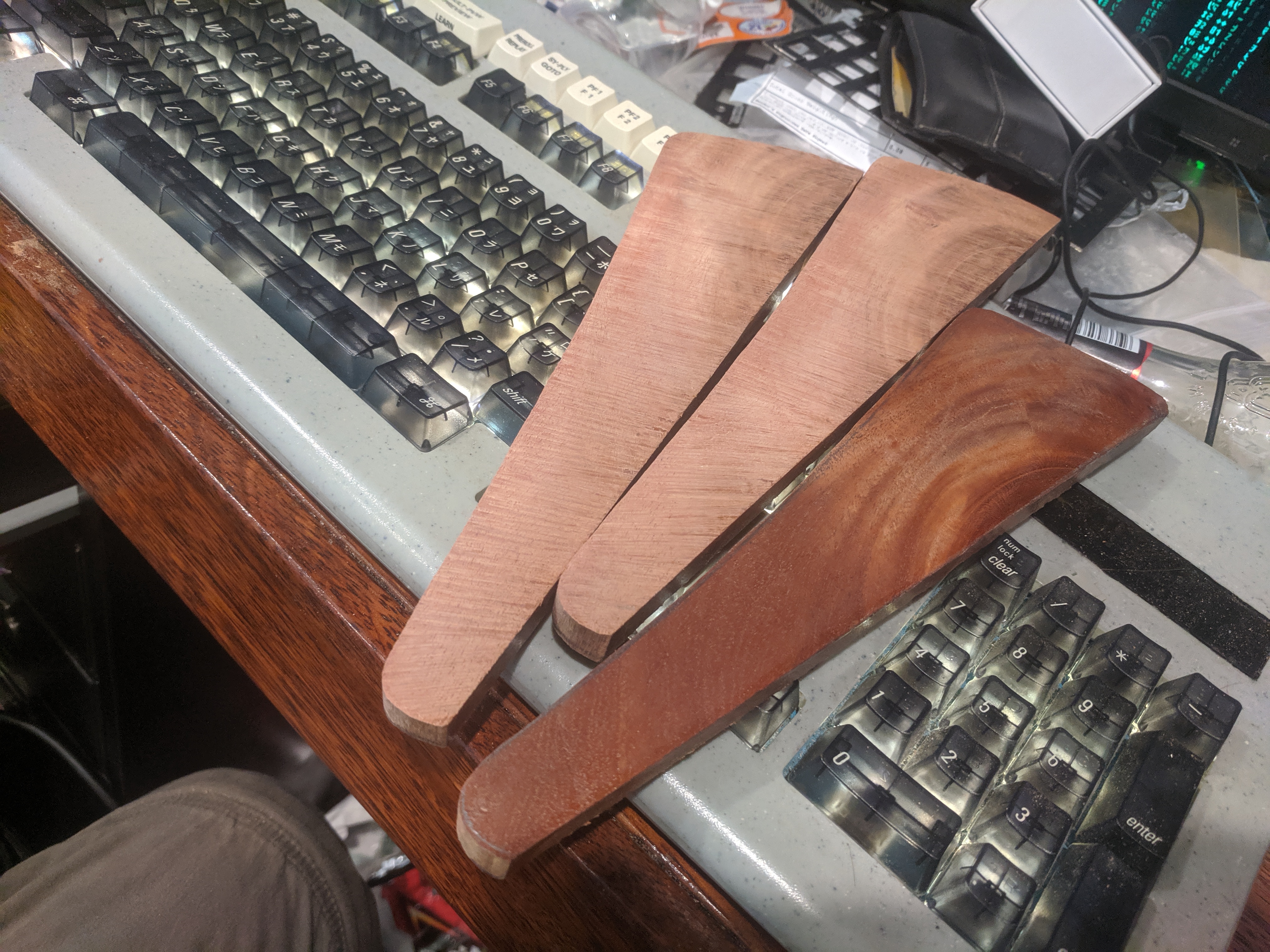

Got the shape, just need to make some slices.
flowerlandfilms
09 Sep 2019, 19:13
flowerlandfilms
09 Sep 2019, 19:21
Figuring out the needed width.
flowerlandfilms
09 Sep 2019, 19:39
Filling in the other pieces.

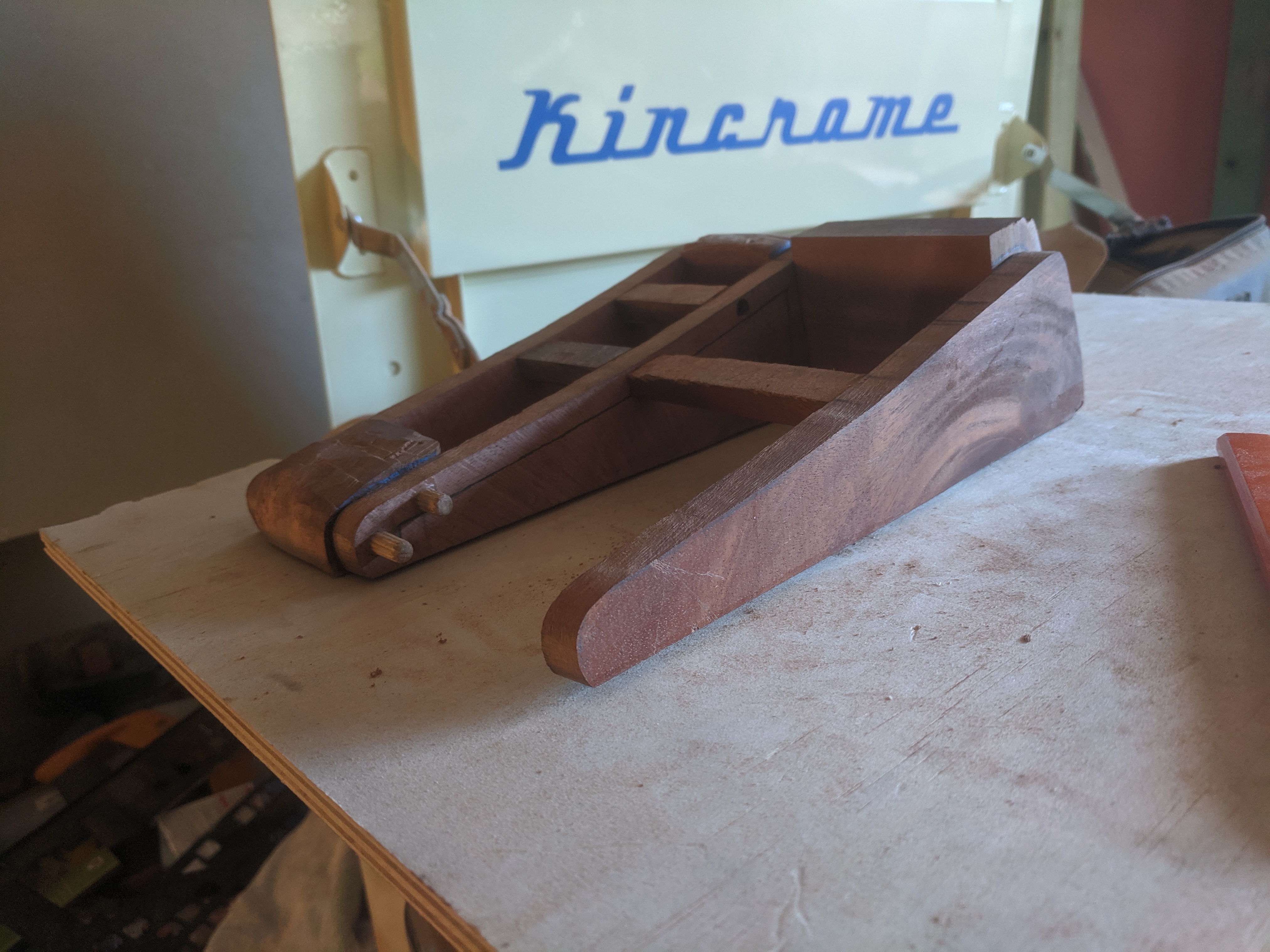

flowerlandfilms
10 Sep 2019, 00:56
Sponsored by Kincrome!
flowerlandfilms

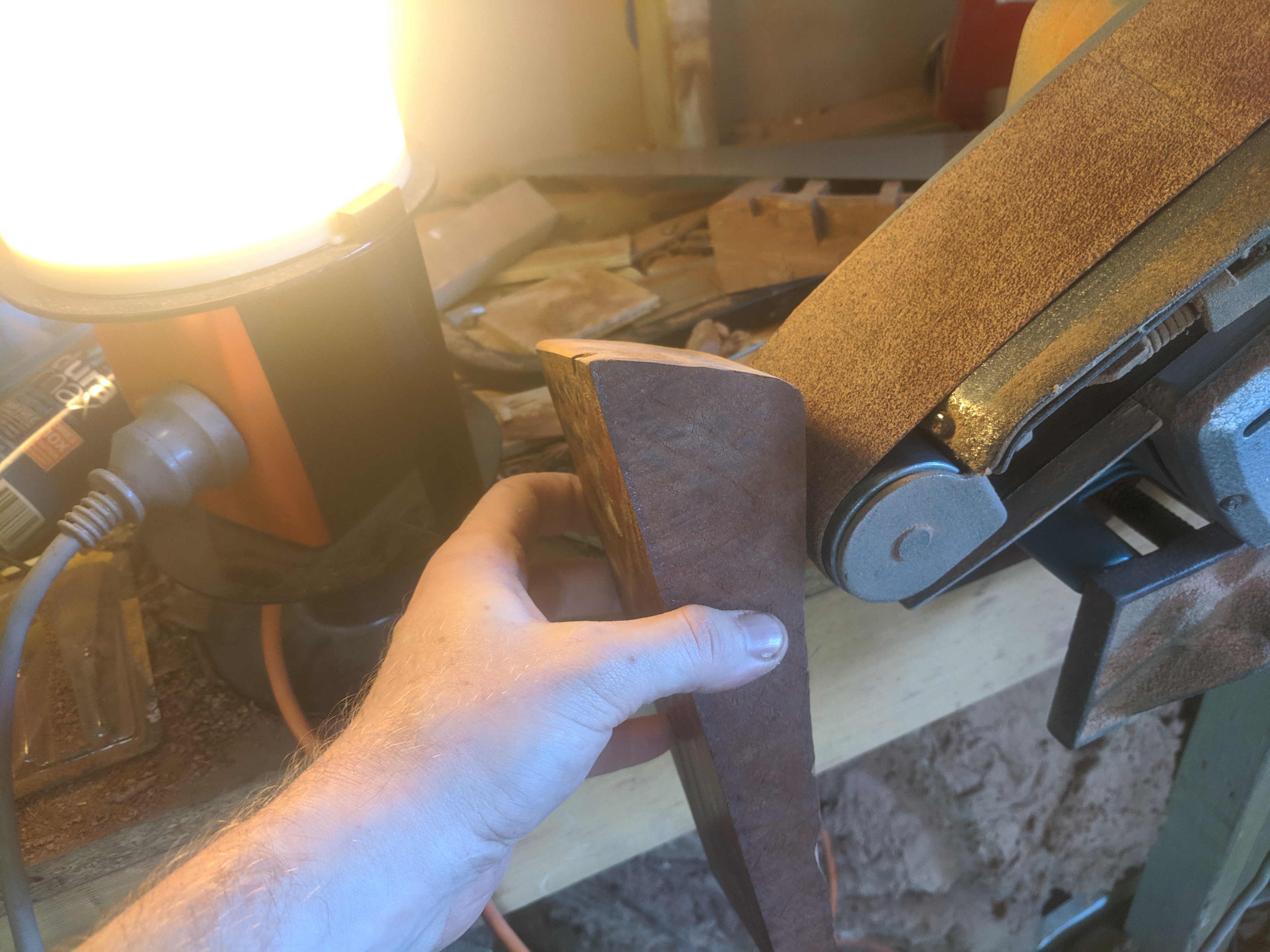

10 Sep 2019, 14:10

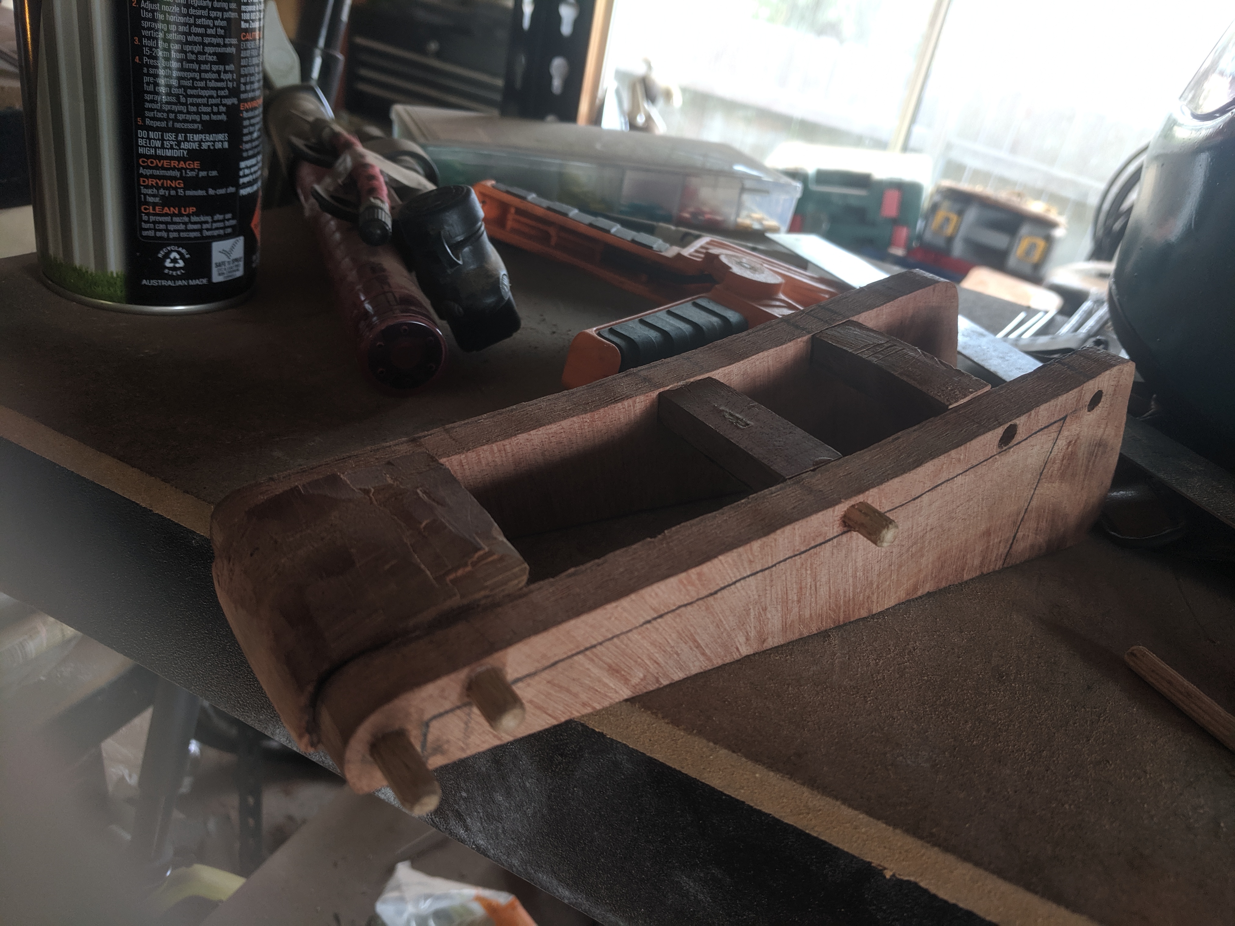

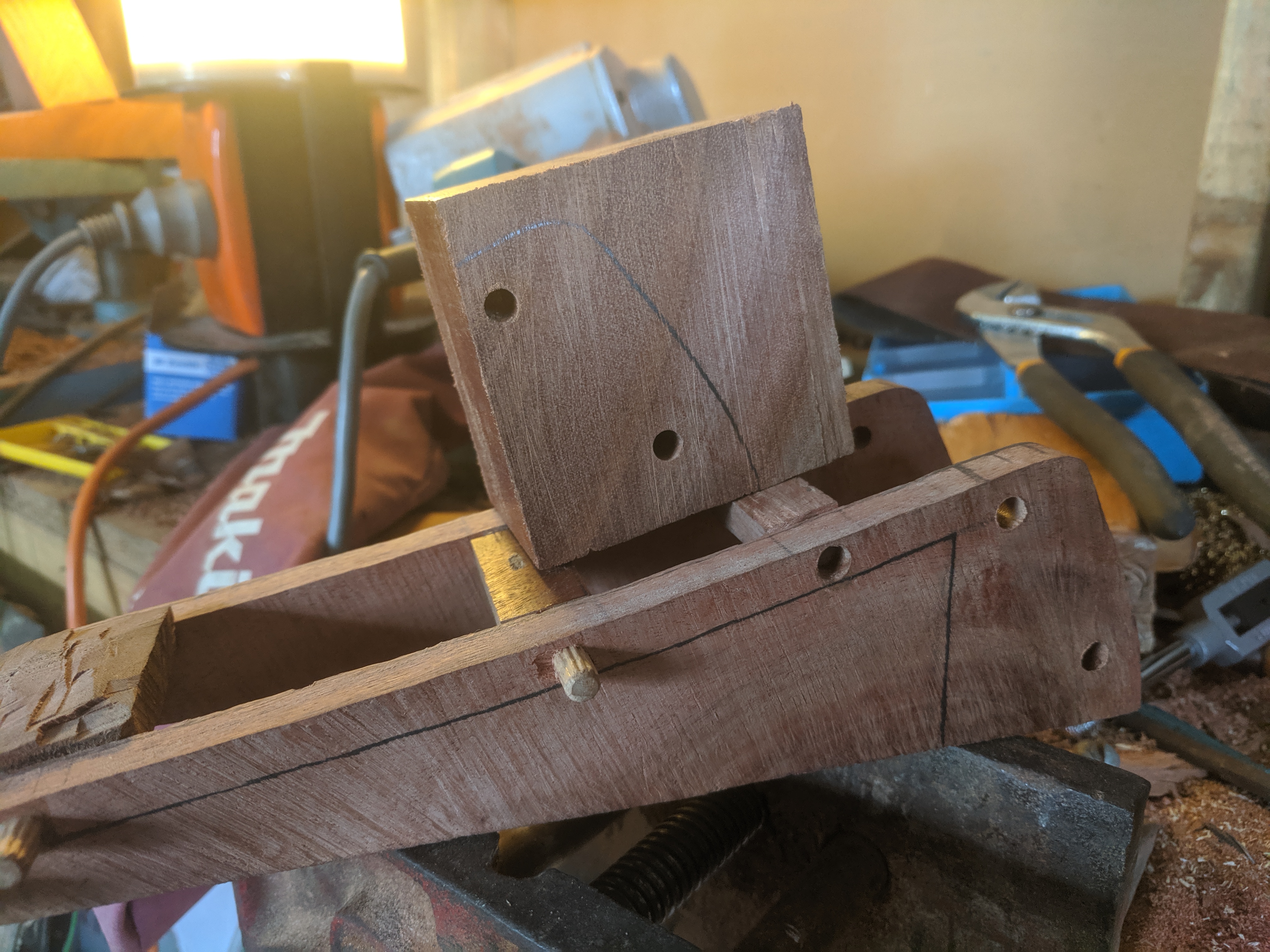

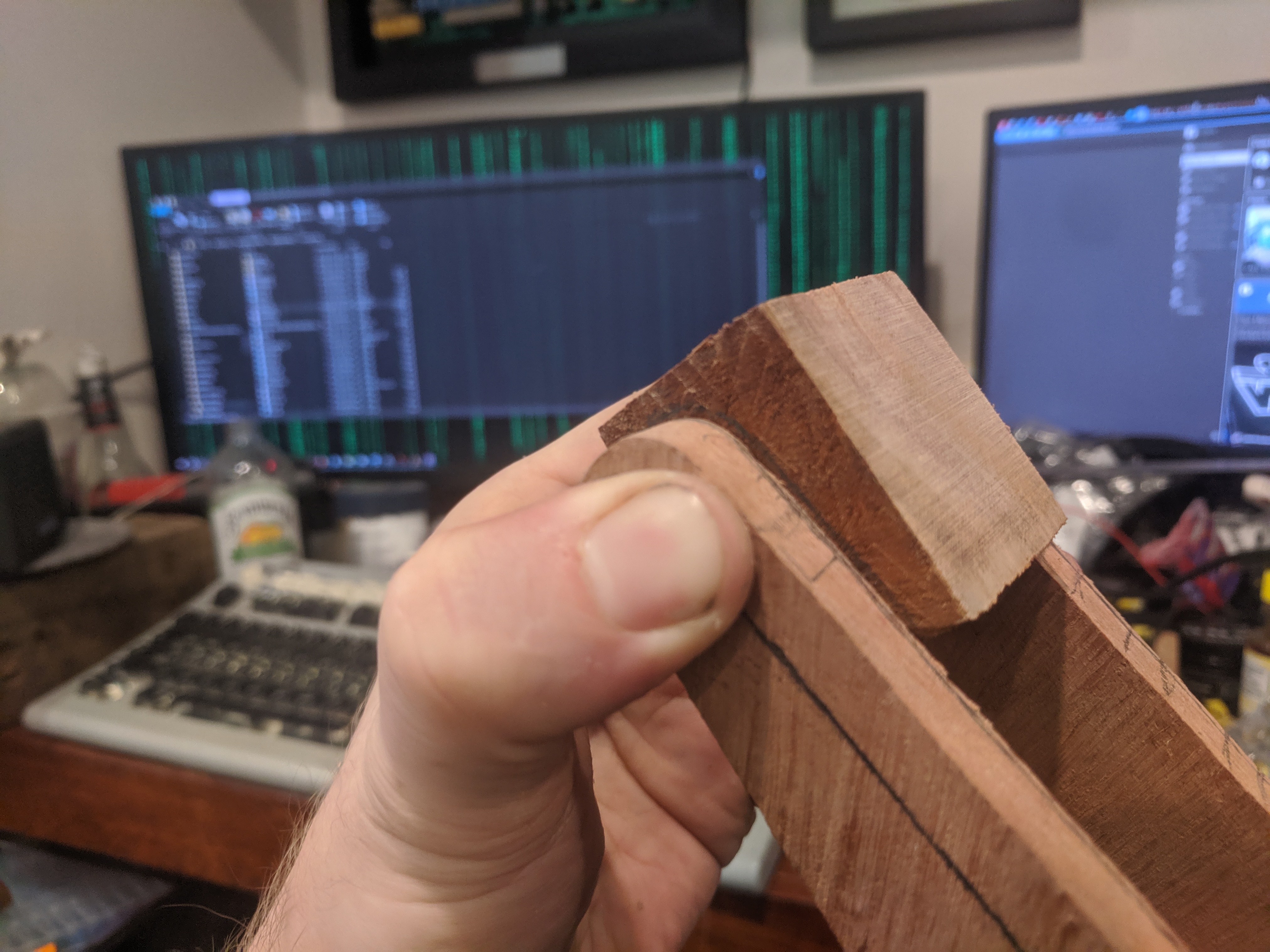

Okay got the basic shape of the wood done!
I'm going to sand it to 1200 Grit, then Danish Oil.
I think it will come up real nice.

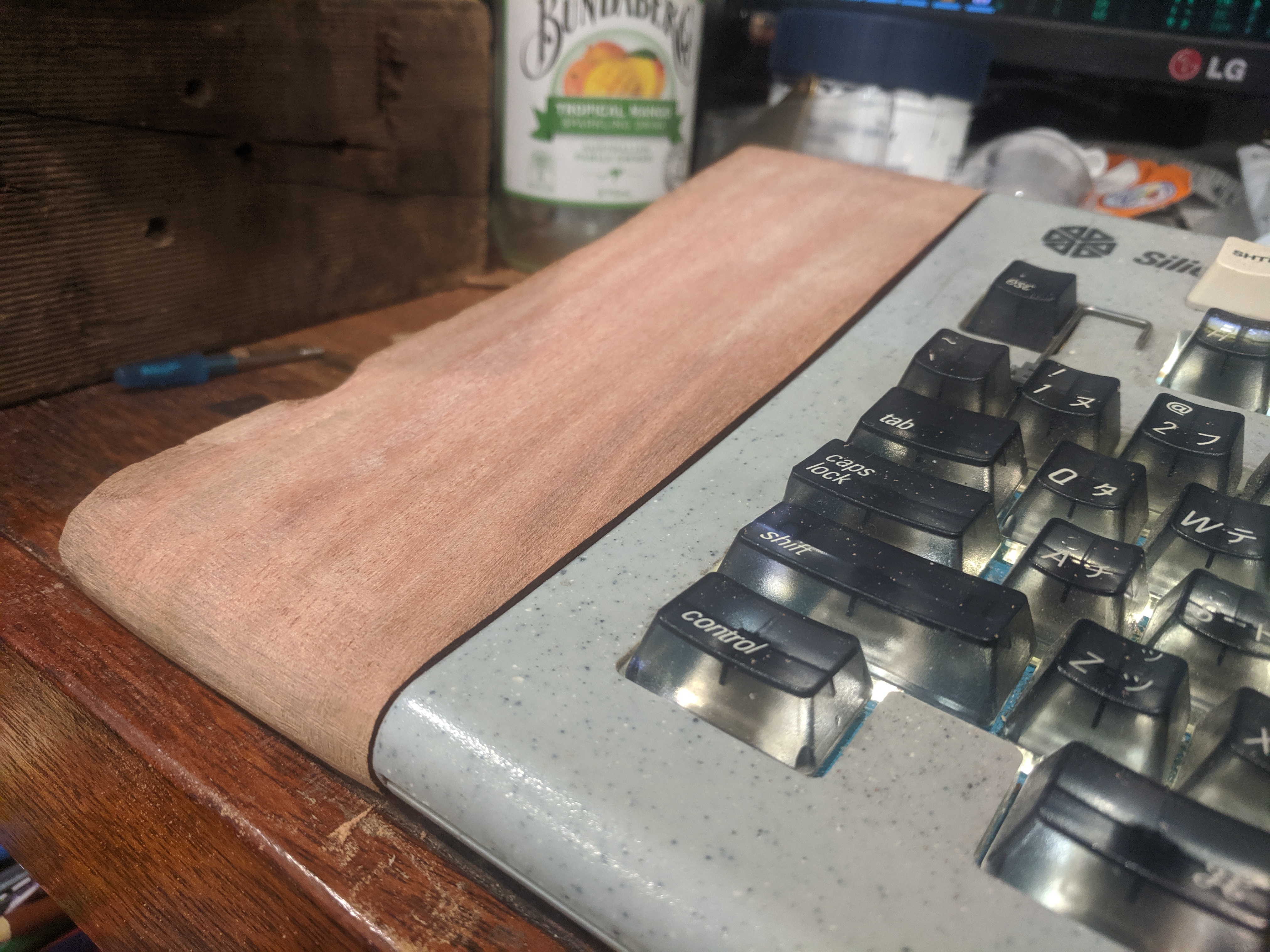

flowerlandfilms
10 Sep 2019, 18:57

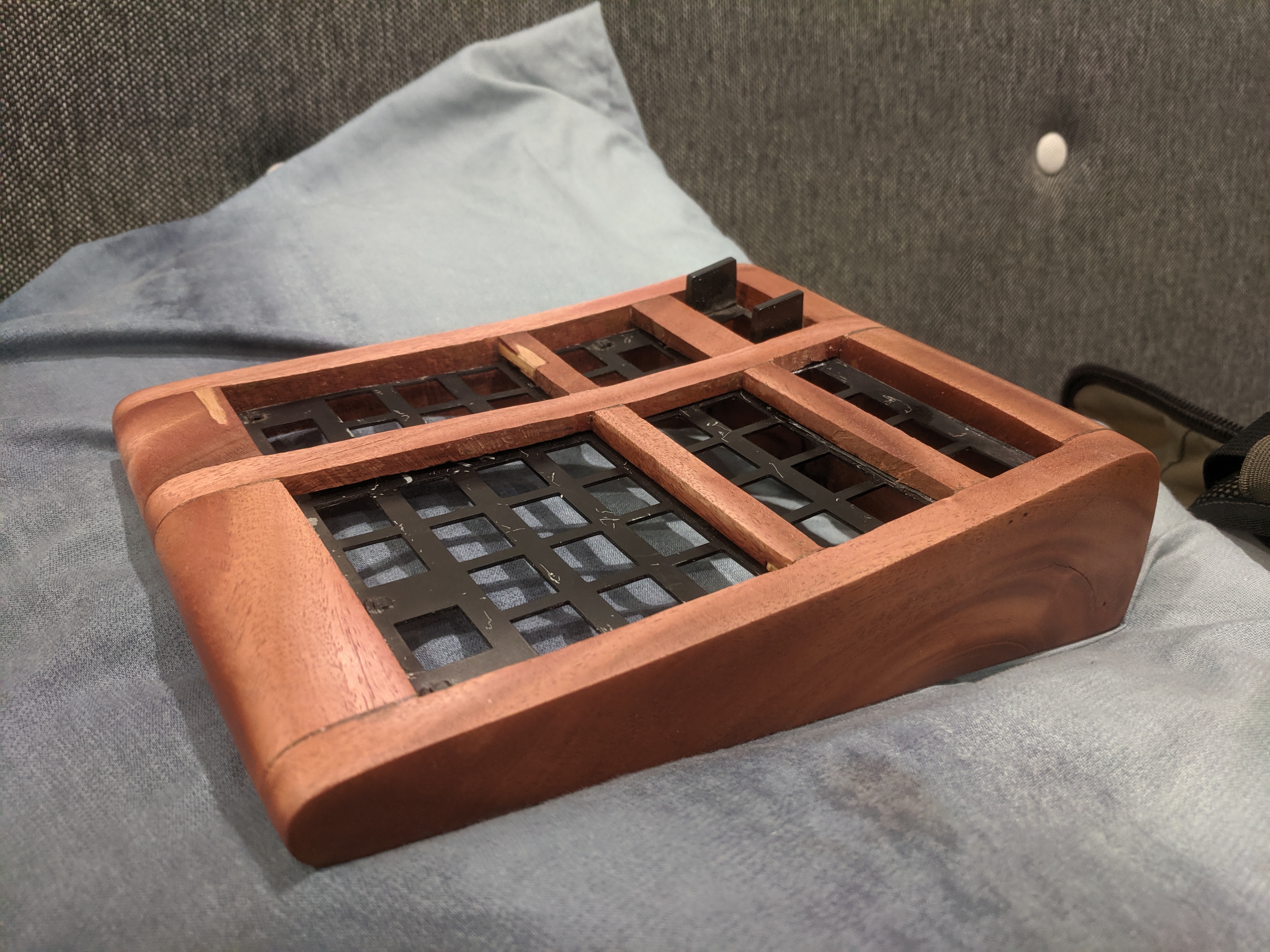

Great colour and grain coming out, here it is with the plate attached.
flowerlandfilms

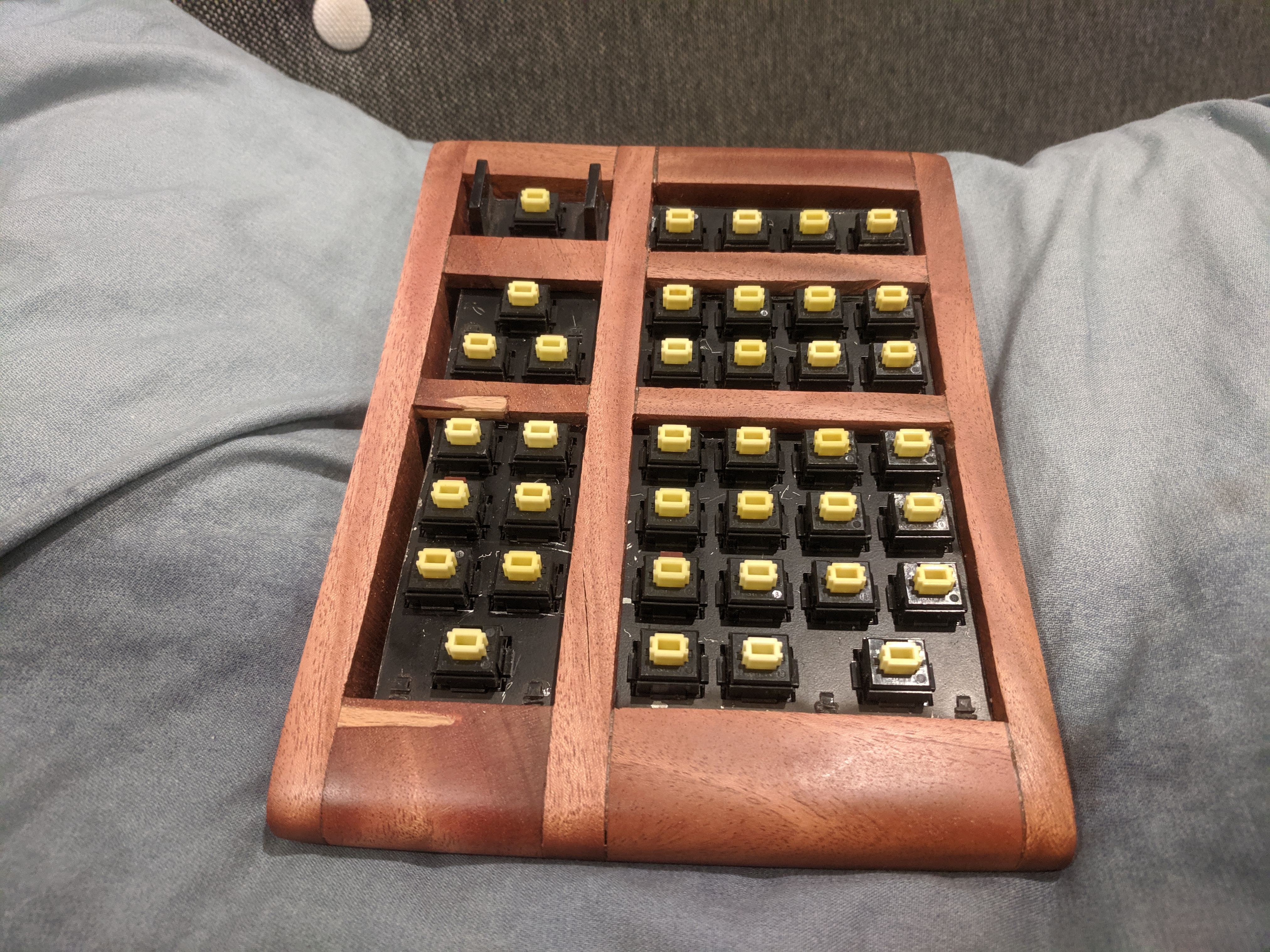

10 Sep 2019, 19:00

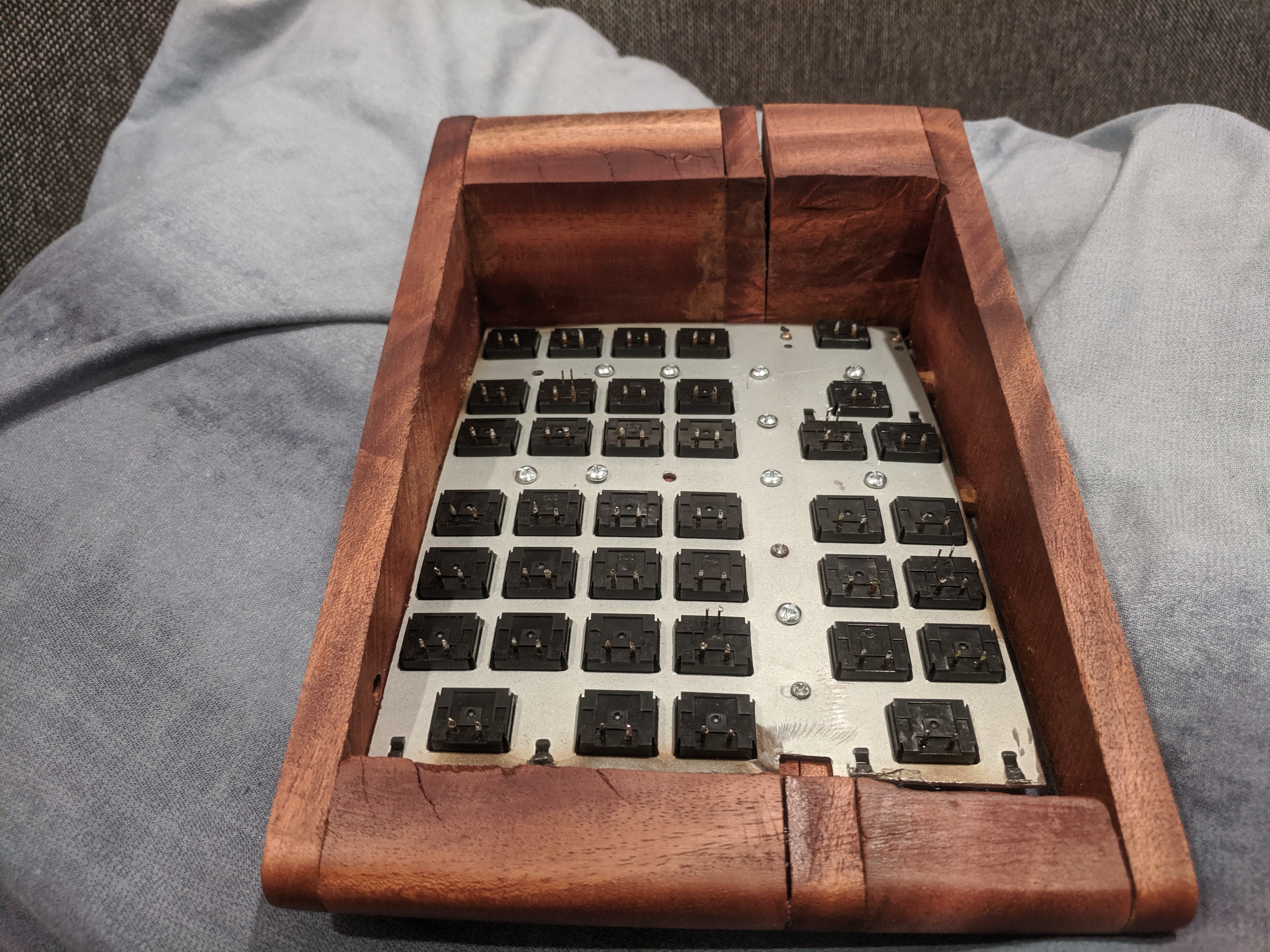

Made some mistakes with the pine dowells showing through the wood, I didn't realise the sanding would take off so much material but oh well.
Here it is with switches.
flowerlandfilms
10 Sep 2019, 19:02
And here it is viewed from the bottom.
The switch plate is suspended with small wood screws.

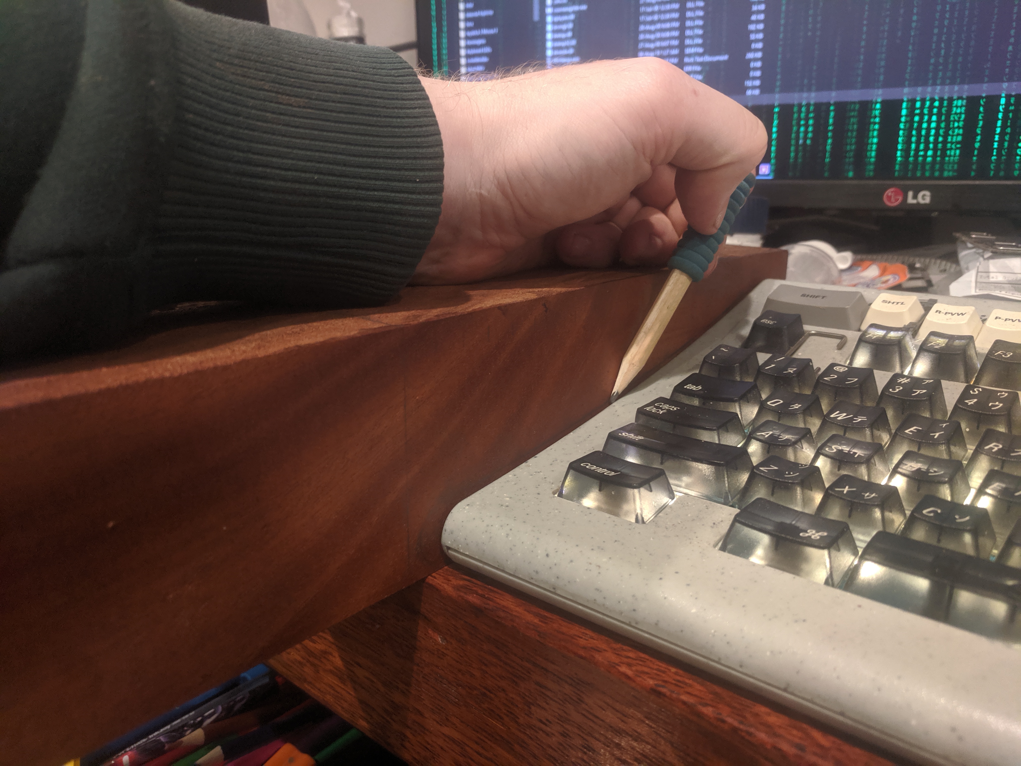

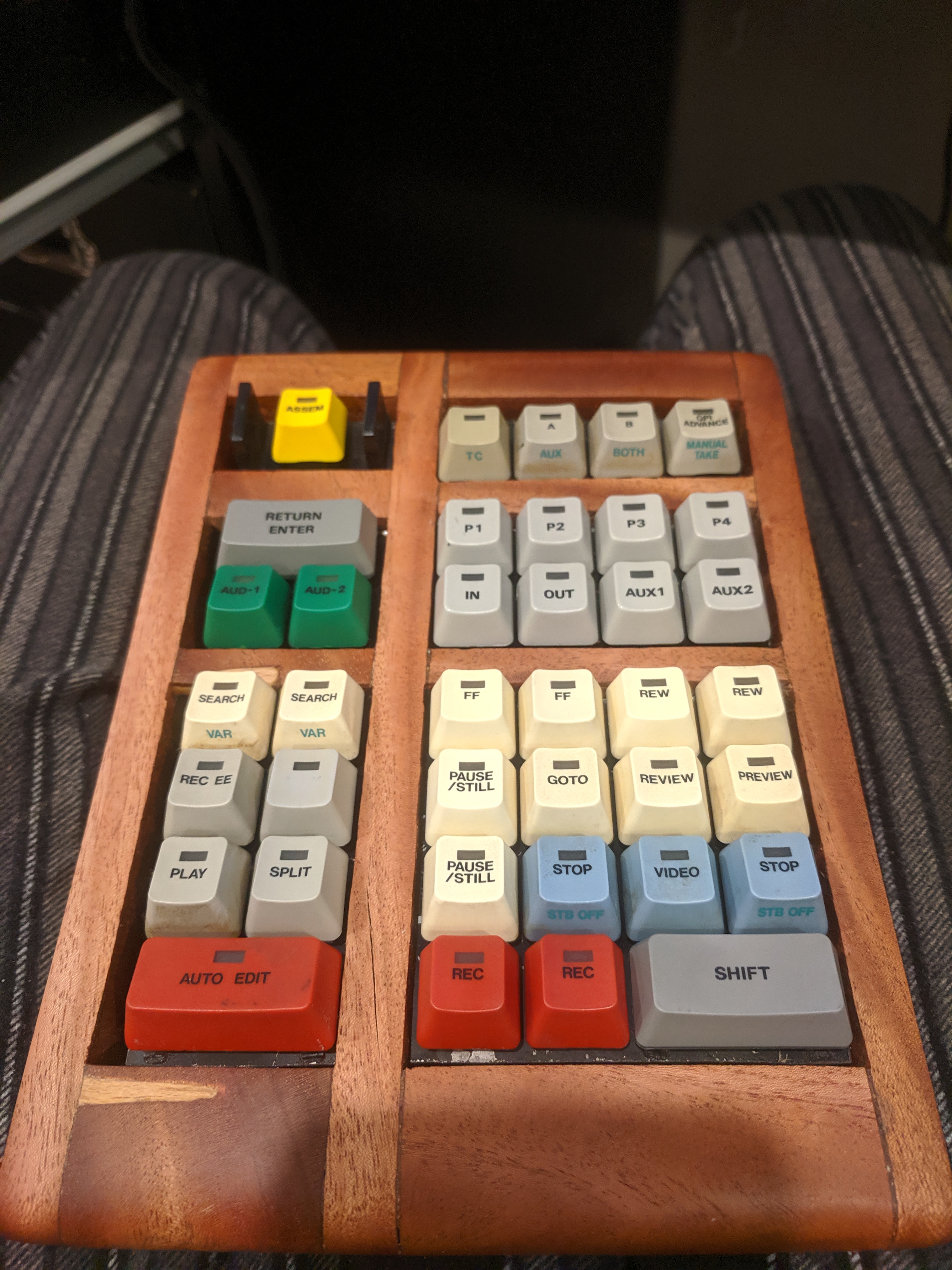

Thanks, it's looking okay, looks even better with keycaps! [Legends to change]

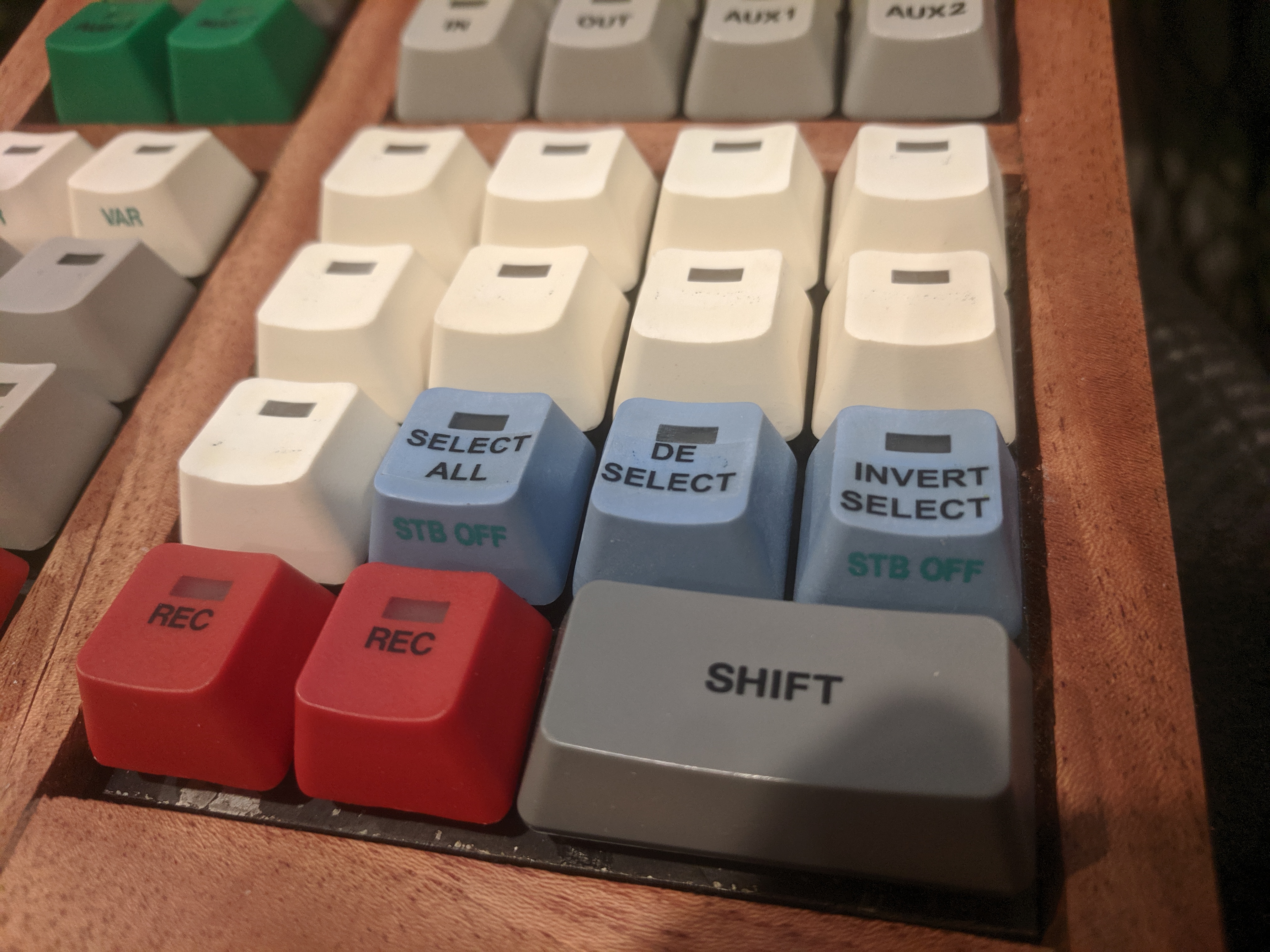

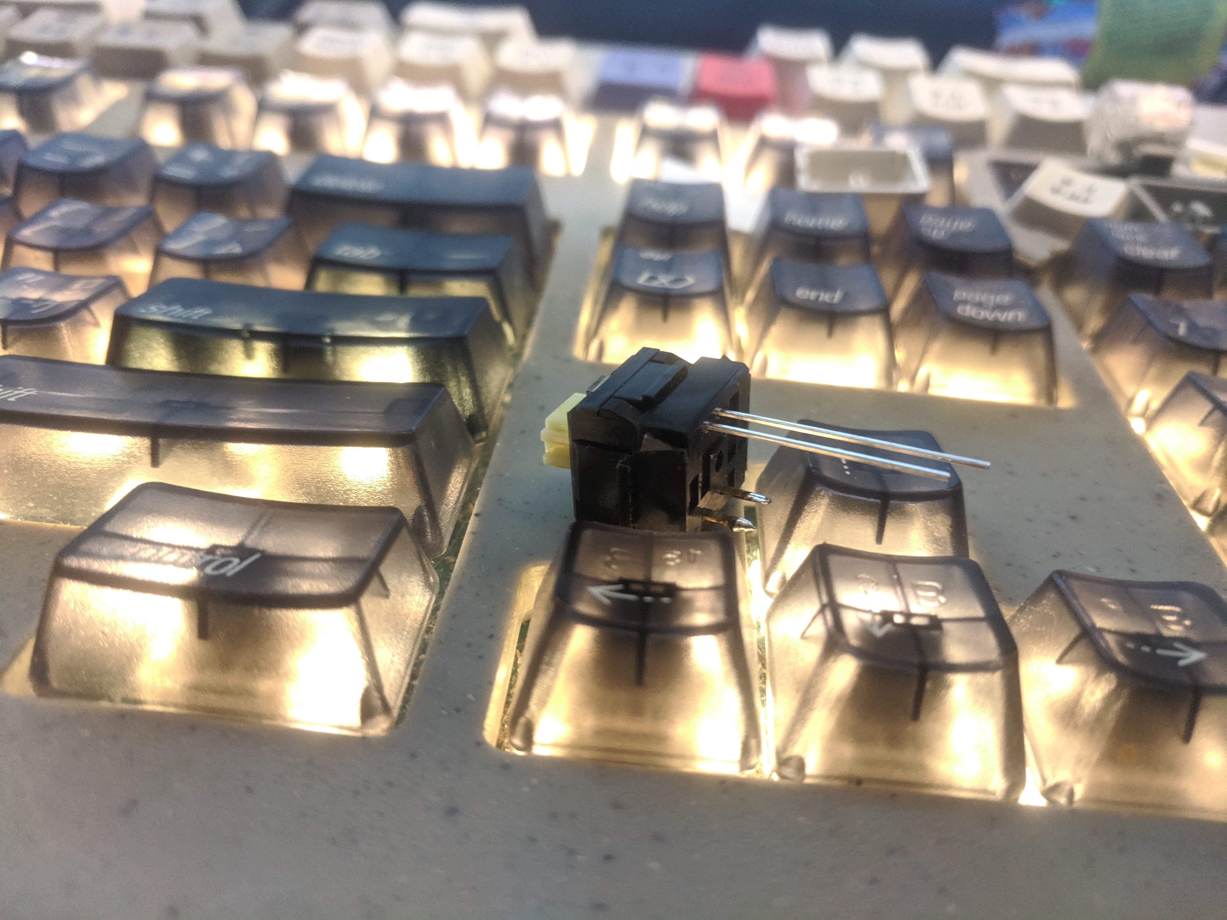

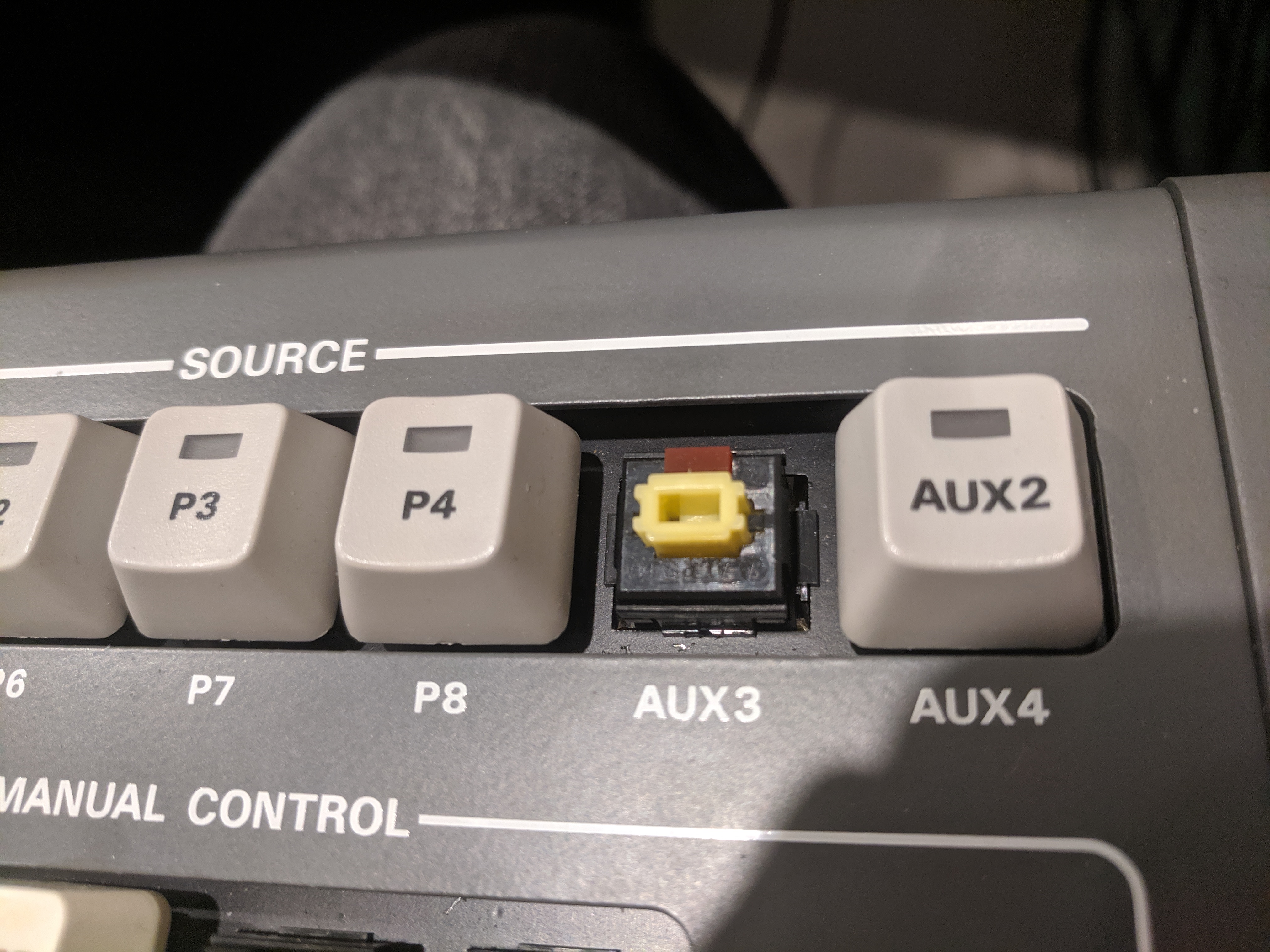

I don't want red LEDs like some of these yellows come with, I want green, so I ordered some replacement square LEDs online. For the the switches that have no LEDs like this one, I just had to make two holes with a small push pin.
flowerlandfilms
10 Sep 2019, 21:13
These editing keycaps are quite plentiful, so modifying them a bit is no huge crime. Pad printed, so I've found a light go with 600 Grit is enough to take off the lettering, without leaving striations on the surface. Plus it leaves a smooth canvas to put my new legends on. I'm using Avery clear label sheets, printing them out on a laser printer, this is a test on the blue ones and I like the way it looks.

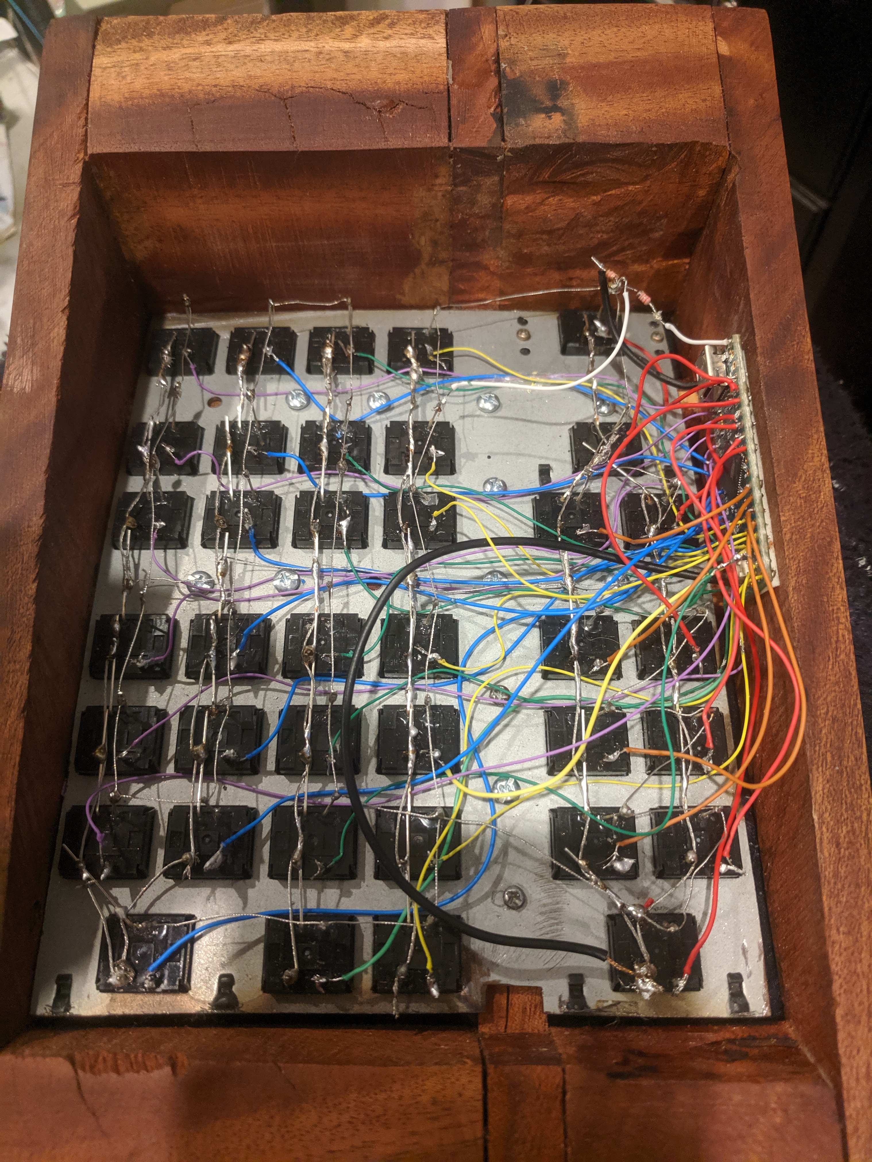

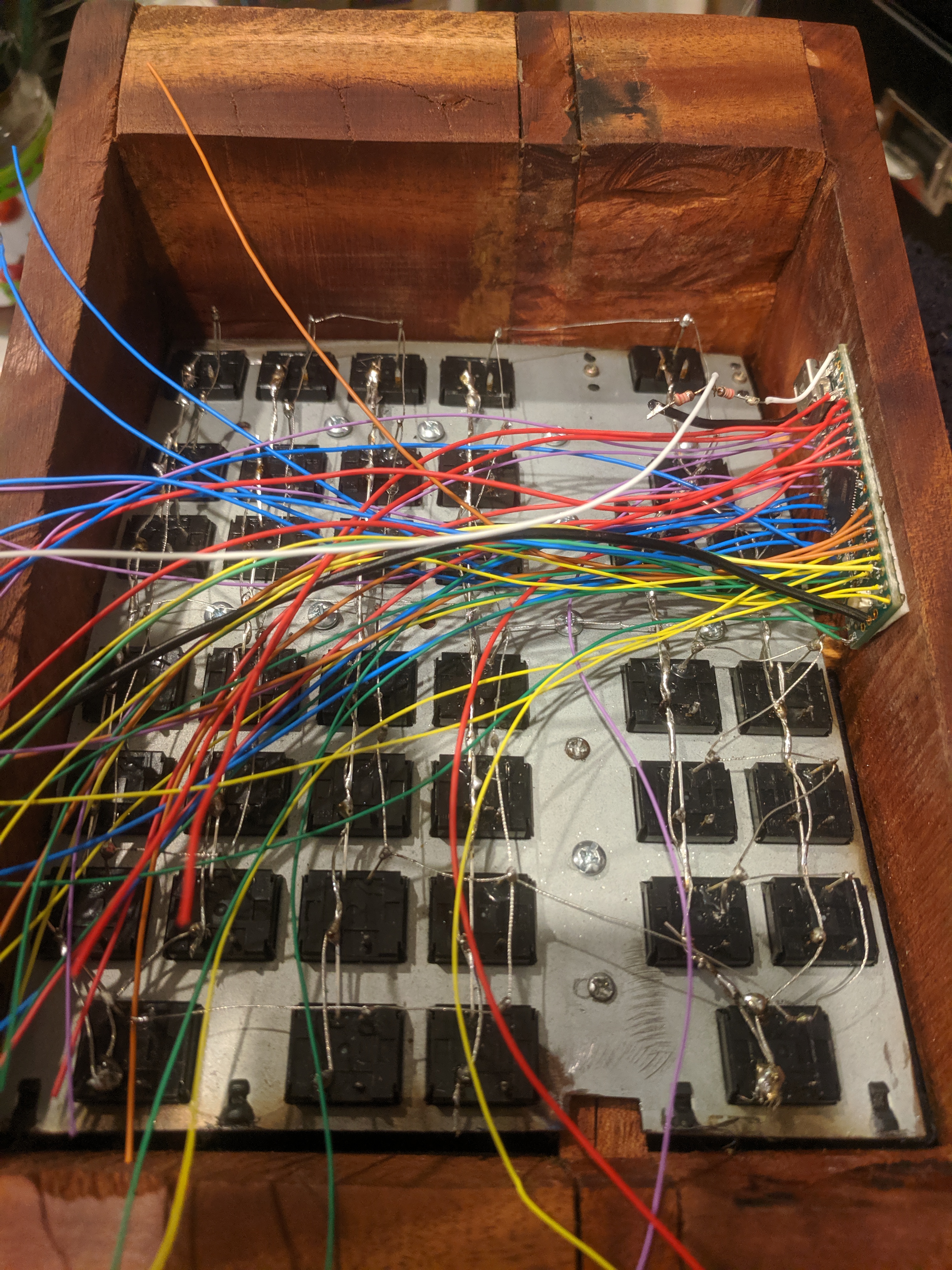

Teensy wiring half done.
flowerlandfilms
10 Sep 2019, 22:46
Teensy wiring all done!
