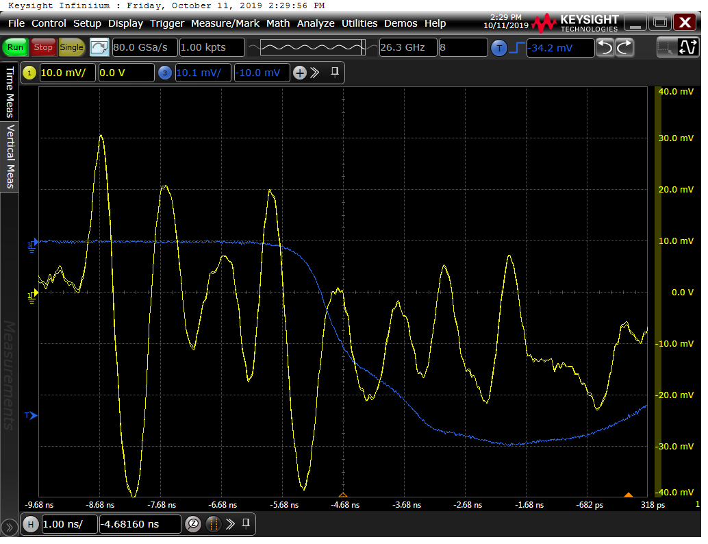

I also, just because the device was there and there was a 12GHz diff probe, used a 25GHz Agilent for a bit, to record what happens on the switch.
I have pictures, will post after PTO. Picosecond resolution is nice but there's nothing special there, everything looks just as it looks in Tek.
But agilent SUCKS. The interface is openly hostile.

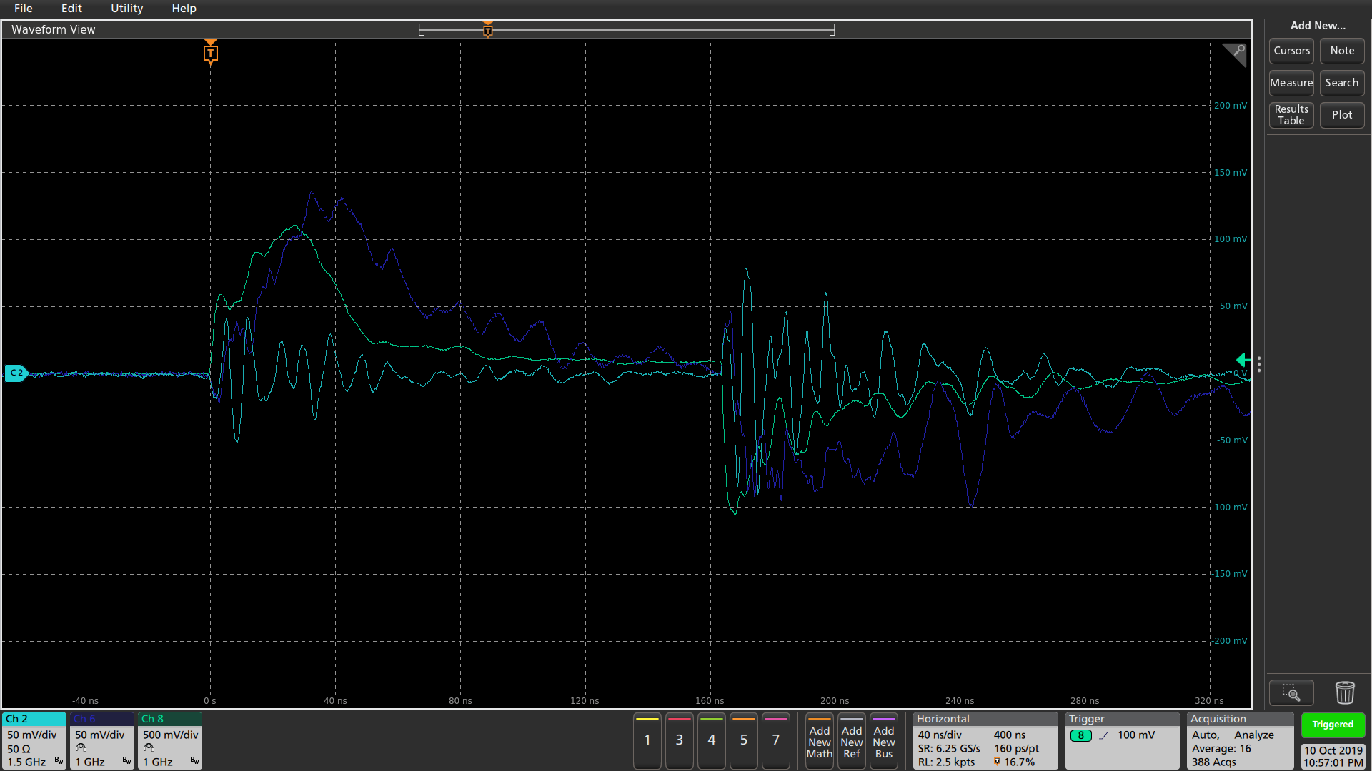

Tek (GPIO, pressed key, non-pressed key)
Agilent (diff probe across key, end of the driving pulse)

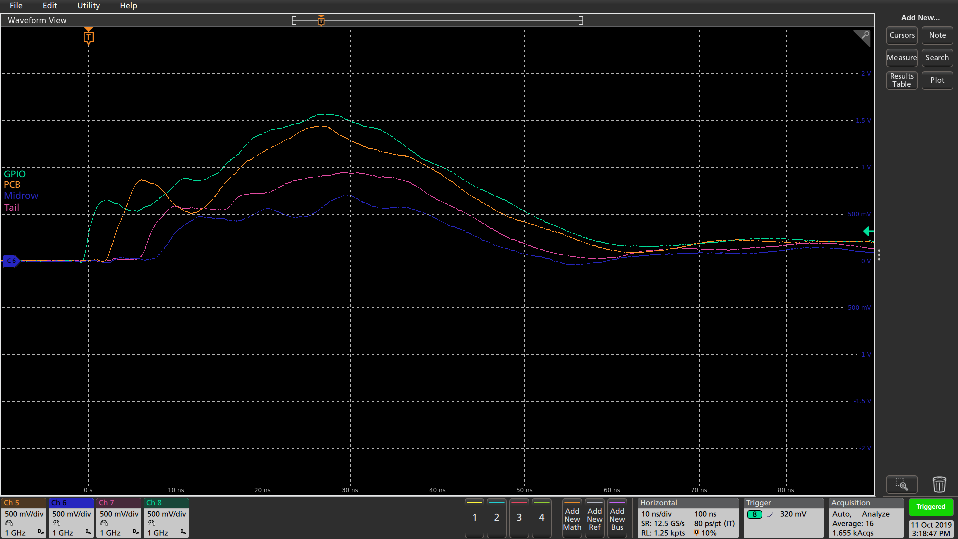

And this is a signal propagation delay - GPIO, PCB edge, mid-row and end-row. Yep, 8 nanoseconds delay. Somehow row tail responds before mid-row - but that's not an artifact, I've checked and rechecked connections and it indeed is.
