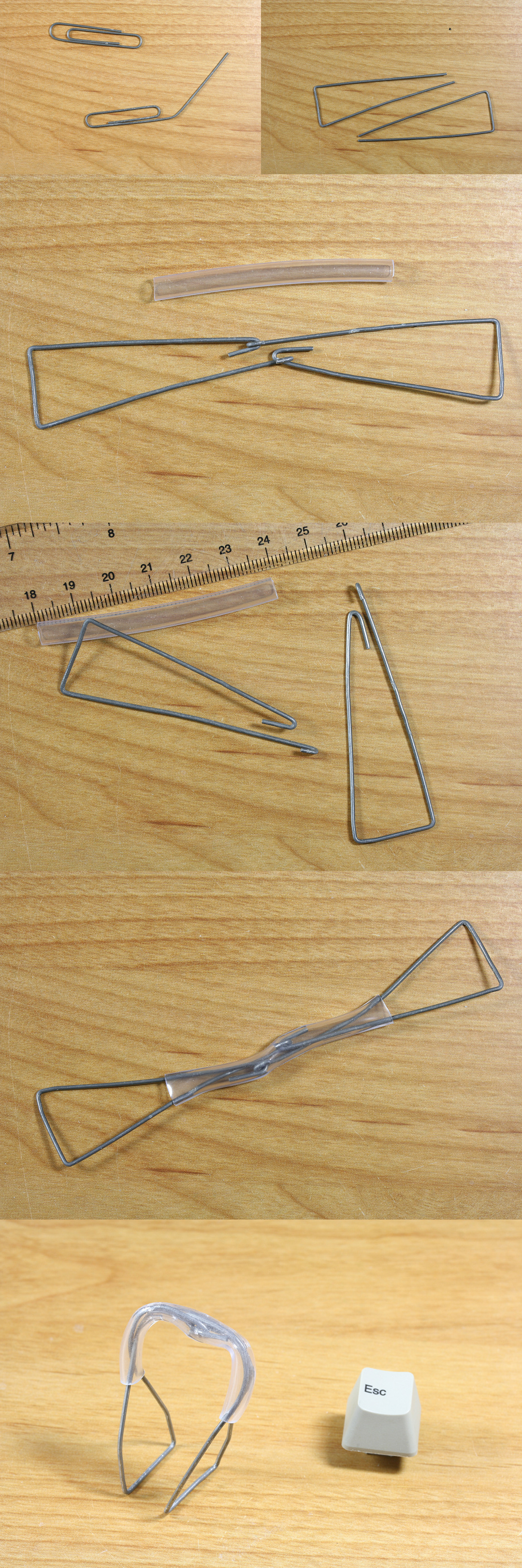

Spending 5 minutes to make something is worth it.
Old Alps can be touchy, pull straight up and be careful.

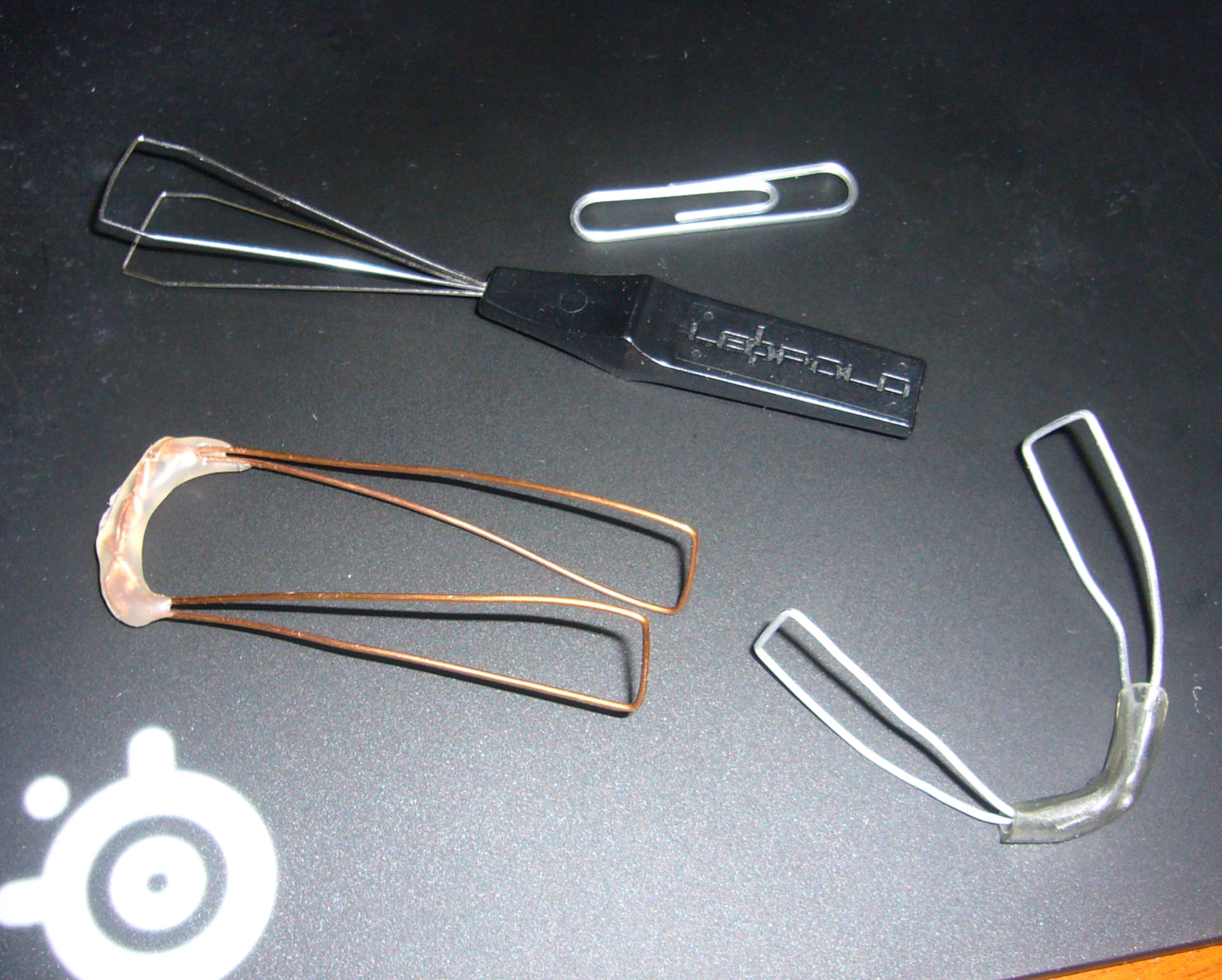

You can also make a nice puller out of a mini whisk — bend two loops to shape and remove the rest.
- fohat
- Elder Messenger
- DT Pro Member: 0158
The copper one is my favorite. I bent it out of the inner wire of a TV cable and the grip is hot glue.
- key-pullers-2018-04.JPG (413.68 KiB) Viewed 8541 times
- key-puller2.jpg (14.42 KiB) Viewed 8541 times
- keycaphowto.jpg (1.76 MiB) Viewed 8541 times

fohat wrote: 23 Nov 2019, 03:45 The copper one is my favorite. I bent it out of the inner wire of a TV cable and the grip is hot glue.
Useful for removing big ass enter keys.
