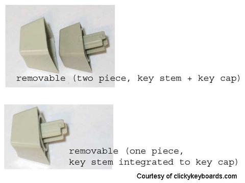

The underside of the keycap has some areas that do flex a bit when you insert the keycap, which might pose some minor difficulties.
Buckling spring keycaps are different from cherry keycaps, in that the buckling spring keycap forms part of the mechanism. When you take a cherry keycap off you can still press the switch.
When you take the buckling spring keycap off, you can't press the switch anymore really. You have removed part of the mechanism.
I would think then that the easiest way to get the aesthetic would be to focus on making the top part of the 2-piece Model M style keycap metal. That part would be much easier relatively to manufacture than a 1-piece Model F style cap
Like this. It might be hard to get metal that thin if you are machining it I am not sure. If your goal is looking good, I would try to just make the top part metal and keep the plastic bottom part. As the mechanism involves the keycap and barrel sliding against eachother, I am not sure how making 1 part metal would change the feeling, I am not sure it would be improved.

SneakyRobb wrote: 20 Jan 2020, 18:26
Touch_It wrote: 20 Jan 2020, 17:26 I might get laughed at, but I watched a Linus tech tips vid on the most expensive keyboard they could make. They got sent a tkl keycap set made from milled brass. I think they said it cost something like 2500-3000. not sure if USD or canadian.
IDK what my point really is, other than a full set of metal caps is either going to be insanely expensive for quality caps, or crappy.
Stainless might actually be a great material for caps, but good luck getting a set for buckling spring.
