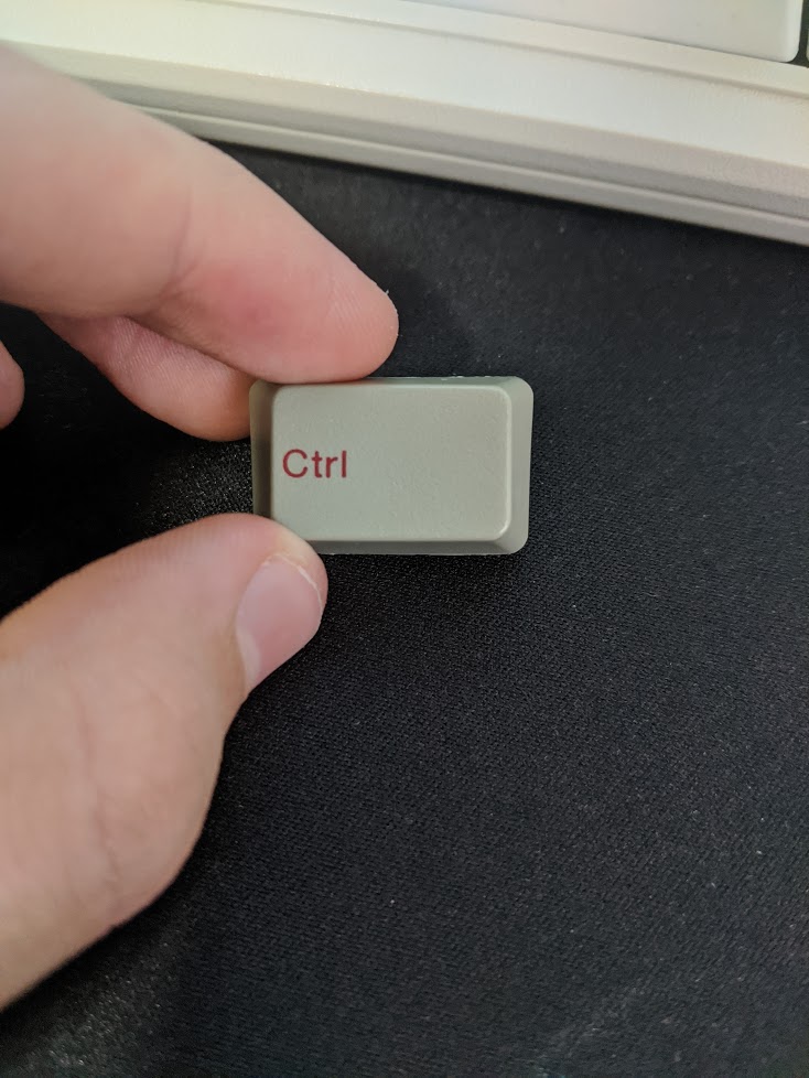

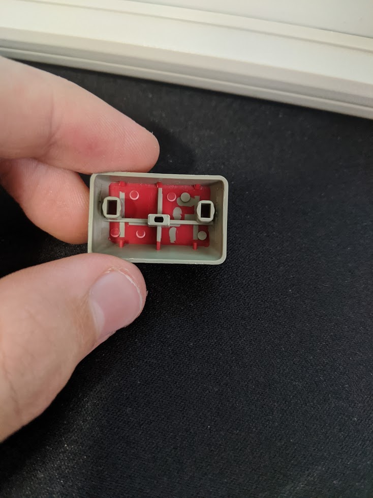

Being the idiot I am, I broke off the stem of one of the control keys on a Lite-on SK-2002. This really sucks as I don't have *any* replacement doubleshot control keys, and the ones on my FK-9000 are a slightly lighter colour and are different keycaps. I was wondering if anyone has a replacement or knows where I can get one. All of my attempts to glue the stem back on have failed (epoxy, hot glue, super glue, etc; nothing works and by now the stem is long gone). Here are some pictures of the top and bottom of the other control key from the same board (identical, but not broken obv). I really hope someone can help me out here. Thanks!

These are ABS key caps. With the correct surface preparation it's one of the most superglue-friendly plastics out there.
I would "pin" the parts together using, for example, some sections of paperclip, inside the hollow region of the Alps mount.
I've used these techniques to repair broken PBT keycap stems, perhaps you will have some luck.

I threw out the stem long ago. I gave up after almost two days of trying to fix it.XMIT wrote: 12 Jan 2020, 21:35 These are ABS key caps. With the correct surface preparation it's one of the most superglue-friendly plastics out there.

I've had good success repairing ABS with plumbing glue. But you have to be patient and wait two or three days for it to fully dry; that's the, uh, hard part.
