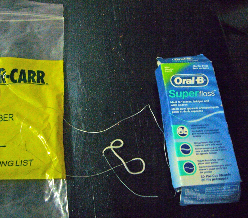

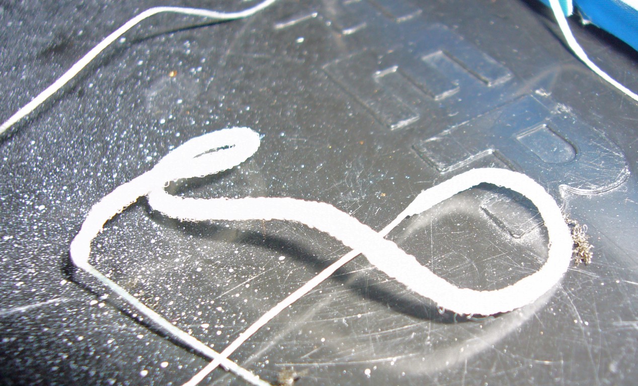

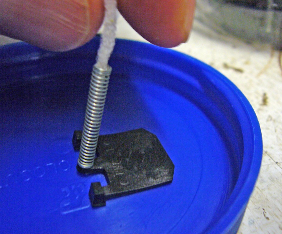

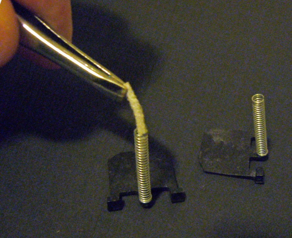

Obviously, not everyone wants or can use a loud keyboard. In my opinion, floss modding is a process that "civilizes" a Model F keyboard by knocking off some of the overtones (aka "pinging" or "singing") that some people love but others don't.zippolupan wrote: 21 Apr 2020, 22:10
Hey Chyros, as an Alps fan, what's your opinion on floss modding?
With the very light and wispy Oral B "Superfloss" product the effect on the feel is minimal while taming the reverberations, and particularly the ringing that carries down the hallway to annoy people in another room.
Some people have used other filaments, such as a single strand from inside paracord or a section cut from a rubber band, and these have greater effect on the feel but greater attenuation of the sound.
- F-122-Z01-floss-mod-001.jpg (260.84 KiB) Viewed 8334 times
- F-122-Z02-floss-mod-002.jpg (305.27 KiB) Viewed 8334 times
- F-122-Z03-floss-mod-003.jpg (174.52 KiB) Viewed 8334 times
- F-122-Z04-floss-mod-004.JPG (222.46 KiB) Viewed 8334 times
