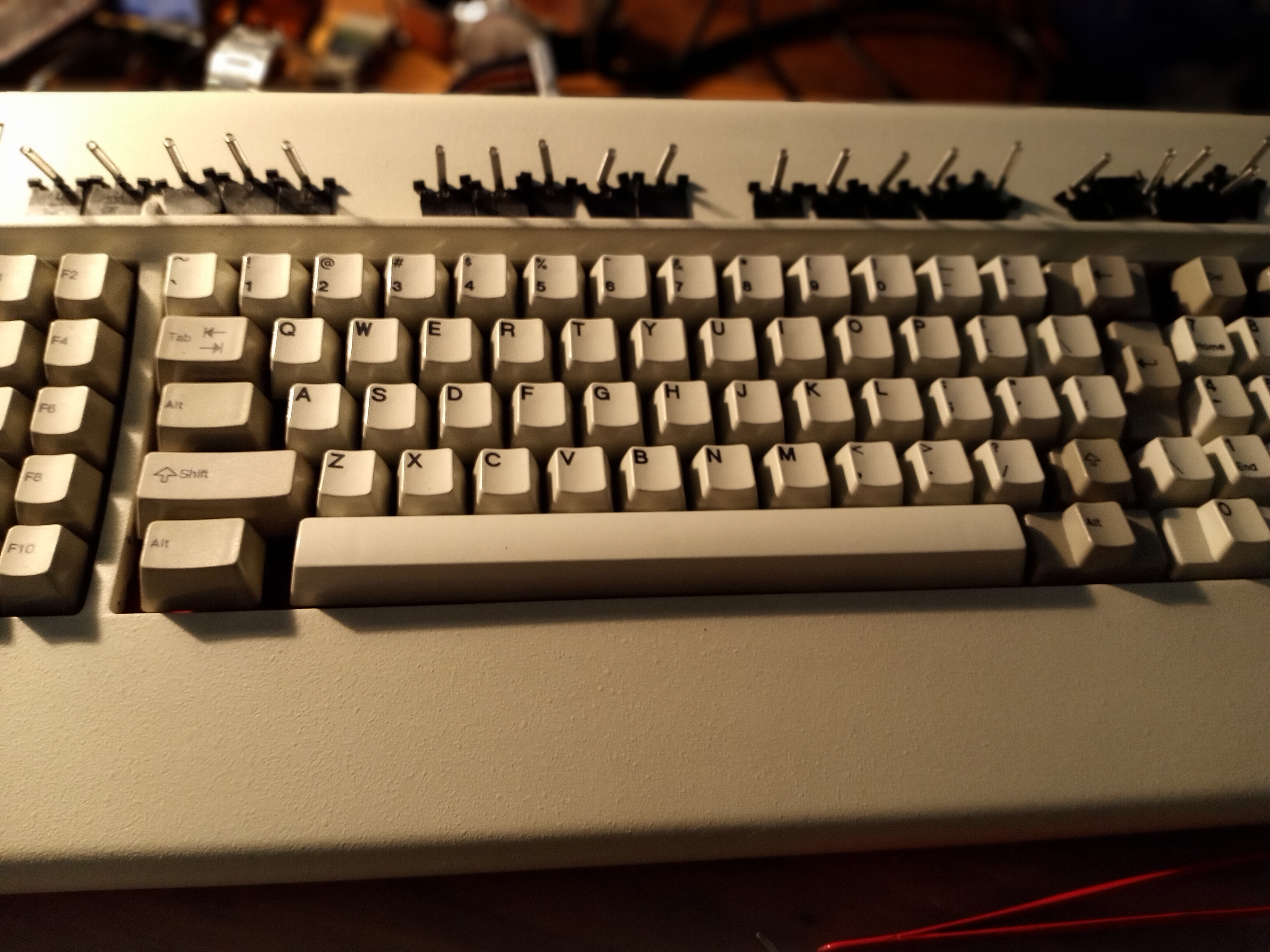

I have a model F AT that is not assembled that I was thinking of doing the space bar mod. I got part of the way through and I thought... I really like the XT space bar. I honestly would rather keep it. I dremelled part of it away but, nah XT spacebar.
So I thought, how can I have fun with this F AT?

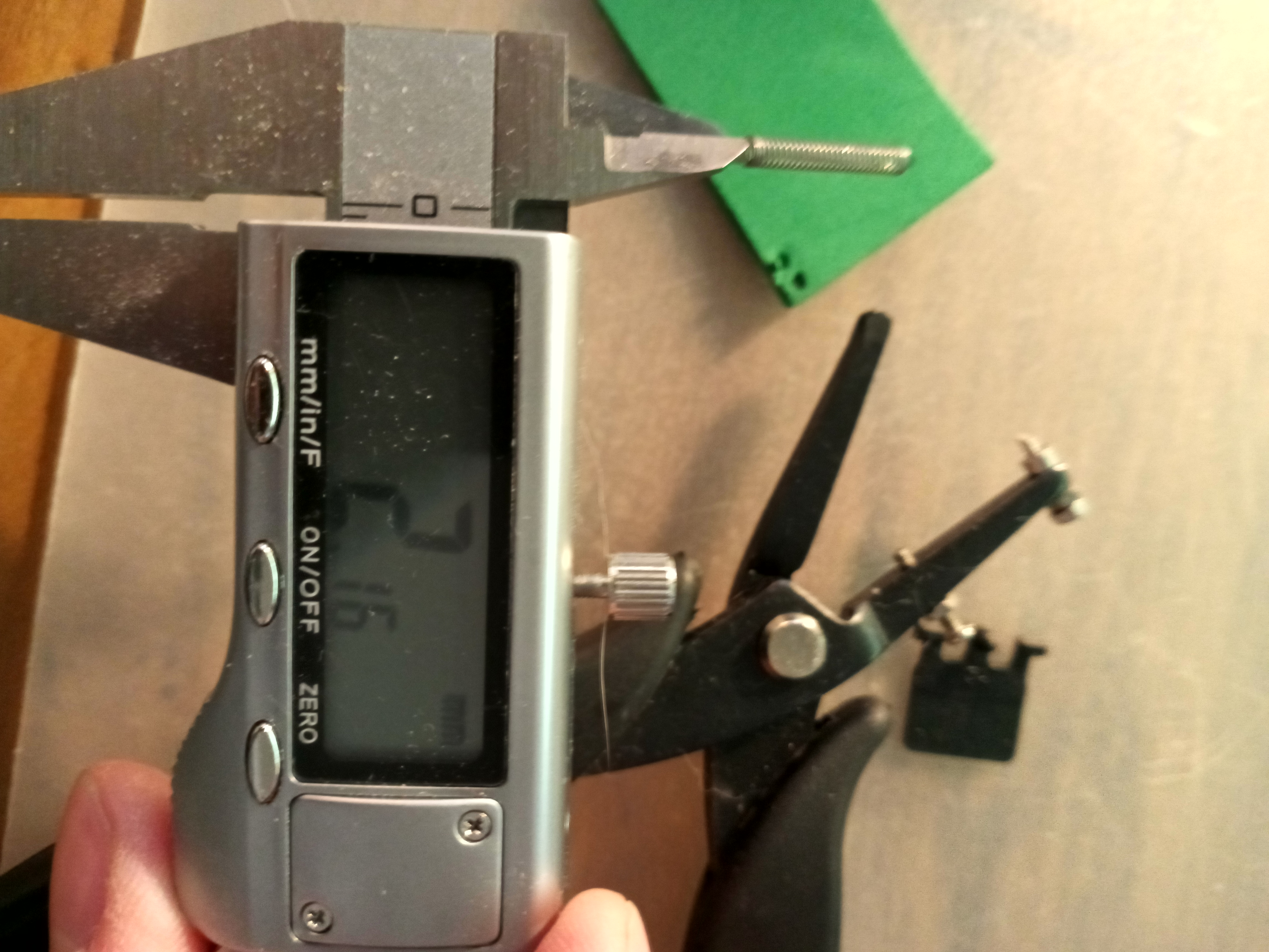

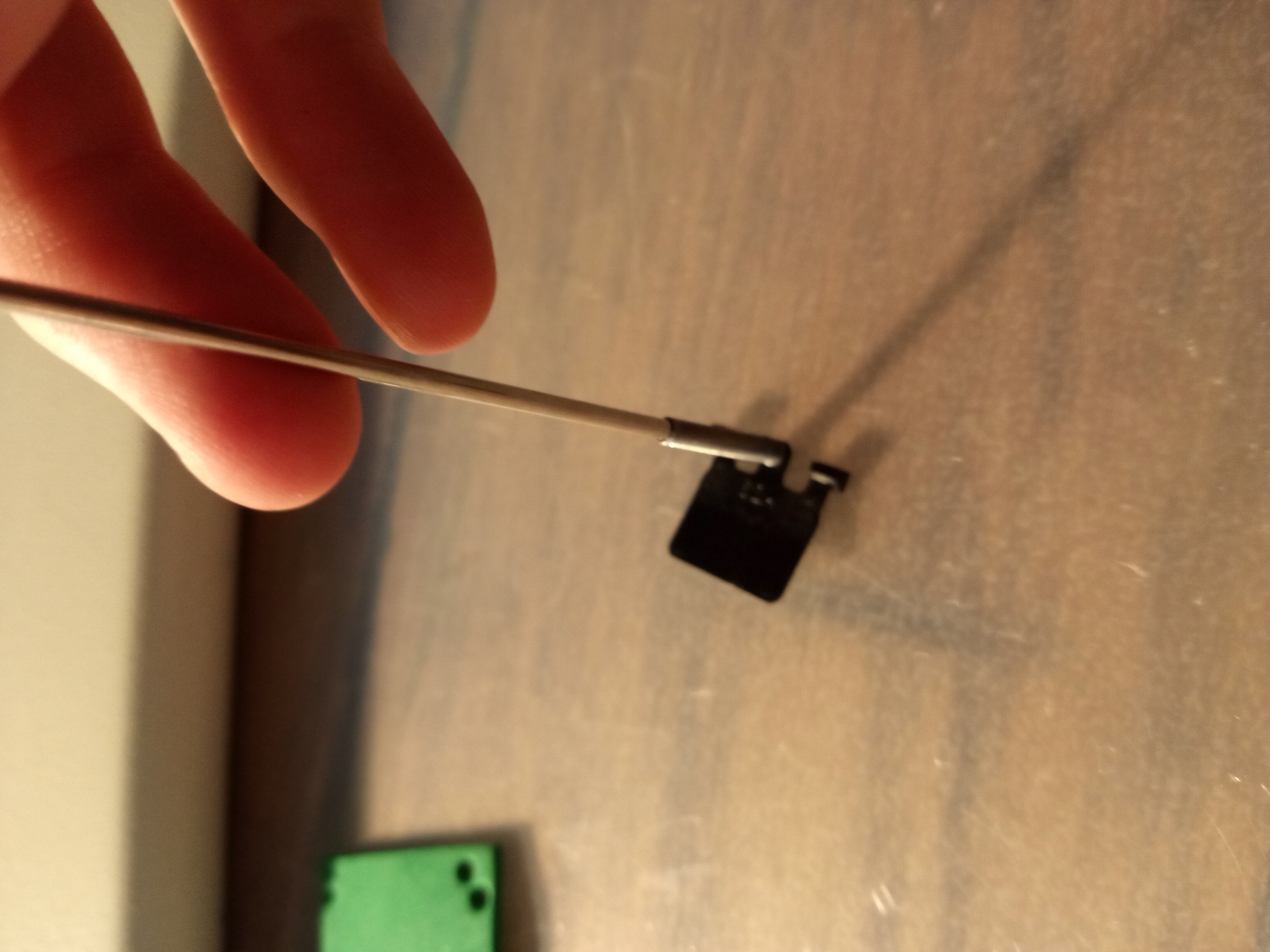

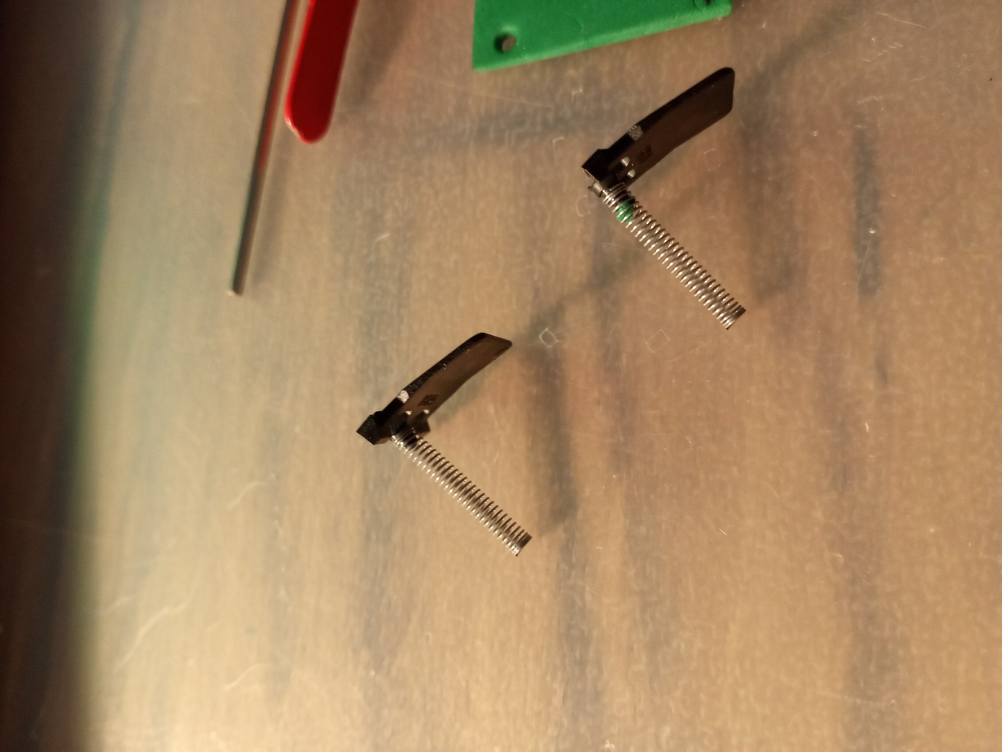

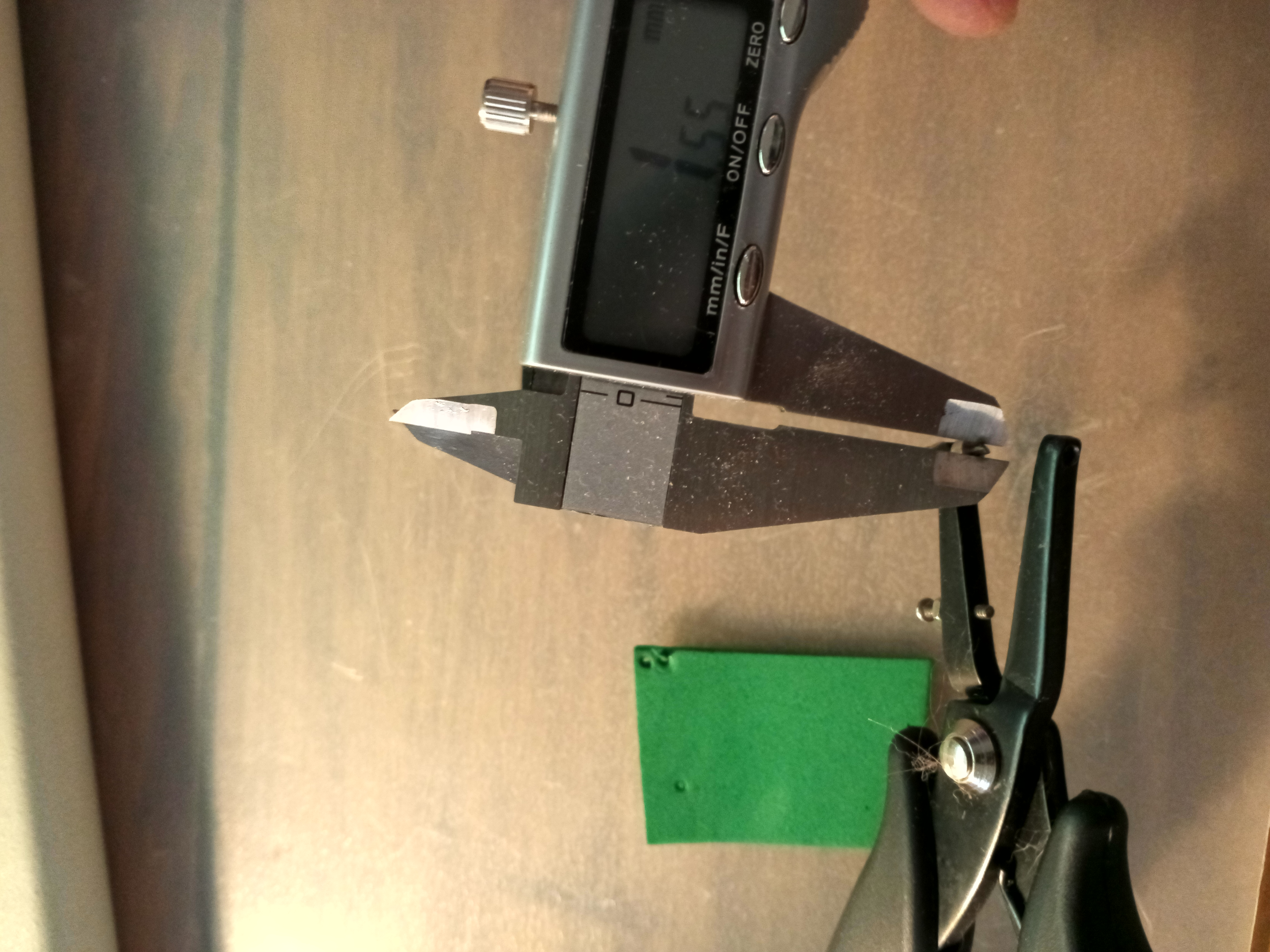

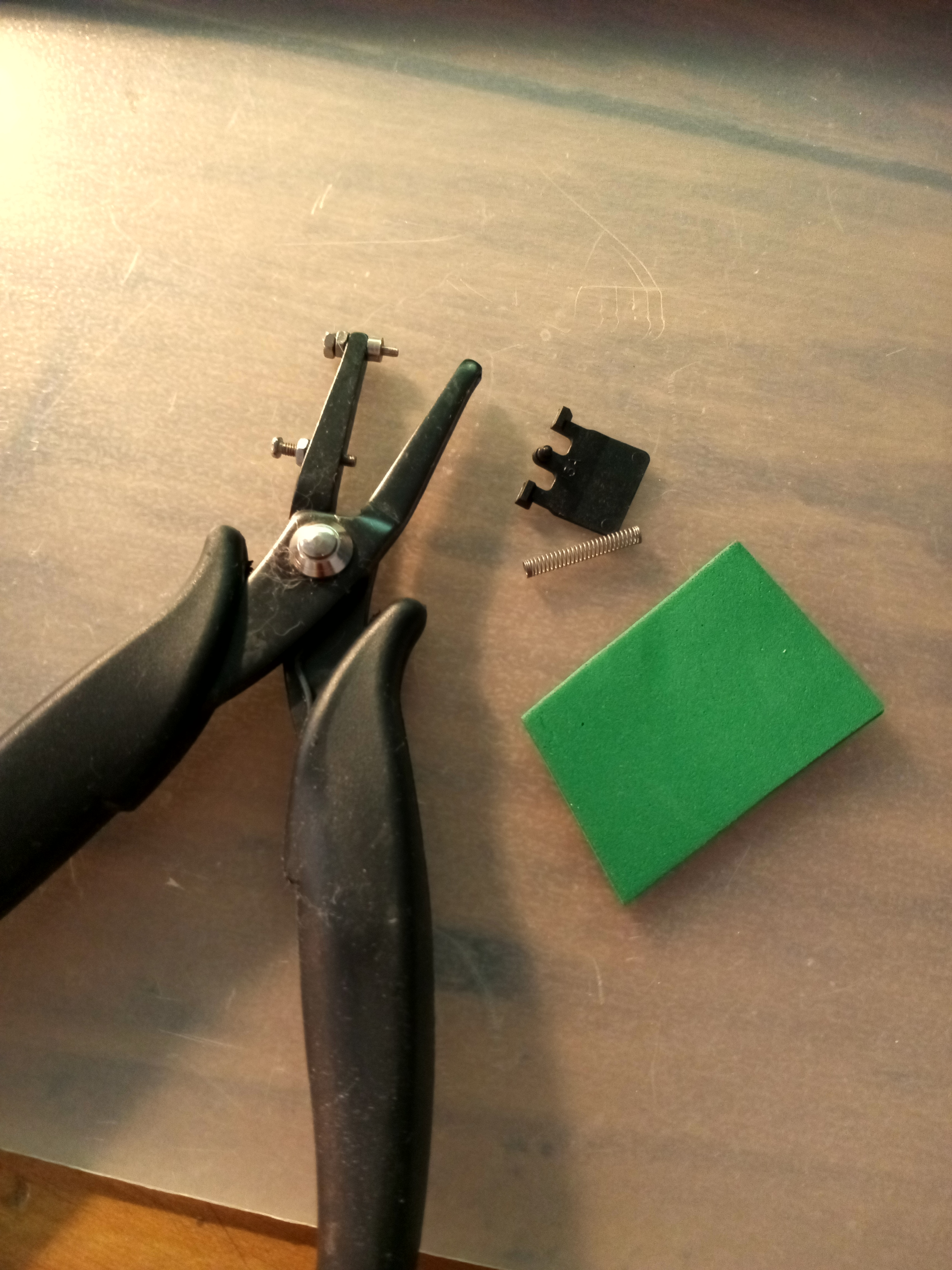

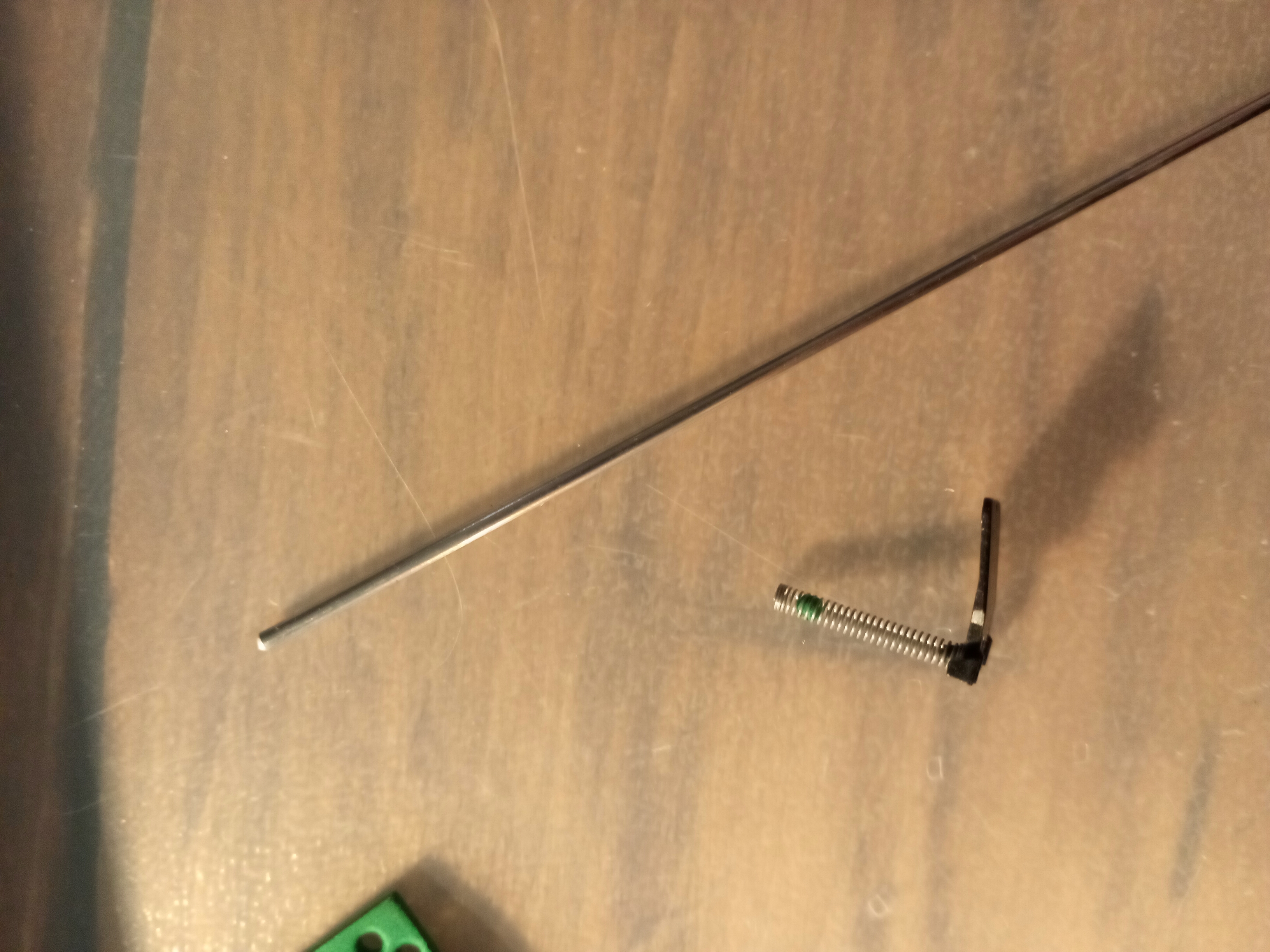

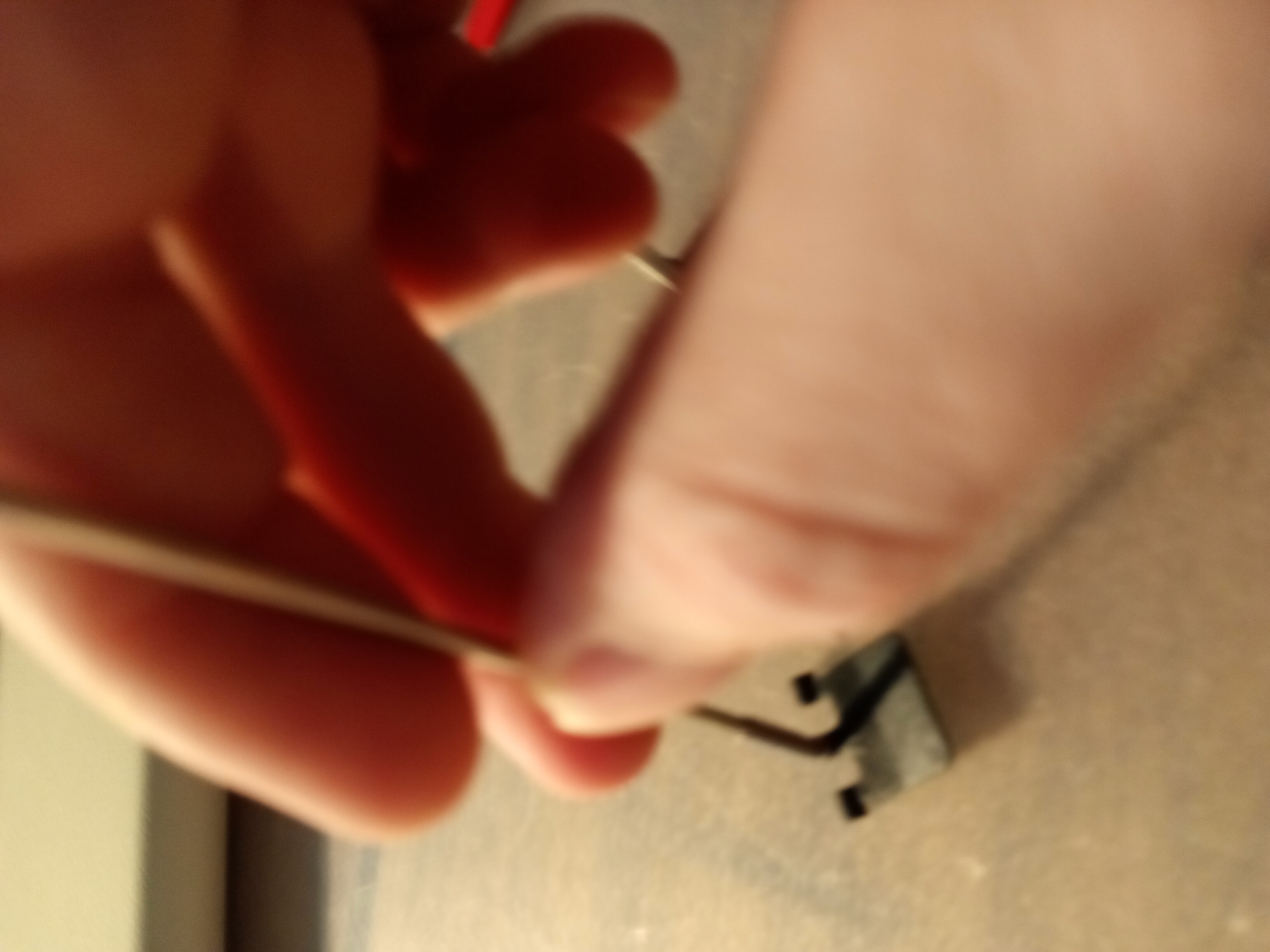

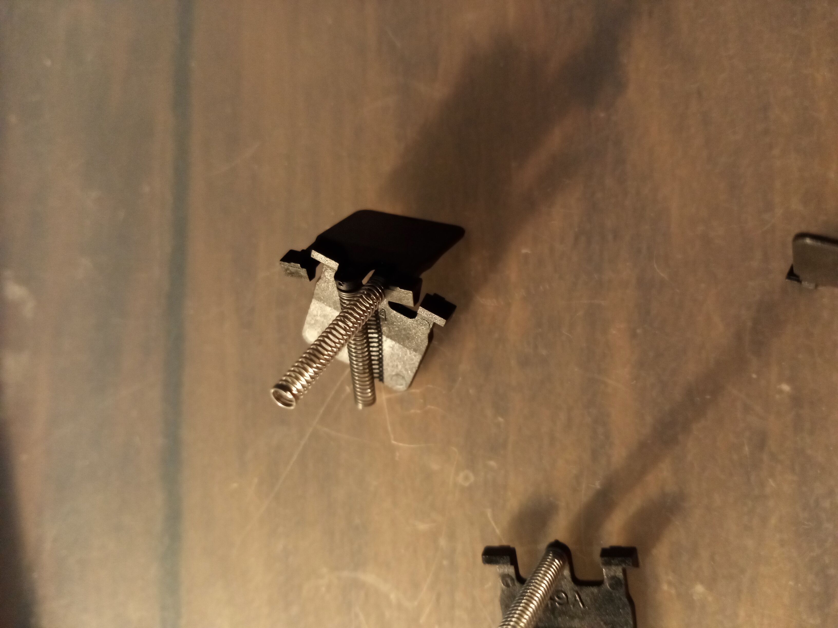

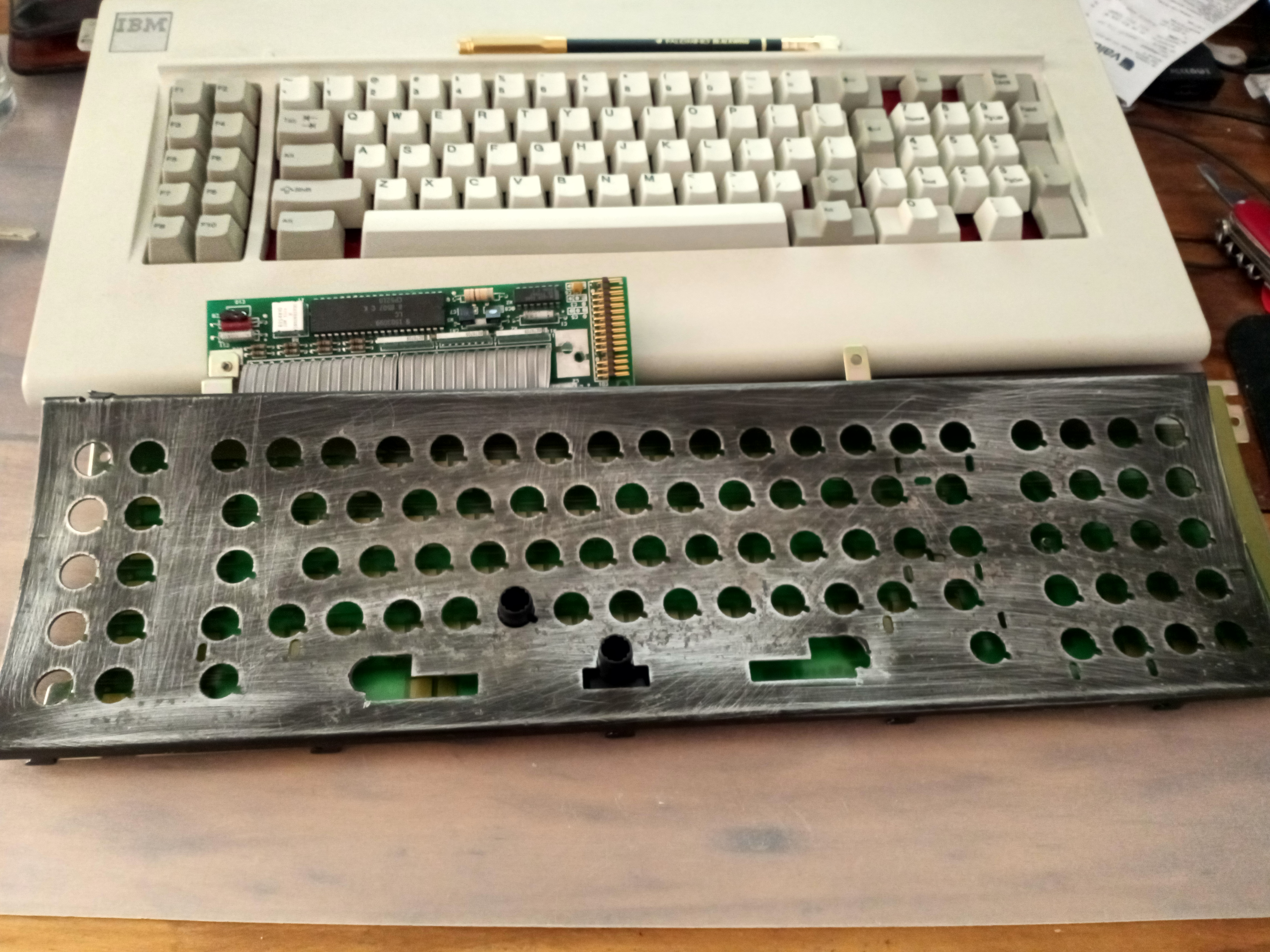

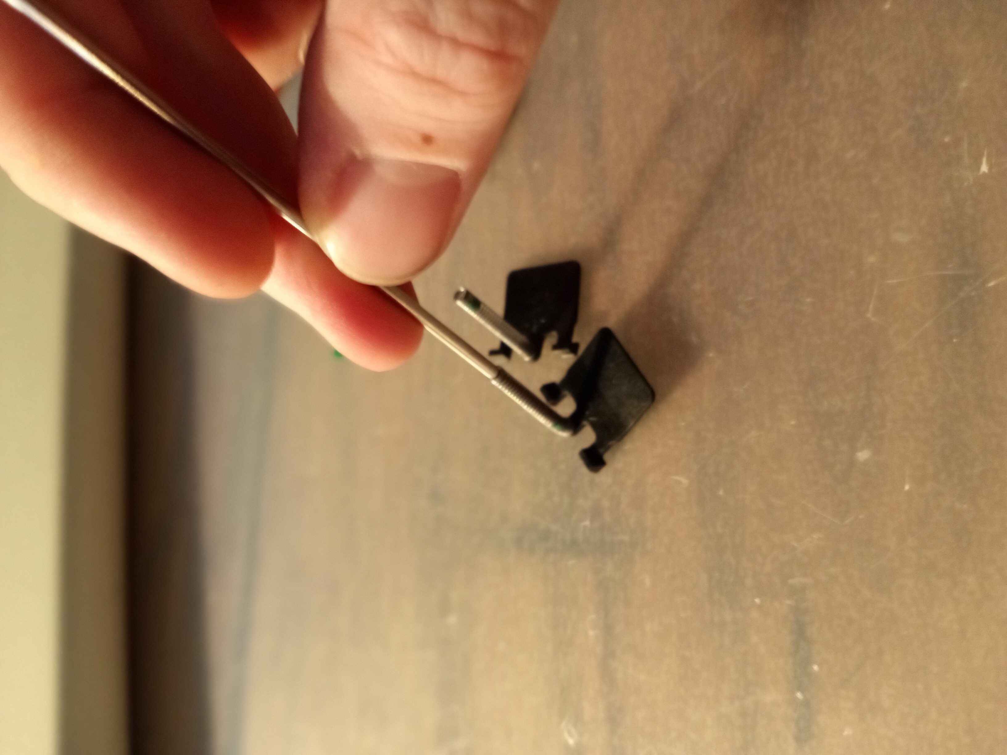

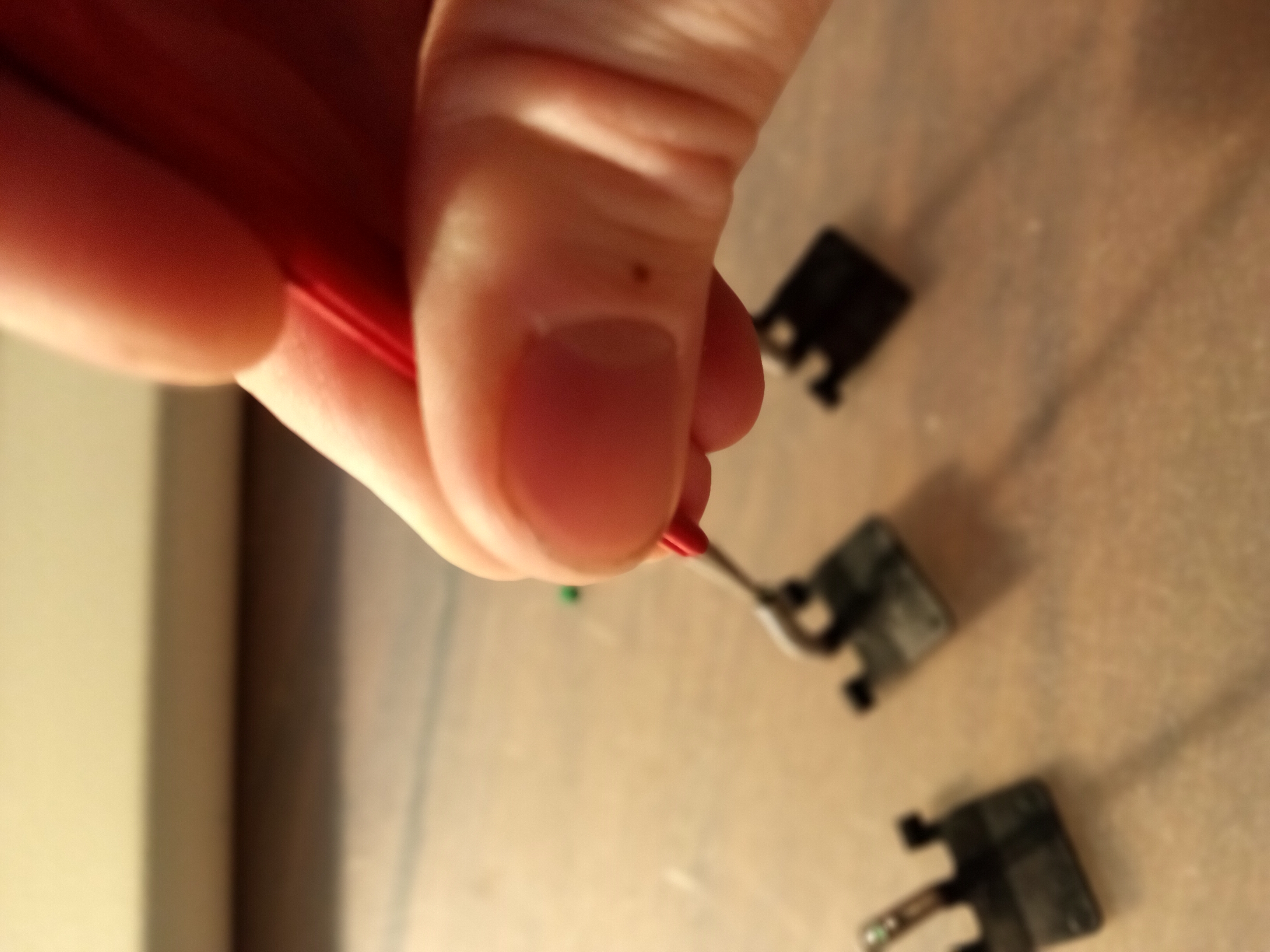

I will do a sound comparison! So right now I have assembled the the Numpad flippers on the AT with foam bottom plug dampened flippers like on the AT&T buckling spring and I will use the super floss on the F1-10 keys on the left.
Then I can see what PING reducing method is best.
I will film a sound comparison tonight, just assembling now. Here are some images of the process.
Basically if this sound dampen method works, the main benefit is that its pretty easy/fast to do and you can use the same foam from the rest of the restore process.
Basically you can use the same foam you use to cut the Model F foam mat, so this seem easy.
Anyway, Here are some photos. Hopefully done soon.
1 should I mod space.jpg (3.56 MiB) Viewed 5137 times
2 beamspring hole cutter works.jpg (3.54 MiB) Viewed 5137 times

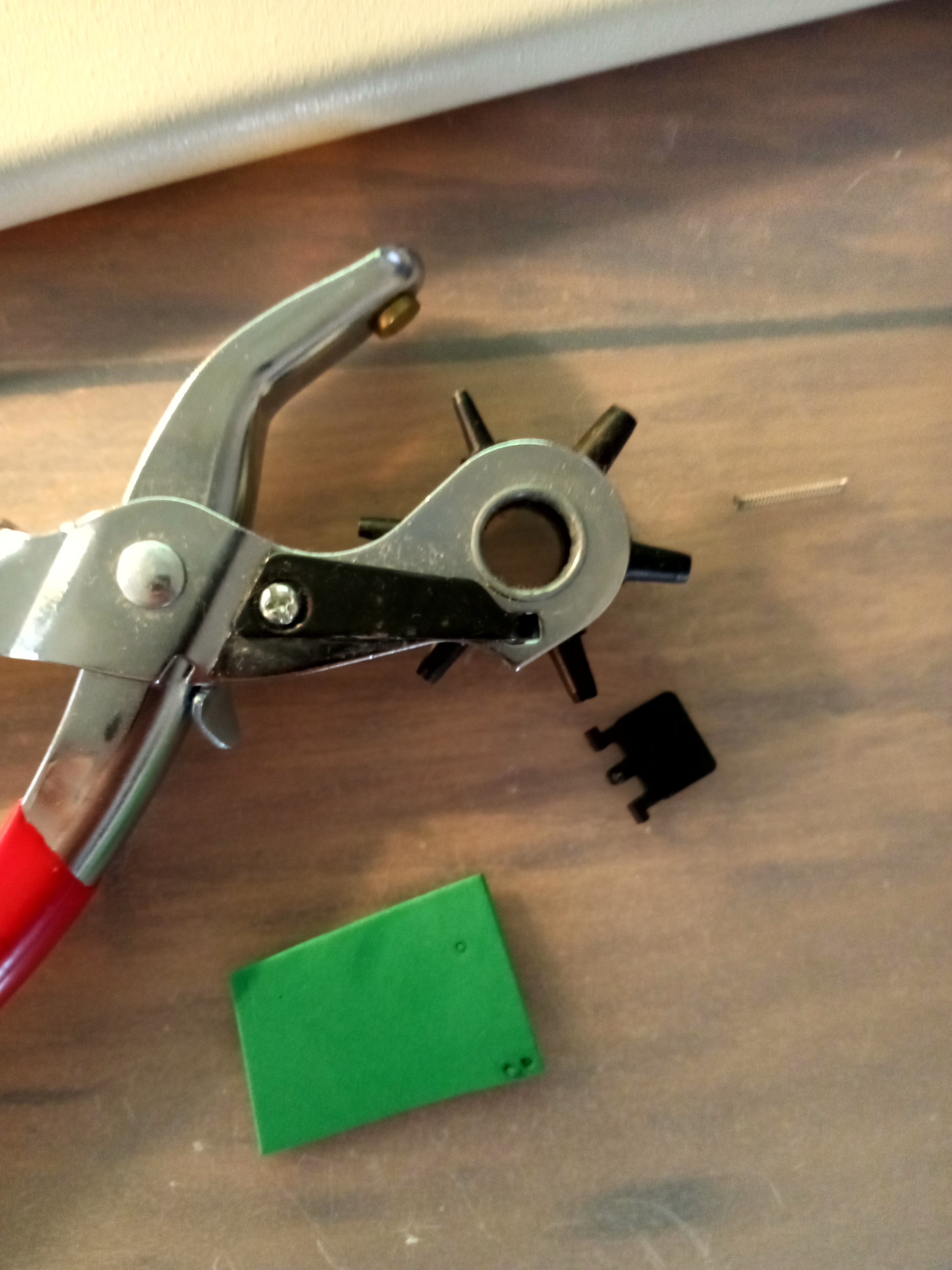

3 spring ID 2.15 or so mm.jpg (3.36 MiB) Viewed 5137 times

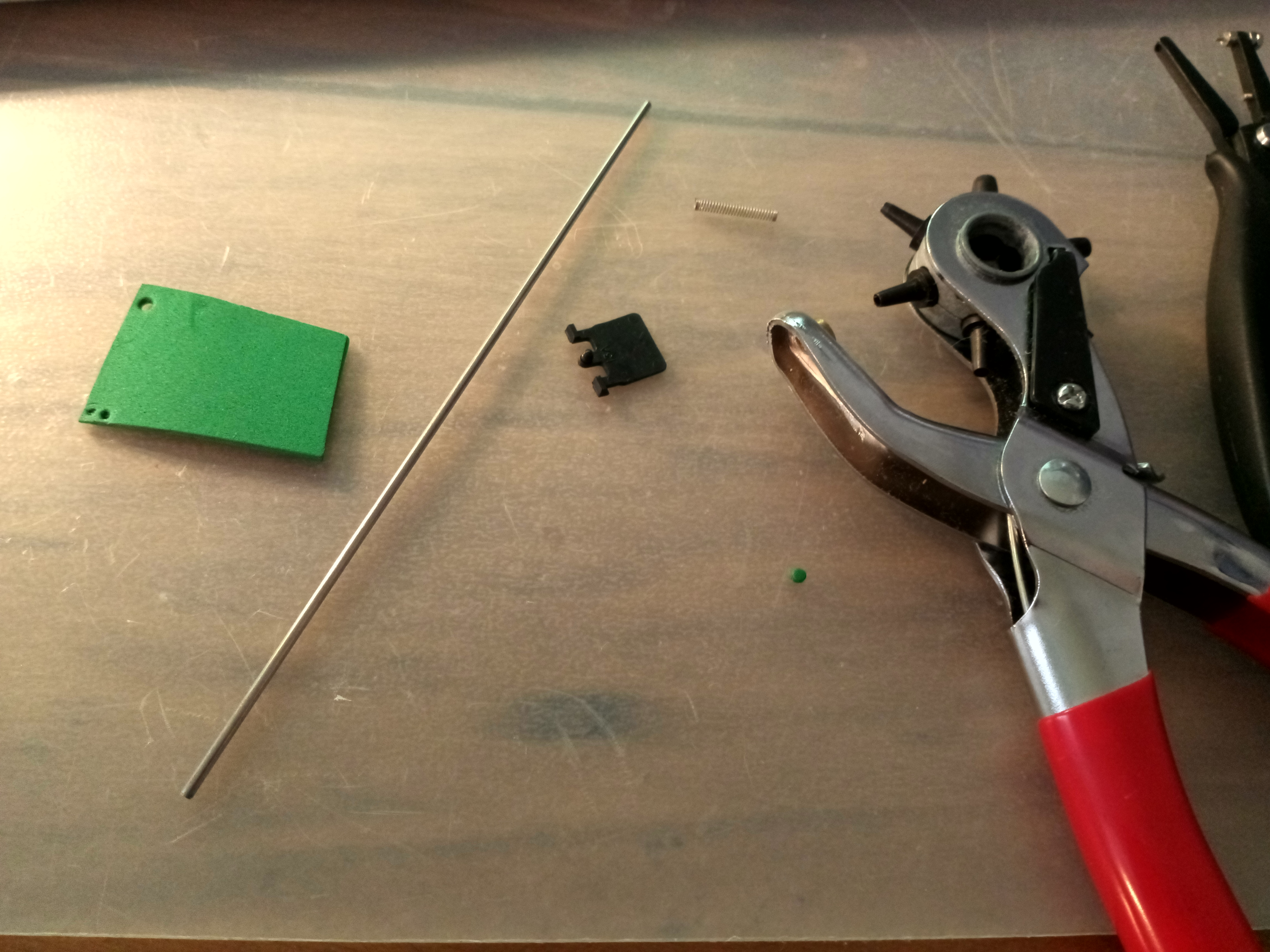

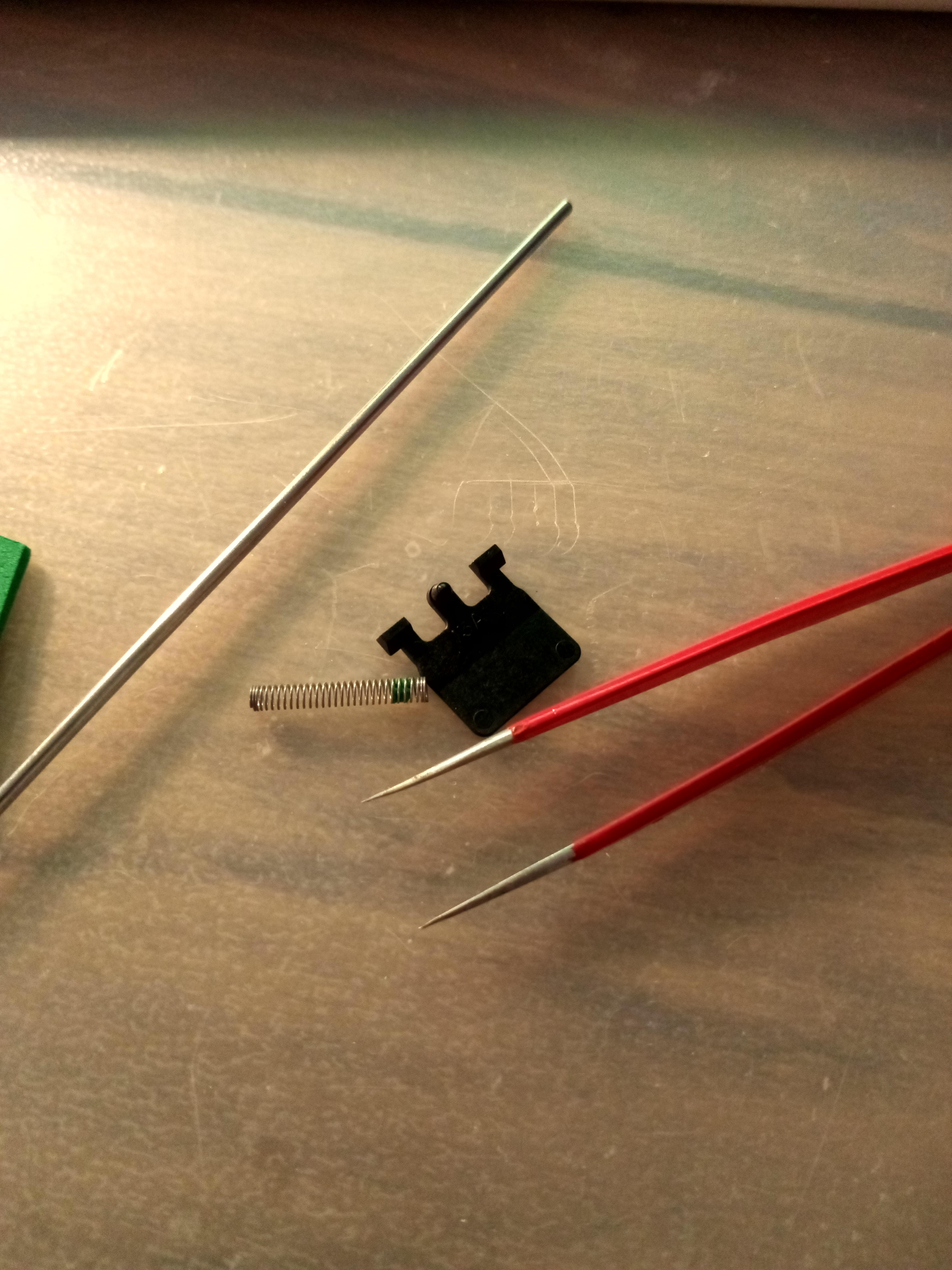

4 beamspring hole cutter too small.jpg (3.51 MiB) Viewed 5137 times

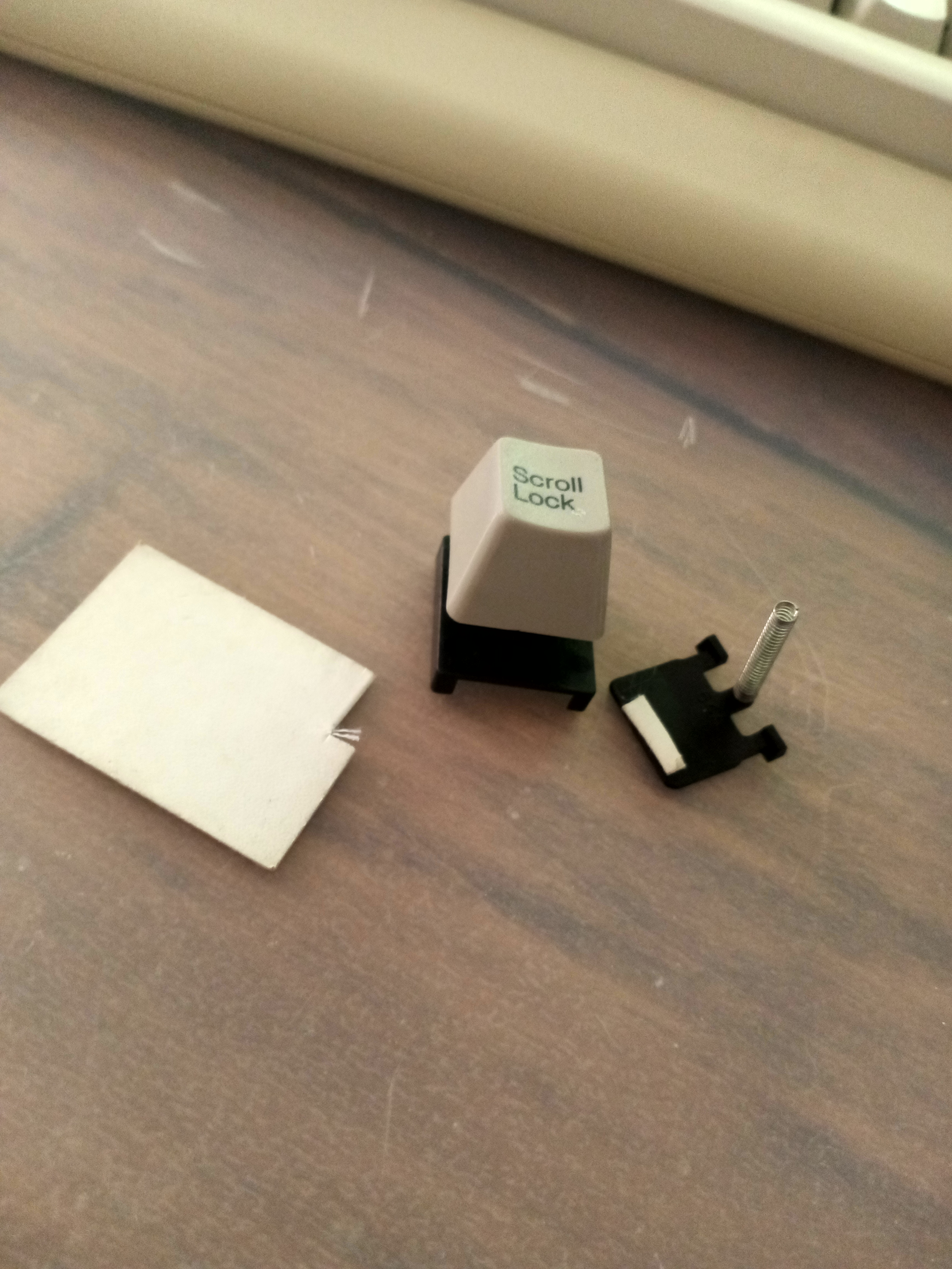

5 leather punch arrives.jpg (3.48 MiB) Viewed 5137 times
6 tools leather punch with stick.jpg (3.55 MiB) Viewed 5137 times
7 the stick is a metal rod about 1.5mm diameter.jpg (3.71 MiB) Viewed 5137 times

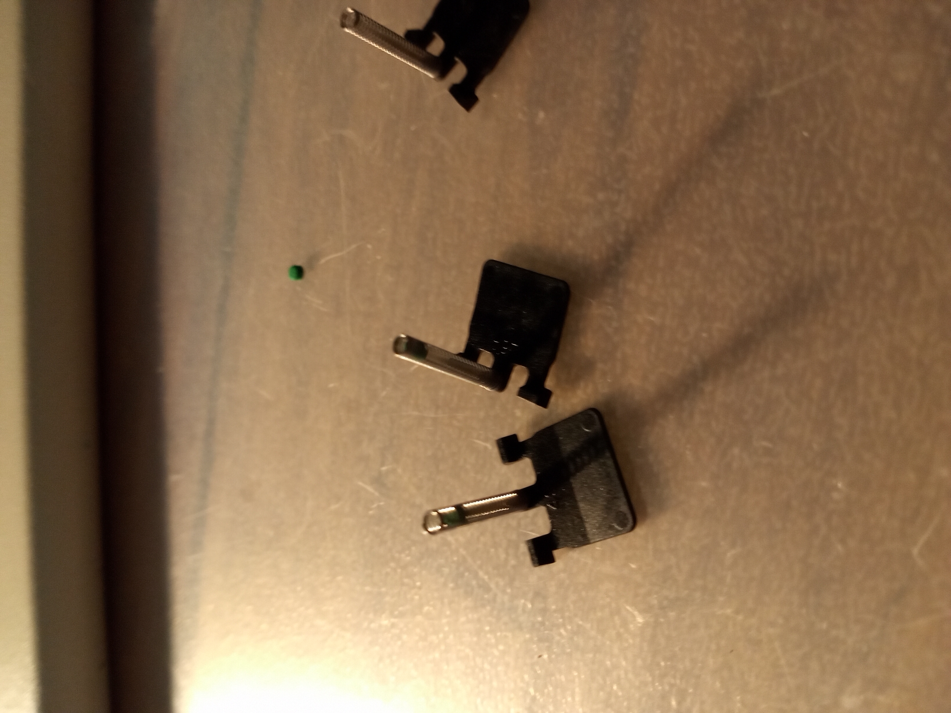

8 first attempt put foam bottom of spring.jpg (4.58 MiB) Viewed 5137 times
9 what if put top and ram with stick down.jpg (3.93 MiB) Viewed 5137 times
10 STICK WORKS.jpg (4.03 MiB) Viewed 5137 times
20 foam plugs made in 10 mins.jpg (4.42 MiB) Viewed 5137 times

The foam as mentioned is simply the same foam used in the F AT restoration, ie Michaels foam.

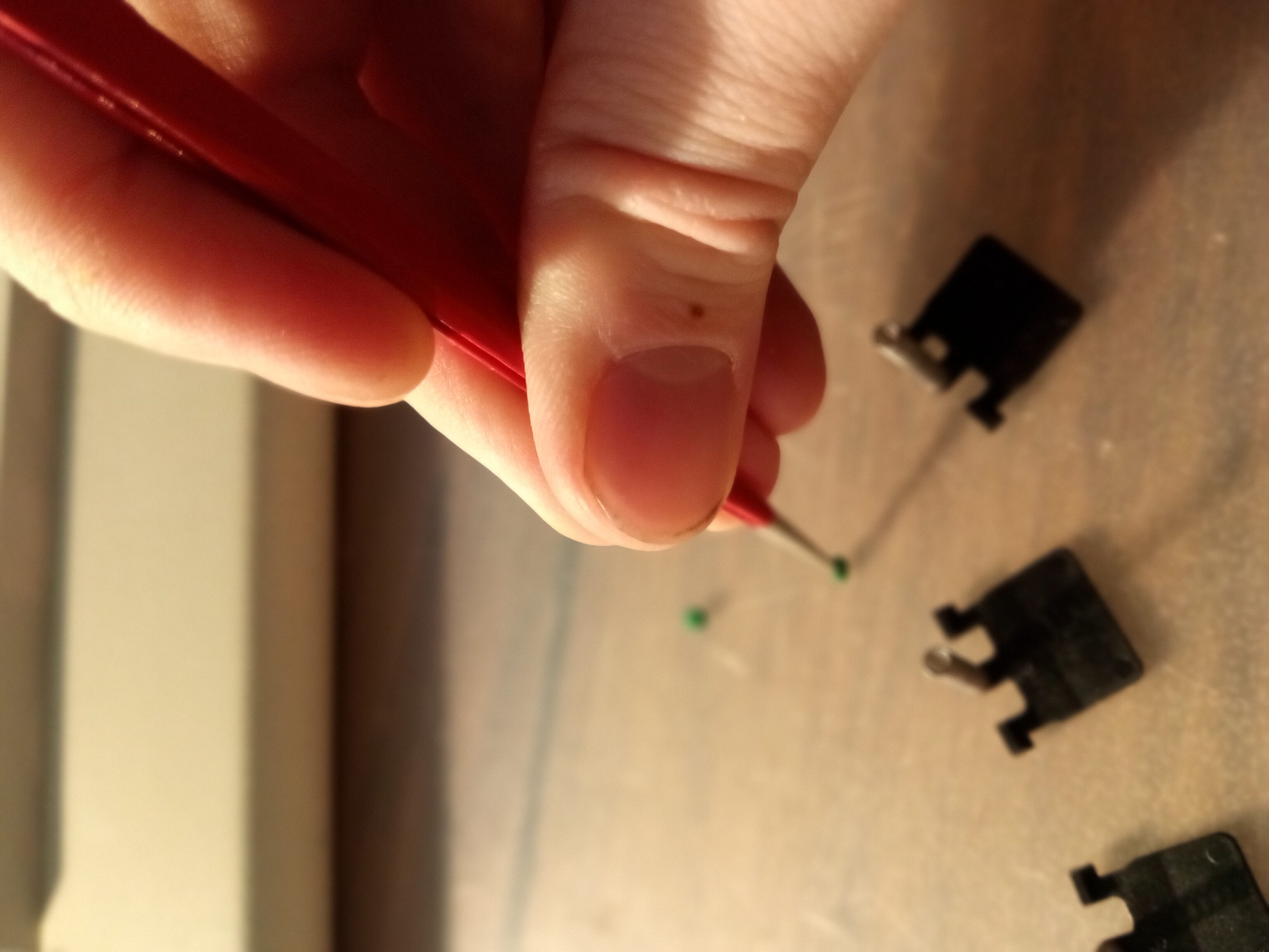

I think in general the sound is comparable to the floss mod. It is pretty fast to do this mod if you have a leather hole punch too. You dont even need to disassemble the board, just use tweezers to insert and a metal stick to push it to the bottom.
An advantage the floss mod has over foam-plug is removing the floss is much easier. Simply tweezer it out. For foam-plug you can pull the springs out of the barrels and remove the foam, but obviously that could occasionally result in a bent spring when putting them back etc.

I found that ping is a minor contributor - at least on my foamless F122 testbed. The rebound is something like +12db to the actuation loudness
