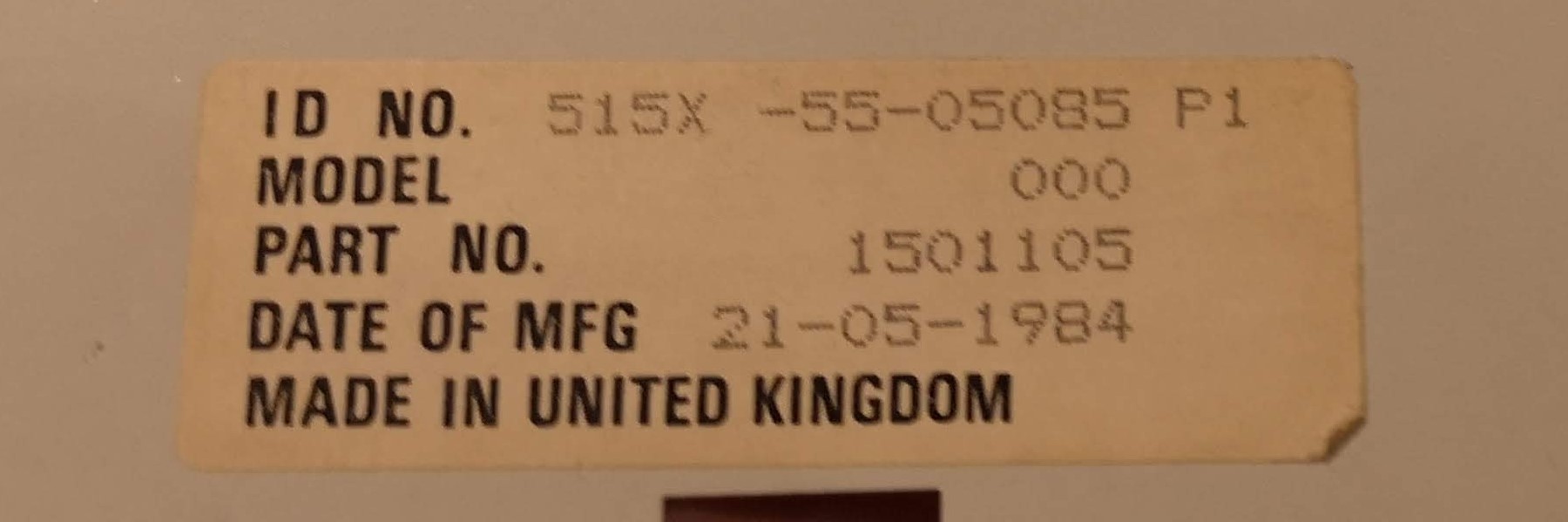

Both those Model F's are the US made ones. As all UK Model F's have a clear date of manufacture and also say Made In United Kingdom on the keyboards back label. Below is an image of the label on My UK IBM Model F XT. My UK made AT also has a similar style label as my XT.
Below is an image of the lablel on my XT
My IBM XT.jpg (120.91 KiB) Viewed 2999 times
