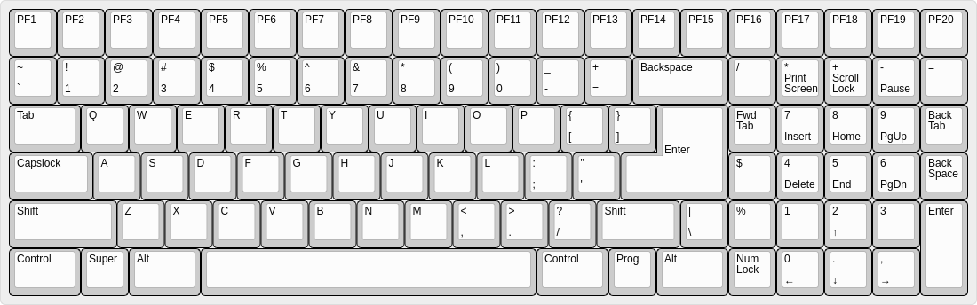

Hello. I have been complaining about the standard keyboard layouts for at least two years. My big problems with it where the following:
-All the navigation clusters (including the mouse) in the right side
-A confusing and bad optimized numpad
-Way too big Enter for ISO layouts, which is stupid and hard to stabilize
-F keys are not as useful as they should
-An irrational extra 0.25 wide
-Lack of such an useful key as Back Tab
The first result was kinda a monstruosity, so I wanted to make something a tiny bit more orthodox. Today I finally came up with a keyboard that is both normal enough to be easy to get used to and also corrects all the considered problems.
It's kinda self explanatory except for the F keys. You can have a set of 12 often used programing instructions for your main coding language (I grabbed C because YOLO), a set of 12 useful text macros, a bunch of FN keys or just the normal F keys. The current mode is displayed with an RGB LED.

I think numpad on the left is what the "full-size" layout should have got in the first place.
Everything else, I disagree on. The Return key should be big so as to be easy to hit, considering that the little finger isn't nearly as precise as a thumb and index finger ... and because it's the law.
Back-Tab is on Shift+Tab already.

The layout: There is no significant improvement compared to standard keyboards. Get an ergonomic keyboard with thumb clusters (Kinesis Advantage, Ergodox, ...).

I agree with vvp. You’re bang in the unhappy middle where there’s not enough difference from standard to be noticeably better to use, but plenty enough that you’re incompatible with all the best keycaps sets! Go big or go home.
Shifting the numpad to the left, though, that’s entirely correct. Some boards have done this over the years. As a 60% user myself, I appreciate a well centred homerow!
Incidentally, what drives me nuts on ISO is that tiny left shift. You’re keeping that? ~shame on you~1

Thanks for the honest opinion. As a 3101 layout user I LOVE the 2x1U enter key. Still, get the point of the law, I think that's the main problem of try to get a keyboard both compact and as complete as you can. I know about the Shift + Tab thing, otherwise it would not be possible to make a Back Tab macro.

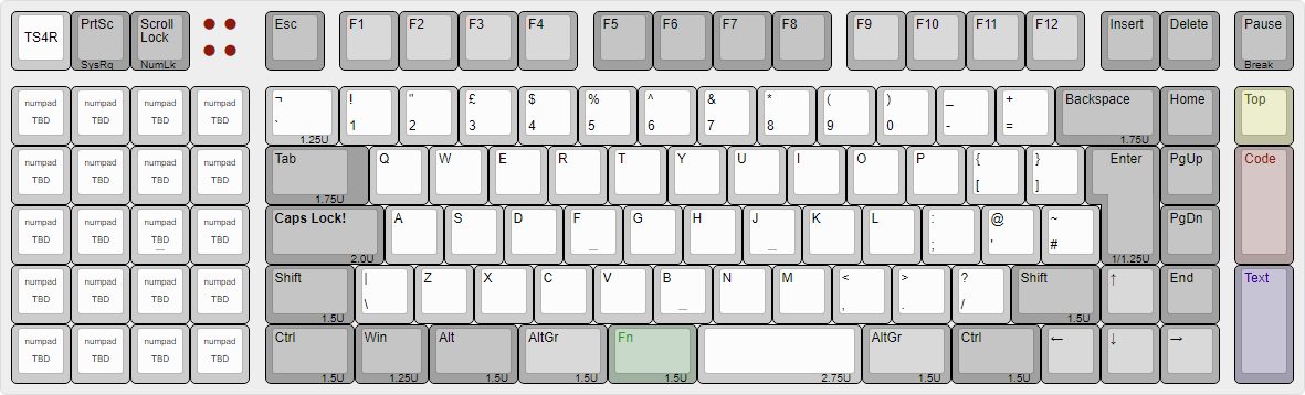

Thanks dude. If you want to see the heterodox brother here it is, but don't mind about the weird legends:

Or maybe go with this?
14 May 2020, 13:42
Keys all smooshed together makes for difficulty in finding your way around by feel. You’ll be looking down more often to find your place in this wall of keys. Needs some separations as highlights.
And your s p a c e b a r s a r e n e e d l e s s l y l o n g. Thumb keys are precious, don’t waste that real estate!

I like the 2u vertical enter a lot. And moving it one row down - compared to the XT layout - makes ergonomic sense and looks retro-beamspring-cool. Small Shifts also look good and one isn't dependent on sometimes annoying stabilizers. I - like most people - manage to hit the keys on a Model F XT, which practically (because they're stepped) has exclusively 1u keys, so aiming isn't really a problem.
Moving the numpad to the left side, would have been a good idea 40 years ago, when people weren't used to only ONE standard layout. Today I wouldn't want to bother relearning that. It's similar to the T-shaped cursor key cluster. It doesn't make sense, but because IBM (or actually all others, who copied IBM) made it a standard around 1986, most people (excluding me) consider it the only "correct" way.
Back-Tab on the right makes sense and looks retro (=good), but for most people, it's probably a rarely needed key (combination).
Spacebars look good to me. No need to complicate the bottom row unless one is in the 40 % faction.

PlacaFromHell wrote: 17 May 2020, 05:05 About the colorful modifiers they are supposed to be toggled just like a lock key every time you work in a different way. The idea came from a very old PLC program that I used, where you were supposed to manage the logic gates by pressing the F keys. For example, if I open the Arduino program I just press the red key and use my most regular instructions by pressing just one key instead of type the entire syntax by myself. The same with the rest of the keys, each one works as a profile.
All the more reason, then, to keep those close.
PlacaFromHell wrote: 17 May 2020, 05:05 My bigger headache is what to do with the nav cluster. I'm sure I feel like it wastes a lot of space, but between contract it or expand it I can't find the correct solution. Maybe add 4 more keys and use a lower profile for the arrows and a higher profile for the rest of the keys? With dedicated Ctrl + PgUp / PgDn keys and something more.
Why not refine your 79%+leftpad, and use that 17th row for your macro buttons? Here's an idea:
75% + macro column and leftpad
With this, you could take advantage of a common 75% layout, with those mode selectors readily available for actual usage; here, I'm assuming Fn to be the one required the most times (and therefore below the left thumb, and giving 2U keys to two of the remaining three. There is space to shuffle things further around, of course.
The exact composition of the numpad remains to be determined, as I still have to write that damn post. I will note, however, something I forgot to mention yesterday, which is the position of the + key: it's too far away on both your numpads (remember there's a reason it was made into a 2U key in common numpads).
PlacaFromHell
18 May 2020, 11:22
Sorry for the delay, I had to think a lot about it.
depletedvespene wrote: 17 May 2020, 23:19 Then DON'T make a tiny Caps Lock! Put those 0.25U on the left side and enjoy a 2.0U Caps Lock key!
Well, that's not possible while having a Back Tab key, which is the case of my Televideo (Alpha Lock + Back Tab).
depletedvespene wrote: 17 May 2020, 23:19 All the more reason, then, to keep those close.
I don't really use the F keys, so there is no need to toggle the layers back while doing the same thing.
What actually makes sense about get the 0.25U space back is the fact of having an extra key in that row. And about the NAV situation I kinda like it, but I think is smarter going this way to have a full cluster with more useful keys:
I replaced the legends on the layer keys to be more self explanatory, the keys do the same.
The world deserves a new numpad, please write that post.
