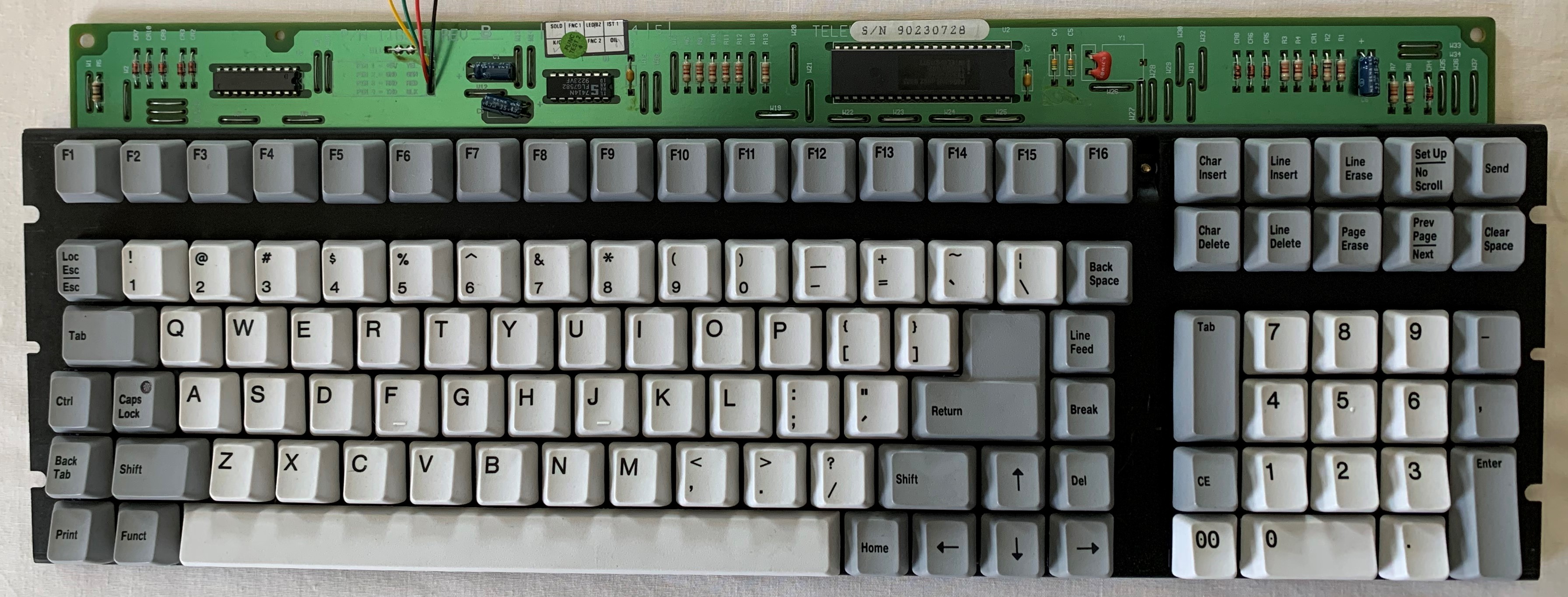

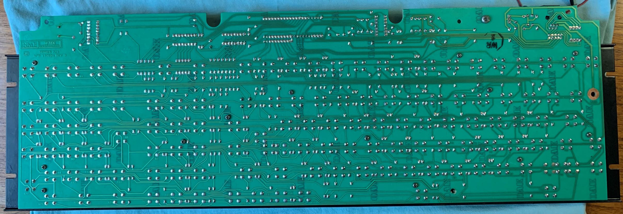

I got his board with NMB Hi-Tek switches some time ago.
All the chips have 84 datestamps, so I assume it was made around 1985. There is no OEM branding that I can spot. It shows no sign of ever having been used and came in its original(?) foam-lined box.
It appears that CHM has a very similar one. Theirs came with a spec sheet, but it went into their archives and hasn't been scanned yet, so that doesn't help.

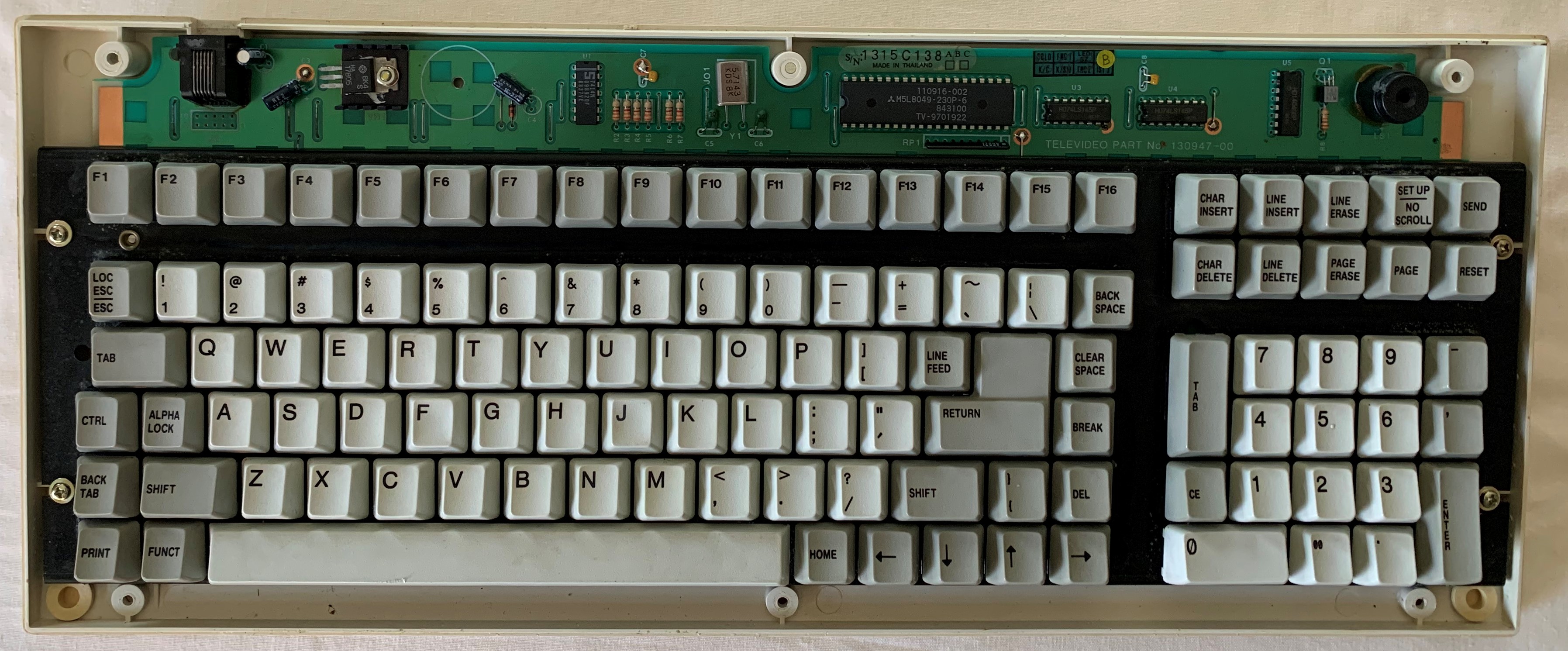

There's clearly a 5V regulator on the left there, so it takes 12V (or did originally; since it just regulates it down to 5V, anything around 8-15V should work). So care was required to get the signals right before applying that higher voltage power.
The controller is an 8049 and it connects to the terminal with an RJ12. After a bit of tracing,

The digital signals go through an inverter twice, a standard trick. As there is no clock signal, the protocol will just be serial. There is also a transducer (buzzer) connected to the controller, so input will be needed to work it. Most of the matrix goes through a pair of decimal decoders but the shifting switches connect to the controller directly.
It came with those red wires already and they turn out to be connected to the signals that really matter: power and data out. This made it easy to connect to a scope and bang on the keys.

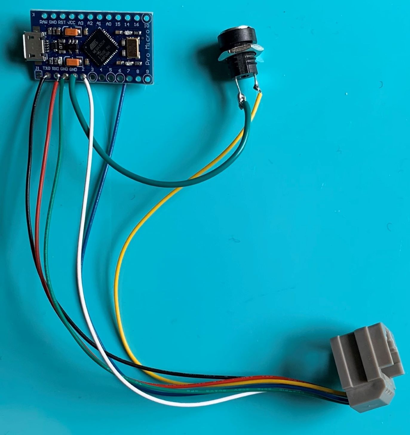

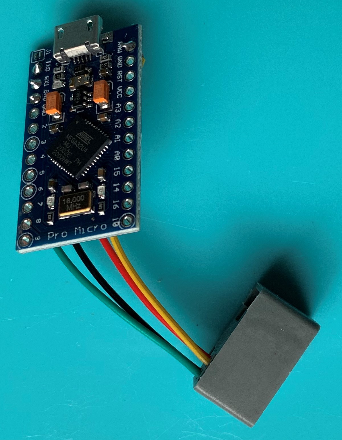

At this point, the possibilities for what a USB controller can do are a bit limited. So I put the board aside for a while.
Recently there was discussion about what can be done for a USB keyboard without both make and break signals and with character conversion done by the keyboard. So I gave it a shot and the result is here.
A Teensy is usually preferable over Pro Micro for the same processor, because:
  • the bootloader is smaller
  • it has a reset button to put it into the bootloader when developing
  • there are more GPIO pins and they are somewhat more rationally laid out
But in this case there is plenty of room, the keyboard has its own reset button, and really only RX is needed.
And in favor of the Pro Micro:
  • cheaper
  • two ground pins next to the UART pins

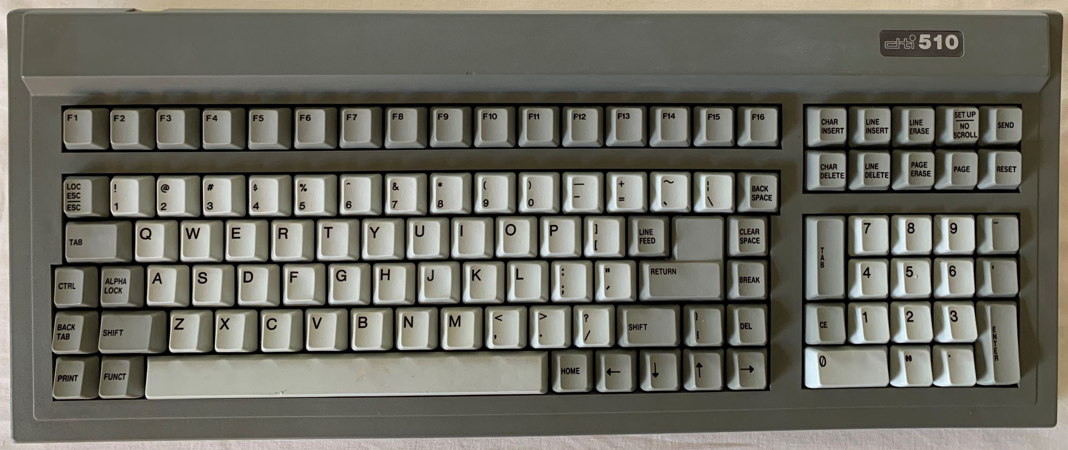

There is no question of having the Reset key work as an ordinary key. It is, in fact, wired in series with the Ctrl key and nothing happens unless that is also pressed. Furthermore it resets the 8049 itself. It would work to wire to the ATMega32U4 -RESET pin. But that would short the two sets of pull-ups and require that the keyboard be powered with its 12V for the converter to work, even just for programming. So, instead it's wired to another GPIO and the program jumps to the booloader when it notices that, so it still works as needed when iterating uploads.
Mapping out the keys reveals a couple of additional pecularities.
  1. The firmware is evidently confused about bracket keys, thinking that there are [ ] and { } keys: unshifted opens and shifted closes. Even though the key caps are normal. This isn't a big deal, except that it means that it was apparently impossible to type GS on this keyboard. Both keys send ESC with Ctrl.
  2. Most, but not all, of the function keys have different shifted codes. I could not figure what determines whether or not this is the case. None of these key codes are standard and the shift mask is also sent, so I am not sure why one would bother. Or, conversely, why one would not make all such keys distinguishable.

This leaves the question of input to the keyboard. It has sometimes worked to just send junk to the serial port and see how the keyboard reacts. But, instead, I decided to finally get around to putting together a planned Arduino MCS-48 masked ROM reader project.

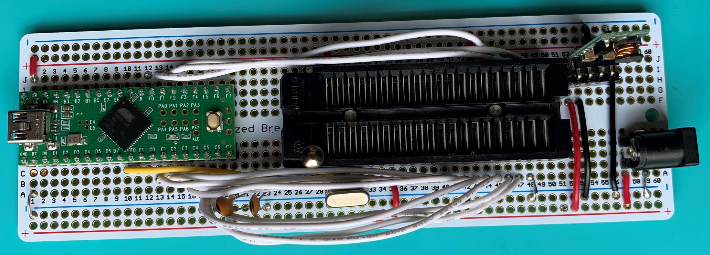

I used a Teensy++ 2.0 because I liked to symmetry of two 40-pin microcontrollers; the regular Teensy 2.0 would be been sufficient. I added the barrel connector as a hedge in case the Aliexpress boost converter wasn't good enough. But it was fine: less than 1mA is needed on the 12V EA signal.

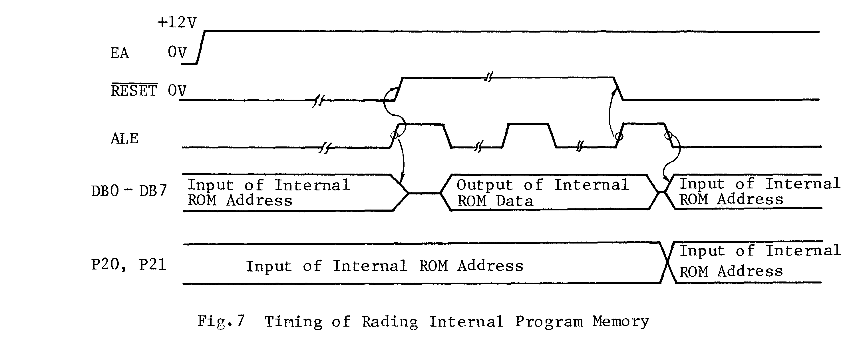

It's all in the data sheet. Start with regular 5V power and a crystal with a couple capacitors. Set RESET low and apply +12V to EA. Put the address to read into DB and a few bits of P2. Then set RESET high, which will latch the address and put its contents into DB.

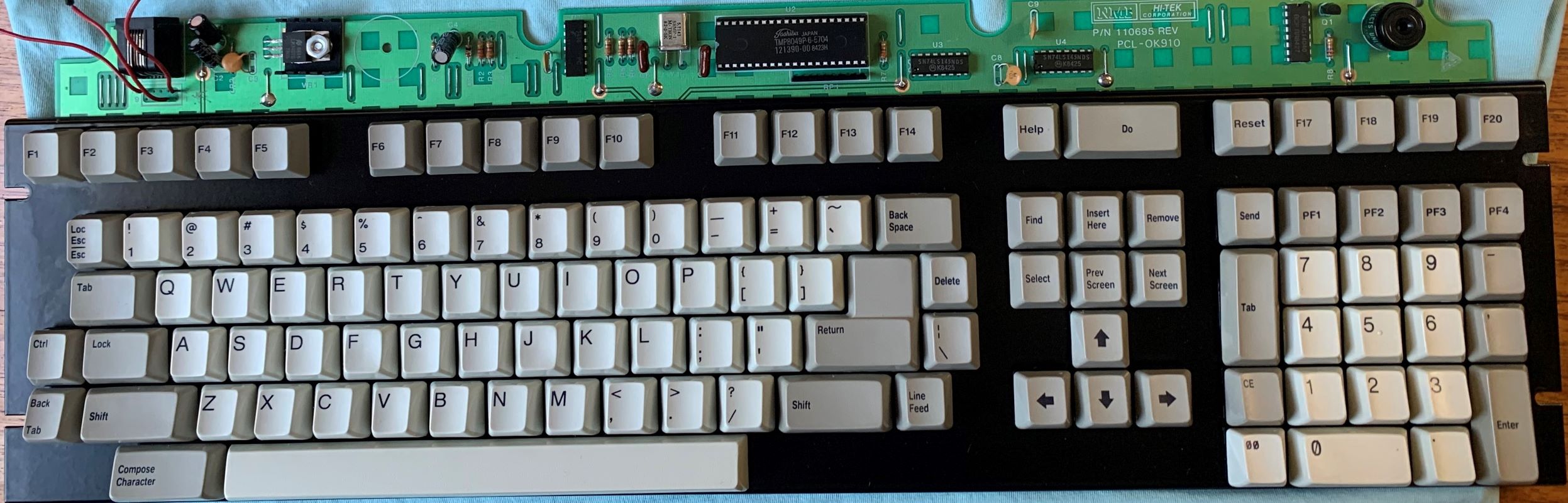

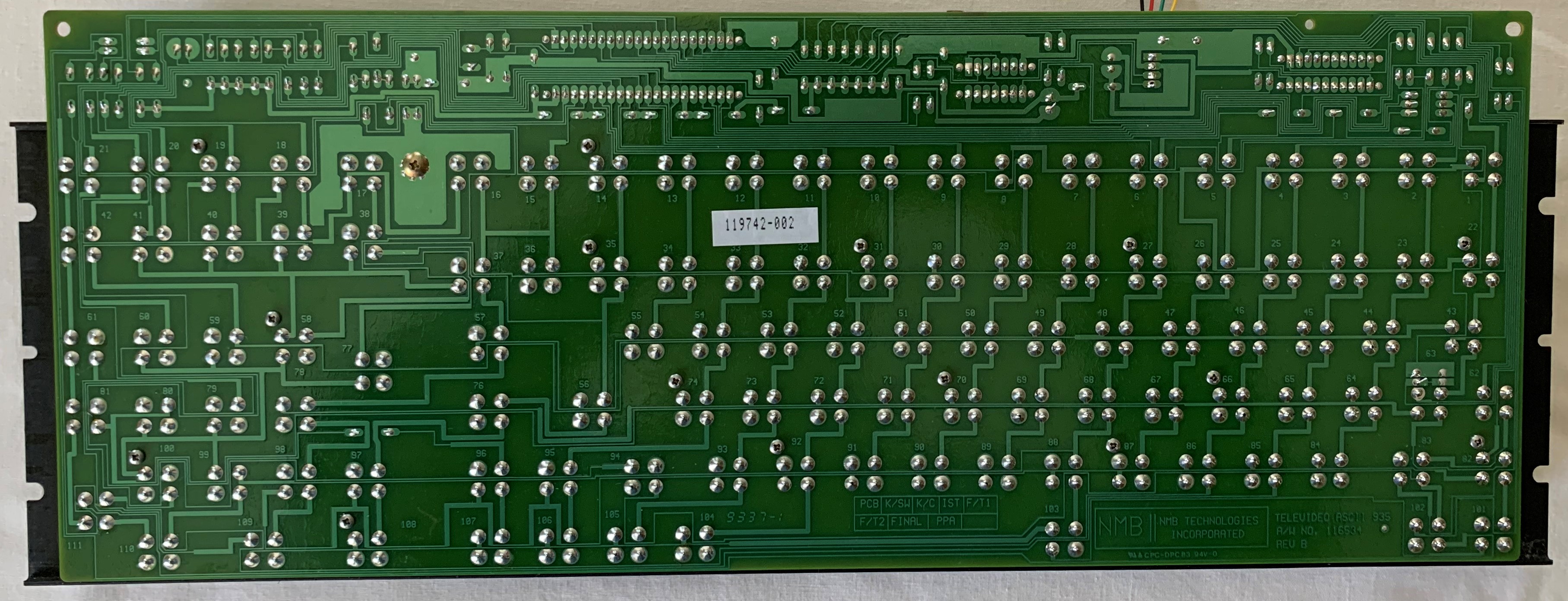

This keyboard looks only superficially similar from the outside.
But inside the PCB is nearly the same and moreover has its TeleVideo part number printed on it.
The layout matches the 905 and 965.
The protocol is the same. The key arrangement has a number of differences, but the same keys have the same codes. Which explains the business with the bracket / brace keys notes above. This earlier keyboard had them that way, matching the keycaps.
It is straightforward to have a single firmware with a synthetic layout that just adds the few keys that aren't common to both.

Since the connector is different, a new converter is needed.
Building this seems to uncover a bug in the raw mapping: both Del and keypad-period send 53.

Al Kossow wrote: 16 Mar 2022, 17:22 ADDS NMB with ANSI layout instead of ASCII, jumperable ADDS or AT
3413-k455-v001 discussed here
viewtopic.php?f=62&t=20868
If it isn't generally known, Cindy is out of the surplus business now...
Also, I'm the person who runs bitsavers. I do a lot of work with the MAME
team to emulate terminals, so I'm very interested in archiving keyboard firmware
and disassemblies, since the emulations include fully emulated keyboards when
the firmware is available.
Ahh, the ADDS 220VT keyboard. I still have this one on hand but I lack the hardware to dump the keyboard ROM. Feel free to reach out if you need additional information.
