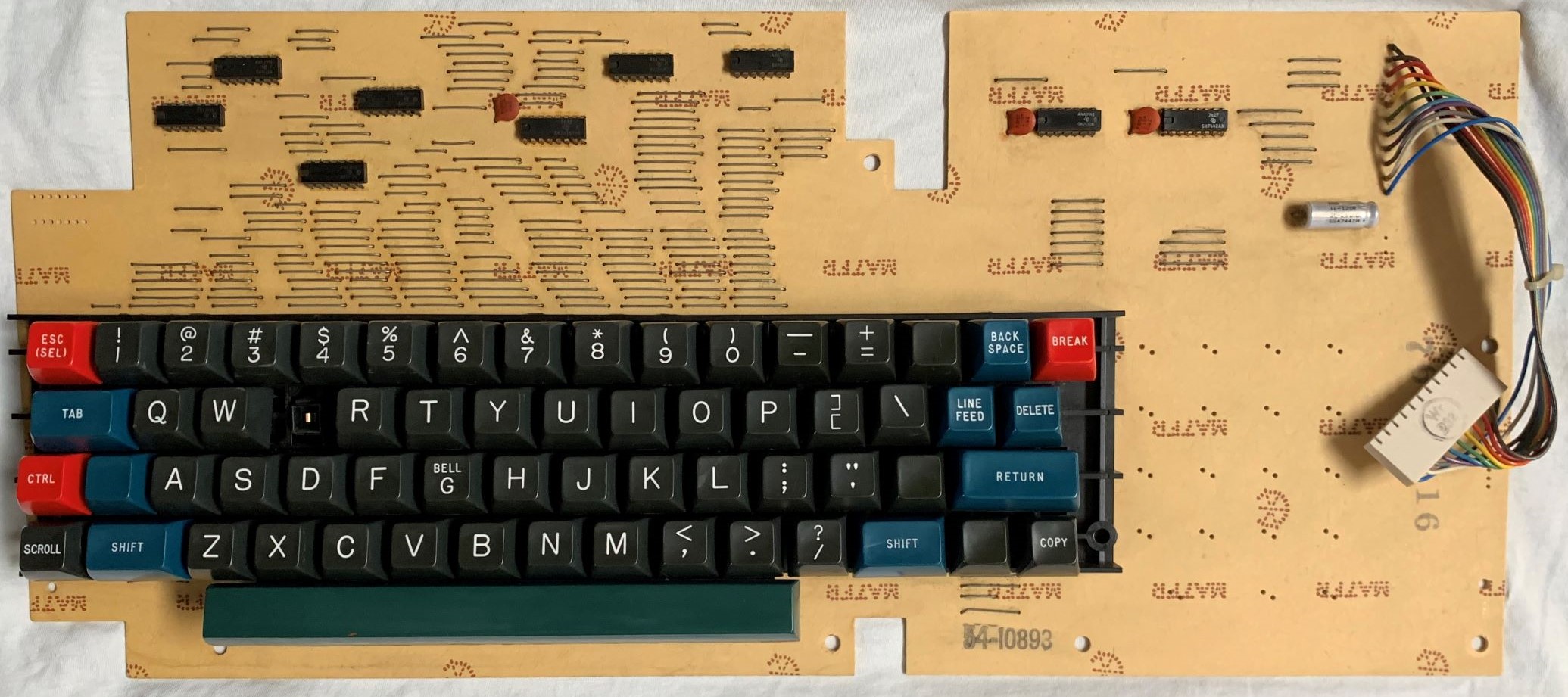

I got this 1976 board even though it has an obvious problem.
Now I'm on the lookout for a Hi-Tek E key or else having to use un corps noir tranchant un flamant as a typing test phrase. Other than that, it cleaned up nicely: only a few scratches and a couple switches with broken corners, as you'd expect.
Of course, the first thing that stands out are the iconic red and blue key caps. On this one, the blues have noticeably yellowed and the space bar is pretty much all the way to teal.

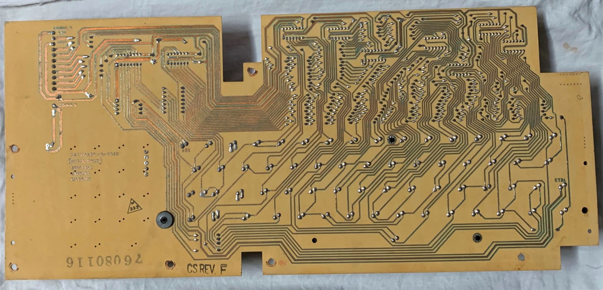

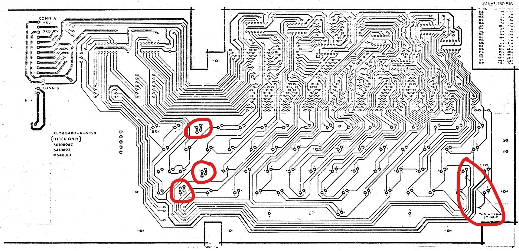

The blank keys don't do anything on this keyboard. The three on the right aren't connected on the PCB. The switches are still there and soldered in, because the whole grid was OEM'ed as a unit. But there aren't any traces from them.

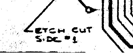

The trace on the locking key just put it in line with the two SHIFT keys, so it was a shift- and not caps-lock. But the copper has been cut. I thought maybe this was peculiar to this example, but nope, that mod is shown in the print set.
This maybe makes more sense when you remember that the VT50 terminal did not have lowercase.
The prints also reveal some renaming. The SCROLL key is called PAGE and the COPY key PRINT. Also, apparently the optional, and now coveted, "gold key" on the VT78 was called the "super key."

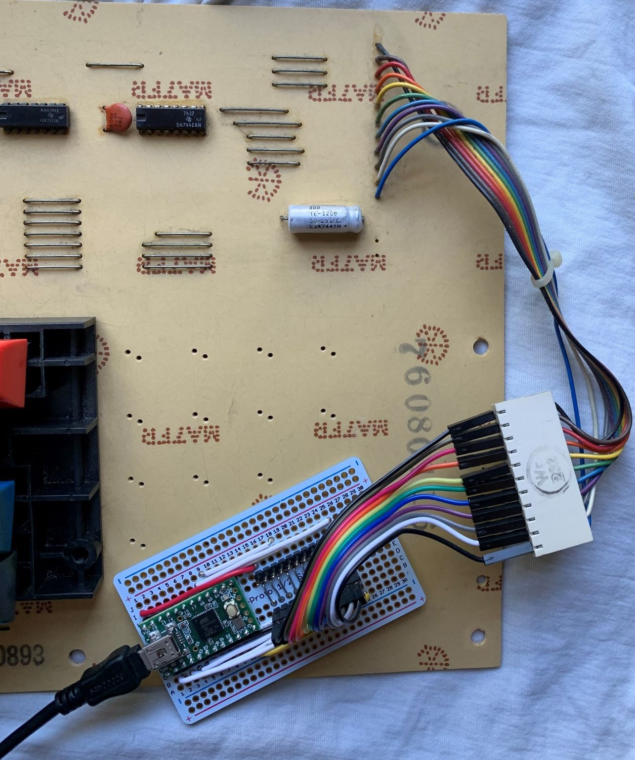

The QMK code should support a VT50H / VT52, though I don't have one to test. Likewise, the converter board, which I gave a separate connector for whether the eleventh signal was a second extra key or a seventh key code bit. Also note how the jumper colors have the same RMA digit order on the old DEC board as some I had from Adafruit.
