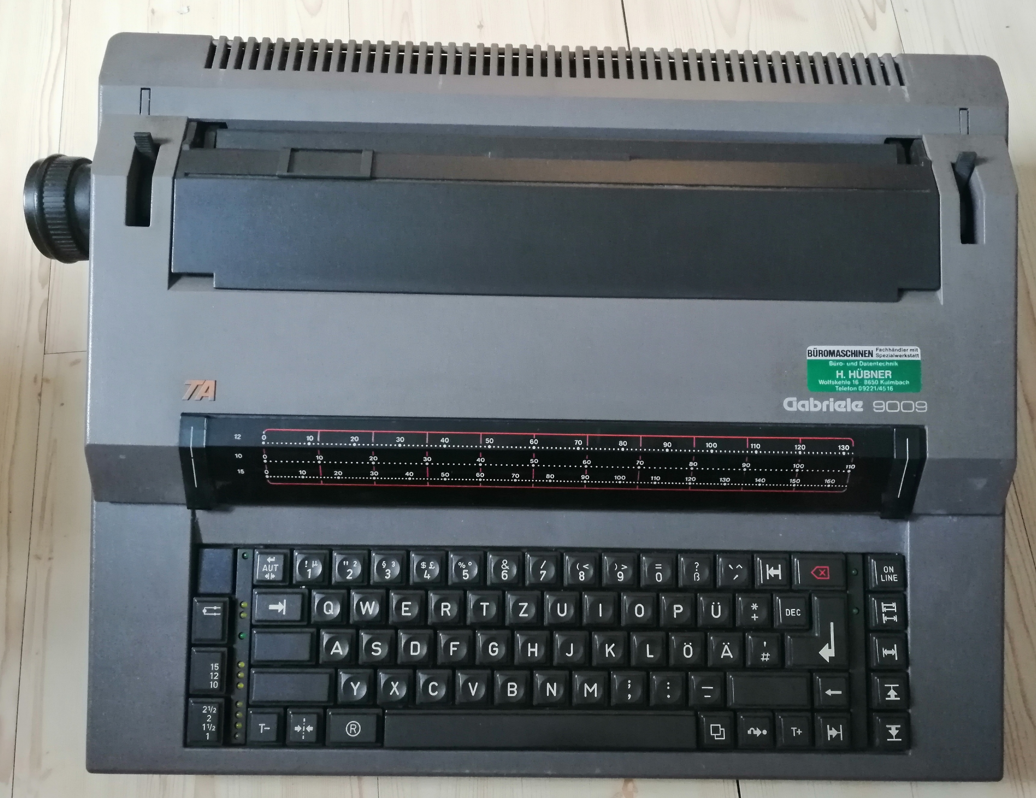

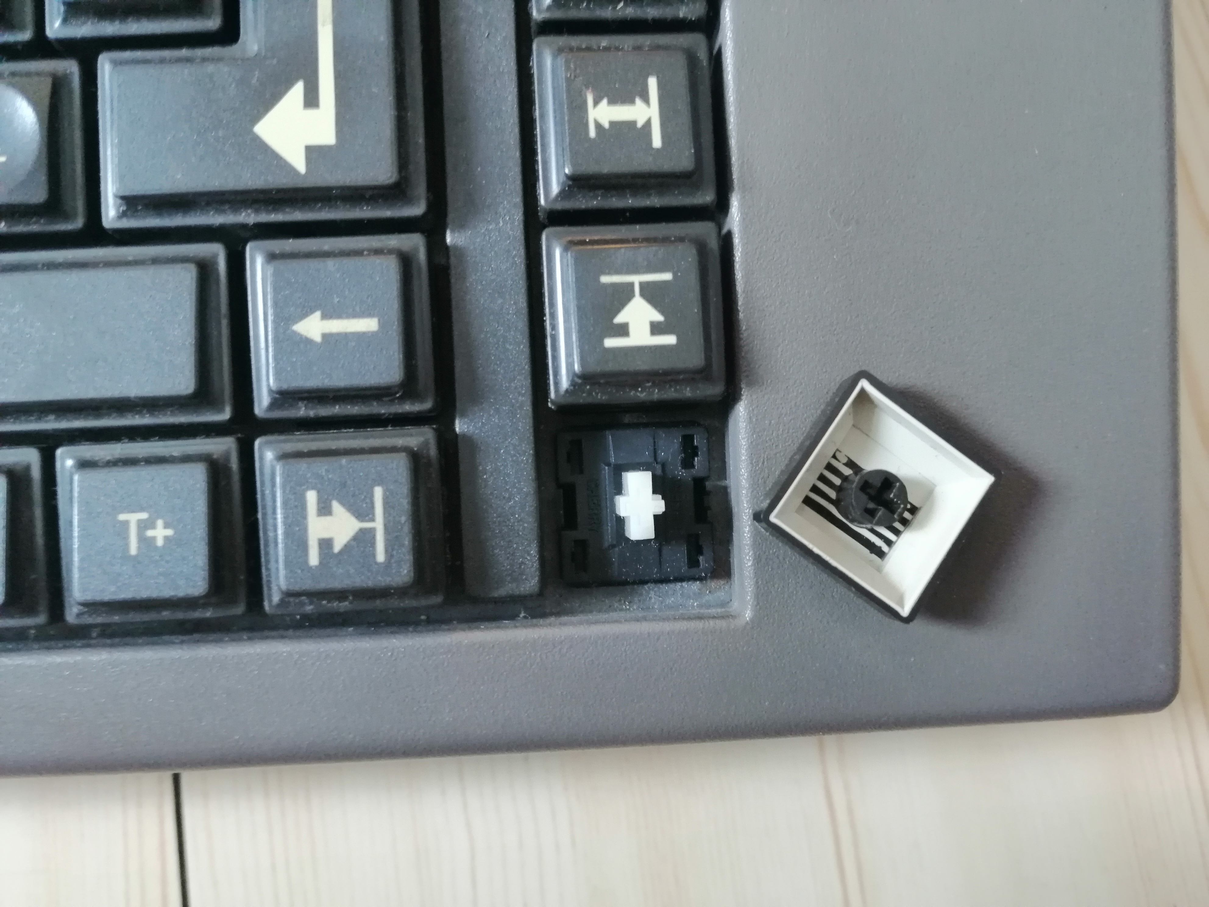

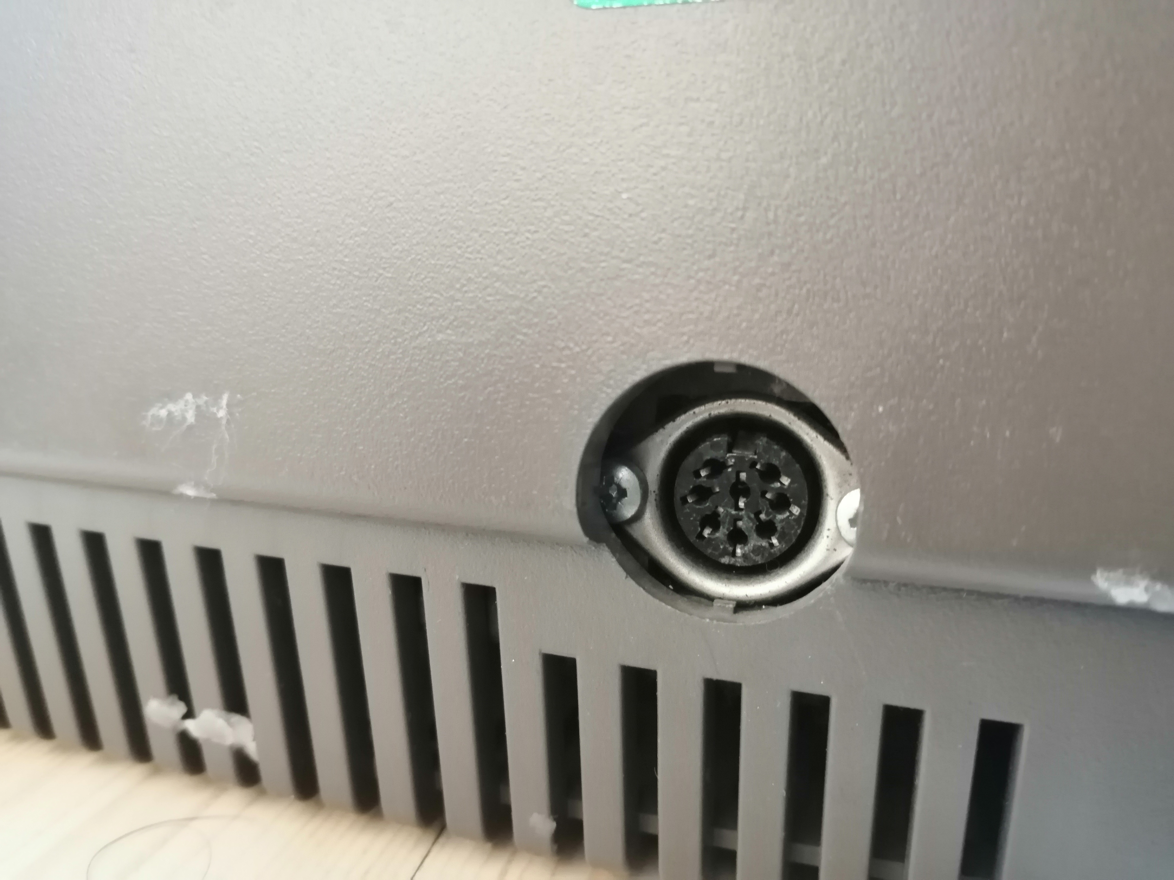

I found this gigantic TA Gabriele 9009 in my dad's old stuff. It appears to use Cherry M9 switches and beautiful MX compatible doubleshots (probably ABS, as the rest of the case is made from it). Because I saw this 8-pin connector at the back, I was wondering if I could actually use it on a modern PC. (Not that I would actually daily drive this monster, as it would take up at least ¼ of my desk)
- the typewriter

- switches & keycaps

- the plug

That connector does not look like a normal XT or AT keyboard connector (180 degree 5-pin DIN) or even the kind used on the IBM terminal keyboards (240 degree 5-pin DIN).
But, as long as it outputs something from that connector as the keys are tapped then it should be possible to build a converter using a microntroller and something like TML or QMK as a base. It could be a lot of work though to identify what the pins do and what protocol it uses.
I don't suppose you have any documentation? What about test equipment? Would you be able to see whether any of the pins are power/ground and any are data, i.e. pulse when keys are pressed. Also some of the pins may be input, i.e. to use the typewriter mechanism as a computer printer.

Well, i am also looking for the name of that connector, all i know's it's mainly used by Fujitsu Keyboard, Mitsumi Keyboard and this one. 8 Pin Din (not the mini kind). Was going to convert mine too.

It would still make an awesome printer. Those can be made to work using I think this driver:mulm wrote: 26 Aug 2020, 13:00 I have now looked deeper into it, and the port sadly does seem to be an input, not an output. Still thanks for the help.
