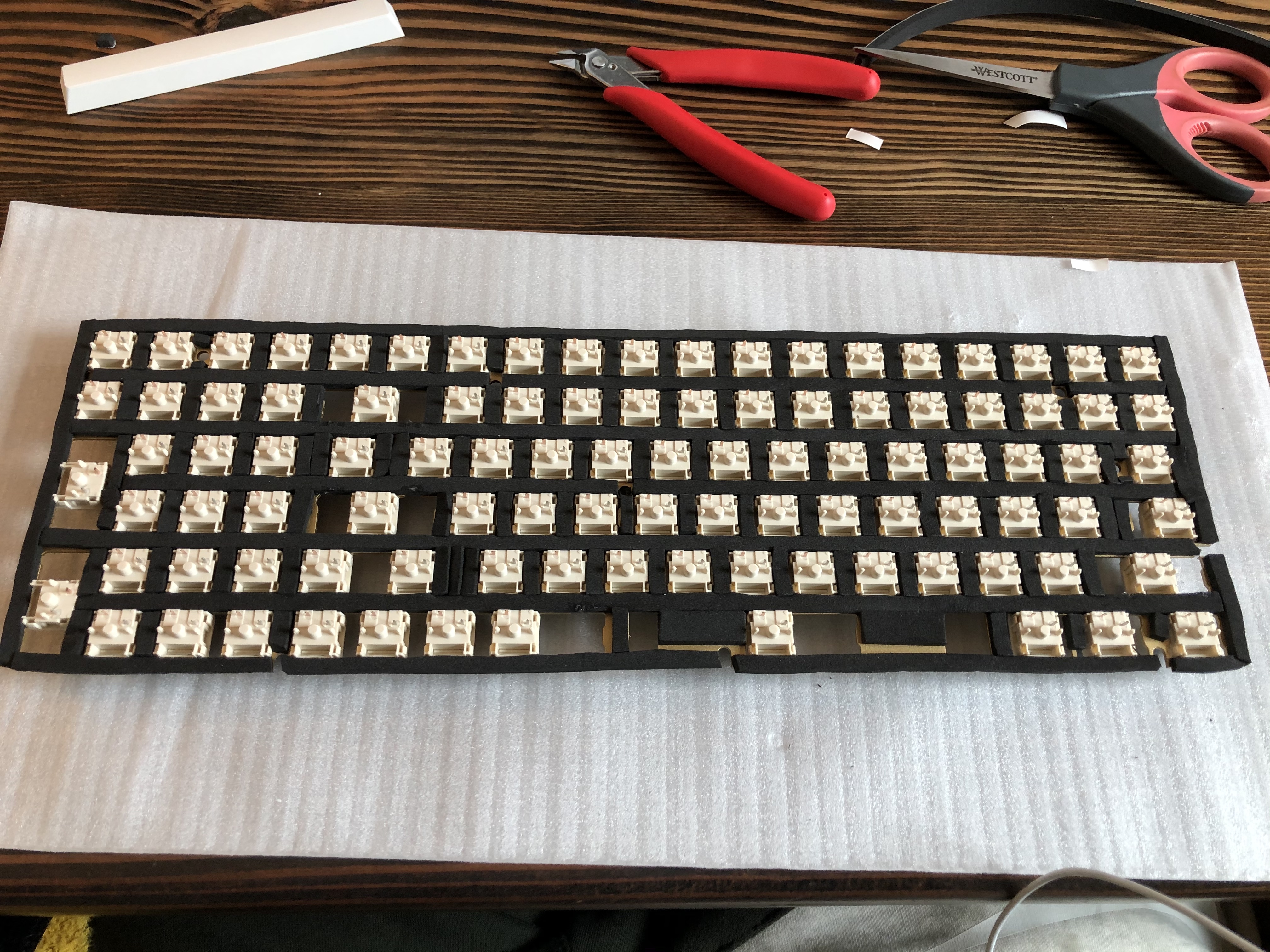

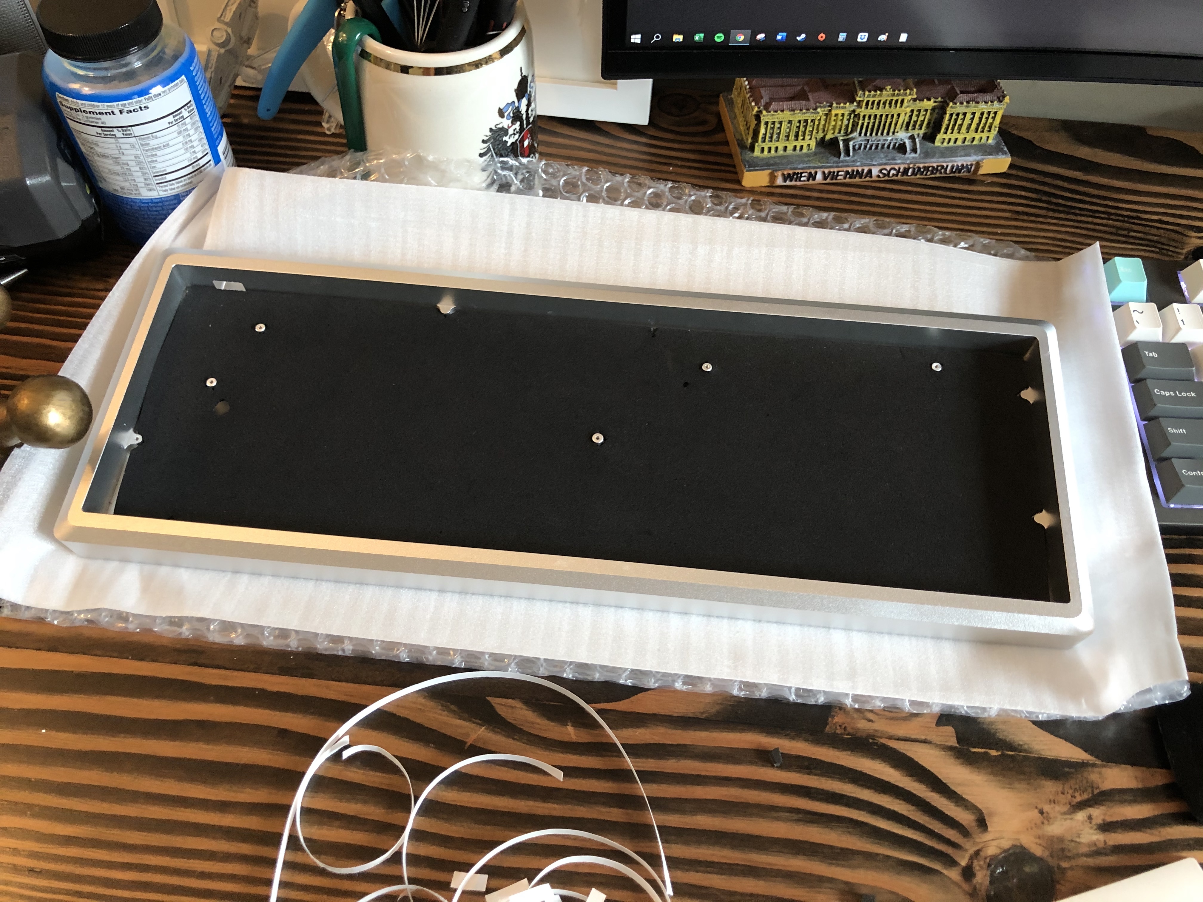

This is what I did on a recent build, found some neoprene stick on strips, cut them to size and filled the space between the plate and PCB.
Then cut a roll to size and stuck it in the bottom.
