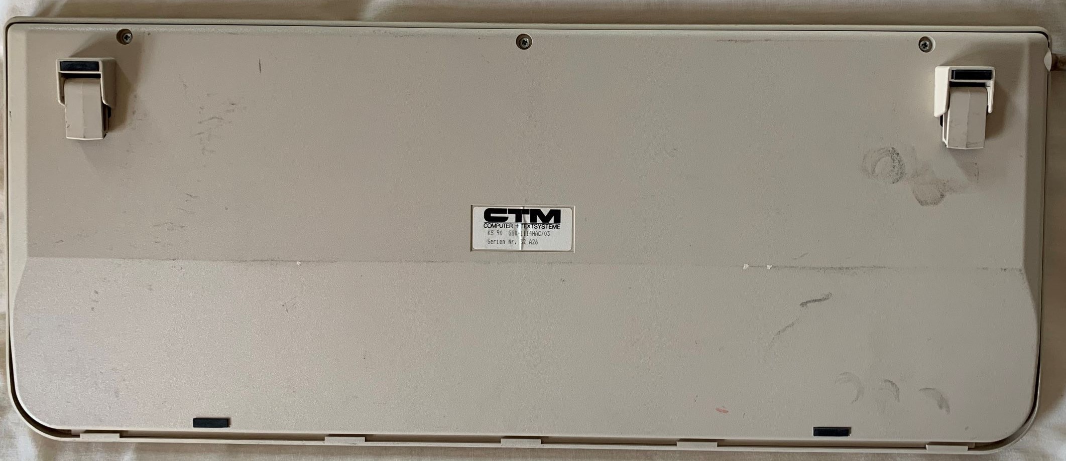

This keyboard is from some CTM system in 1988. Its part number seems to be 680-1114HAC/03.
I am not familiar enough with CTM product lines to say what it was part of and didn't find a comprehensive source online. It says Series #32, A26.

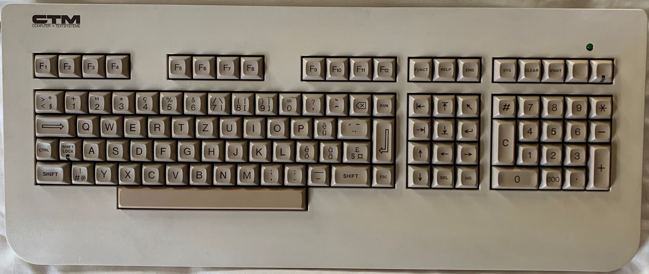

The design is rather striking with large bevels and interesting layout and key legends, particularly the various icons. It is clearly a descendant of the older CTM keyboard discussed here. It is more or less the same keyboard as the one branded ITOS discussed here. That one being the German layout and this one being Swiss, since I got it from tentator's sale.

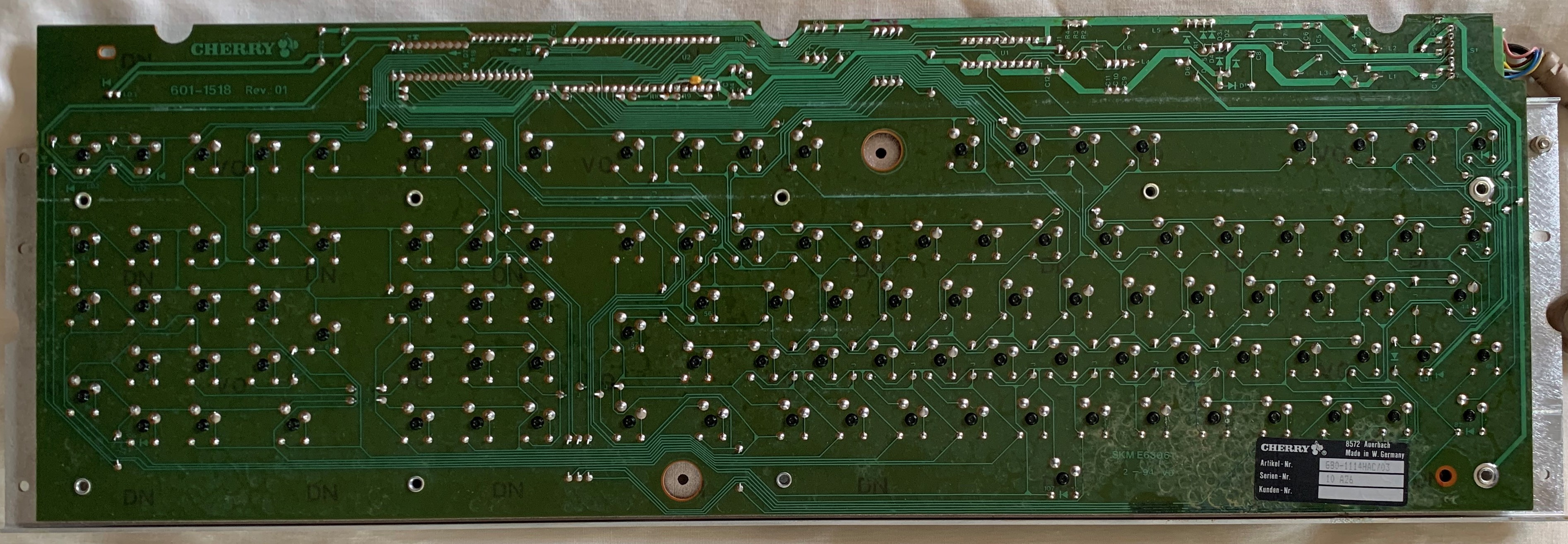

The switches are vintage Cherry MX blacks. In fact, it was manufactured by Cherry. The PCB is 601-1518 Rev. 01, again the same as the ITOS.

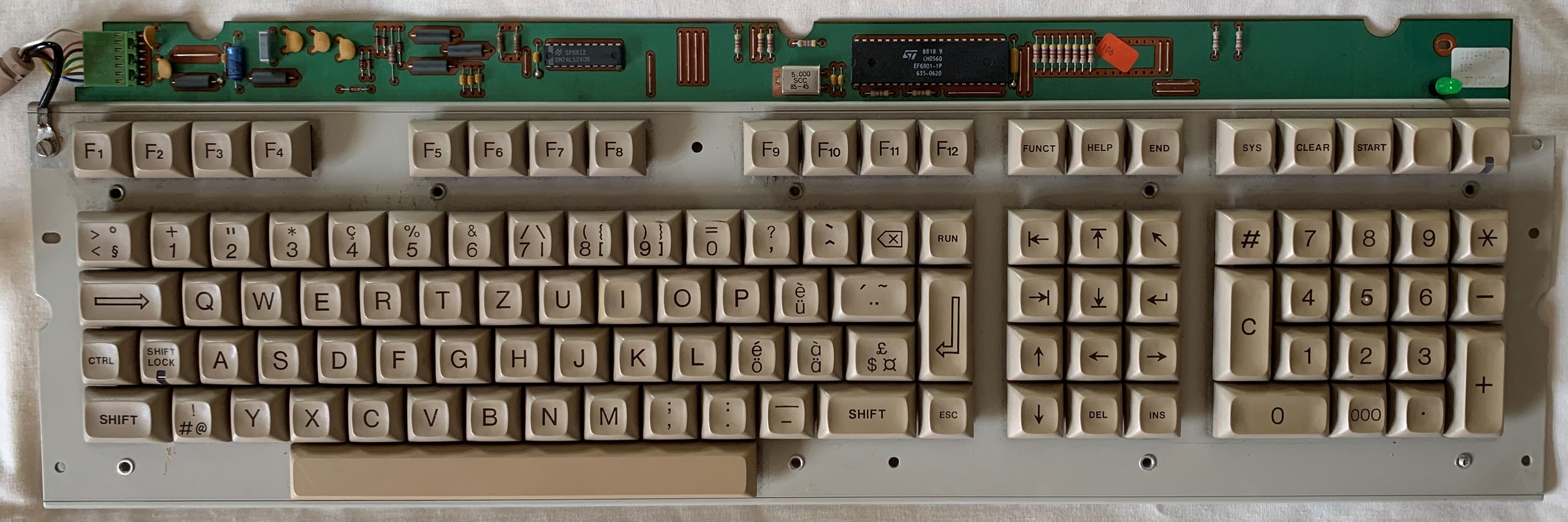

The circuit has two active components, a 74LS240N driver and a 6801 controller. The cable ends in a DE9 male. Tracing the signals shows:

The 6801, one of the first of what we would now call a microcontroller, has, as one of its additional subsystems beyond the 6800 microprocessor, a Serial Communications Interface, that is, a bare-bones UART. And it's probably not a coincidence that appears as Rx on P23 and Tx on P24.

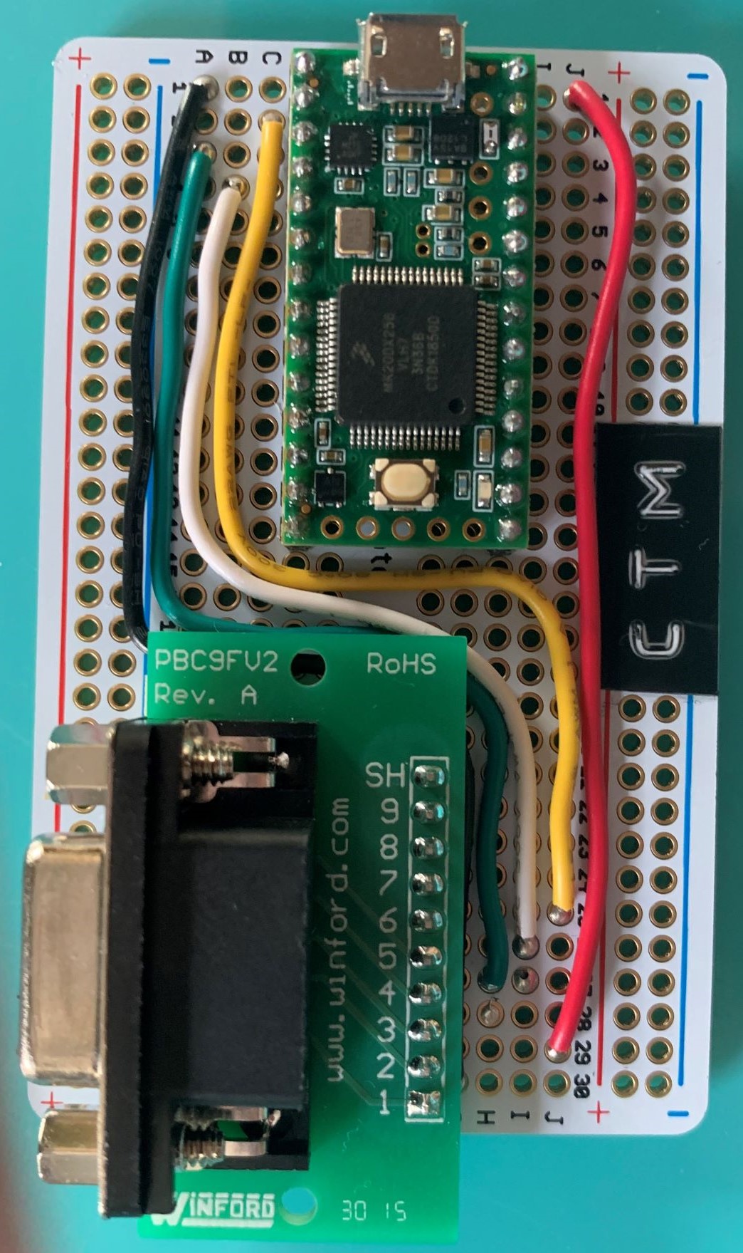

Since it looks like it's going to be 9600 baud with inverted polarity, I got out the last of the Teensy 3.2s. (Fortunately, there are more on order from Adafruit, whose prices are even better than PRJC's own.) And, indeed, just enabling the serial port is enough to make the one byte show up.
But no more, so the controller is expecting some kind of ack. And the second thing to try -- a 1 byte (after first trying a 0 byte) -- seems to work. Now there is a steady stream of scan codes for each key press.

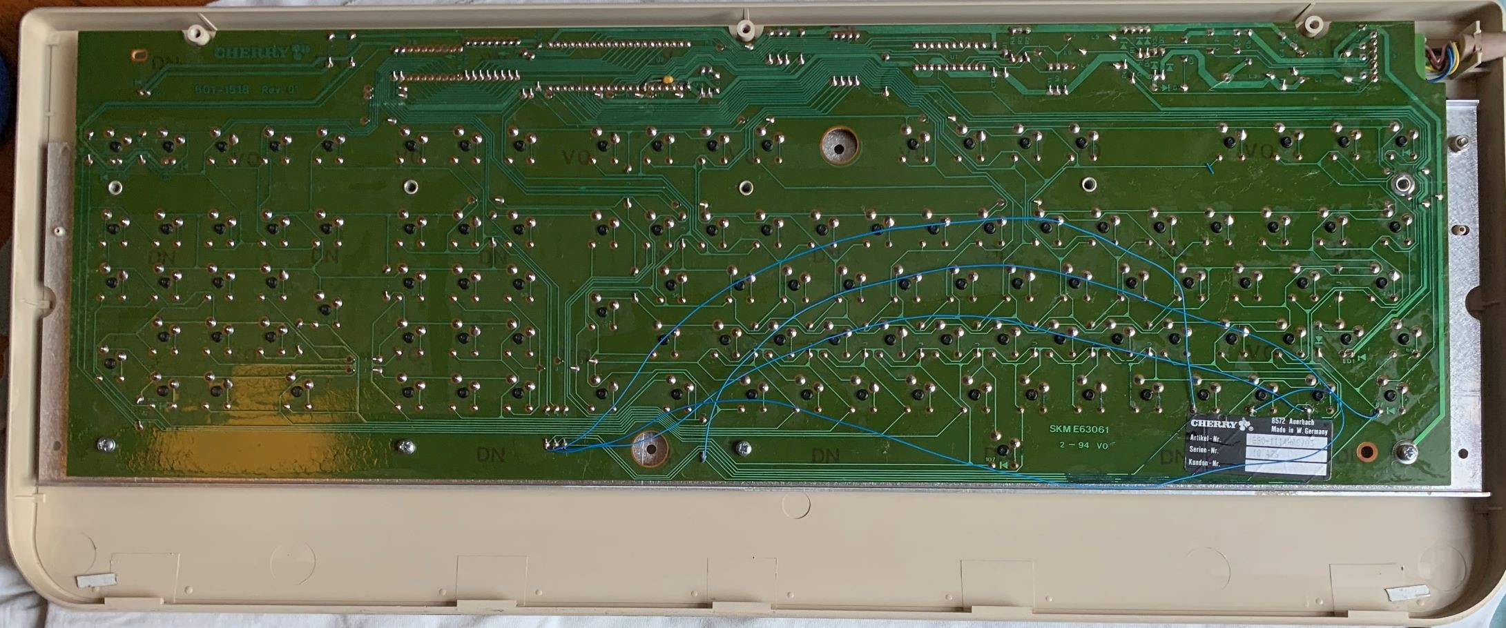

But the PCB has issues. In fact, I wouldn't be surprised if some people reading along here already noticed that in the photo above, in the lower right around the Cherry sticker. It looks like somewhere along the line coffee or maybe cola was spilled into the keyboard and there's a patch where it's corroded through.
The traces are a little thin for a conductive pen, which seem to me not to be a very precise tool. So, instead, I added some old-school patches with 30 AWG wire-wrap wire. The fourth trace up was actually good enough to get continuity, but I did it anyway while I had all the tools out.
And that gets things back working: left and right SHIFT both change the scan code and CTRL sends a prefix byte before the (possibly shifted) scan code.
