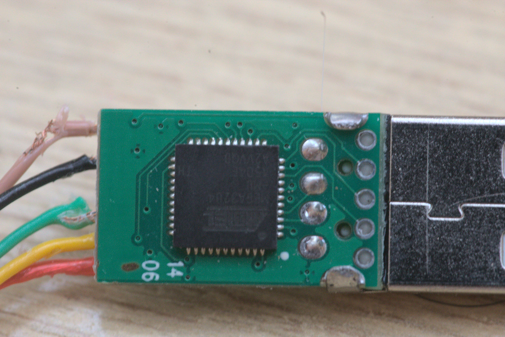

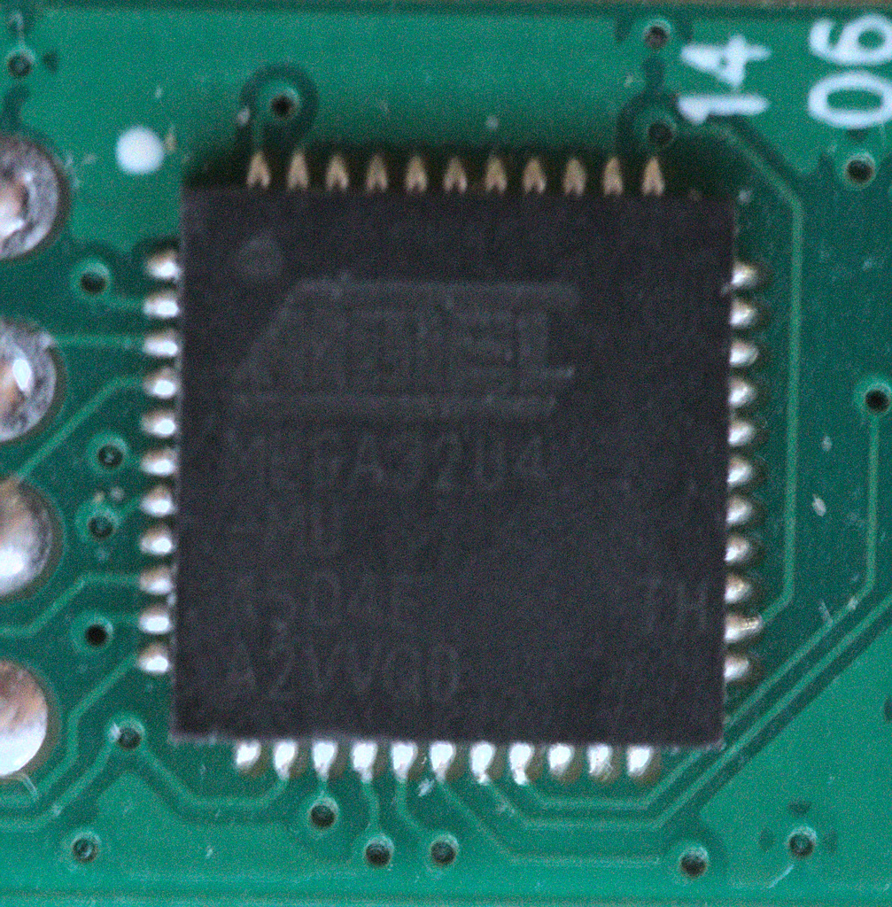

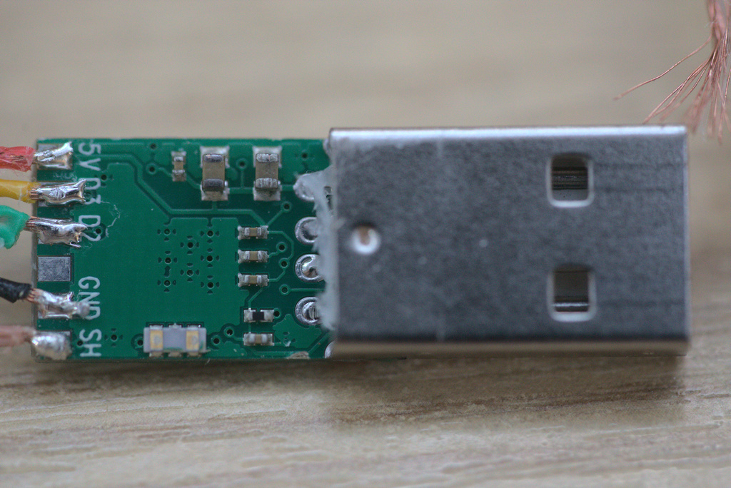

Inxie wrote: 13 Sep 2020, 18:05 Is there even a way to look inside one of these orihalcon's? I assume the converter is on the USB side do the over sized plug. I'm not even sure they implement reset either, which I made sure to make an option on my home grown one should I ever require it.
Yes, the converter is inside the moulding of the USB A plug. Here are some pictures:
ignore the damage to the wires - the encapsulation is not easy to get into.

14 Sep 2020, 21:44
Coeus wrote: 14 Sep 2020, 18:34
Yea, I see no resistors there only capacitors, it has no pull ups. This explains everything. Luckily the eBay one for mine did have the shield connected properly so that wasn't it, and it's the same exact MCU as the Teensy 2.0. So the pullups really were the problem then. There's a lot of ground fill that could be used for a space for pullups so there's no problem with space here.
EDIT: Photoshopped an easy way to add pullups to it.
That's what I'd do at least. It would help reliability for certain.

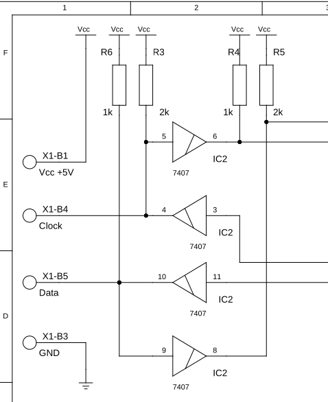

I'd also like to point out that IBM's own 1981 Tech Ref for the 5150 shows pullups used on clock and data as well. It isn't a case of if you should or shouldn't use it, it's that you really should, even IBM used it on the PC.

Inxie wrote: 14 Sep 2020, 21:44 I'd also like to point out that IBM's own 1981 Tech Ref for the 5150 shows pullups used on clock and data as well. It isn't a case of if you should or shouldn't use it, it's that you really should, even IBM used it on the PC.
As each of these lines can be pulled low from either end, i.e. from both keyboard end and host end the outputs must be open collector so some form of pull-up is needed for reliable operation. However I am sure I read that the MCU has internal pull-ups on those lines which is why, in many configurations, no other pull-ups are required for reliable operation.
However, if the cable has a high capacitance the rise time for any given value of pull-up will be slowed compared to a cable with less capacitance. As capacitance increases there will come a point where the high value is not safety above the threshold at the moment it is sampled. When it's right on the threshold, extra noise could cause it to be read as either 0 or 1 seemingly at random.
So with a cable with extra capacitance it is worth adding a 2nd pull-up in parallel with the internal one. With lower overall resistance the rise time will be faster.
That does not explain why my model F works on the teensy with no external pull-ups and not on the orihalcon.

I just noticed that the schematic that was posted of the IBM keyboard interface uses 4.7k ohm pull up resistors. That might be a good value to try too.

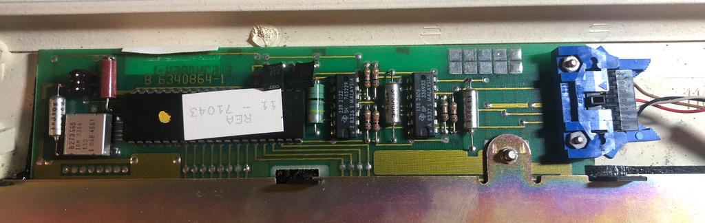

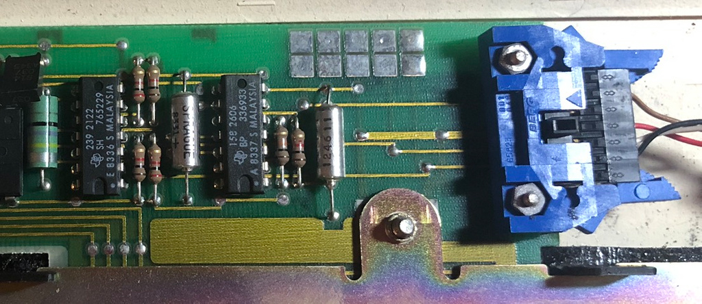

orihalcon wrote: 15 Sep 2020, 17:01 Is it only for the AT/XT that the phantom keypresses have been observed? From the description above, the XT being the oldest I assume would have the most potential variance from board to board perhaps?
Unfortunately I only have 2 other PS/2 boards but no AT adapter to plug it in. And my AT keyboard was lost in my move, so I can really only test this Model F XT (which is a Type 2, but has a Type 1 cable on it for some reason. I had even replaced the DIN connector on the keyboard thinking that was the issue).
Inxie
15 Sep 2020, 20:43
Oh shoot you wanted a picture of the MCU as well in the keyboard. I don't feel like taking it apart, but the eBay auction I bought it from took a pic of the inside.
Coeus
15 Sep 2020, 20:48
Here are some pics:
the second one is just a crop of the first by focuses in on what I think may be the circuit driving the cable. It's hard to tell because am unable to decode the chip numbers.
Coeus
15 Sep 2020, 20:53
Inxie
15 Sep 2020, 20:55
Interesting, you have an 8049, mine has an 8749. Generally the same but mine is technically erasable and reprogrammable. Maybe they are slightly different in their high/low thresholds?
Coeus
15 Sep 2020, 21:07
Inxie wrote: 15 Sep 2020, 20:55 Interesting, you have an 8049, mine has an 8749. Generally the same but mine is technically erasable and reprogrammable. Maybe they are slightly different in their high/low thresholds?
I assume you're basing that on the fact that mine is in a plastic package because I can't read a part number on it. Now here's the interesting part of the schematic:
So here we can see pull ups within the keyboard. Also interesting is that the pull-up on the clock is weaker (higher resistance) than that on the data line.
Inxie
15 Sep 2020, 21:11
Coeus wrote: 15 Sep 2020, 21:07
Correct, the 8049 is plastic, the 8749, identical, runs the same code, is ceramic with a UV window on it (like mine). I wonder if there's some sensitivity differences as well (I don't see why that would be but hey, I've seen weirder).
Yea, I'm seeing it has pullups in the keyboard itself, and the 5150 also had pullups on the mainboard as well.
Inxie
15 Sep 2020, 21:13
Pull up is different on clock in the keyboard because if you look closely, clock is going to INT and DB5, while data only goes to DB6.
Coeus
15 Sep 2020, 21:38
Inxie wrote: 15 Sep 2020, 21:13 Pull up is different on clock in the keyboard because if you look closely, clock is going to INT and DB5, while data only goes to DB6.
It looks like DB5 and DB6 are being used as outputs here. The open collector buffers in IC2 are drawn so the signal goes through them as if they are an arrow, i.e. the same way the symbol for an amplifier is drawn. So DB5 does not represent a load on the clock line.
The resistors I was talking about were R3 and R6. When sending, keyboard to host, the rising edge of the clock follows very soon after the data line is asserted. There is almost no scope for the data line to be delayed relative to the clock and the unequal value of those two resistors seem me to be doing the opposite, i.e. delaying the clock relative to the data.
