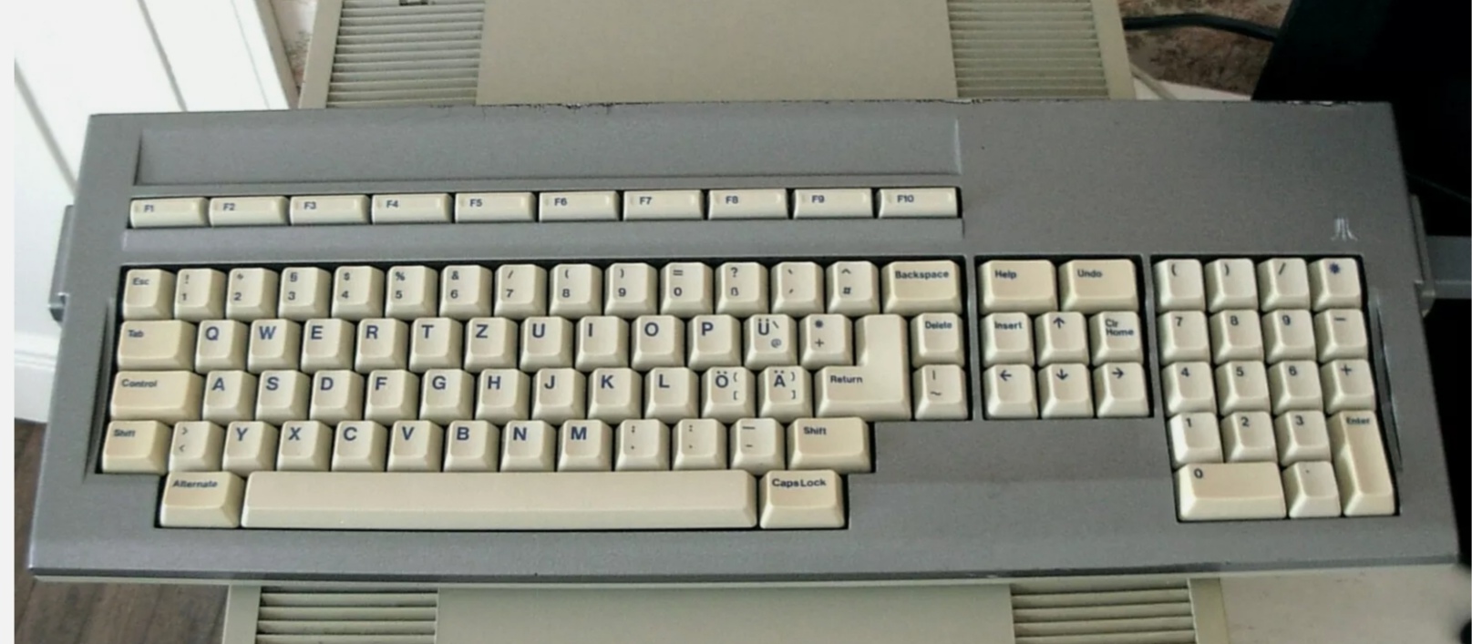

- Screenshot_20200921_154541.jpg (264.43 KiB) Viewed 1921 times

Cool! Be careful to do precise measurements. I once considered designing a keyboard with support for the Atari ST's layout, but did some measurements and noticed that the spaces between key groups were not simple fraction of a key size (1/2, 1/4, etc).
I think most of the cheaper manufacturers may print anything, but will only provide shapes for the US-ANSI Windows keyboard layout, perhaps with some variations.
If the 2.75u right Shift is supported, you could possibly adapt such a kit to the XE, ... if you would move the Return key down, and the * down to the bottom or something.
One option I had considered was to support a split of the 9-unit space bar also into 2.75 + 6.25, making the left side into an additional Backspace key. (or configurable with jumpers)

Are you sure about 2.5u shift key? I think in ATARI XL Keyboard: the LEFT SHIFT is 2.25u and RIGHT SHIFT is 2.0, as well as the CONTROL is 2.0U , ESC 1.25U, RETURN 1.75U and CAPS LOWR 1.25U. Lateral metallic function keys are sized as 1U
In the ATARI 800 ESC is 1U, RETURN is 1.5U CONTROL is 1.5U, LSHIFT is 1.75U as well as the RSHIFT. The lateral function keys are 1.50U or 1.25U (I do not know)...
Can you confirm that?
