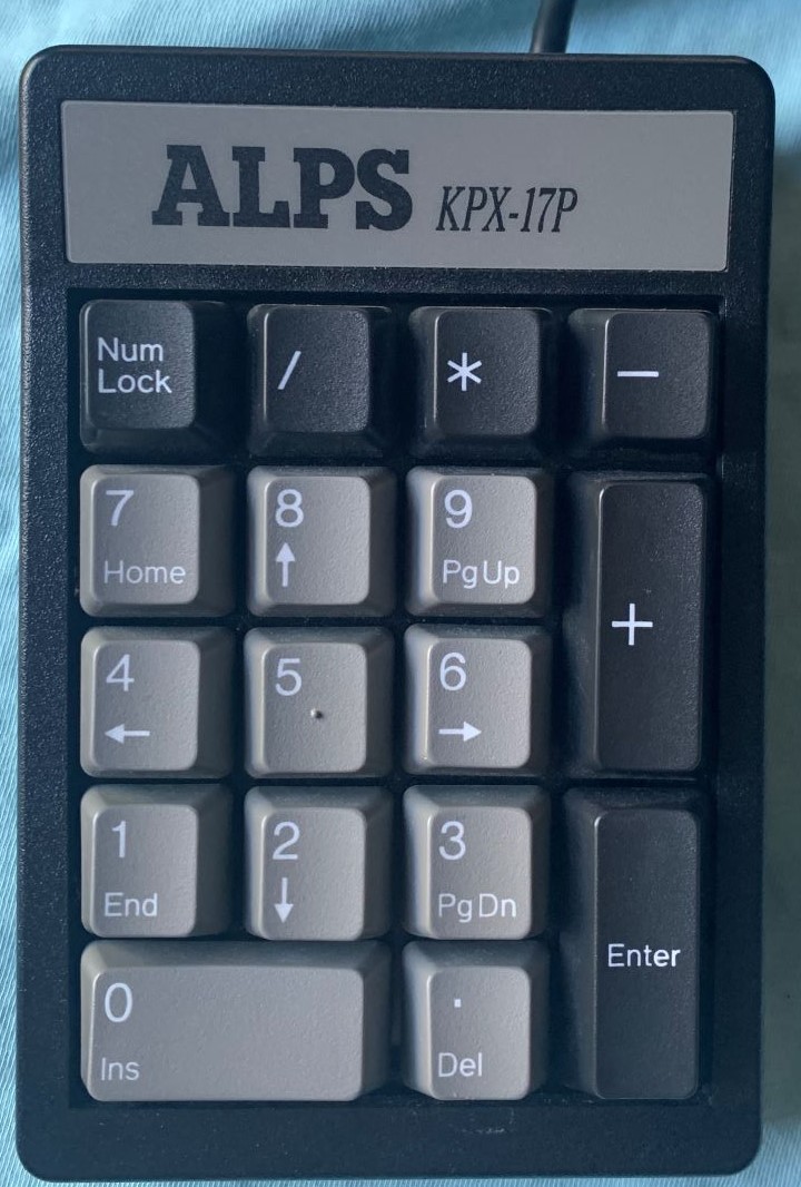

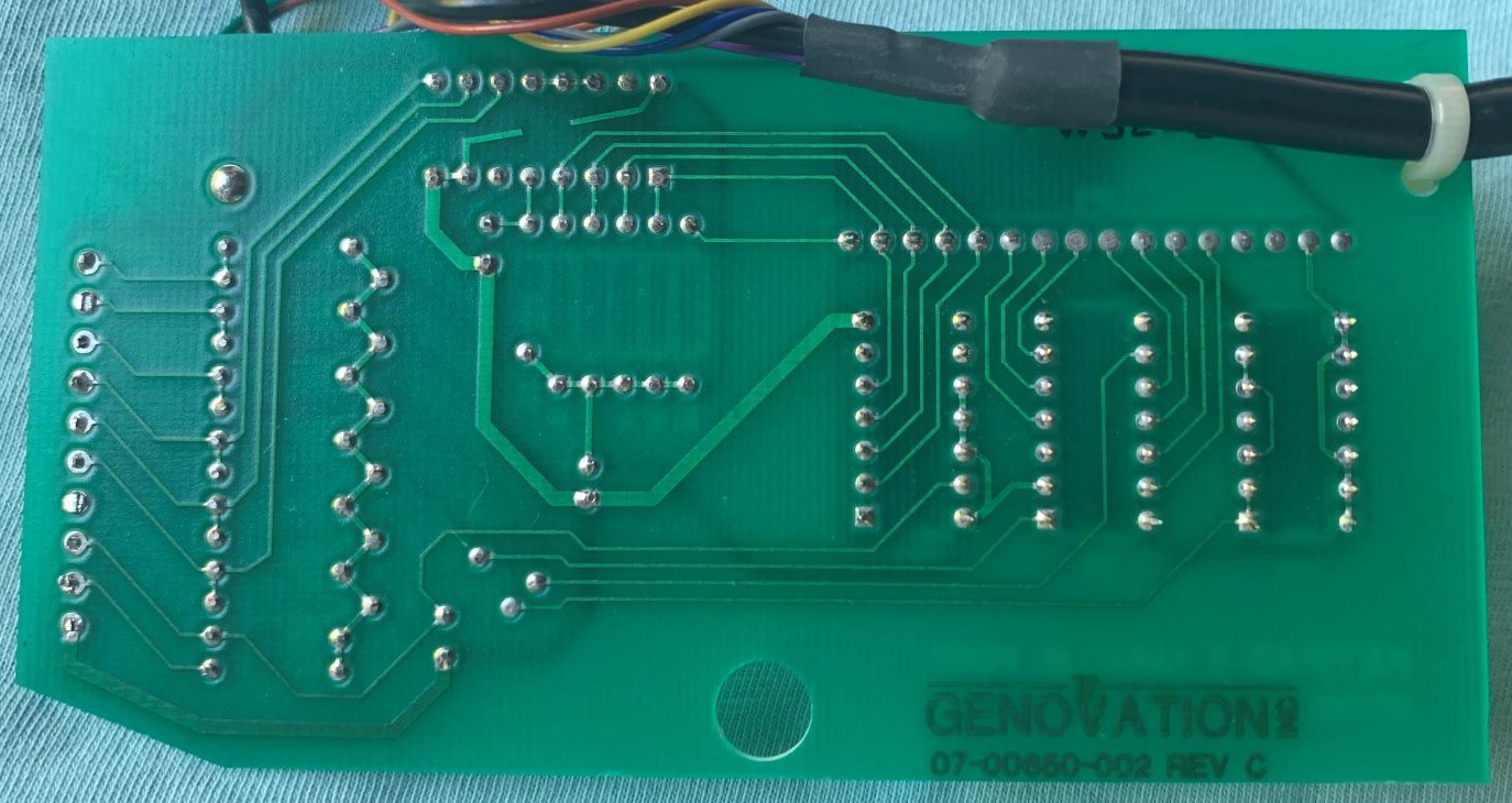

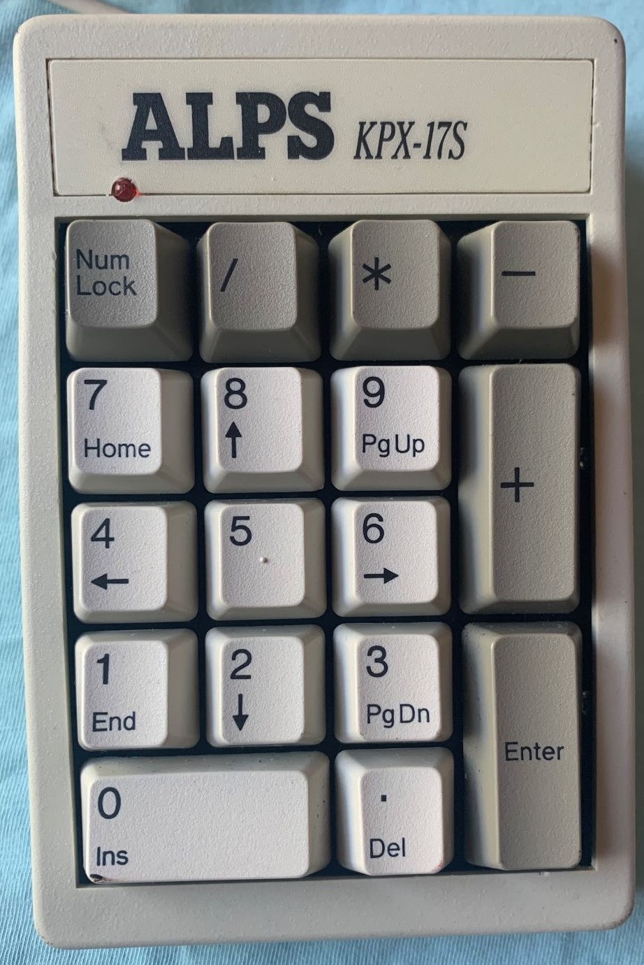

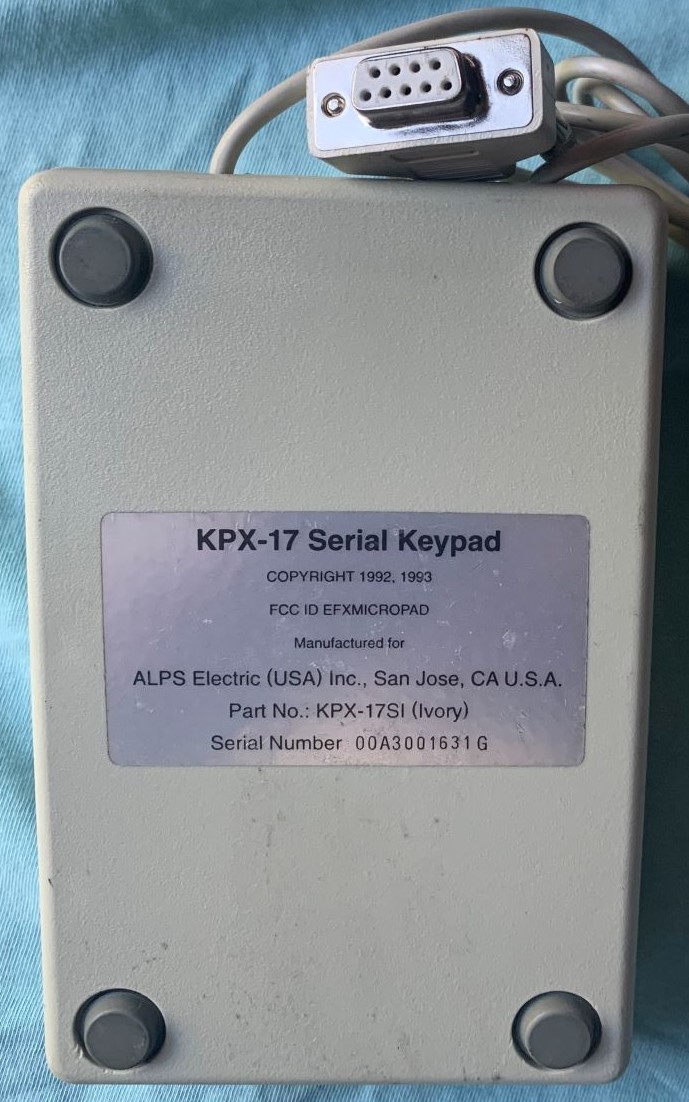

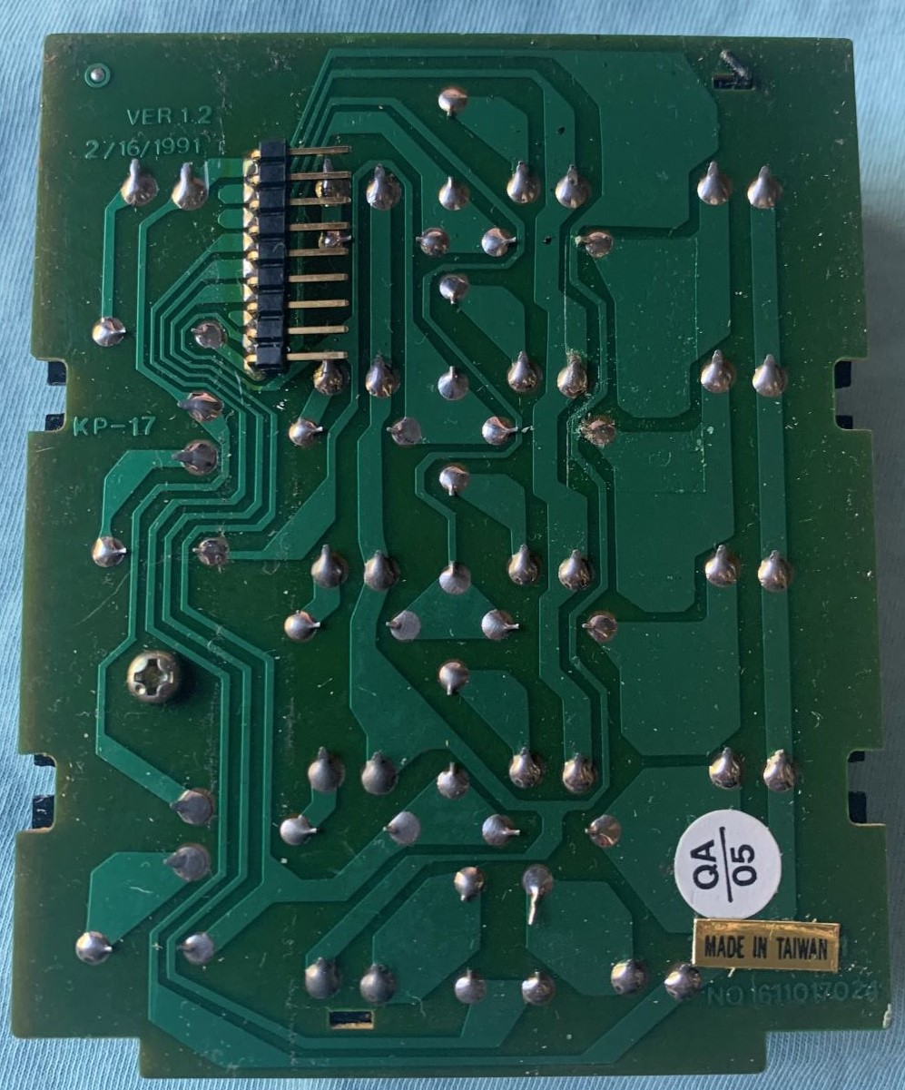

Here are two variations of the Alps / Genovation KPX-17, one serial and one parallel. Each variant came in two colors, black and ivory, making for a total of four products.
The switches are complicated cream Alps. The matrix is a separate module, KP-17, manufactured by Alps. With its convenient connector, it's easy enough to interface directly to the switch module. I used a Pololu AStar Micro, since it has ten data pins on one side, making it easy to solder on a compatible header. The combination would fit back into the original case, if one wanted.
Other than using RS-232 levels instead of TTL, the serial version is like many other keyboards of the time. Each key sends a unique 7-bit code which also changes depending on the state of the Num Lock LED. Num Lock both toggles this LED and sends a code. There does not appear to be any way to change the LED state using the serial line. Which means that it might be more convenient to assign Num Lock to a layer of its own if the main keyboard also has a Num Lock key + LED. There are no break codes.
A converter needs a level converter like the MAX232 or MAX3232. These are available as breakout boards with a D-sub connector, which works nicely with a smaller ATMEGA32U4 like the Piksey Atto. The parallel version is much more interesting. The controller board is made by Genovation. The whole external keypad was also sold with Genovation branding as the Micropad 621.

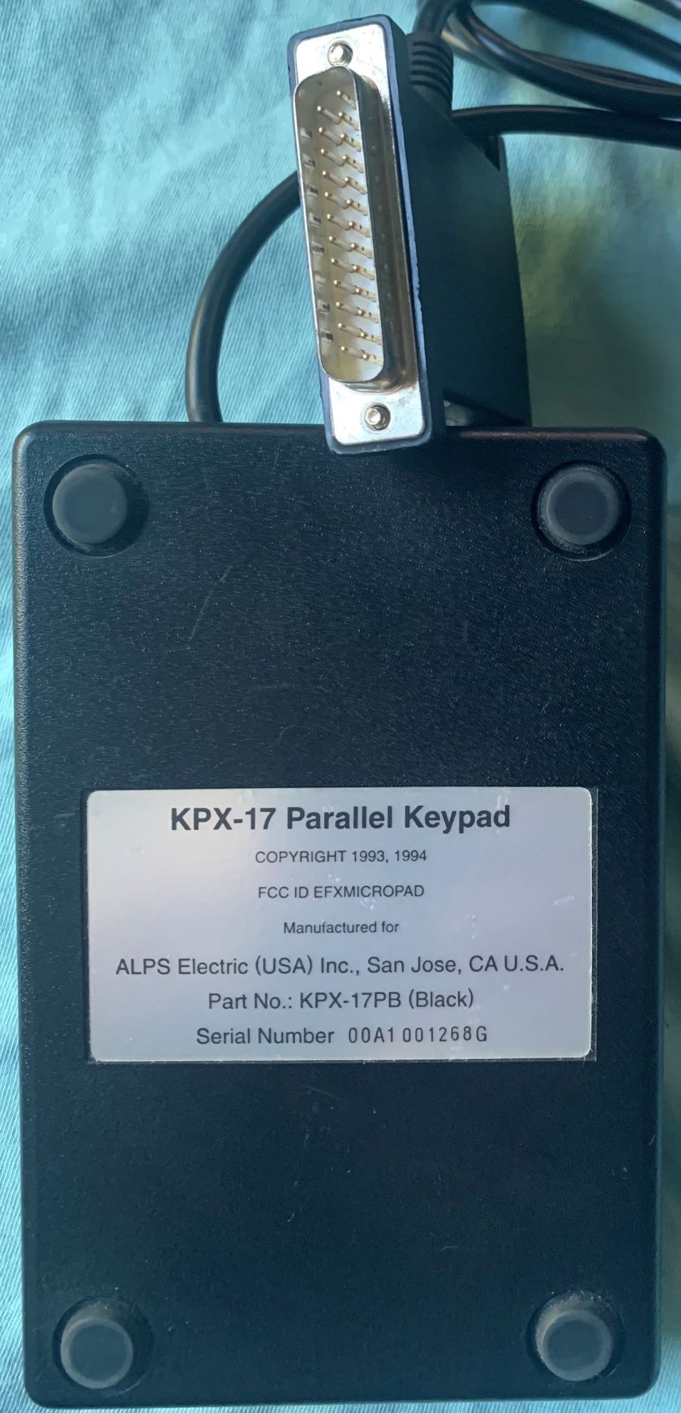

A DB-25 has eight more conductors than the keypad has keys. Even if you allow that eight of those are all ground, that's still one more. So if it weren't for the parallel port interface, they could be separate switch signals.

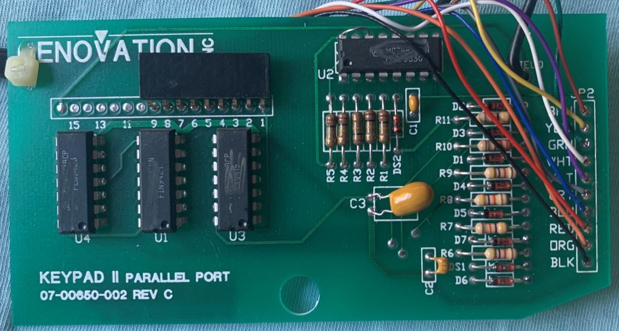

The board was evidently designed to work with an original output-only parallel port. Which makes sense from the date and that it was not associated with any specific laptop model.
The first issue is power. A parallel port does not have any supply voltages, expecting that both the computer and the printer are powered. Oddly enough, this is very much the same problem as the "one-wire" Mitsumi keypads had. The solution here is to connect each of the data lines to a diode and current-limiting resistor and connect all of those to a common Vcc for the circuit. Provided that a majority of the data lines are kept high all the time, the small bit of logic is powered. That will inform the protocol.
Someone had the job during manufacture of using a rotary tool to deface the tops of the active chips, which are presumably 74-series TTL. This makes it hard to say exactly what the part numbers are, but not what they do. They clearly include a de-mux and a counter. Two of the counter signals go to parallel data pins. Several others go to the de-mux. Which suggests that one strobes a data line to advance a row or column number. Likewise several other data pins go to the matrix, making them the column or row. (Turns out, by experimentation, that they are column and row, respectively.)
Only two parallel status lines are connected back to the parallel port, SELECT and ERROR. So one of those, or both, is how you tell when the key at the current position is pressed. (Turns out it's ERROR. SELECT seems to signal that any key was pressed, but that's not important if there is a scanning loop.)

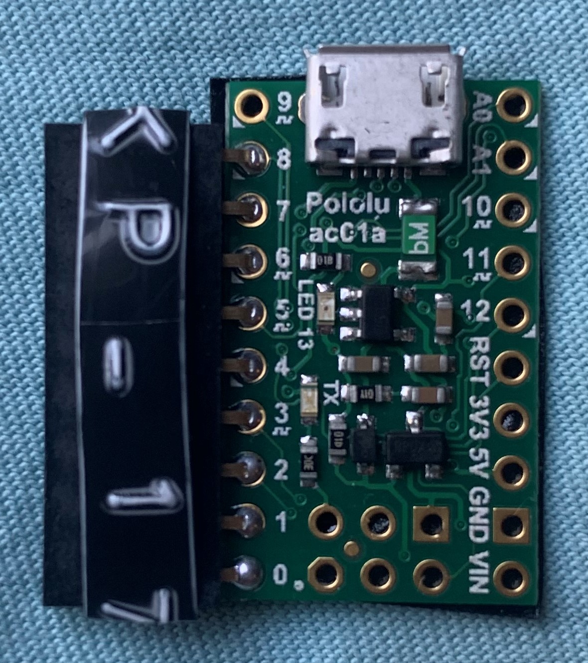

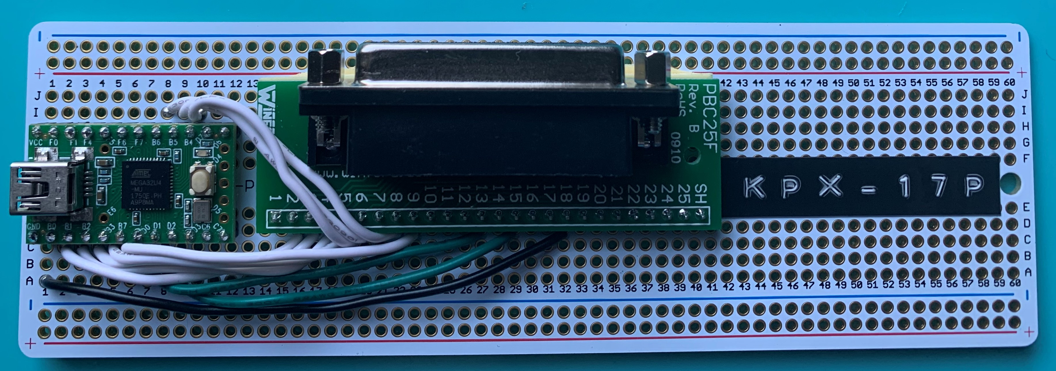

The converter just needs a Teensy and a DB-25, with an output data port PORTB and the two input pins. Keeping those separate from RX means that a single board with enough connectors could do both KPX-17S and KPX-17P. The predefined QMK firmware variants build them separately, though.

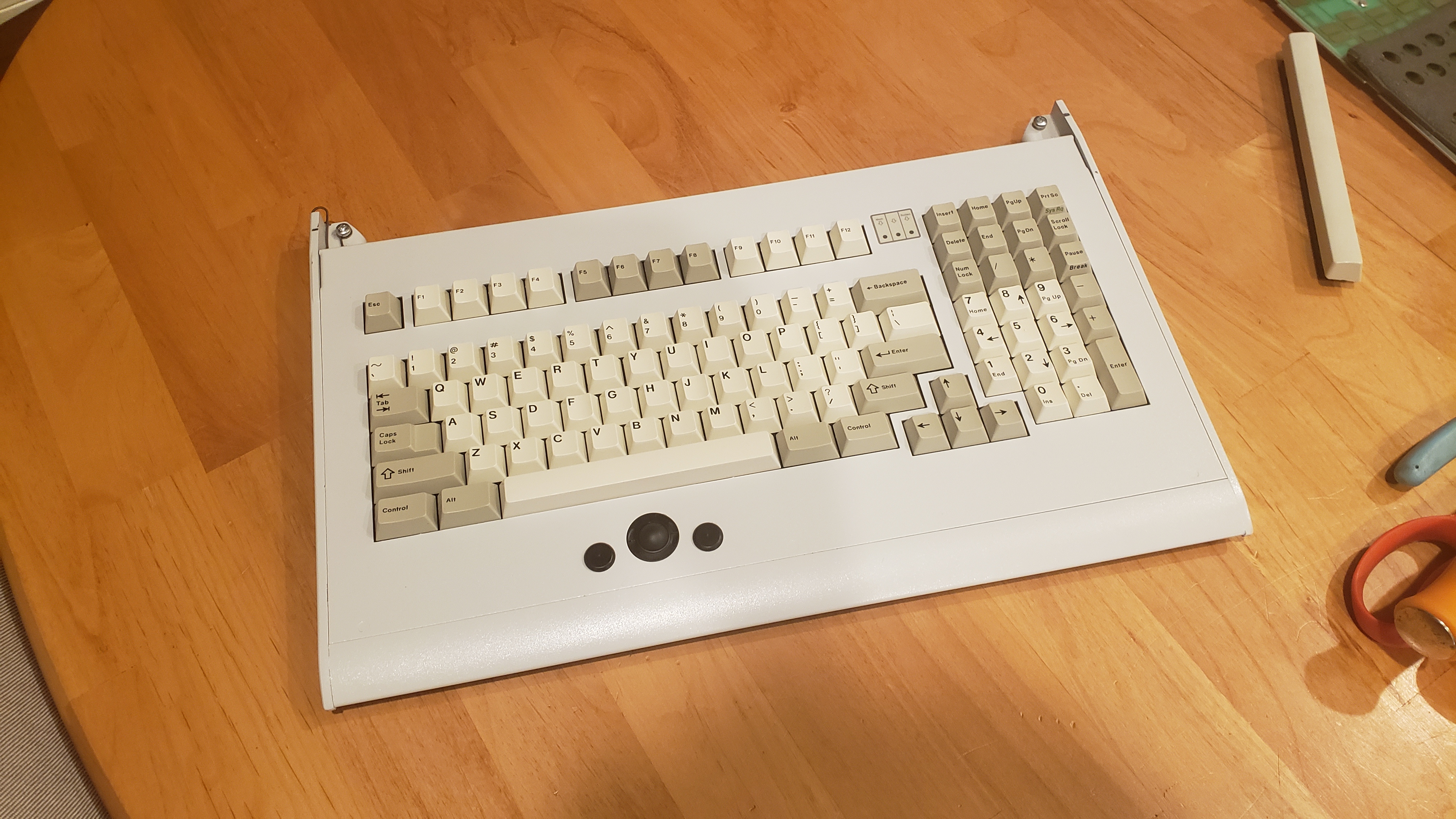

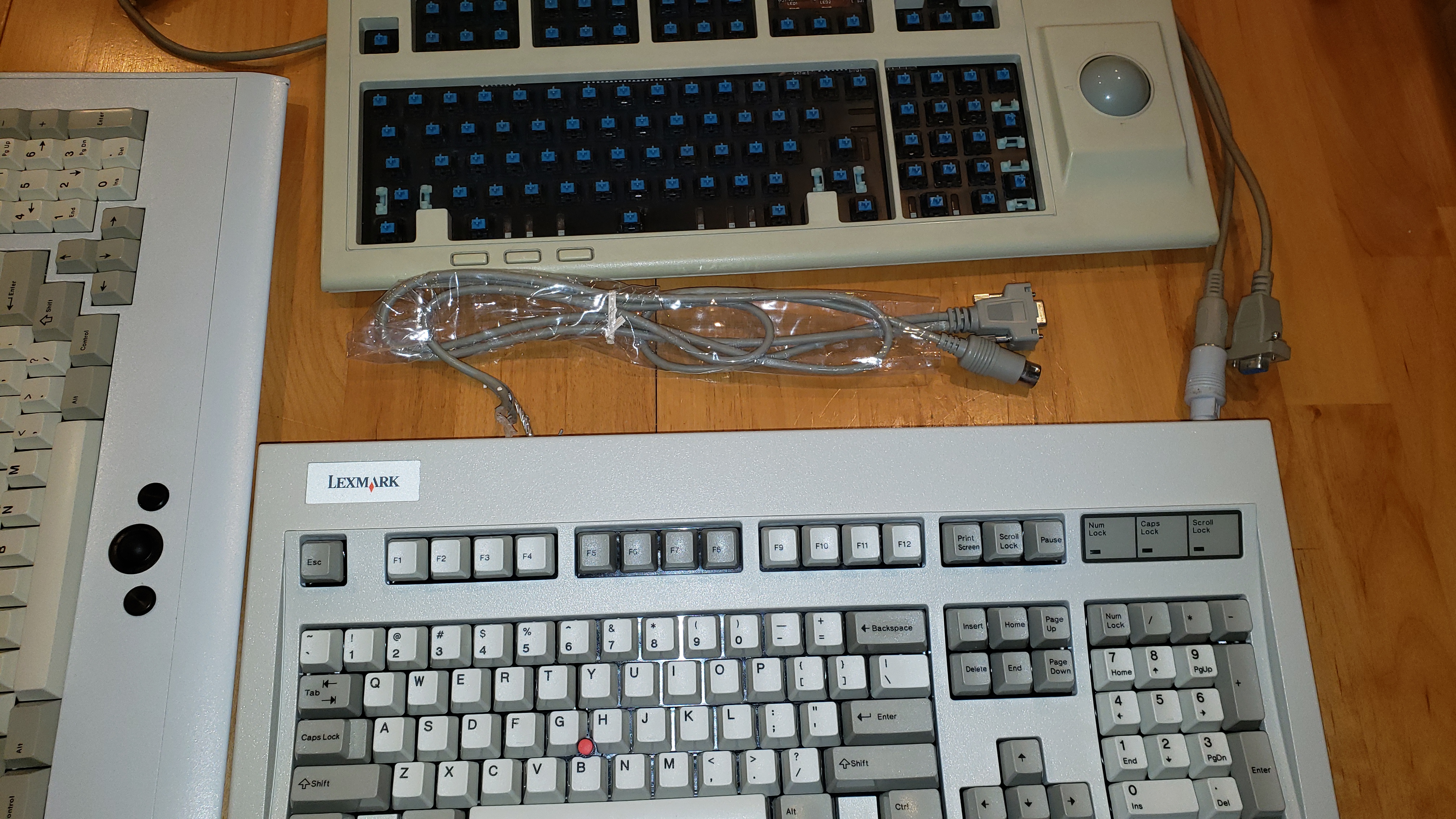

I should be more clear, I have 3 keyboards with pointing devices that connect with DIN5 AT + Serial (?) Instead of dual PS/2. The one that I traced had only 4 or 5 wires actually connected to the DB9 plug. These plugs appear identical to serial mice of the era, but convertors for serial mice are surprisingly hard to find.MMcM wrote: 09 Nov 2020, 05:16A converter like this, yes. But all the details will be different.Rayndalf wrote: 08 Nov 2020, 02:57 Would a convertor like this work with a serial mouse or trackball? I have an M13 and some other boards with integrated trackballs that I'd love to use over USB, but I can't find a commercial Serial to USB convertor marketed for pointing devices.
Can you say a little more about what you have, exactly? I am a little confused because I would have imagined that an M13 with trackball would interface as a PS/2 keyboard and a PS/2 mouse. But what you have is serial? Is that for both the keyboard and mouse?

Ah, okay. I get it now.Rayndalf wrote: 09 Nov 2020, 06:18 I have 3 keyboards with pointing devices that connect with DIN5 AT + Serial (?) Instead of dual PS/2.
I believe that QMK has the necessary protocol handlers for both, so it should just be a matter of a proto-board with both connectors and maybe extra power and then some copy and paste software.

The grey one on the left used a standard G81 keyboard module and the ball is an entirely independent serial device (that happen to share a wire), and I replaced the keyboard PCB already, so that one should be the same as converting a standalone serial mouse (I didn't know QMK also converted serial, but I can give it a shot).
Using one micro controller for both outputs would be great for the other two though. The cable on the M13 is losing its insulation so I think I'll convert it internally and get a new cable.

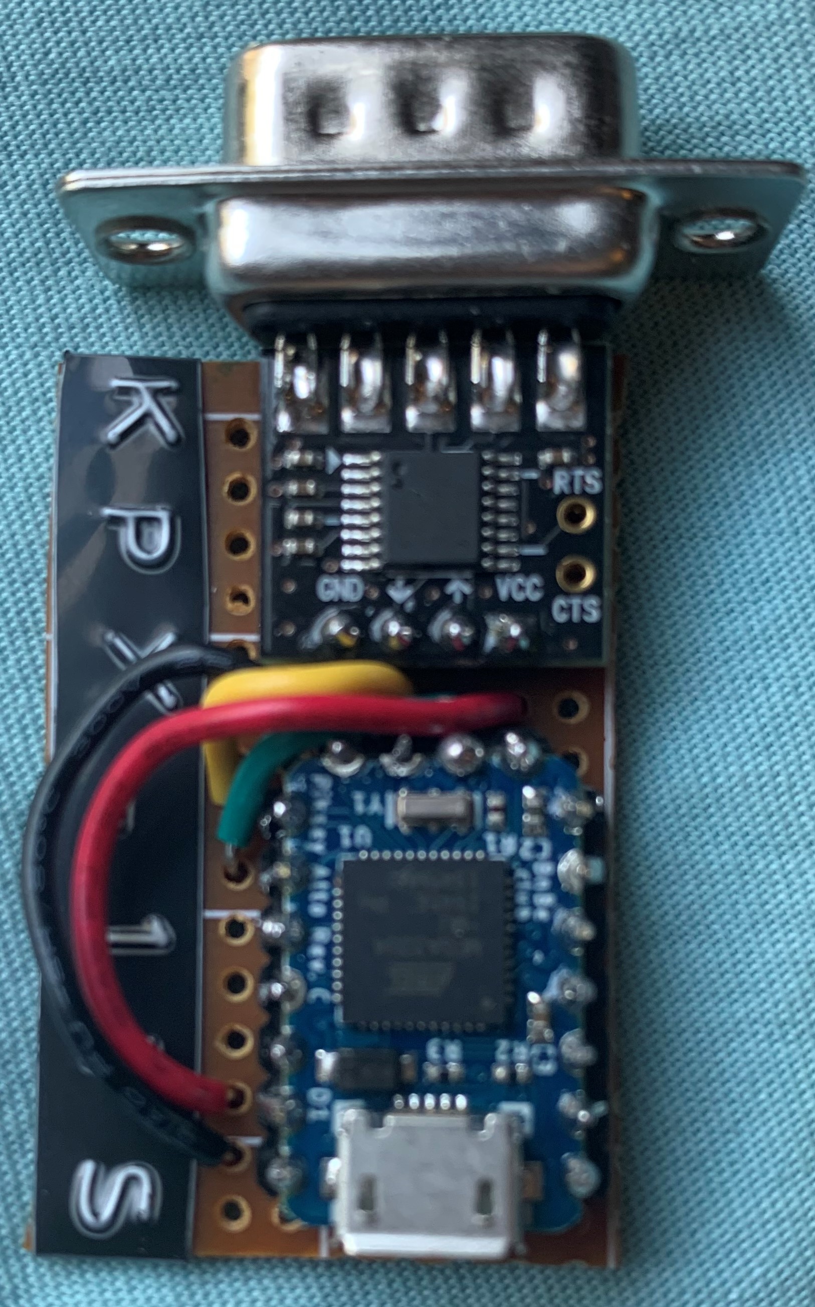

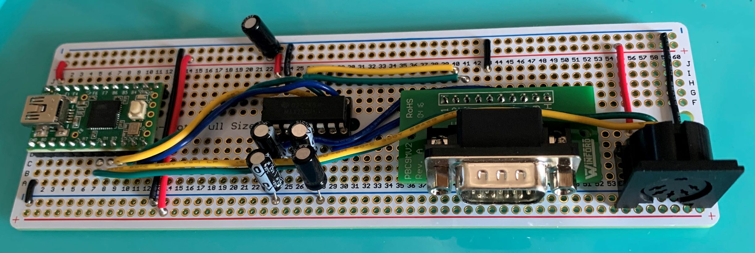

Here's the converter I built. Since this trackball uses physical switches, it needs essentially zero current. It's possible that a more sophisticated device would need more and maybe that would turn out to be an issue.
There are pre-packaged MAX232 breakout boards, with SMD components. They don't break out the raw voltages, so that would mean going with the two GPIO solution. Breakouts with a DE-9 on the board (male is rarer than female) don't seem to deal with EIA signals other than data flexibly enough, or I didn't find one that looked like it would. Hence the giant capacitors for the charge pumps on this thing.

So the DB9 header you used is just a connector, all the logic is on the Teensy and the MAX232?
I'm a little too dumb to copy a circuit just by looking, are only 4 pins of the DB9 connector used? If I wanted to make something similar but hardwired (to mount internally) I would just need a QMK compatible microcontroller, and a MAX232? How would I know if I need to use capacitors with my pointing device?
I hate to just throw questions at you, but this looks like exactly the kind on converter I would need, but I'm not (yet) familiar with level shifters or really electrical engineering in general.

Correct. The Teensy has all the real logic and the MAX232 does voltage adjustment between TTL (0 or +5V) and RS-232 (± 10-ish V). The rest is wires and connectors. I do my conversions outside, keeping the existing connector hardware. But that's just me; there aren't any rules.Rayndalf wrote: 24 Nov 2020, 06:16 So the DB9 header you used is just a connector, all the logic is on the Teensy and the MAX232?
Connections on the Teensy:Rayndalf wrote: 24 Nov 2020, 06:16 ..., are only 4 pins of the DB9 connector used? If I wanted to make something similar but hardwired (to mount internally) I would just need a QMK compatible microcontroller, and a MAX232? How would I know if I need to use capacitors with my pointing device?
- GND to - rail.
- Vcc to + rail.
- D0 to DIN-5 2 (DATA).
- D1 (INT1) to DIN-5 1 (CLOCK).
- D2 (RXD1) to MAX232 12 (R1OUT).
- D3 (TXD1) to MAX232 11 (T1IN).
- C6 to MAX232 10 (T2IN).
- 2 (Vs+) to DE-9 7 (RTS).
- 7 (T2OUT) to DE-9 4 (DTR).
- 10 (T2IN) from Teensy C6.
- 11 (T1IN) from Teensy D3.
- 12 (R1OUT) from Teensy D2.
- 13 (R1IN) to DE-9 2 (RXD).
- 14 (T1OUT) to DE-9 3 (TXD).
- 15 (GND) to - rail.
- 16 (Vcc) to + rail.
- 2 (RXD) from MAX232 13 (R1IN).
- 3 (TXD) from MAX232 14 (T1OUT).
- 4 (DTR) from MAX232 7 (T2OUT).
- 5 (GND) to - rail.
- 7 (RTS) from MAX232 2 (Vs+).
Connections on DIN-5 (see http://kbdbabel.org/conn/kbd_connector_ps2.png):
- 1 (CLOCK) from Teensy D1.
- 2 (DATA) from Teensy D0.
- 4 (GND) to - rail.
- 5 (Vcc +5V) to + rail.
- 1 and 3.
- 4 and 5.
- 2 and ground.
- 6 and ground.
- 16 and ground.
The other ones are to protect against voltage drops as things start using those sources.
If you wanted to save some soldering (and messing with loose capacitors) and go with something prefab like BOB-11189, as I said, I believe the difference is that you'd need to use T1IN from another GPIO, say, C7, and T1OUT to RTS. And leave D3 and TXD disconnected. And then add that second GPIO bit to the SERIAL_UART_INIT macro. I haven't tried this, but I think it will work.
If you're putting the converter inside the case, then the simplest thing is just to leave out the DE-9 connector and still do the RS-232 signal. It's likely that the trackpad is doing TTL (or CMOS) levels itself and then converting to RS-232 at the last minute. So, you could bypass that and go straight. But how to do that would vary from board to board, so it's hard to give more specific advice. Maybe just stick to the (slightly) wasteful conversion to serial and back.

Yeah, the grey metal board was made by another company that used a G81-1800 keymodule installed along side the trackball. Any PCB made to fit a G80-1800 case seems to fit if I widen the hole on the left side. Currently a Leeku 1800 PCB is installed (I bought it assembled and unlike the TKC1800 the switches are aligned), but I also have a TKC1800 PCB that would also fit.MMcM wrote: 24 Nov 2020, 07:27I'm not quite sure what you're trying to hook up here. Is this a Cherry 1800 board with a pointing device that we're gonna Frankenstein with the TKC PCB?Rayndalf wrote: 24 Nov 2020, 06:16 I'm sure if I was more experienced I'd be able to use the I2C or SPI interface on a TKC1800 PCB to run the serial convertor as well and eliminate the need for a USB hub to combine the two devices, but a simple internal converter is more than good enough!
Given how industrial the case is I might install a USB hub in the back, so merging the two devices (keyboard PCB and the trackball) could be done through that. I don't really want to mess with the TKC1800 (it's powerful and has some IO, but proper switch alignment requires a plate.
I also have a trackpoint Model M (M13) that uses AT + Serial instead of dual PS/2, and the dual cable started to disintegrate so I may convert it internally similar to the converter you made for the Ortek (only mounted internally... assuming the M13 has room for even more PCBs).
