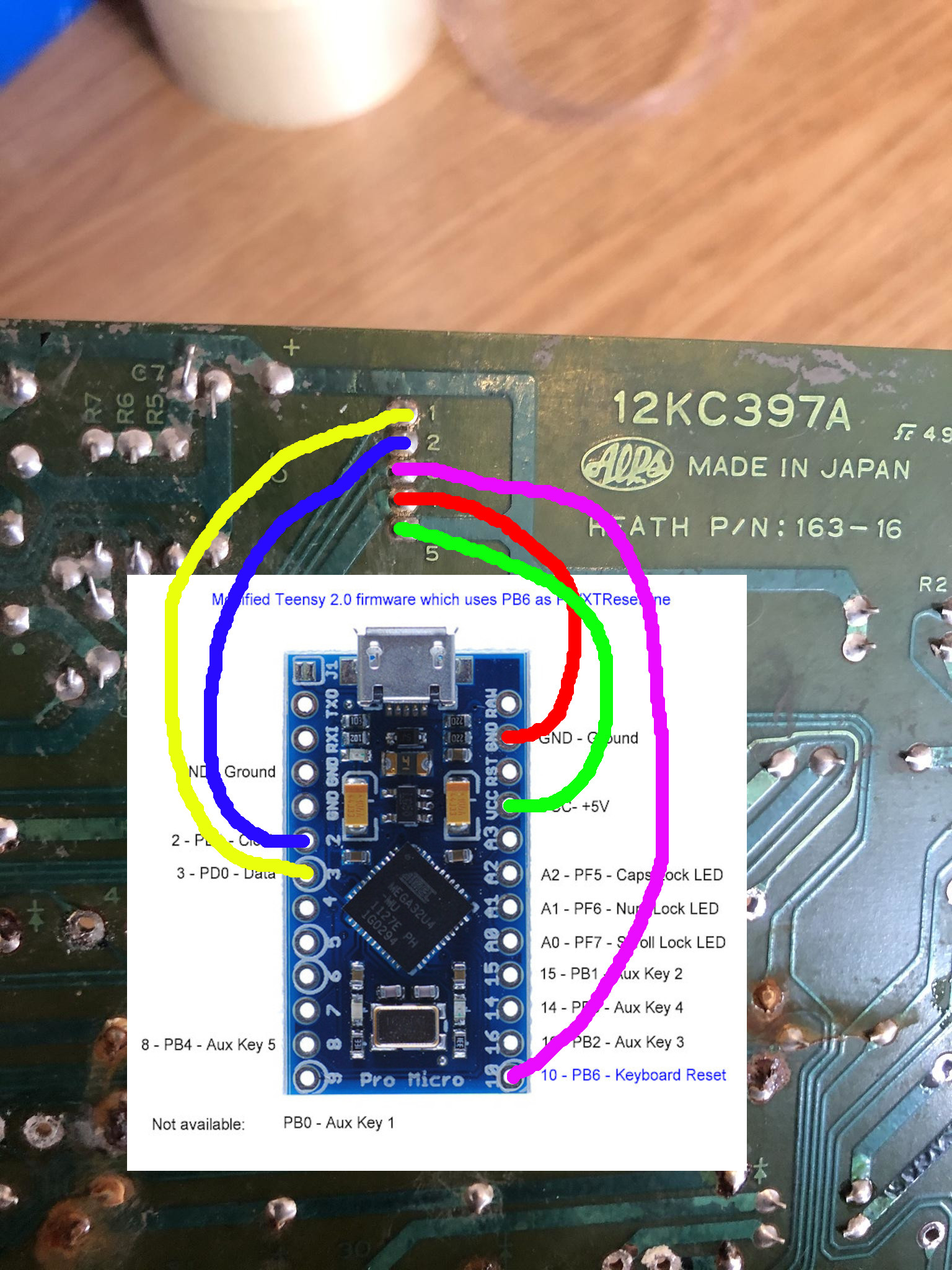

Figured I should add a small update for anyone who needs this in the future. I helped OP in DMs on Discord and we figured out the pinout. It is as follows (going of the pin labels on the PCB)
1. Data
2. Clock
3. Reset
4. Ground
5. VCC
Reset was easy to figure out since, as I suspected, it goes to the reset line on the controller. From there, we just got lucky and the first combination of clock and data wires happened to be the right one.
His board still isn't 100% working, however, this is likely due to the horrible shape it is in. Apparently his computer makes noises when keys are pressed but not when clock and data are switched, further leading me to believe this is the right pinout.

Oooh. I think I'm going to need to know where that "Keyboard Reset" pin is, so thanks very much for the diagram!
kelvinhall05
16 Oct 2020, 04:45
hellothere wrote: 16 Oct 2020, 00:57 Oooh. I think I'm going to need to know where that "Keyboard Reset" pin is, so thanks very much for the diagram!
The diagram only applies if you use the modified Soarers firmware with the reset pin moved to an IO pin accessible on a Pro Micro, not just a Teensy. It'll be a different pin on the controller with stock Soarers on a Teensy.
Regardless, reset should be easy to find on any XT keyboard with one; it'll go to a reset line on the controller.
