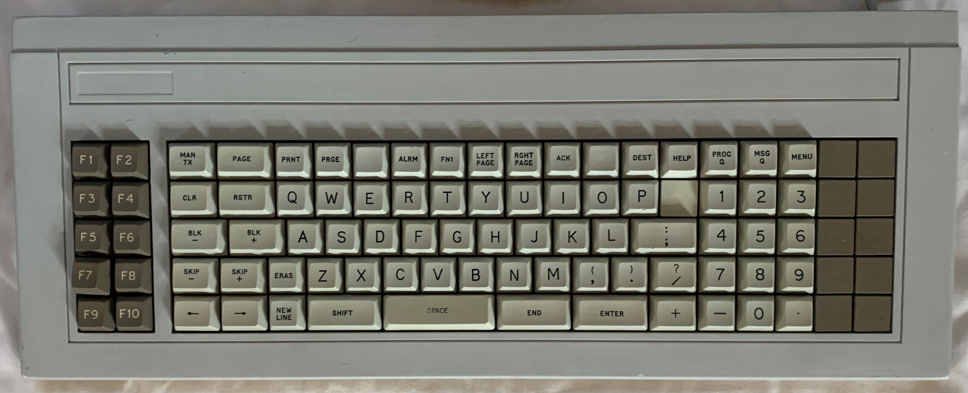

The immediately obvious interest is the layout. No doubt it made perfect sense with the system for which it was intended. But out of context it appears particularly quirky.
  • Huge top bezel with room for some kind of branding.
  • No typewriter digits.
  • No Tab.
  • No Caps Lock.
  • No Backspace / Rub Out.
  • 1.75u semicolon.
  • Spacer in the typewriter section.
  • Shift and Enter in the bottom row.
  • Space so squeezed that it needs a legend.
  • Aggressive removal of vowels in legend abbreviations (yes, there are examples for all five).

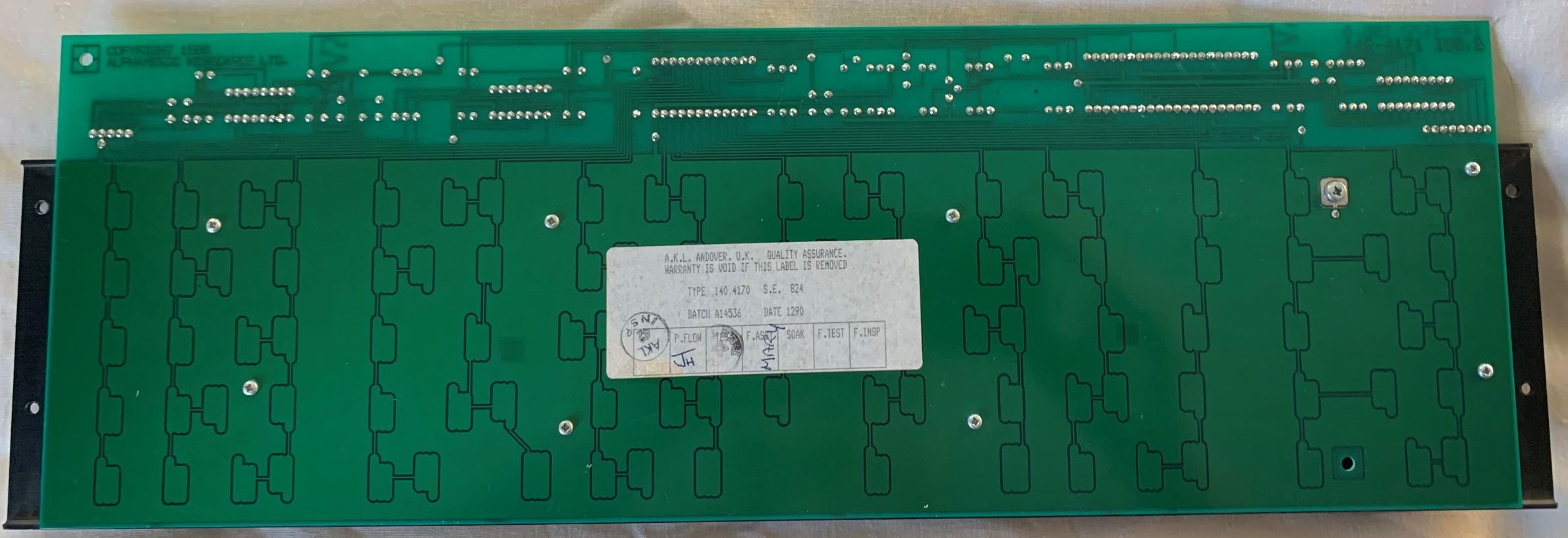

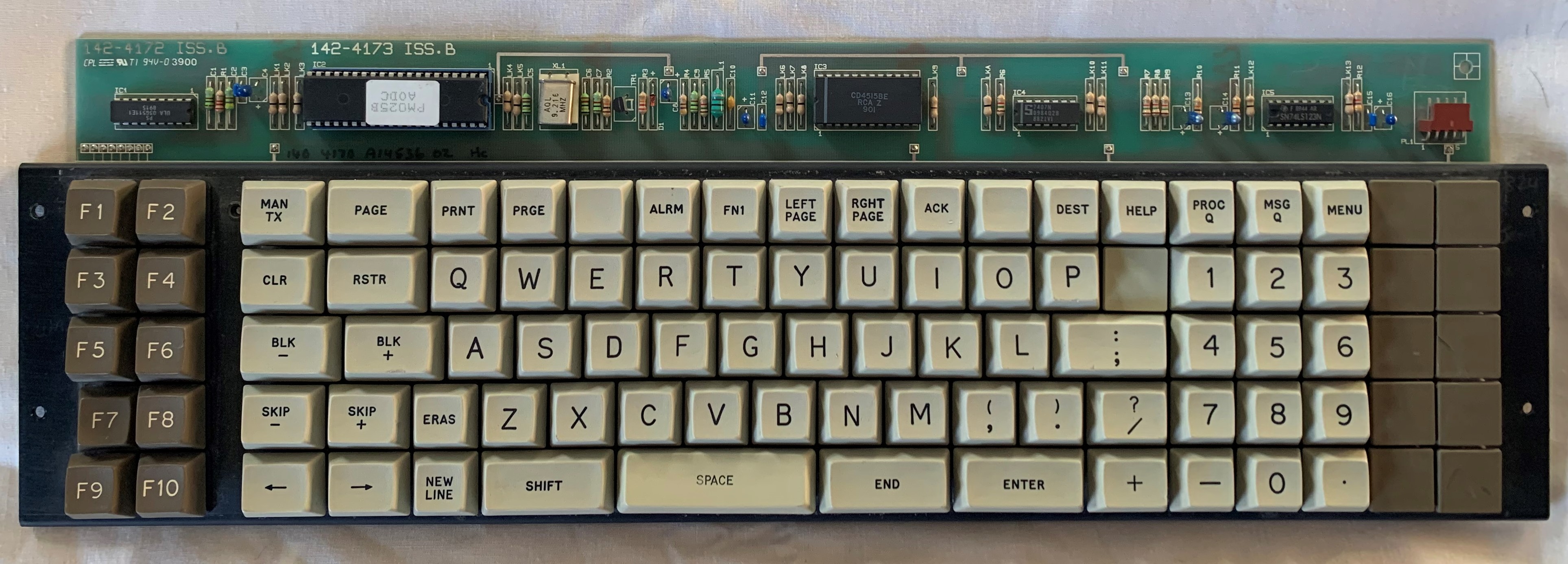

The switches are Alphameric foam and foil. Which hasn't deteriorated enough on this board to affect the capacitive switching, so I haven't bothered to replace it yet. The main PCB is bolted to a metal plate with a couple of hard rubber spacers in addition to the metal standoffs. So the typing feel isn't all that bad.
(That's what the small square residue on either side of the sticker in that photo is from.)
The controller is an 8749, which is consistent with low-volume manufacture.
The sense circuit seems a little bit different from other foam and foil, though I didn't work out the details. I imagine the multivibrator generates the sense pulses. I could not find out what a 03G511E1 is. There seems to be a couple of Shenzen vendors with some but no datasheet that I can locate. It may be part of it, too.

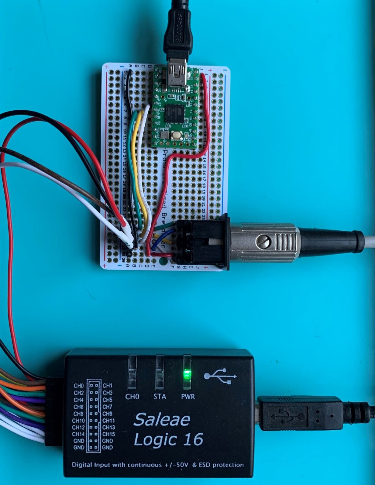

The keyboard connected with a DIN-5, wired up more or less like an XT: +5 on pin 5, ground on pin 4, reset (after a 7407 buffer) on 3, 2 and 1 with a pair of open collector circuits going to INT and T0 and coming from data ports.
So the converter can be wired up just like for Soarer's or an existing one temporarily reprogrammed.

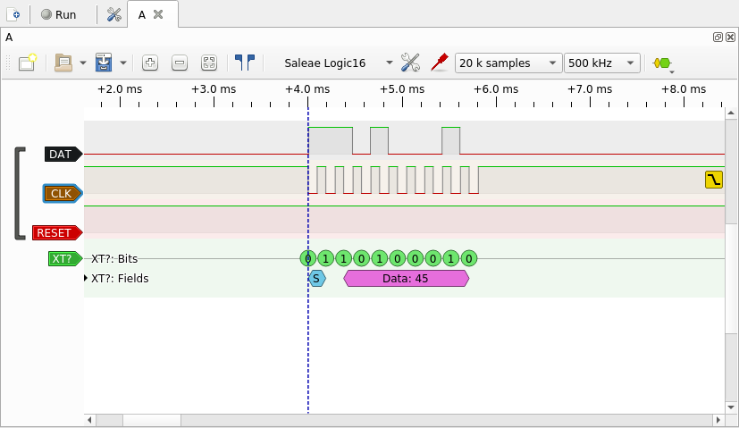

The protocol is more or less XT (or clones) as well.
Two start bits, eight data bits, data idle is hi-Z. The clock pulse timing is uniform.
The scan codes are completely different though, being, it seems, the switch position, since adjacent keys tend to have adjacent codes.

More practically, the protocol is also compatible with the TMK XT protcol driver. And the copy in QMK, which is what I used. I might wish that it were a bit more robust in the face of lost clock pulses: it's happy to wait for all ten for an arbitrary amount of time and so can get permanently out of sync. Since soft reset apparently isn't needed, it might be that a separate interrupt handler (like this) would be simpler. But given that the layout makes it kind of challenging to use as a real keyboard, I'm not sure it's worth the effort.
