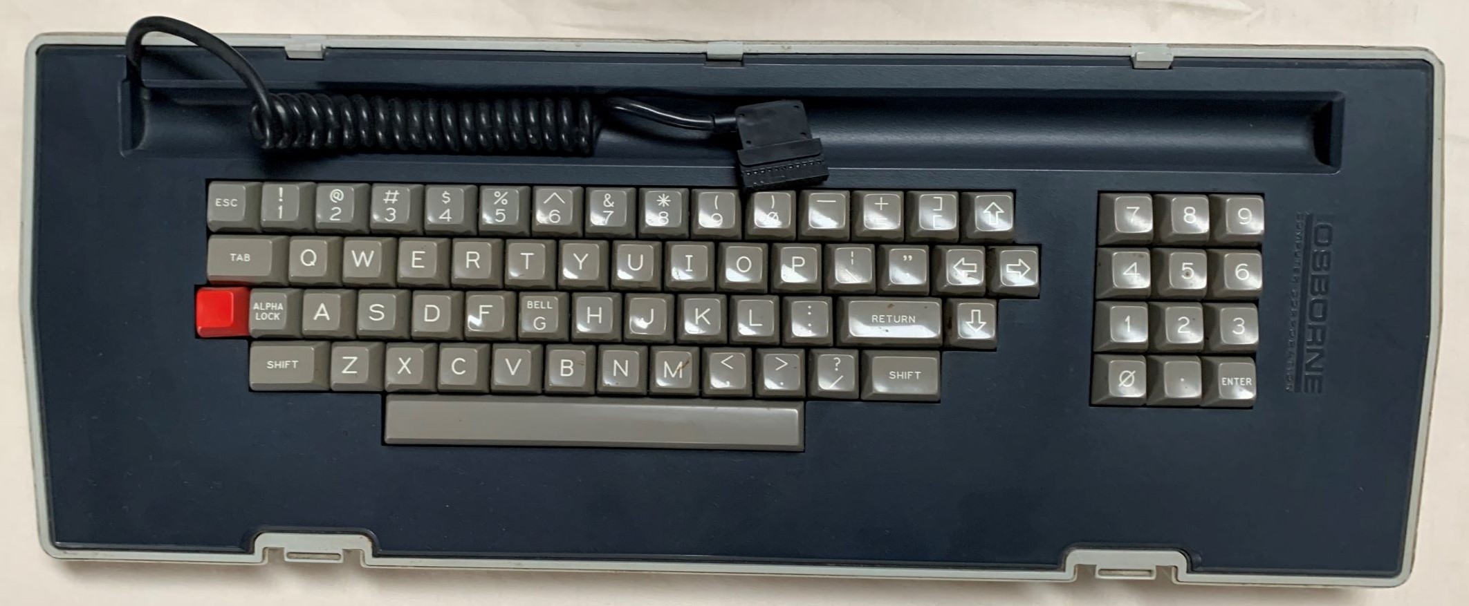

Which brings me to this Osborne 1 keyboard.
I don't know where that red CTRL key came from. I suppose it's a replacement, but where did someone find one with the right cross-mount? Anyway, I think I found a seller online with something closer to the original and I will fix it.
There are pictures of the insides in this post from a few years ago.
The Technical Manual on Bitsavers has schematics and details of the matrix.
Even though it's a direct matrix, the keyboard designers went to the trouble of connecting the two shift keys and all the numpad keys to corresponding main typewriter section keys. So while there are up transitions, there aren't as many key codes available as it might seem. Also there isn't a backspace key. So I figured to use the left arrow for that and the up/down arrows for layer shifts to get more codes.

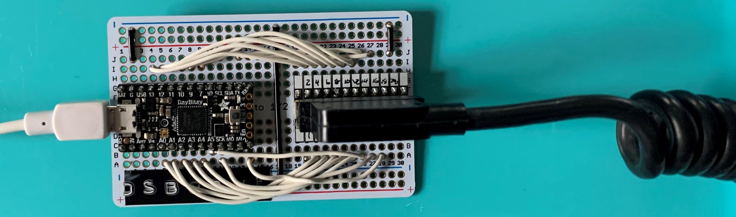

Here is a straightforward converter using an Adafruit ItsyBitsy M4 Express, a board about the size of a Teensy and cheaper than one, too.
Specifying the matrix pins and key mappings in Python code is straightforward. But the converter only sort-of works. The root problem is that there aren't any diodes in the Osborne matrix, a common problem with older (cheaper) boards. Consequently, you can't type shift-' to get " or shift-[ to get ] (or {) or ctrl-ESC. These are all pairs of keys in row zero. It's even worse if you switch the scan direction ("diode orientation") to ROWS: now shift T, G, and B and ctrl E, D, and C don't work!

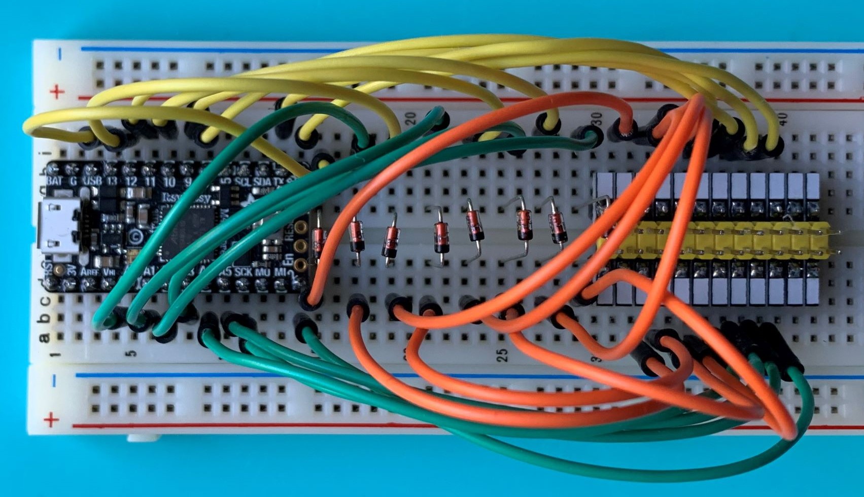

Now, of course, one way to fix this is to add some diodes. Specifically, a diode per row, if scanning by rows. That doesn't fix all ghosting, which needs them per switch, but it does solve the shift-key problem. Here is the same converter on a breadboard with the necessary diodes.

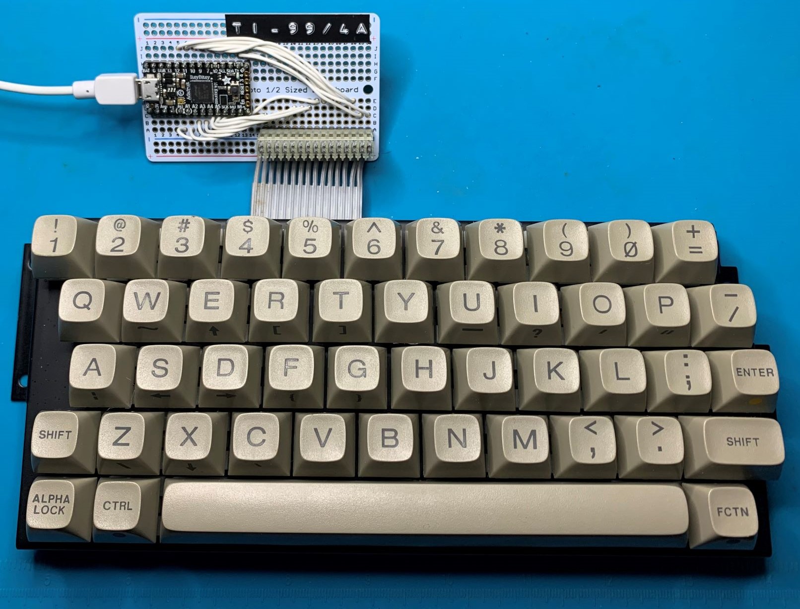

Naturally, that's just one-time work. This new class works fine for another matrix keyboard, like the TI-99/4A.

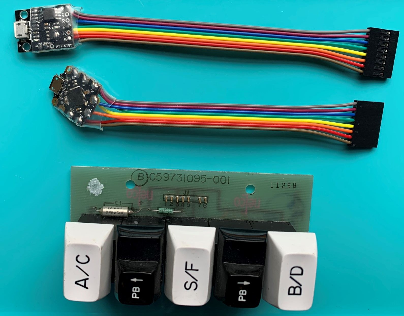

What about smaller boards? From time to time I pick up these button sub-assemblies with interesting key switches. They aren't keyboards, per se, but the same approaches ought to be able to make them into macro pads. (Perhaps even usably so if I could manage 3D printing.)
Here are some old Micro Switch SN-series switches from some kind of industrial control. The black switches are sink pulse and the white ones sink level. Which is close enough to a switch to ground for QMK's DIRECT_PIN configuration to work.
For the main converter, I used a DFRobot Beetle.
For tiny stuff like this, QMK even supports ATtiny85 boards like Digispark. The second converter pictured above is some clone with an actual USB connector. The biggest problem is that only three GPIOs are available of the six after the onboard LED and software USB. So one of the buttons isn't connected.
It would work to add a MCP230xx and use the available pins for i2c, but that kind of defeats the purpose of using a tiny MCU and eats up the cost savings. Plus they aren't really supported in QMK. There are a number of (mostly split) keyboards there that use them, but through a custom matrix. Generalizing the GPIO routines in C is more of a big deal; in Python duck-typing mostly does it.

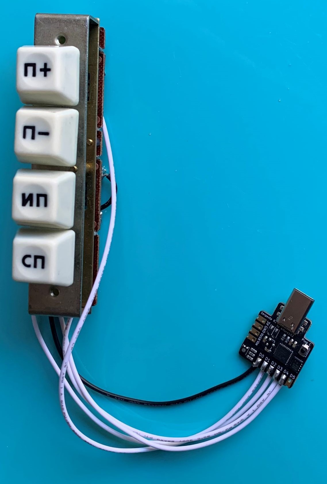

Here are some reed switches, from the memory (Память?) section of a Soviet-era calculator, connected to a Serpente.
Can it be made into a macro pad?
The issue is RAM. The KMK landing page is pretty explicit about needing the bigger boards.
