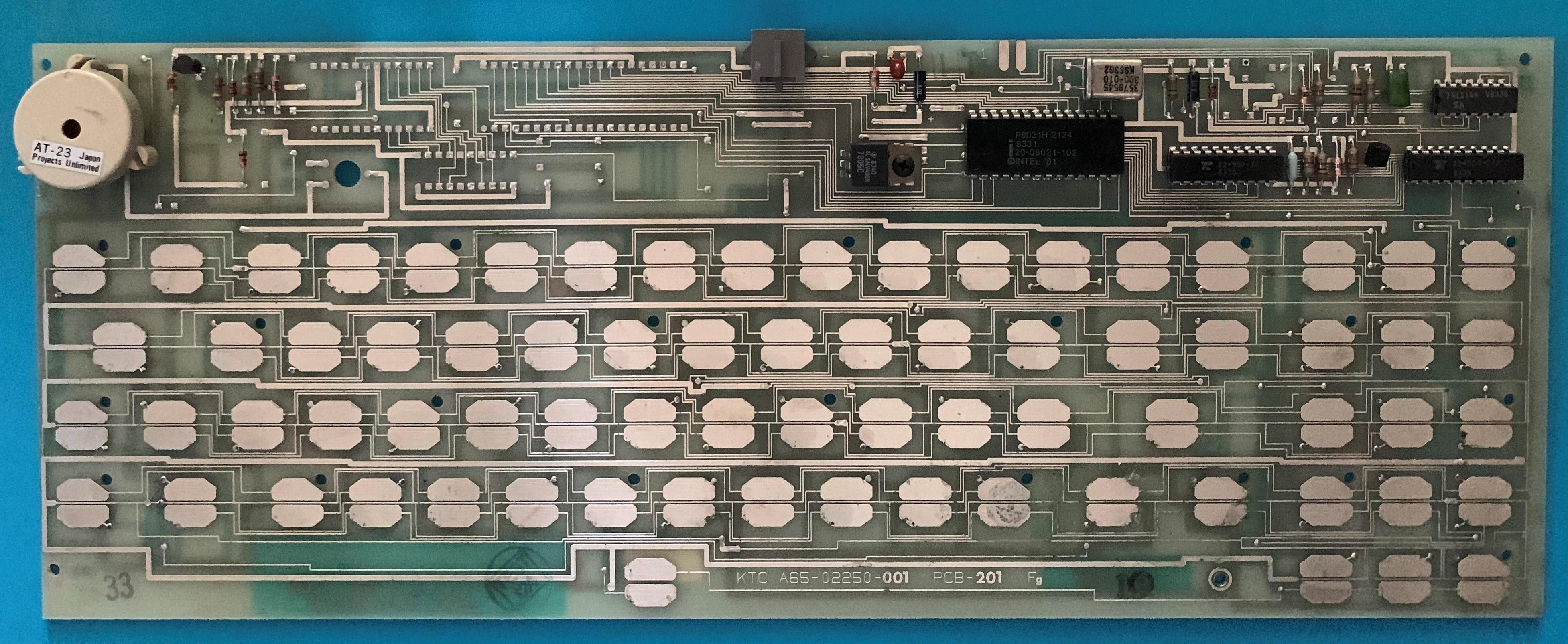

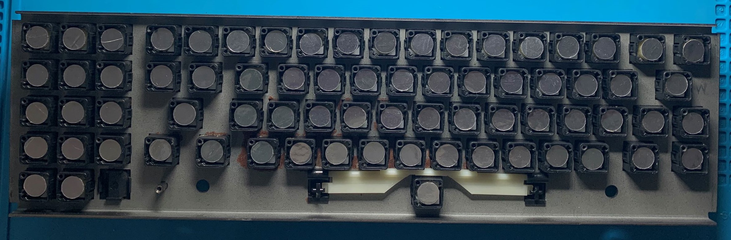

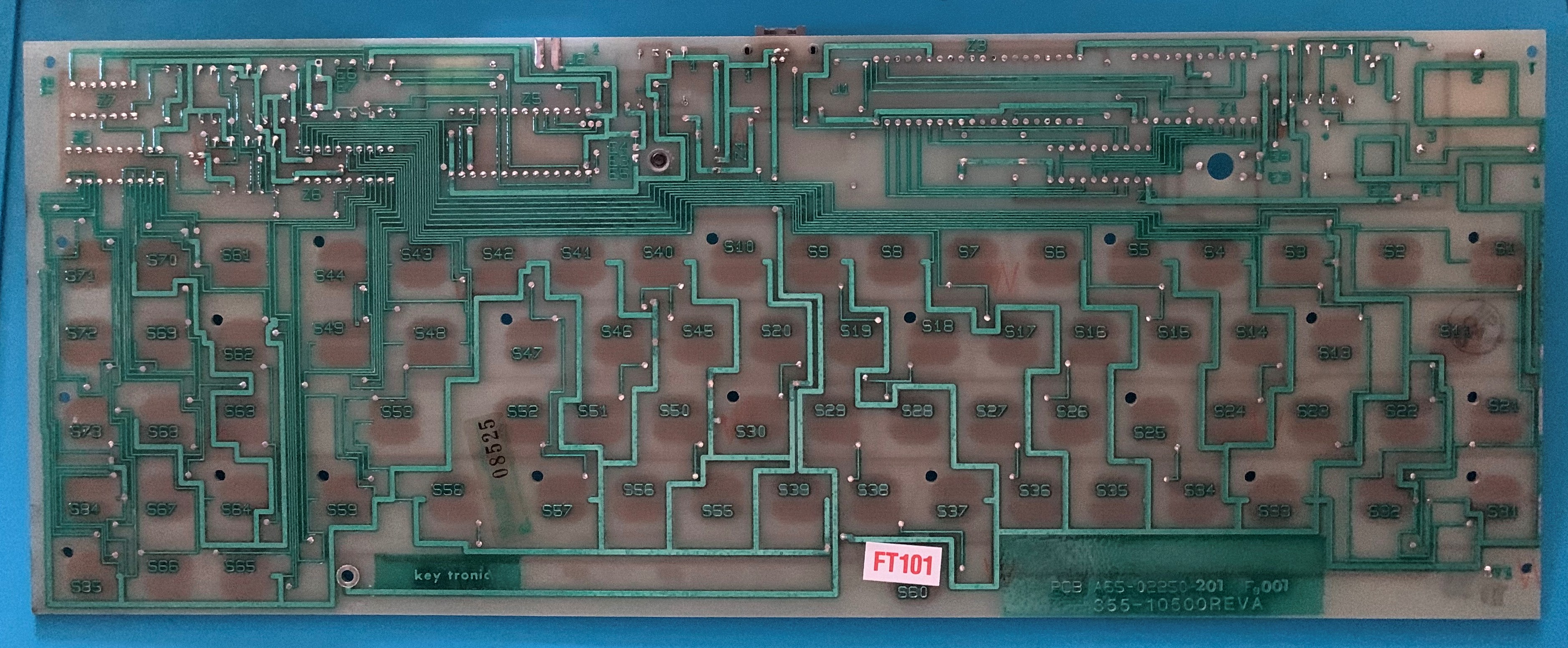

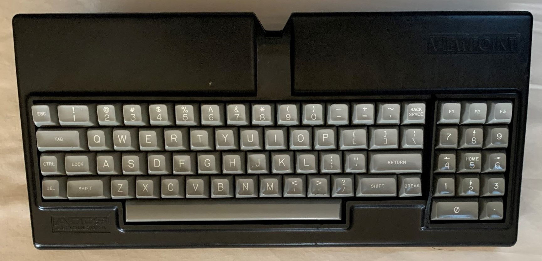

First, it's a little beat up. Both the keycaps and the case, which is also plastic, have some gouges. And it looks like someone started to deal with the rather annoyingly high barrier between the typewriter keys and the numpad. There are pictures of another example's insides on Bitsavers. From these, it was evident that it was Keytronic, so that meant replacing the foil as a first step. And that it used a 4P4C modular jack and had a 5V regulator. So, I figured that it would need 12V and ground and then use the other two lines for TTL-level serial ASCII.
But looking closer at the PCB, I can see that one of the signals just goes to a screw, so it's a chassis ground. The keyboard can't be output-only, because it has a buzzer and the DIP switch settings listed there confirm that one could enable key clicks. Furthermore, the buzzer itself is 12V, so the power isn't trivial, either.
So, I got it for reasonably cheap, half shipping. And dealt with the foam and foil.
And confirmed the details of the circuit.

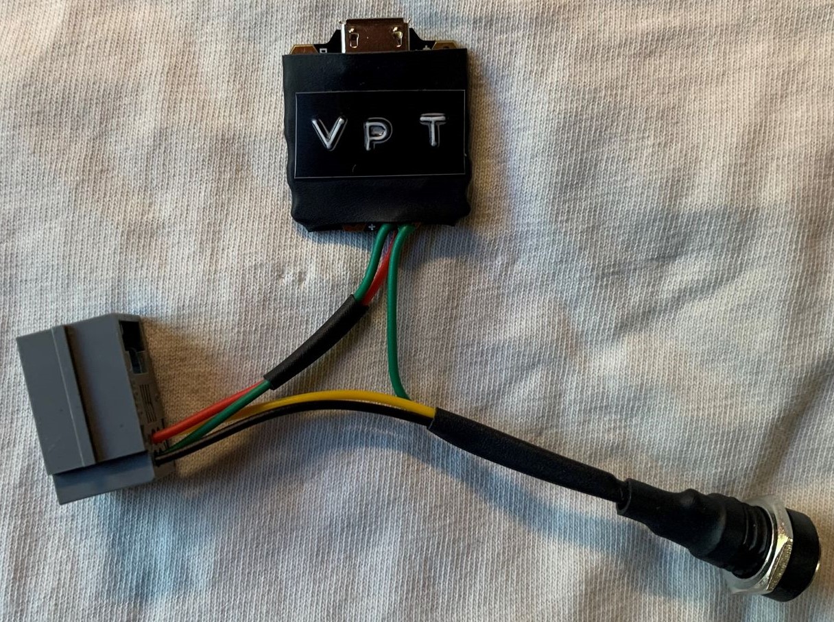

And built an interface for power and the one signal line.
When connected and powered, the signal is pulled high. And typing characters does nothing.

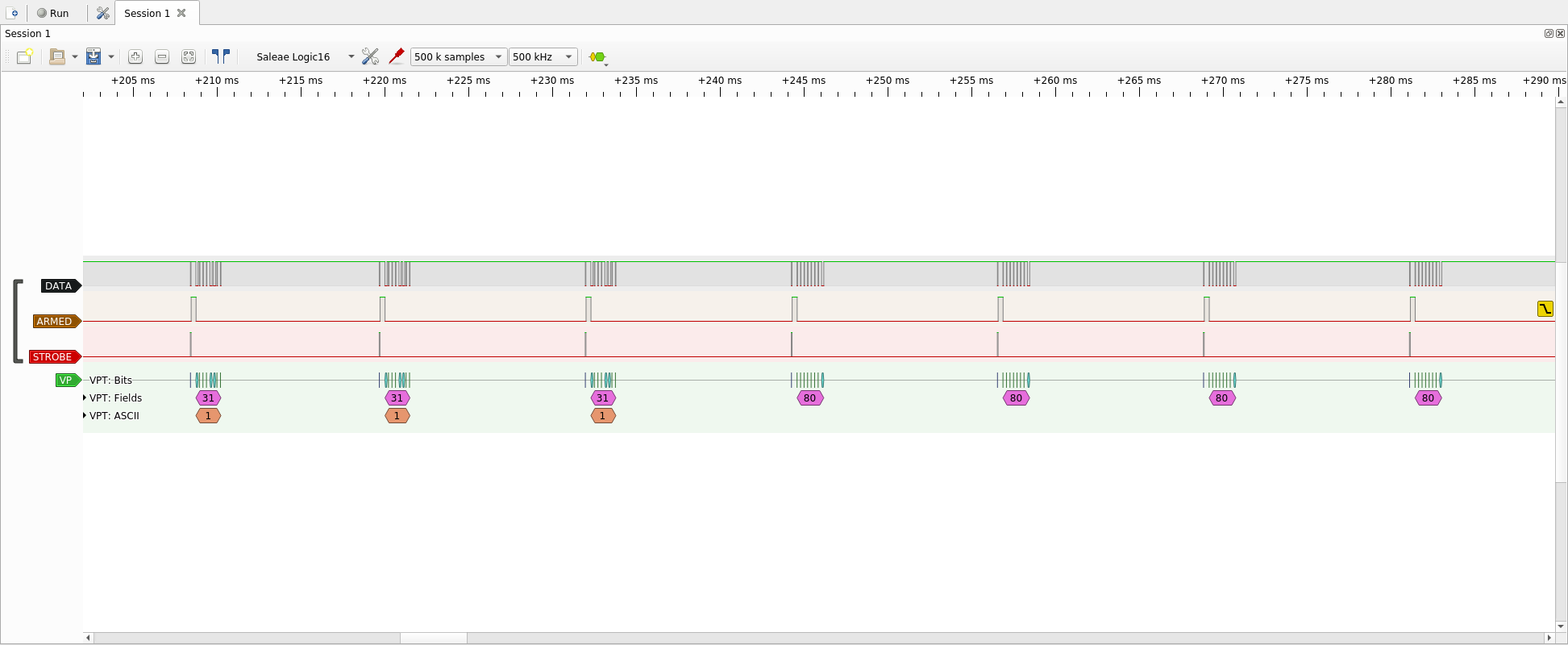

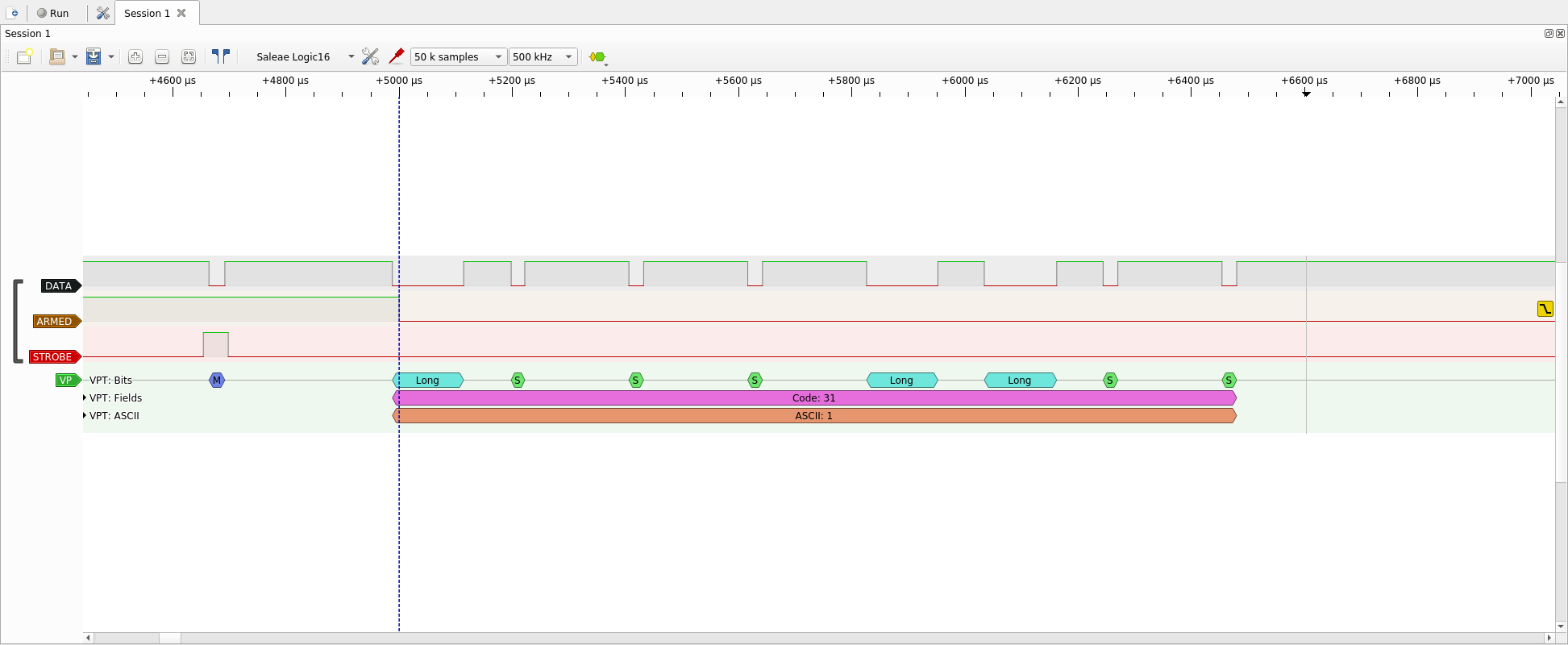

After fooling around with having the host pull it low for a while, I found that a single pulse would cause it to toggle the line a few times on its own. And that multiple pulses would cause it to make noise, which turned out to be a quite loud alarm kind of sound. It also makes this for a few seconds when 12V is cut, as some capacitors discharge.
The most noticeable thing about these pulses was that the low segments were sometimes short (26µs) and sometimes long (126µs) and there seemed to always be eight of them. The ESC key in the upper-left generated long-long-short-long-long-short-short-short. Which is ASCII ESC (1B) in LSB-first order.
And, likewise, the 1 key next to it generated 31. So, it was indeed ASCII, but with a funny bit-serial protocol.
So I whipped up a decoder for Pulseview.
But then I discovered that the 2 key sends 80, not 32.
And 3 is 81; 4 is 82; 5 is 35, as expected; and 6 is 83 again. In fact, there are 16 keys that send 80-8F, 90-9F with shift, and A0-AF with ctrl.
2 3 4 6 Q W Y A Z M ` [ ] \ ; '
I don't think those are a single row in the matrix.
It's almost as though the keyboard were in some kind of raw code + shifts mode. But it's completely reliable for just those keys and no others. And there doesn't seem to be enough room to do all the keys that way. Moreover, C4 is used for LOCK and CD-CF for F1-F3.
